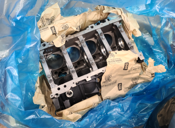

been looking over my 5.3 block and taking note of other things i'll need to order.
Looks like the new block won't come with plugs.
Anything threaded should transfer over just fine.
However the oil gally plug at the front of the engine

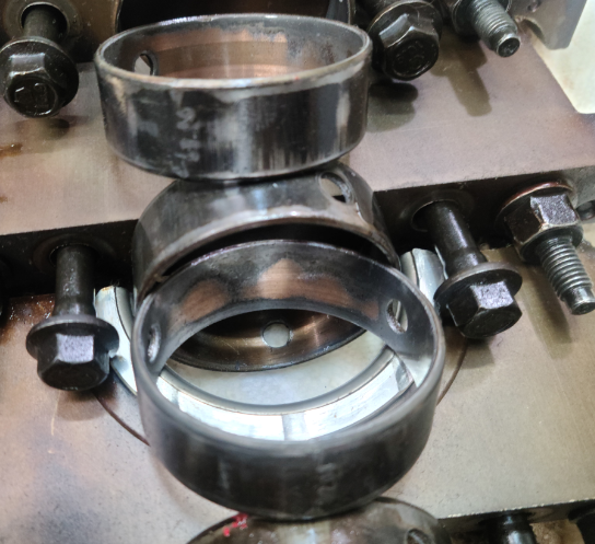

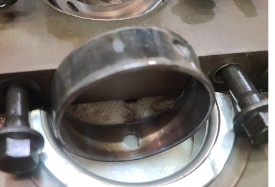

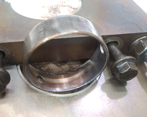

And i got the cam bearings pulled
Sorta destructively, so don't pay attention to the edges. :)

not great, but the amount of metal in the pan i was expecting to see a bearing destroyed or just super thin.

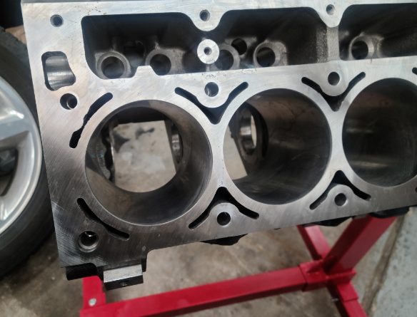

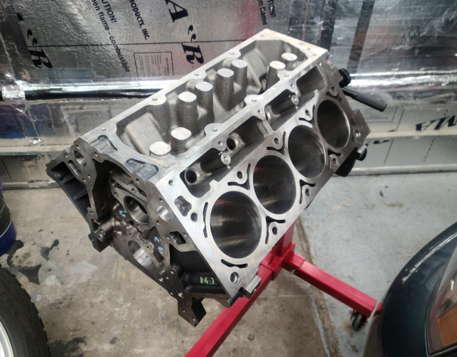

It'll lose a little weight when you have it bored to 6.2, 6.3 or whatever. :D
I was thinking the larger cylinders are nice, but are they really big enough?
I saw what i believe was an LS7 block at the machinist, now those are some girthy cylinders!

So all the crank and rod bearings looked good? Only cam bearings have wear? It wasn't making any noise? I'm very curious about this metal mystery
