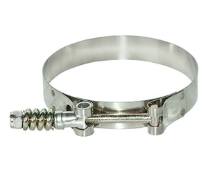

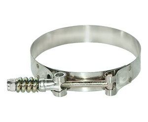

If you really want to go crazy about clamps they make a worm drive clamp that incorporates a spring to mimic the effectiveness of the factory style spring clamps. This would reinforce what is well known- spring clamps do a better job by providing a constant force under both extreme heat and cold conditions.

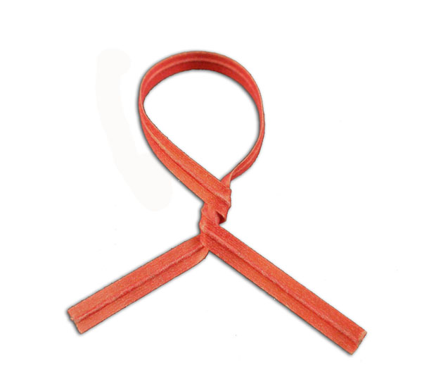

Twist ties FTW. Hundreds of them for free on aisle 3 at Walmart. Just be considerate and twist the bag and tuck the end under the bread after you nab the tie off of it.

I've always called those T-bolt clamps. I use those on my Vortech blower output on my 5.0 mustang. Hold well under boost.
Also, I agree about factory spring clamps being reusable. I still use the 24 year old factory spring clamps that came on my '95s radiator and heater hoses..... Lol

They make the regular T-bolt clamps but that’s a T-bolt with a spring added. It’s made specifically for silicone hose.

I would entertain those as a possible idea. But I still prefer traditional spring clamps.
The only info I've been able to find on the "one time use" claim was a post on BITOG from 2013. I've visited their site and was unable to locate that info. I have never read a mention in a service or technical manual that the things need to be replaced. It's been my experience that unless you damage it by exceeding the yield point of the spring steel they use (which by the way is rather difficult to do) they work well beyond the life of the vehicle.
