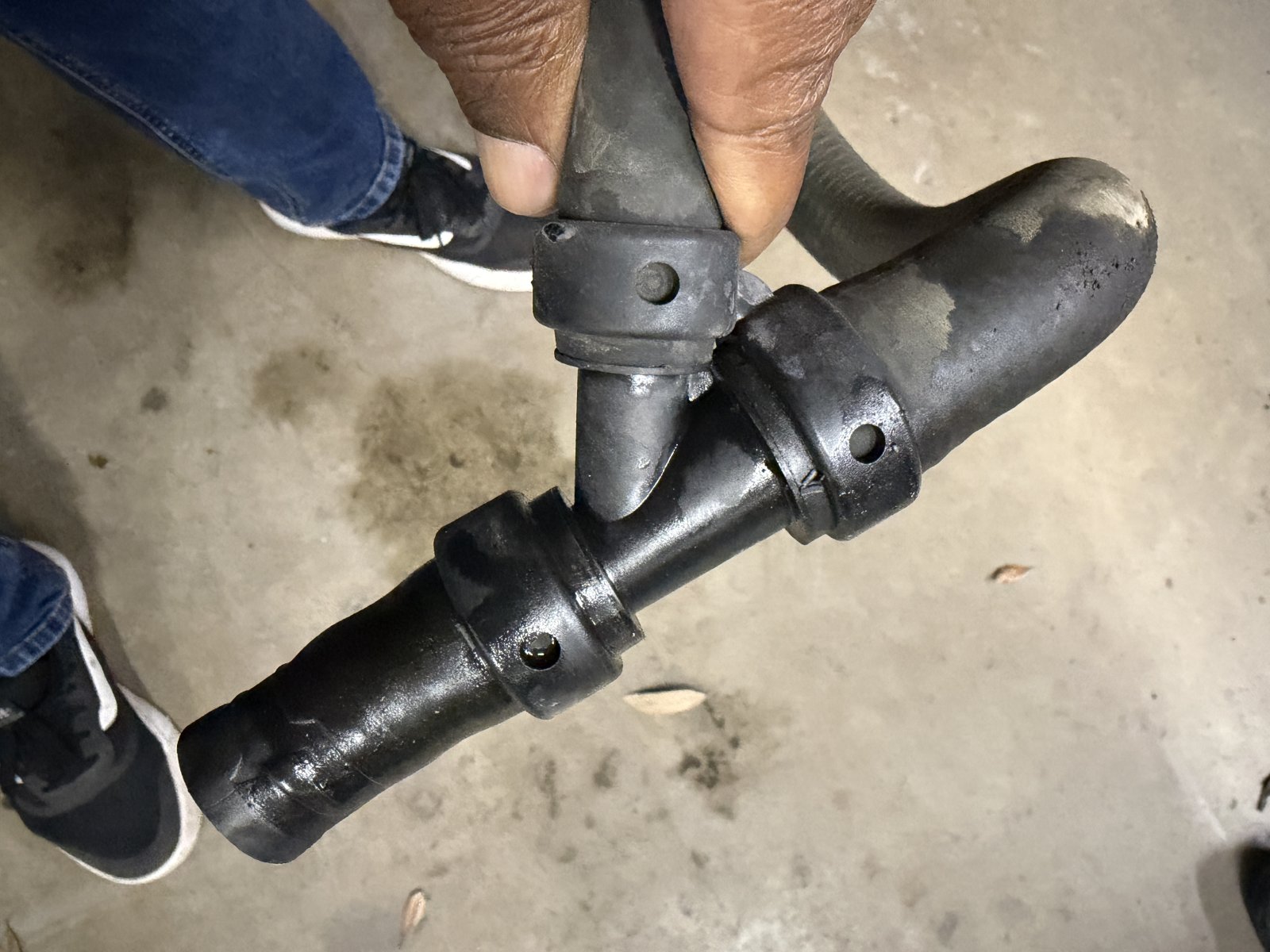

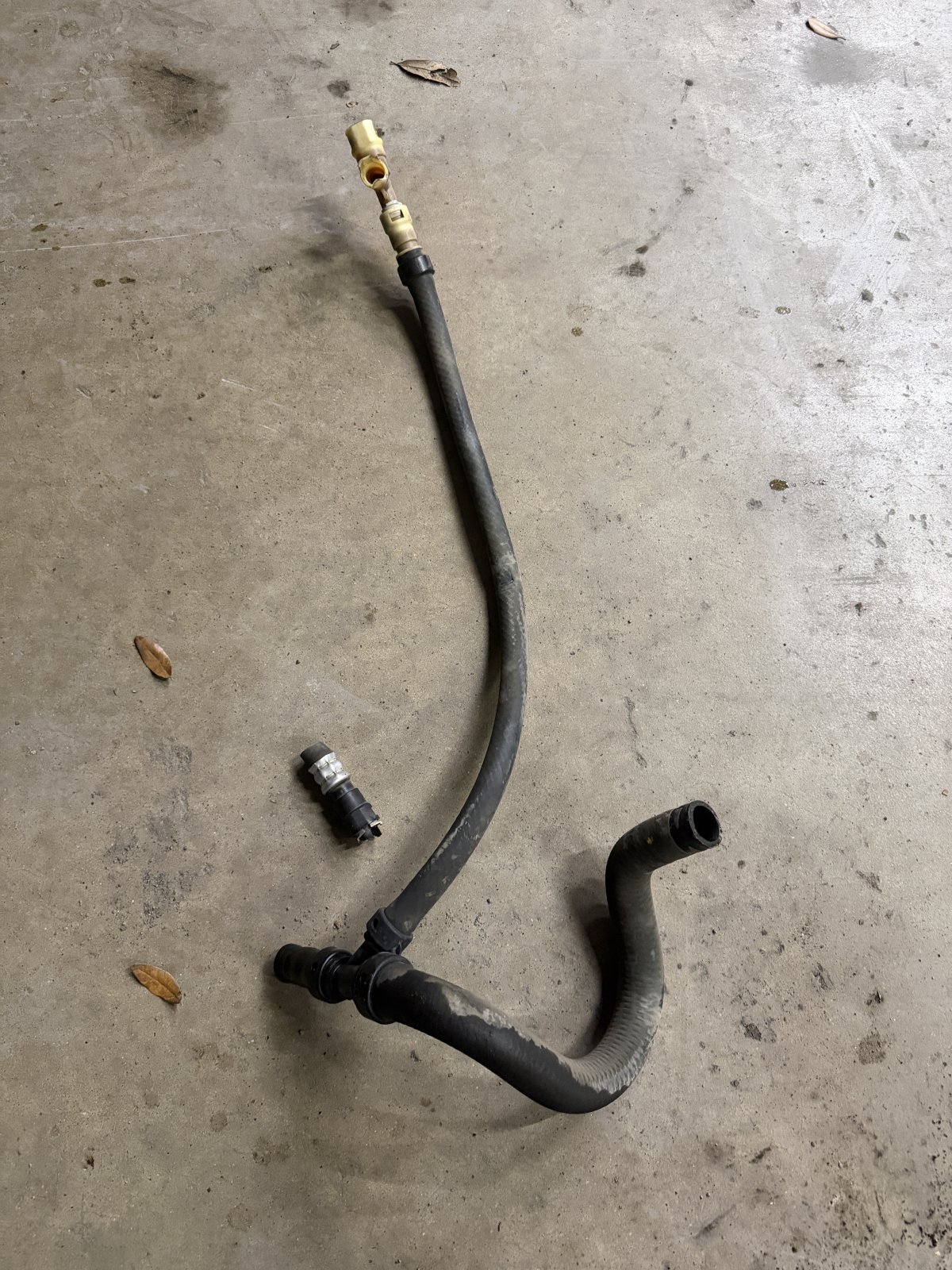

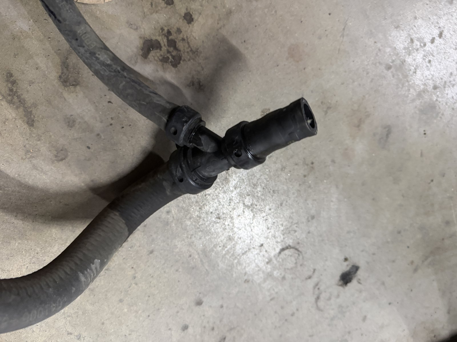

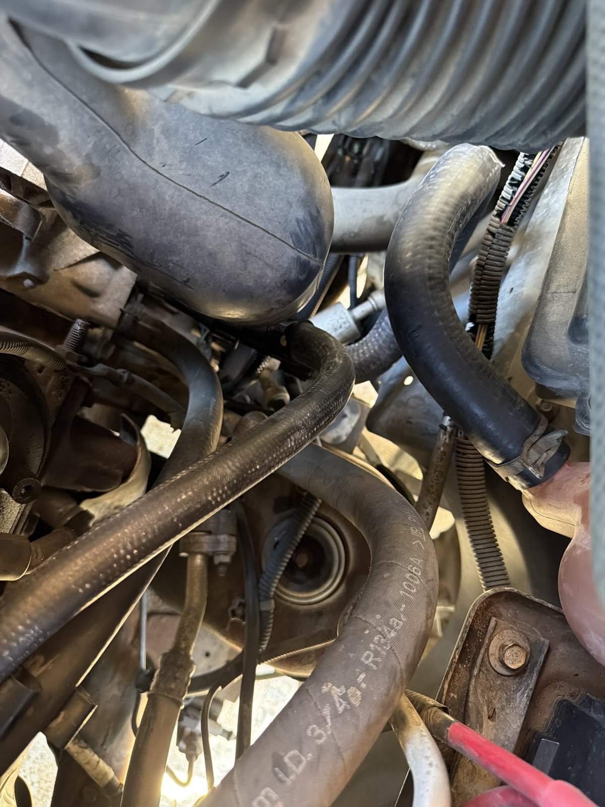

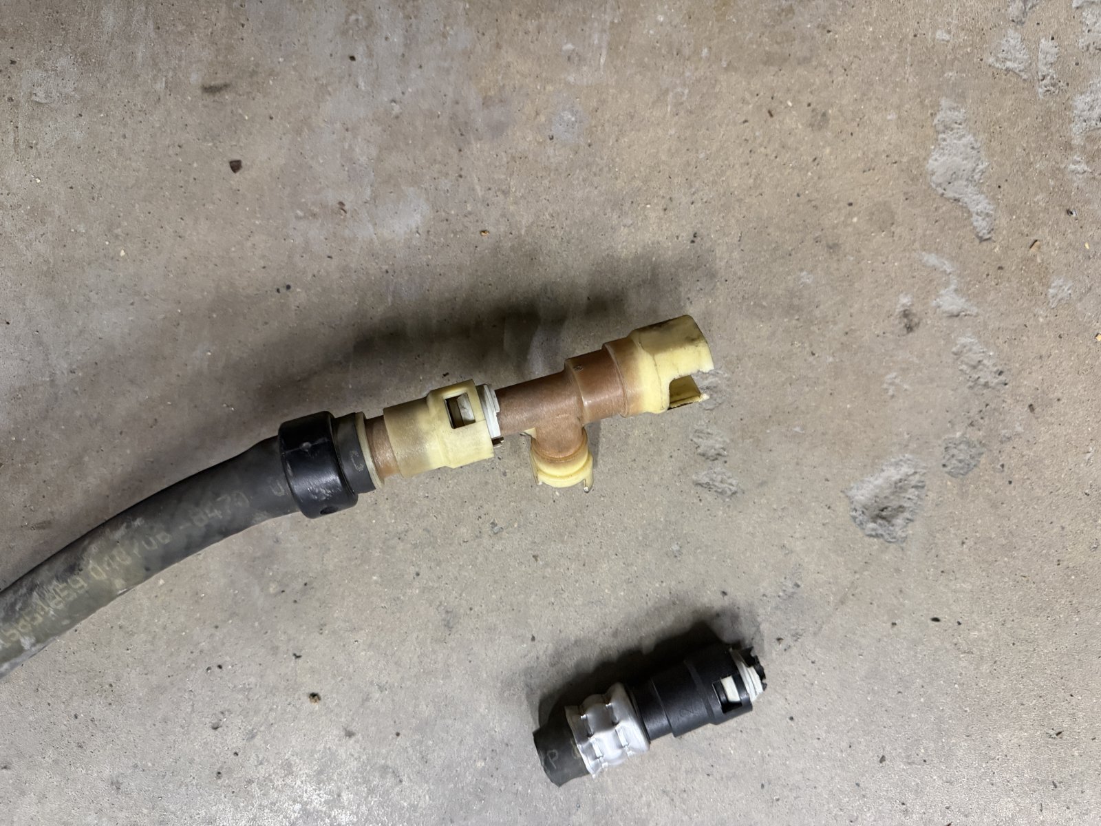

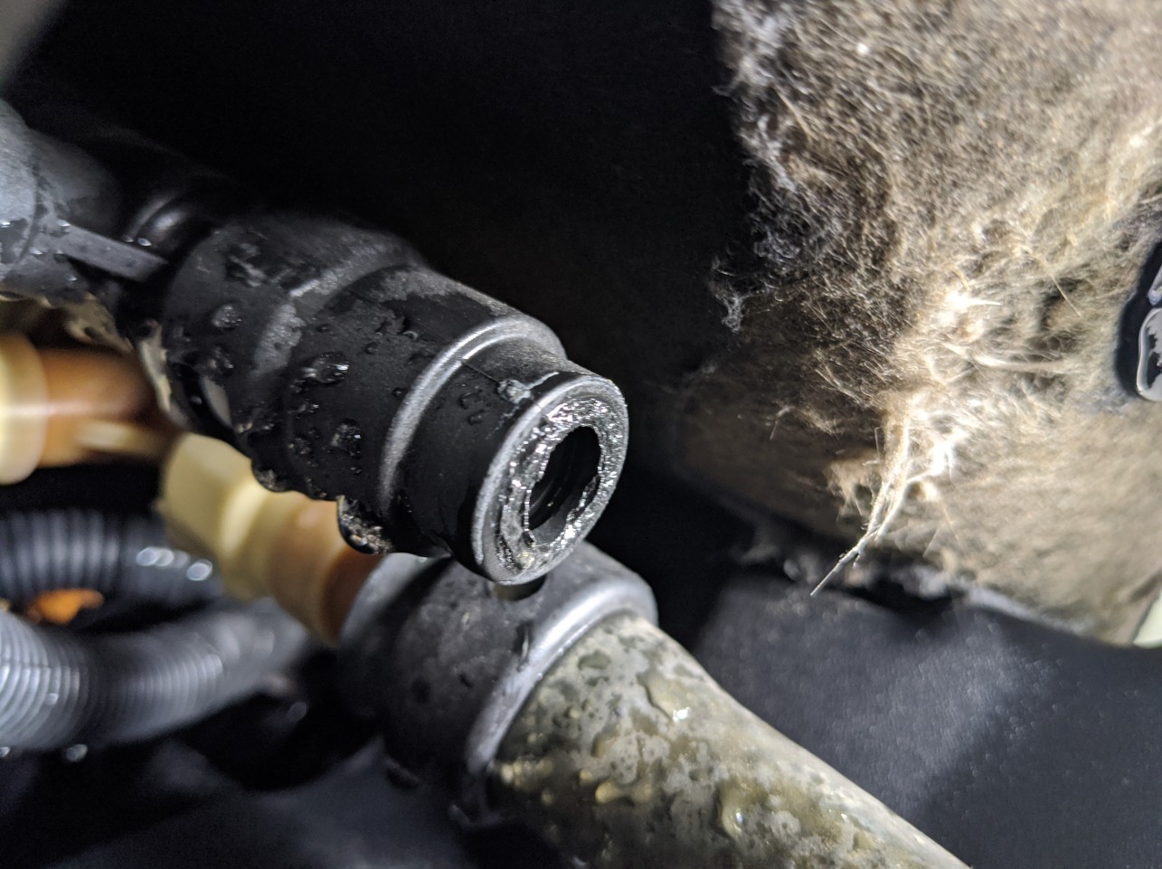

I noticed coolant dripping on my AC compressor. The heater hose is very complex with a plastic t connector that developed a stress crack. I initially thought I had a bad thermostat . This is 19 year old plastic and it was really hard to see. One side goes to the firewall to the heater core, one side goes to the water pump, and one side goes to the reservoir..

I noticed coolant dripping on my AC compressor. The heater hose is very complex with a plastic t connector that developed a stress crack. I initially thought I had a bad thermostat . This is 19 year old plastic and it was really hard to see. One side goes to the firewall to the heater core, one side goes to the water pump, and one side goes to the reservoir.. View attachment 480409View attachment 480410View attachment 480411View attachment 480412
yes over a extended period of time the Y can be prone to leaking, sometimes it only leaks in a certain pressure range
R&R both T's and both hoses and call it day

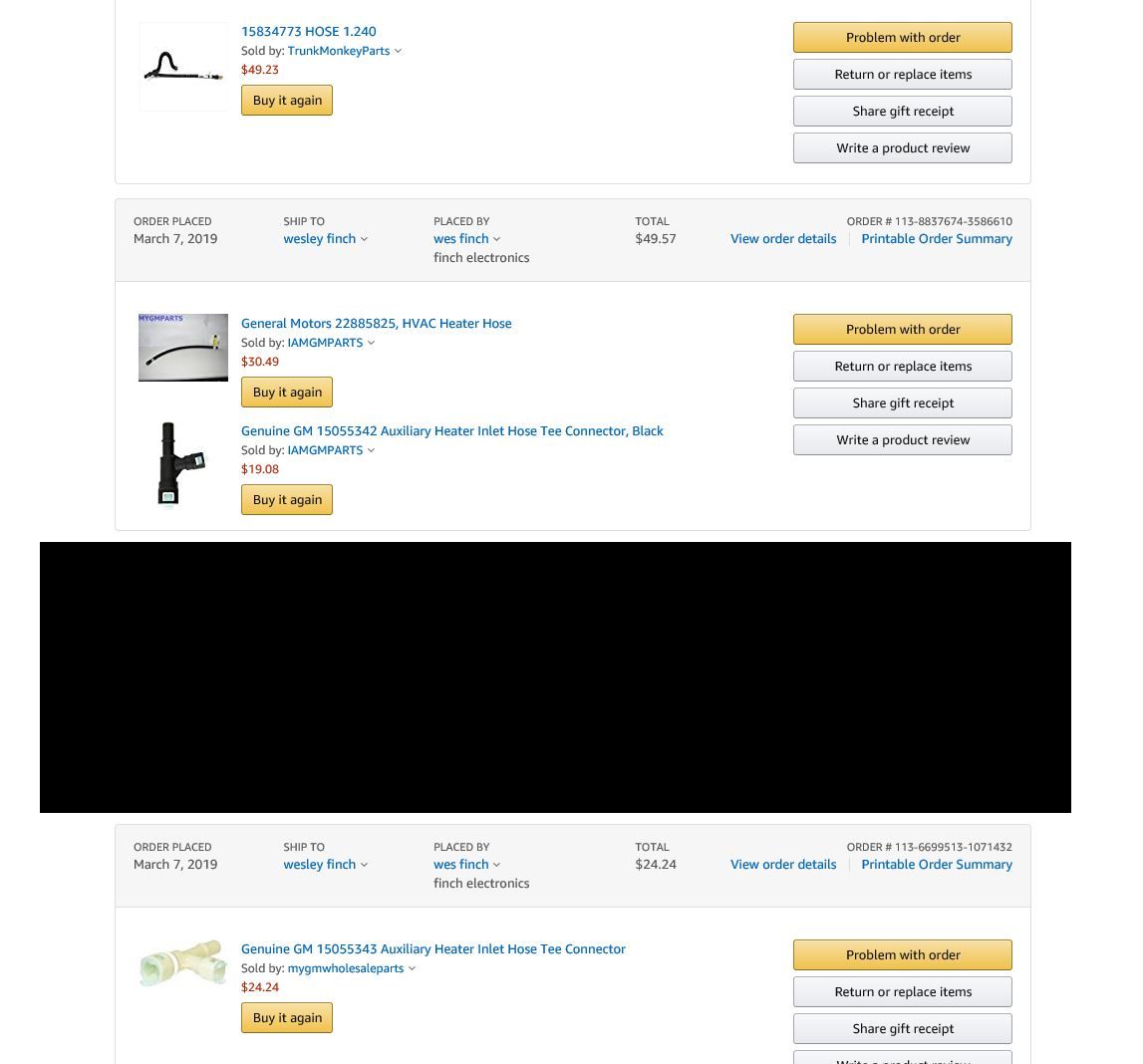

these are the oem part numbers for 00-14, for future reference the same T"s are used on 15-20 but are swapped position.

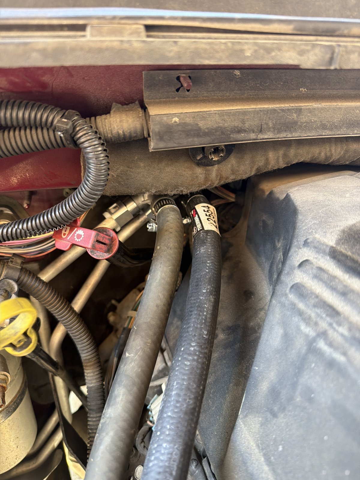

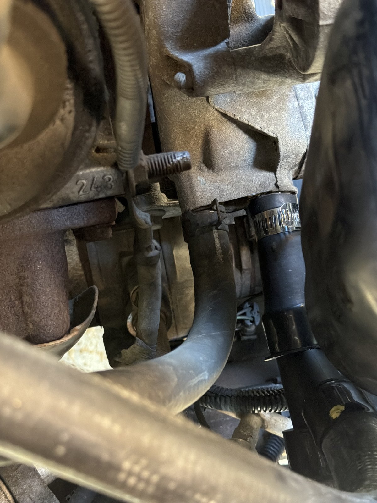

Sorry everyone, it was late last night when I made that post. I finished the job that same day with all new hoses. I was only down for the day. I wanted to get my Burb back up and running quickly. All new hoses installed. Some scratched up knuckles later.

Good job. When you say, "I finished the job that same day with all new hoses", did you mean ALL radiator and heating hoses?

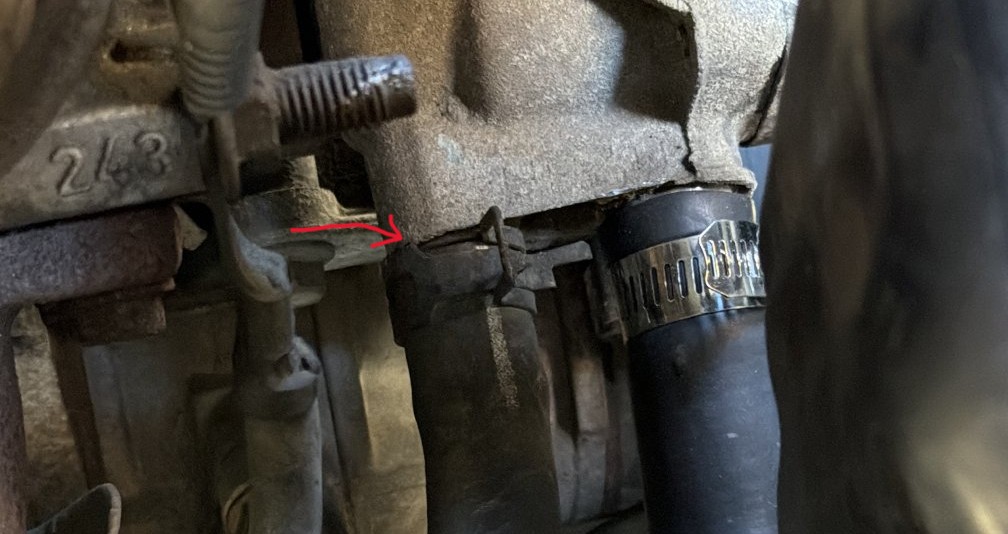

Nice, you eliminated the plastic heater hose end on firewall T.. One less part to break..
I can't imagine this would actually matter but.. I would move that clamp away from edge and closer to the bead..

I would have stuck with spring clamps but to each his own
