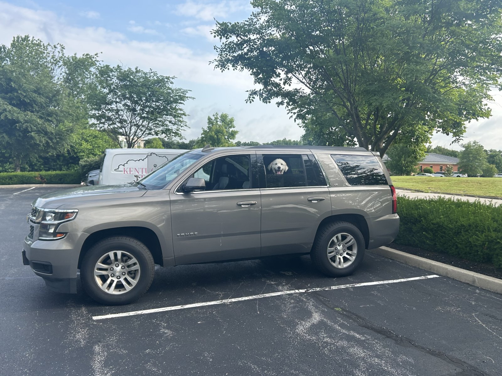

Pics of the truck, please. If we can't see it, it does not exist.

Chillerman57
Jul 3, 2026
Great to see I can use the same connectors as the gmt800/900 swapped. I was wondering about that. That dealer hose assembly by the way is $800. Thanks everyone and much much appreciated. Those funky plastic tees had my dod delete project stopped in its tracks!
