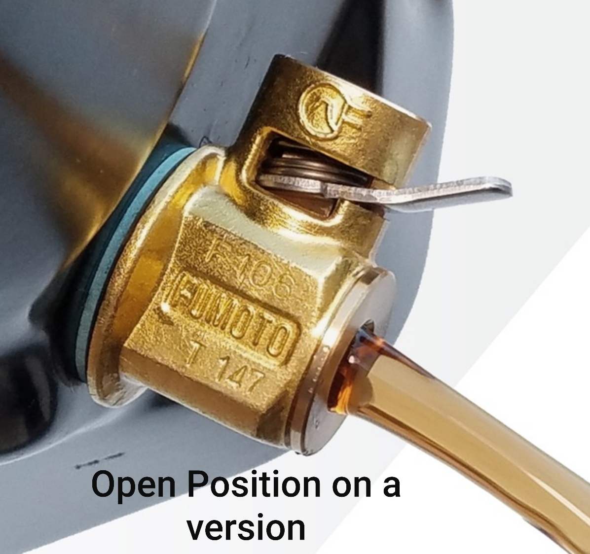

Does any use a Fumoto oil pan drain valve?
52,949
That's an interesting design. I can see it in some applications. On others, no. I like the Fumoto for it's ability to immediately stop the flow with a flick of the lever. On my truck for example, I use one gallon jugs. I'd be leary of twisting the hose/connector to stop it quickly.
I fill my Blackstone Labs oil analysis containers precisely. It flows pretty slow, it’s easy to control. Just unscrew a little bit and it closes. A gallon jug would be easy but I’m not gonna lay there and wait to fill a jug. That’s why I use a drain pan and just leave it draining after I get the sample. I come back in a half hour or so. It’s easy to put it into gallon jugs from the drain pan.

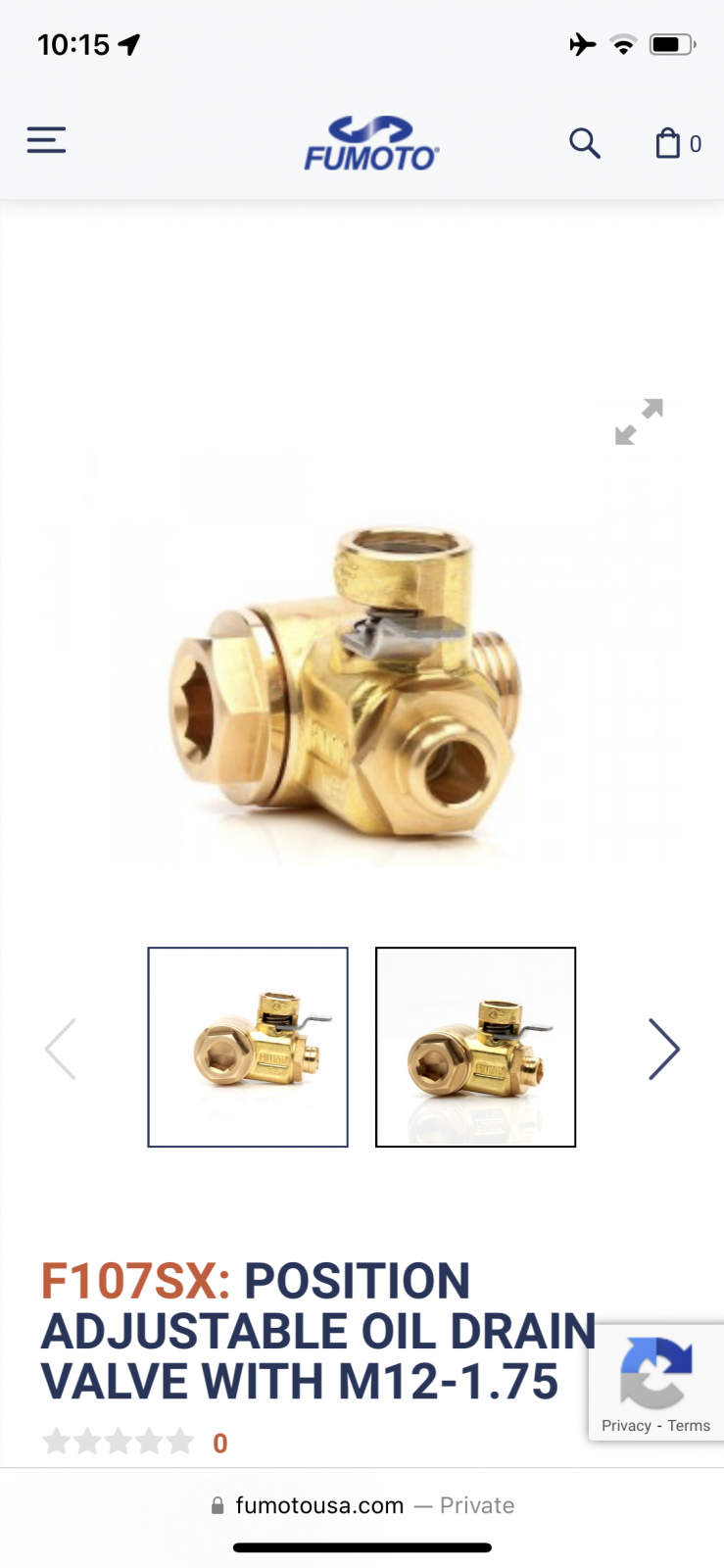

Is the 90 degree elbow version also adjustable, so you can tighten it well and also position it perfectly downwards?

I was going to order the adjustable one, it uses a banjo bolt design, which allows you to point the direction perfectly instead of where it lands once tightened down.
And because of the banjo bolt, it already points down at a 90 degree angle.
Does yours point perfectly downward?

I was going to order this one, the direction that it points is fully adjustable before tightening down by using a banjo bolt design.
And because of this, it points down at a 90 degree angle anyway.
This way it can be fully tightened and still point exactly downwards.
