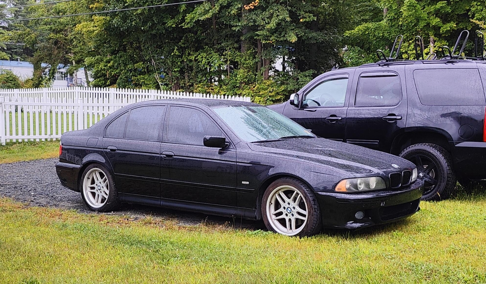

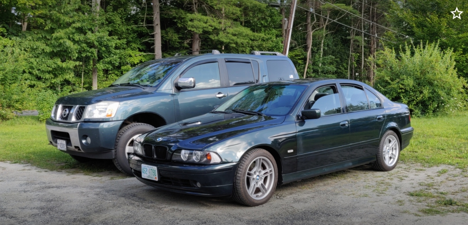

Yes, the only version worth owning. I'm on my third one now. Top was sold in TX, middle was wrecked by some skinny-jean hipster in a Duramax, bottom one is current project.

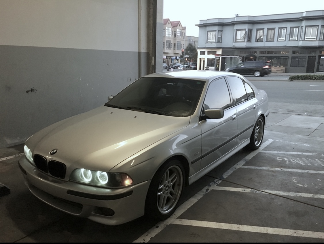

Nice! The latest one is a true M-Sport? 6spd?
Here is mine. View attachment 395254
I think it's just a clone, and I suppose I should run the VIN to see what's up, but it does have a Dinan intake and exhaust.
It's a 2001, so not a true M-Sport.
All my BMWs (4) and Saabs (7) have had manual gearboxes except that one Saab 9-5 Aero.... Sold that and bought a 5-spd Xterra.
