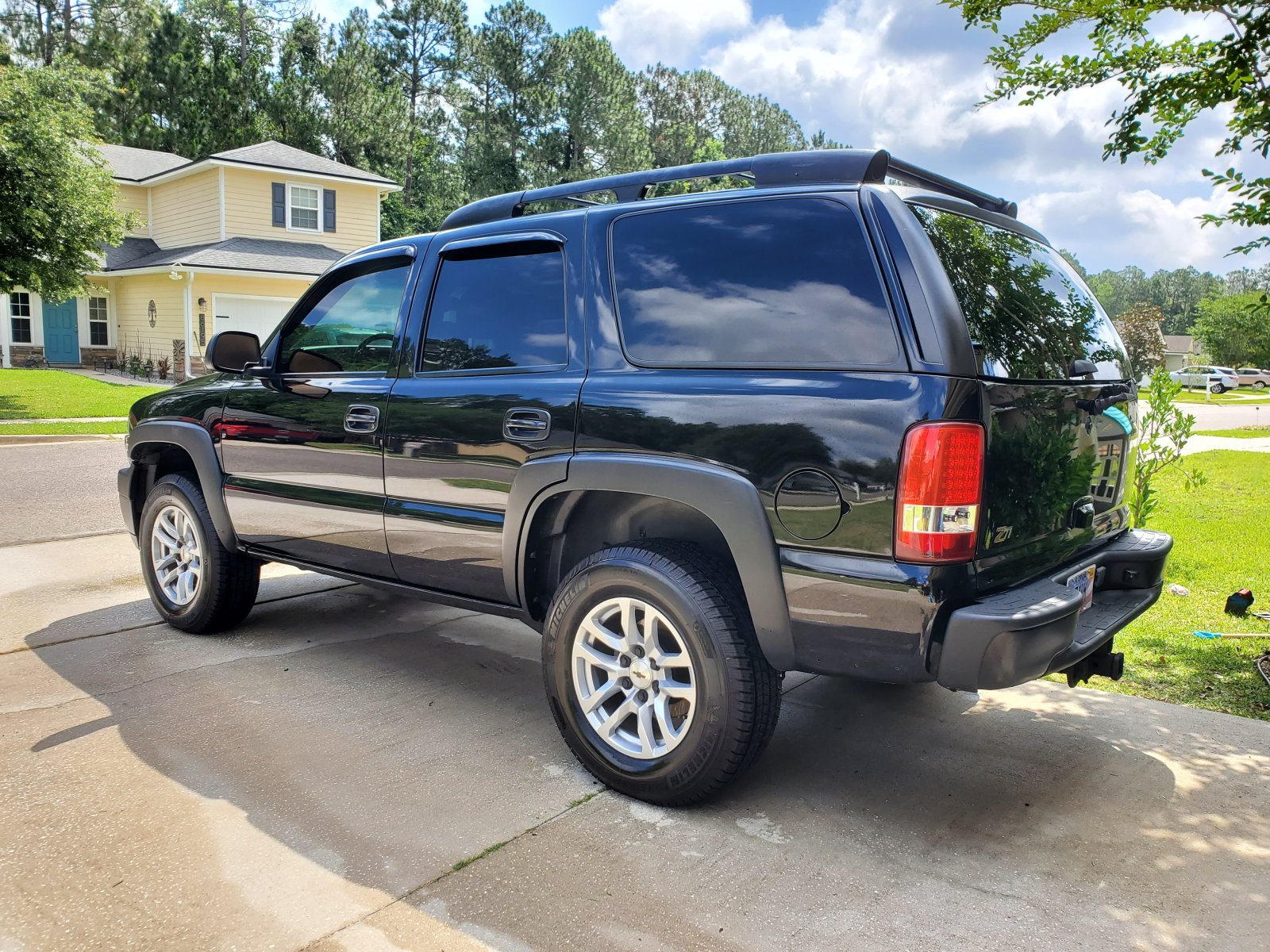

I got my tahoe back in 2010 at about 70k miles, second owner, first owners my parents they bought it new in 03. It is 2/20/23 and I have 197k and my oil pressure is solid, hangs just below 40psi at idle. Only check engine lights I have had over the years were for knock sensors, and bad o2 sensor.
I have always maintained it, oil changes and a few important corrective maintenance issues done by a shop, but the last four years I have really dove deep on her, taking care of every square inch and 80% of it with my own hands.

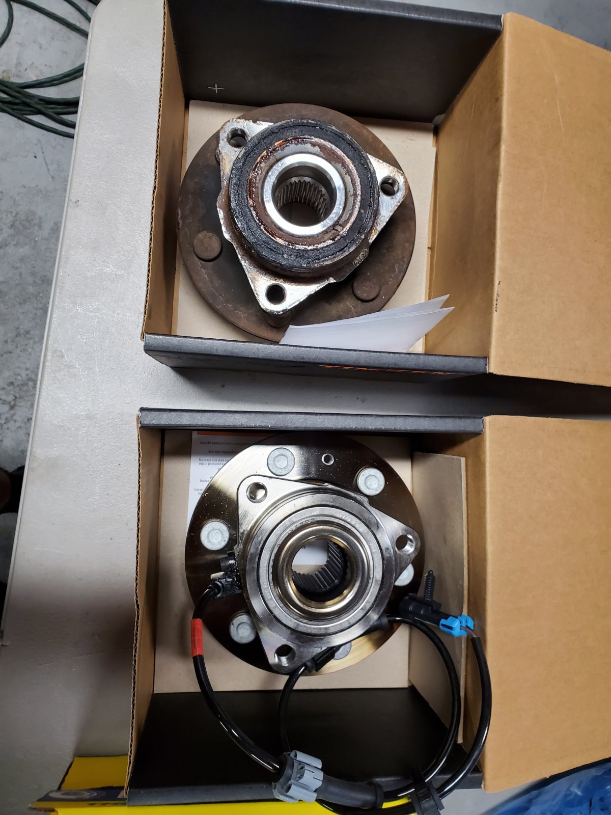

Work done by shops years back while I was in the navy: Viper alarm/remote start, fuel pump, ac compressor, front wheel bearings, blower resistor, two brake lines blew out, alternator, knock sensors/harness

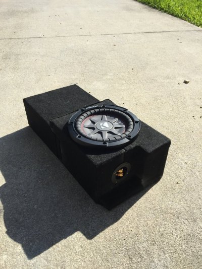

All new speakers, pioneer android auto dvd head unit, 5 channel amp under rear captain seat, capacitor under other seat, all new wiring. Most challenging on this project I gutted the center console and built my own sub box to fit an 8" kicker. Also a little hidden storage under the cup holders. Removed the factory bose sub and amp. I almost quit on the box it was so difficult but glad I didn't.

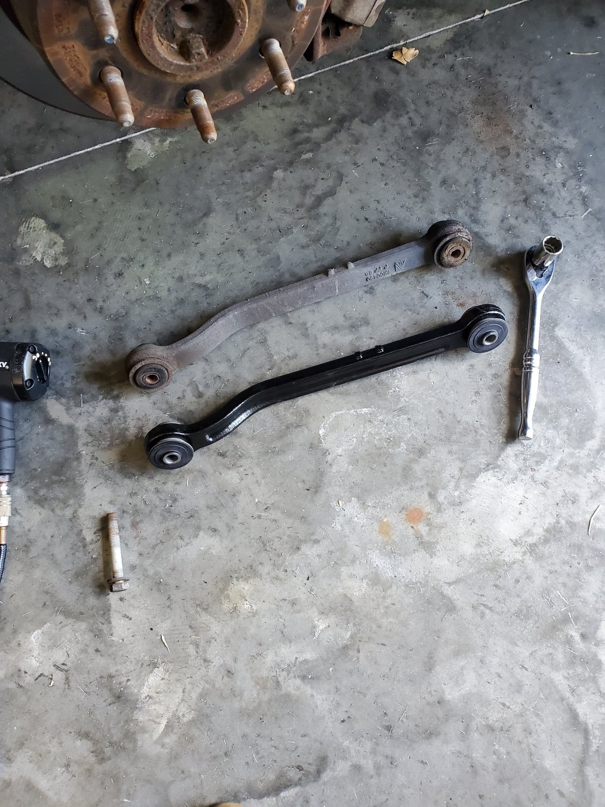

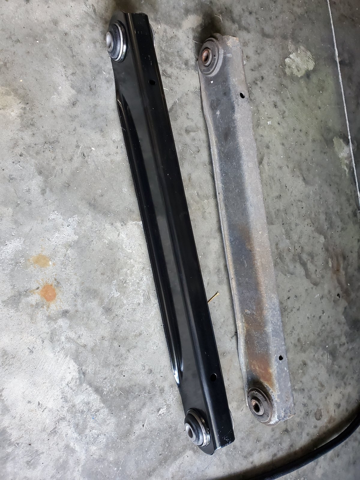

Replaced front upper/lower control arms (had to cut out pass. upper control arm, bolt seized), rear control arms, track bar, sway bar links and bushings, cv axles, bearings, inner/outter tie rods, idler arm, pitman arm, tightened gear box up a bit, new intermediate shaft and bearing, leveled on bilstein 5100, bump stops, gmt900 brakes all new calipers/pads/rotors, stainless lines replaced rubber, e brake, a few more brake lines replaced (stupid, I got the whole kit should have done all the lines at once)

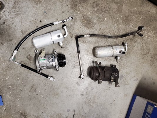

Replaced ac compressor, most of the system. Cut a hole and installed a bracket for a cabin filter. New tensioner, pulleys, belts.

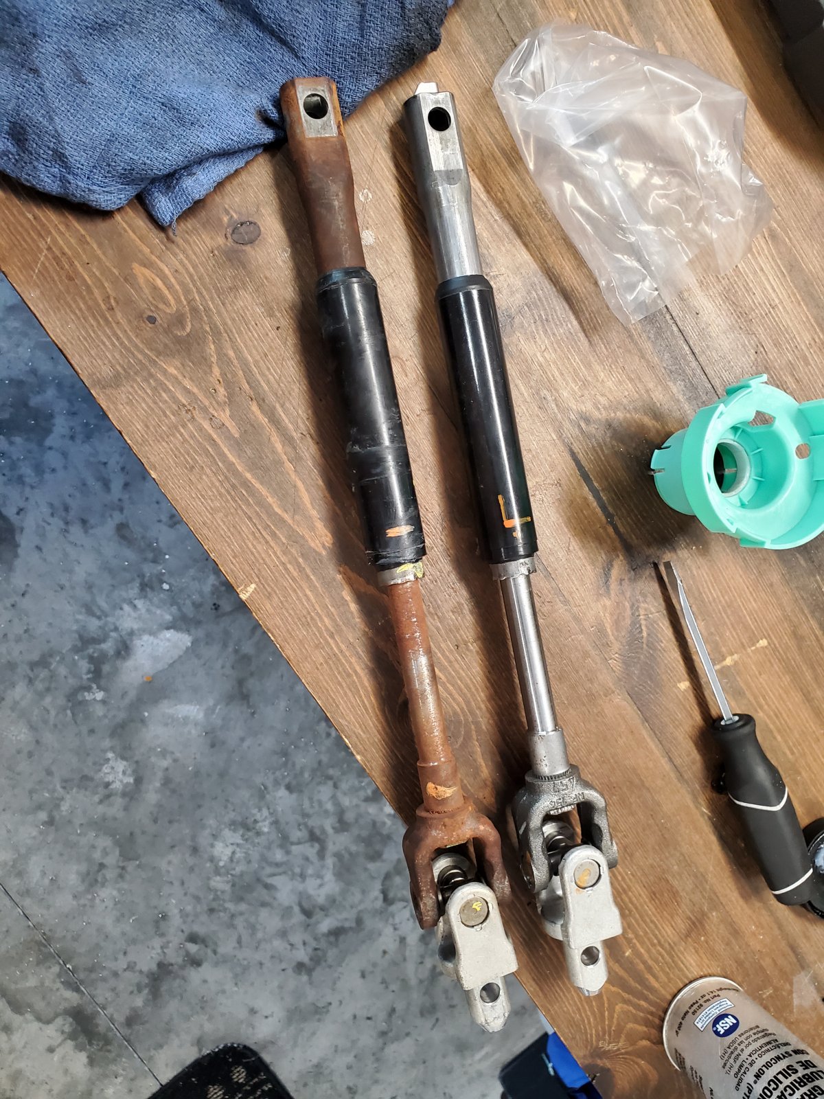

New rear main seal, cam shaft sensor, oil # sensor, rebuilt trans at the same time: replaced planetary, upgrade sunshell, hd band, hardened pump rings, oversize boost valve, shift kit, sonnax 1-2 servo, all new solenoids/bushings/molded pistons, replaced converter

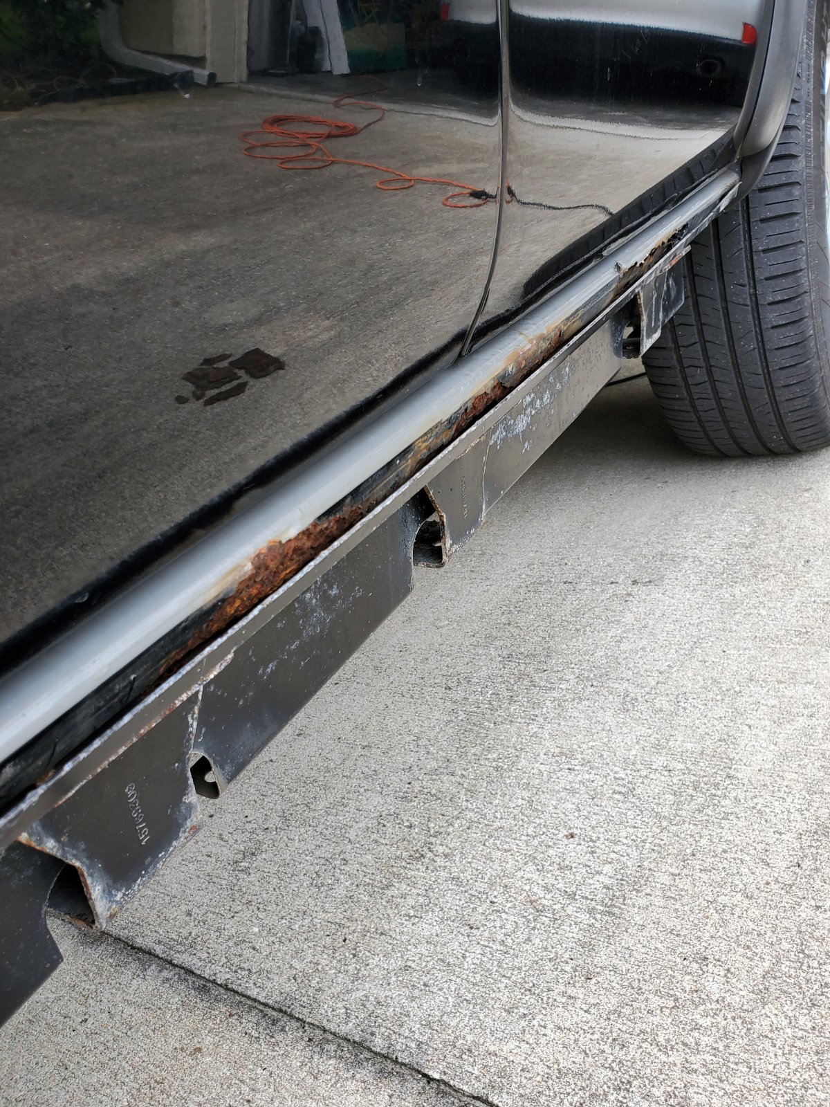

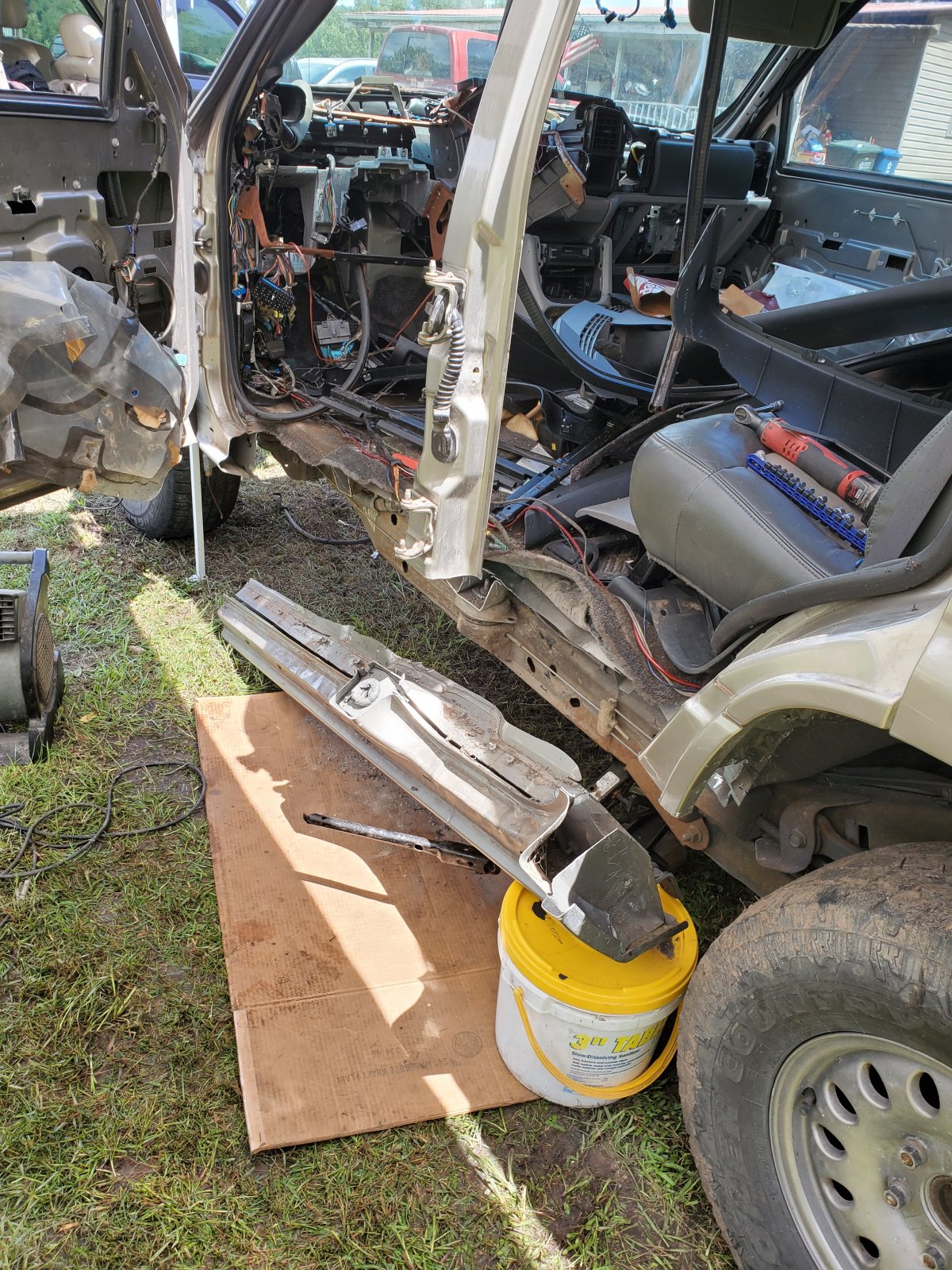

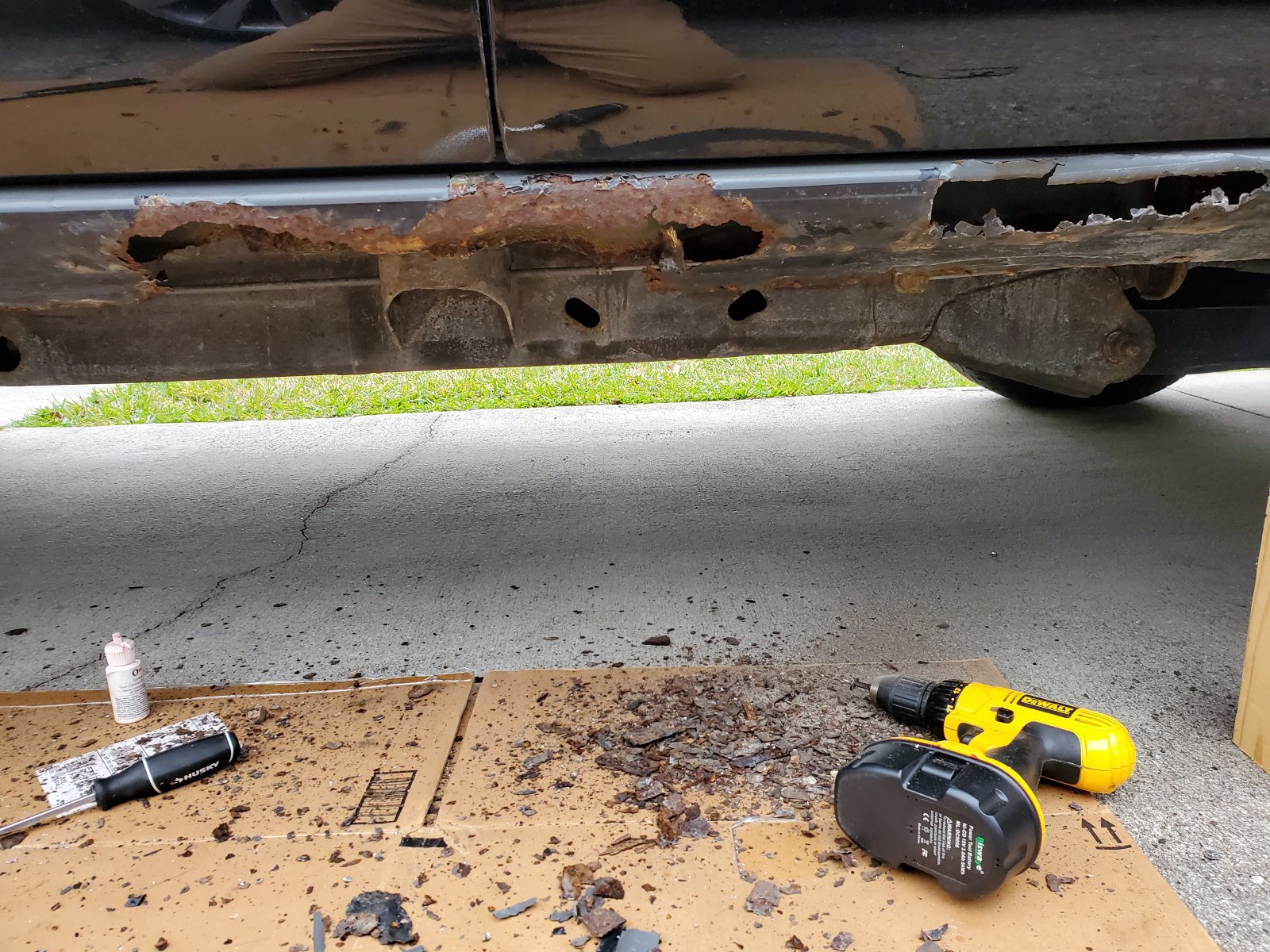

Driver side rocker major repair, cut a rocker out of a donor suburban had my dad and brother help me patch it up. Have to patch up some very small holes with rocker cover on passenger side.

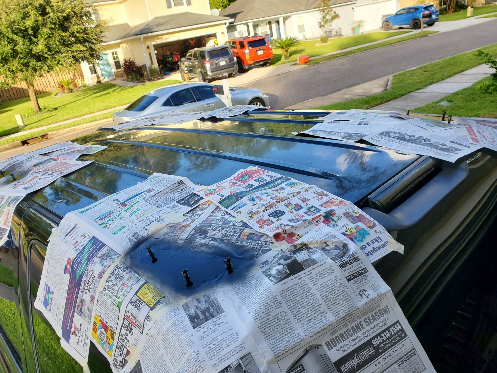

Removed roof rack and cleaned up underneath/teflon tape bolts/silicone around bolts and reinstalled.

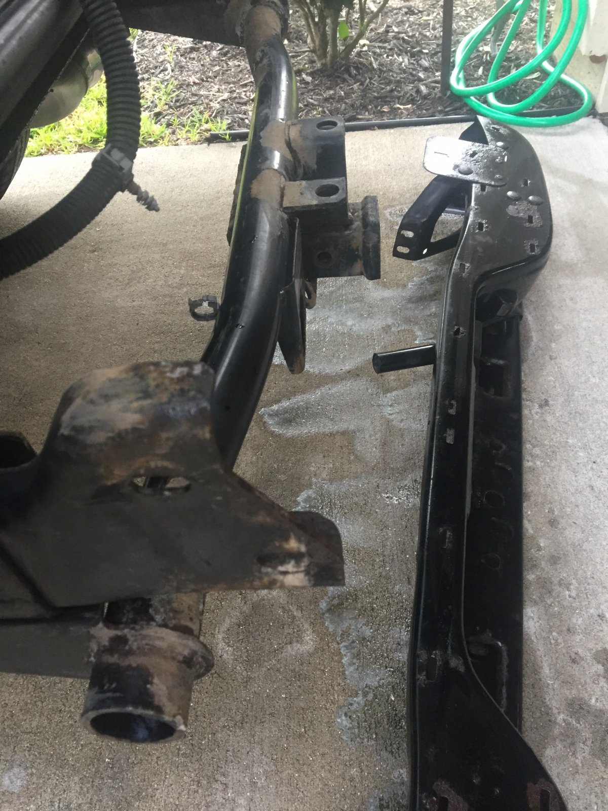

New rear bumper

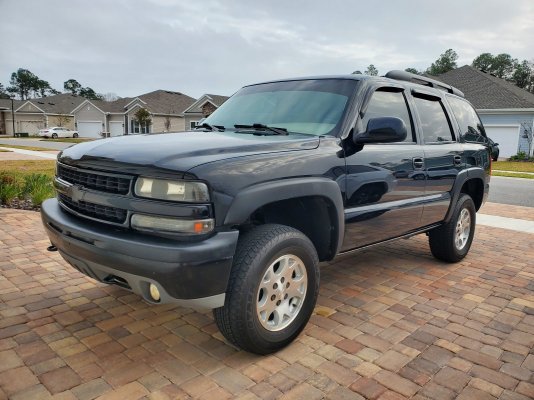

Some pics.. one a few years back, and some recently. See next posts for more random pics of projects.

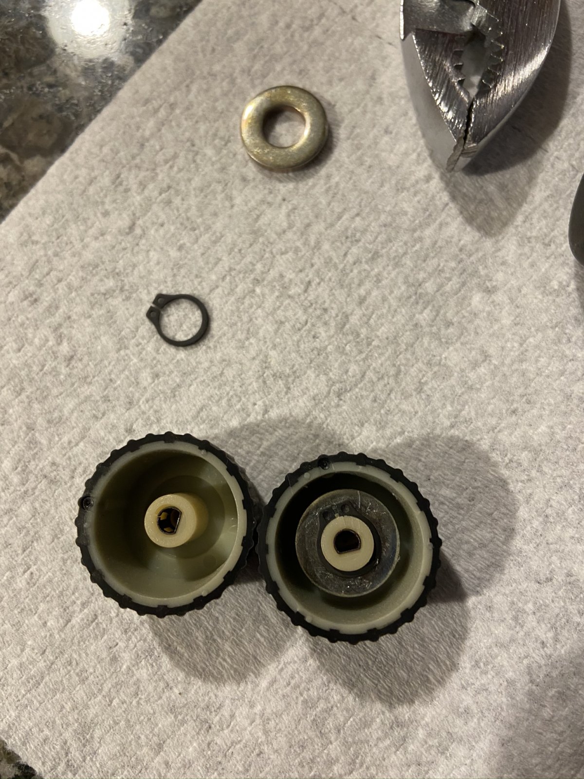

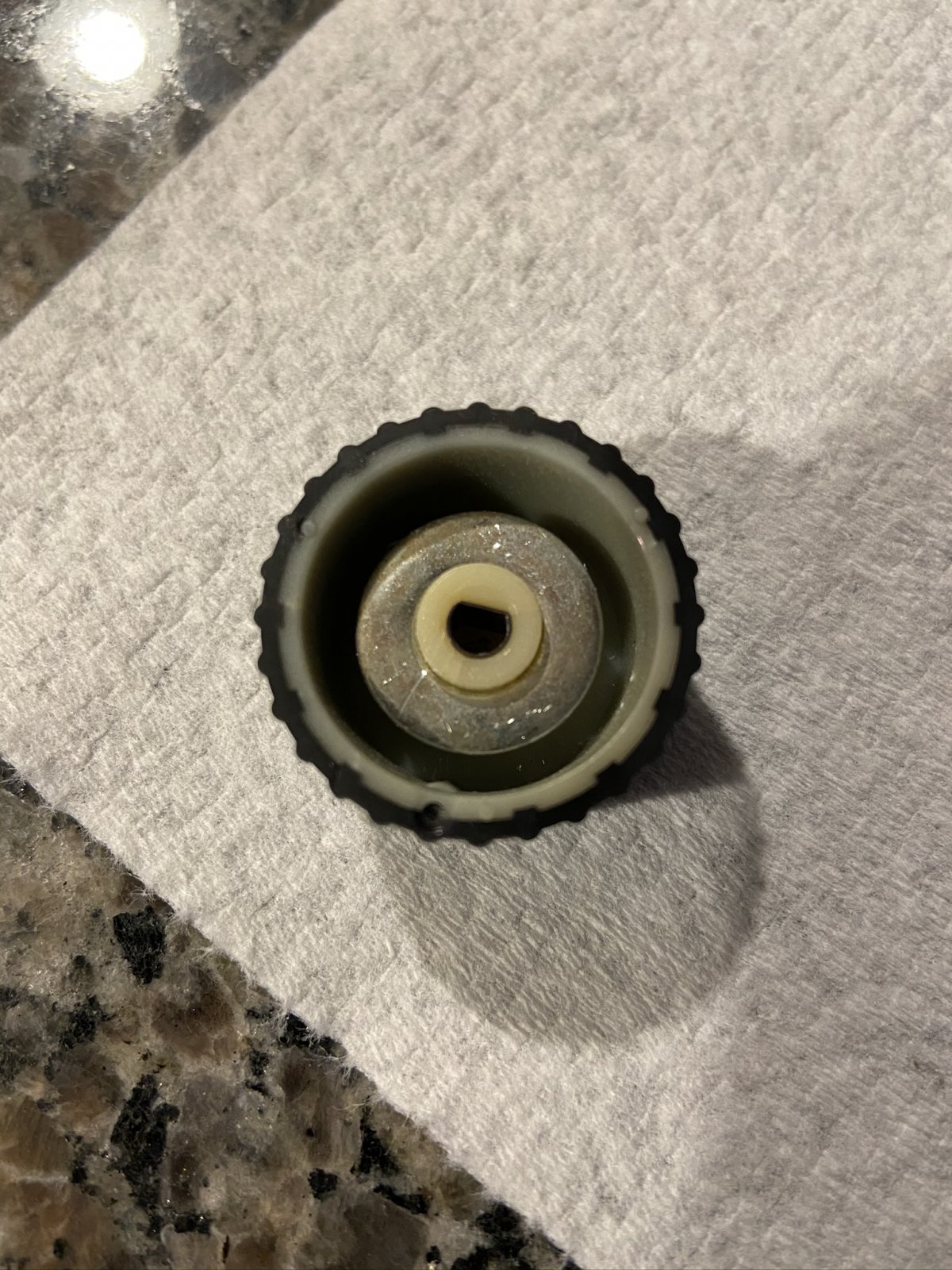

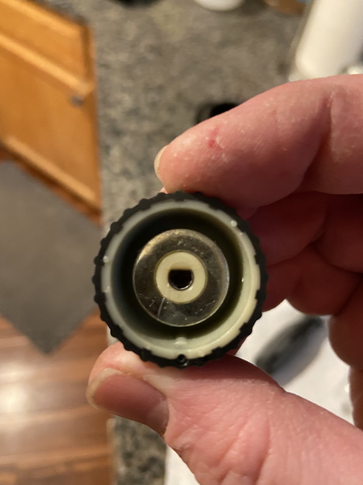

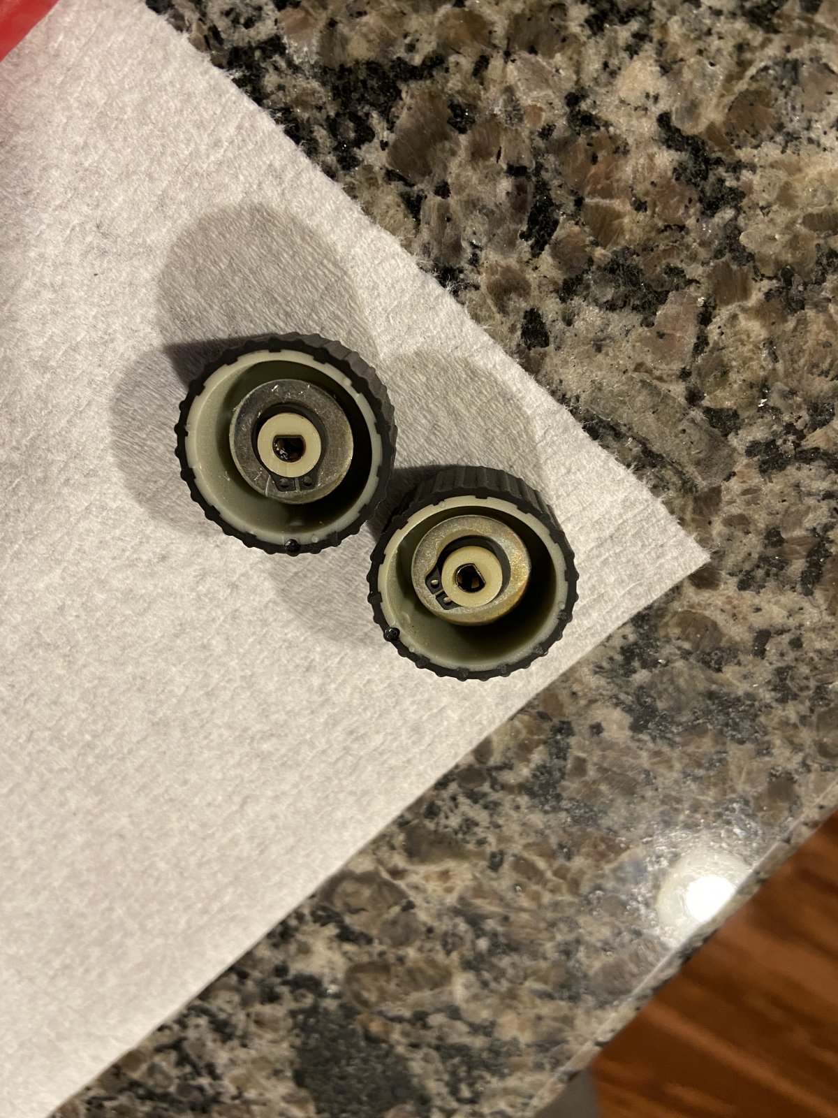

I had trouble with my digital HVAC controls sticking. Eventually, it broke the plastic inside the knob. I was able to strengthen them with a snap ring in a strategic location, just around the plastic that protrudes into the rheostat -where the real problem lies. I used electrical contact cleaner, spinning them back and forth manually many times, and it world work for a while, and then stick again.
Another member here had the idea of attaching the rheostat into his drill, tightening it down, and spinning back and forth to clean out the corrosion causing them to stick. I had already purchased a replacement Ebay control, so figured why not? And it’s worked like a charm! Contact cleaner, and high speed forward and reverse with the drill.. it’s been working perfectly since, for probably around 2 years. I’ll try to find pics of my repair as well.
ETA: to add the pics of my knobs repair:

Nice I'll definitely try that thanks. Did the cleaner a few times it worked for a short while. Using a drill now that's clever
