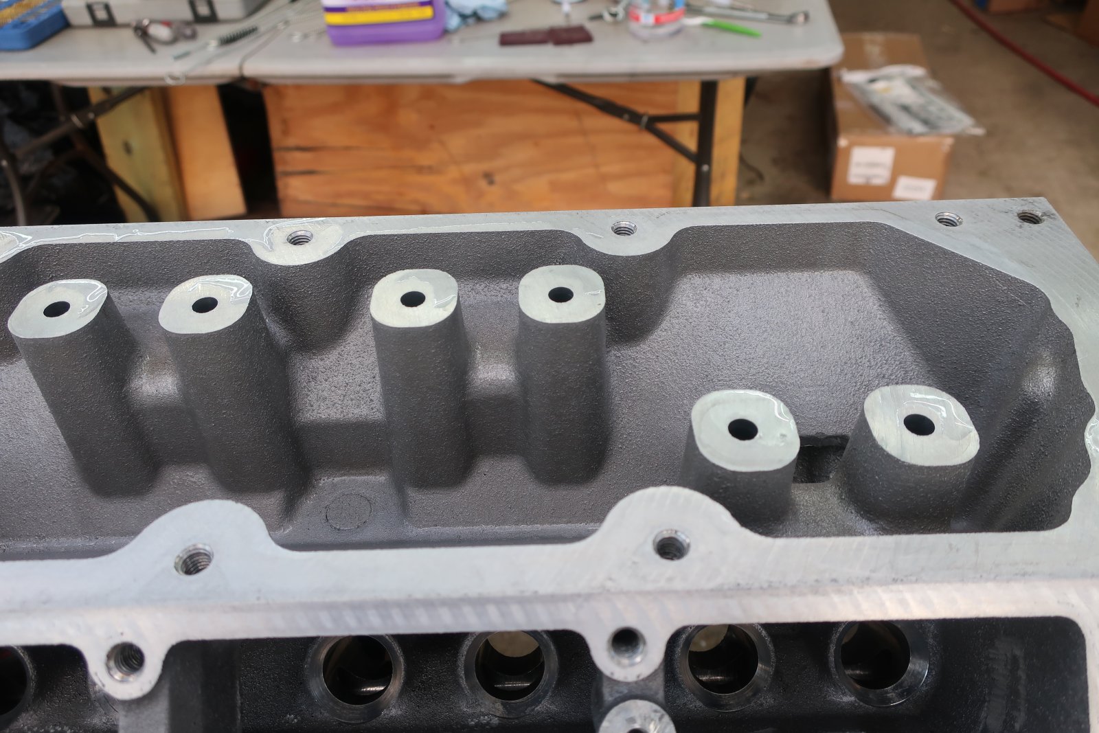

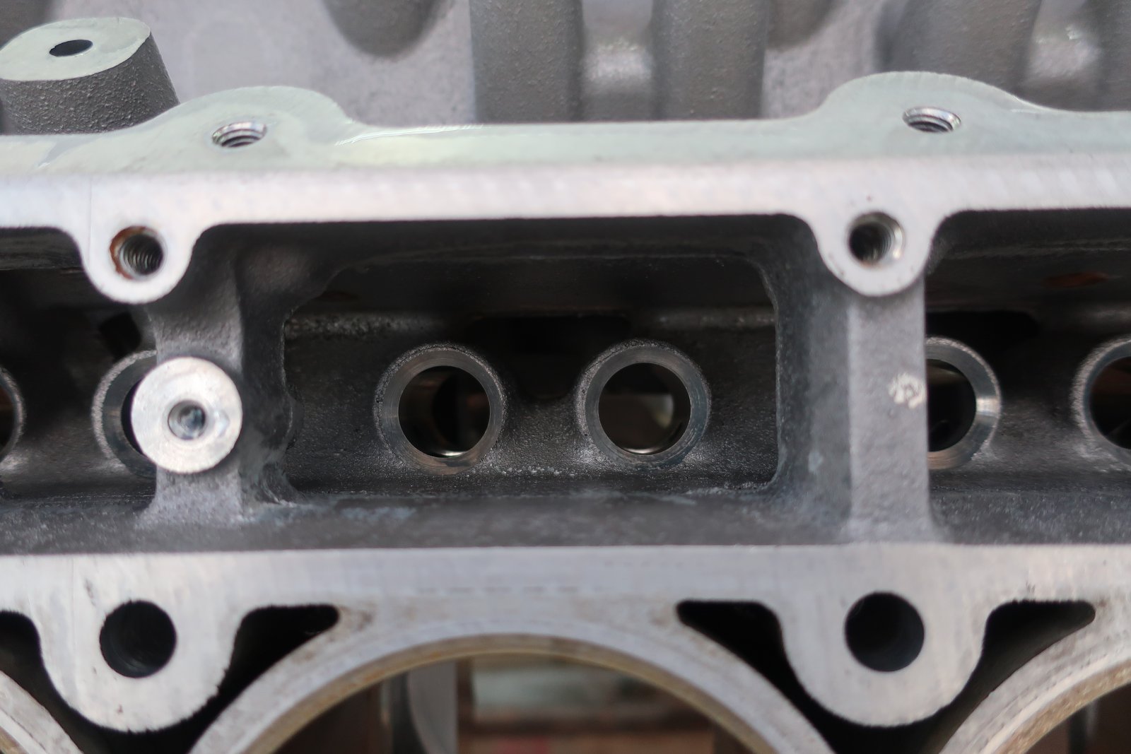

For plugging the V4 mode tower holes in the 3rd pic of your previous post.
SpareParts
Sep 17, 2023
2,122
4,827
North Idaho
To expensive. Why not use bearings or the threaded plugs for removal from Amazon?
skpyle
skpyle
Senior Member
May 15, 2021
551
1,366
Good suggestions, gentlemen.
I went with this:
Thanks!

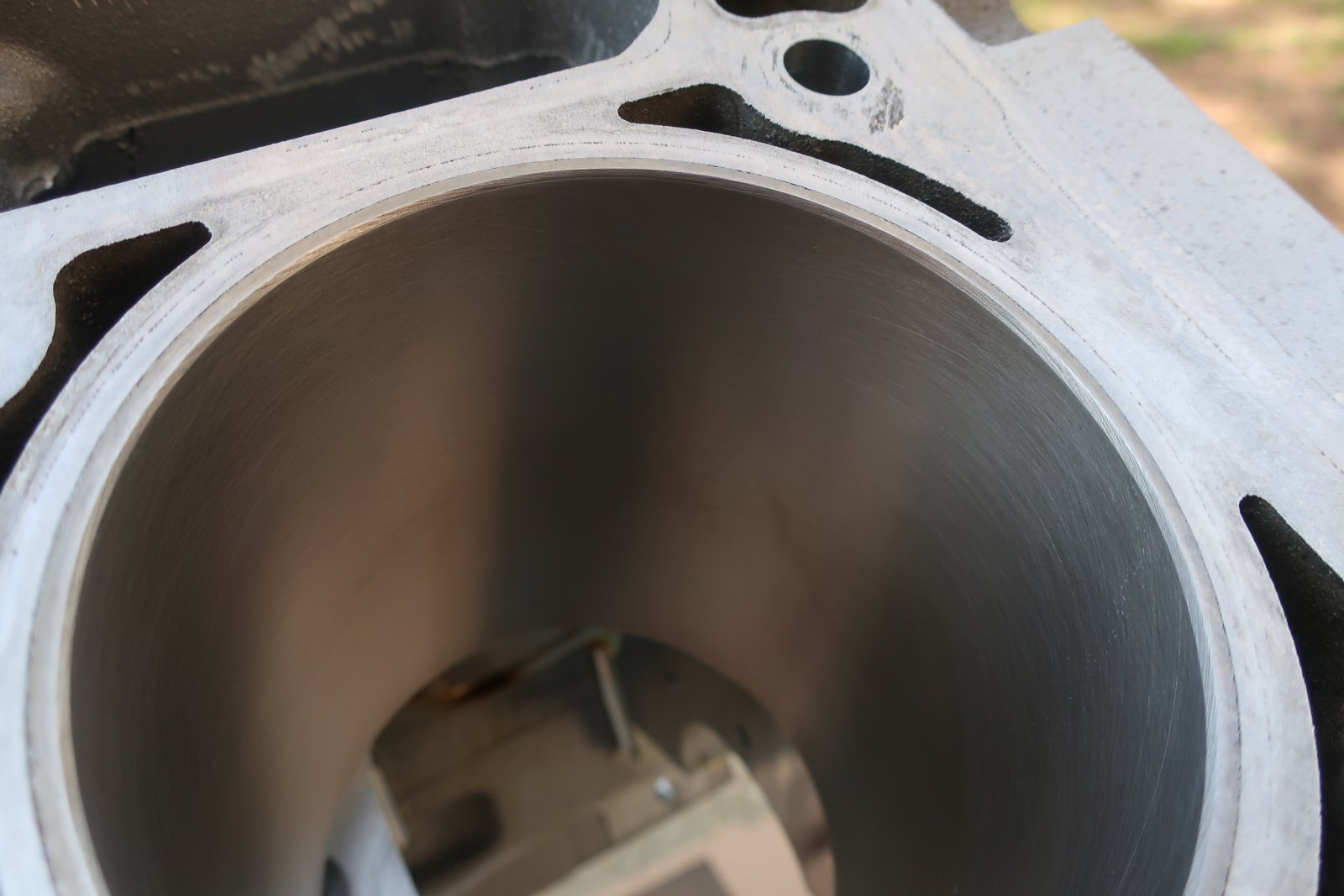

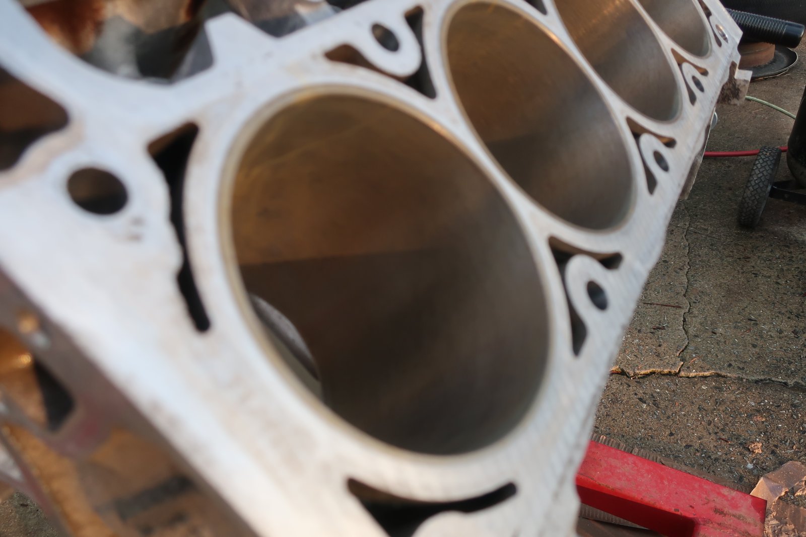

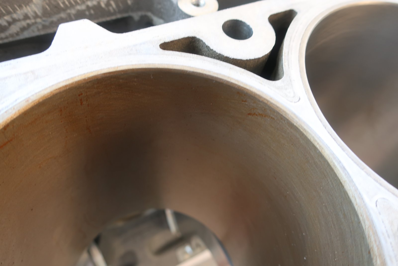

CATCH UP:
Soooooo...I did make a mistake while cleaning the engine block. I did not address the flash rust in the cylinders soon enough. I had scrubbed the cylinders repeatedly with a bore brush and the Simple Green Pro solution, followed by rinsing with hose water, followed by several cans of brake cleaner. I wanted the cylinders to fully air dry before I coated them with WD-40. I expected some flash rust that would wipe off. It did not. I used a lint free rag soaked in brake cleaner. Rag turned orange, cylinder still had orange tint.
I used red scotchbrite and brake cleaner to gently scrub each of the cylinders until the orange rust was gone. Same with the tops of the cylinder liners. Then wipe with lint free rags soaked in brake cleaner until the rag came back clean. Then wipe again, just because. Finally, thoroughly coat each cylinder in WD-40. Honestly, I sprayed pretty much the entire engine. I wasn't entirely sure if the main bearing saddles or machined gasket surfaces would oxidize.
Rusty orange cylinders. Not what I wanted.
Much better!

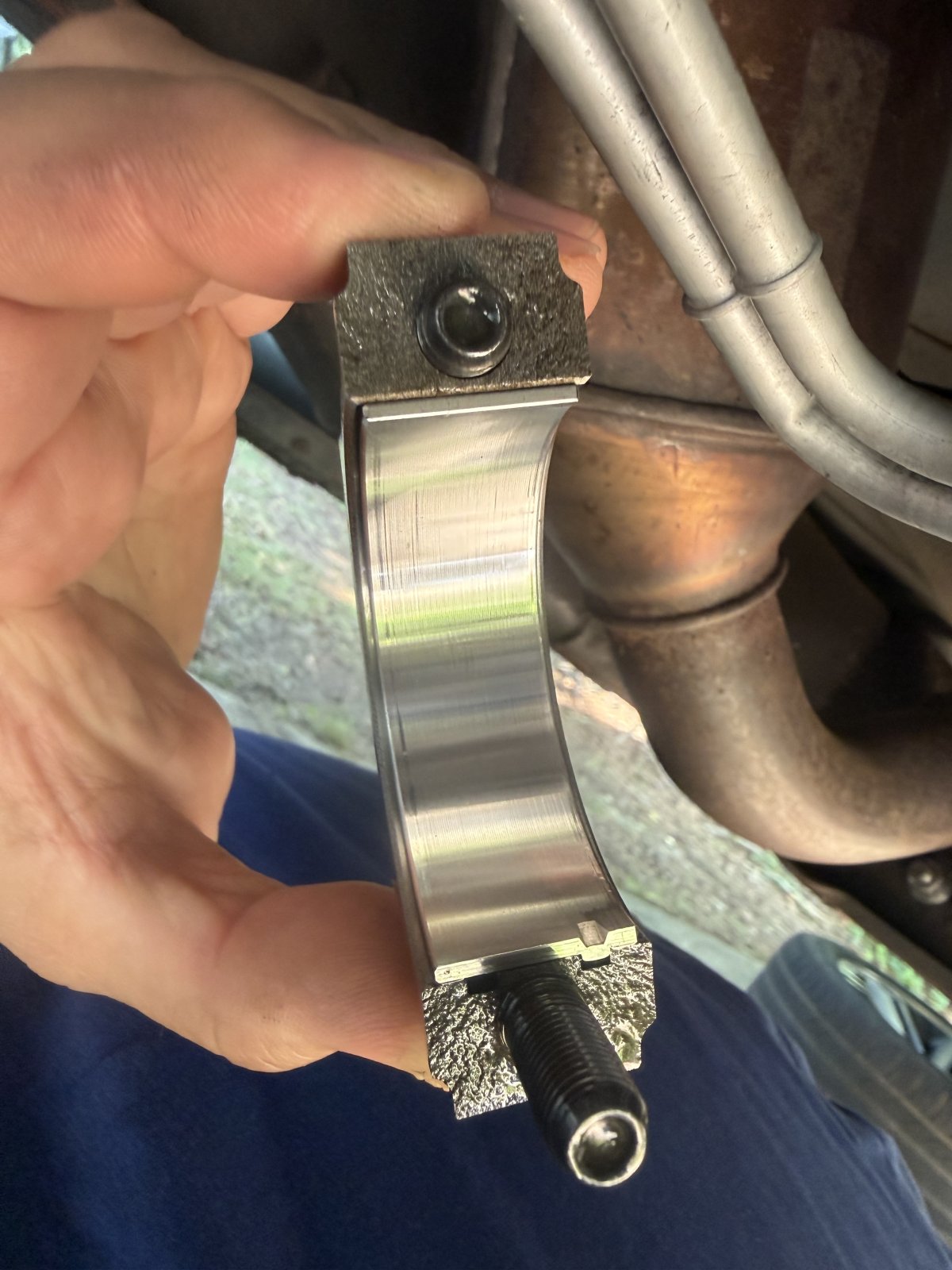

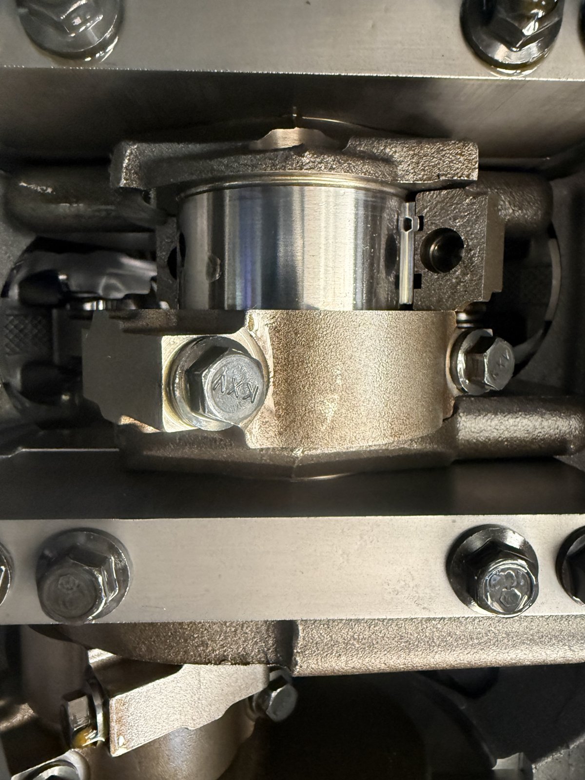

Jacked up the Escalade at all four corners. Removed the front antisway bar, front differential, differential mounts, and front cross member. Then removed the oil pan. Removed oil pump pickup tube then the windage tray. Fun fact: I had installed a double bolt girdle on the oil pump pick up tube at the oil pump. The extra bolt was a serious pan in the rear to remove with the timing cover in place...
I saw no obvious issues in the rotating assembly. No rods were dark. No rods were loose on their journals. All the rod bolts and main cap bolts were tight. Cylinder walls under the pistons were still pristine. There was no debris in the oil pan.
Rotated the crankshaft by hand through two full revolutions. Saw no issues with the rotating assembly. Checked the torque converter to flexplate bolts, they were tight. The flexplate was tight on the crankshaft.
Crankshaft thrust clearance at #3 main bearing was still 0.004", same as I measured during assembly. Thrust bearing flanges showed no obvious damage.
One by one, I removed all 8 rod caps. Bearings and crank journals were undamaged. Cleaned rod bolts and holes in the rods with brake cleaner then dried with an air blower. Reinstalled the caps and bearings with a blop of assembly lube, then torqued the rod bolts in accordance with the service manual.
NOTE: I used new GM rod bolts during assembly. They can be torqued up to 3 times. This was the third time. I will install all new rod bolts once this all goes back together. I reassembled them now for a possible test run later.
I did NOT remove any main caps. Based upon what I saw with the rod bearings, I don't necessarily think there is anything wrong in the bottom end of my 6.2L engine now.
