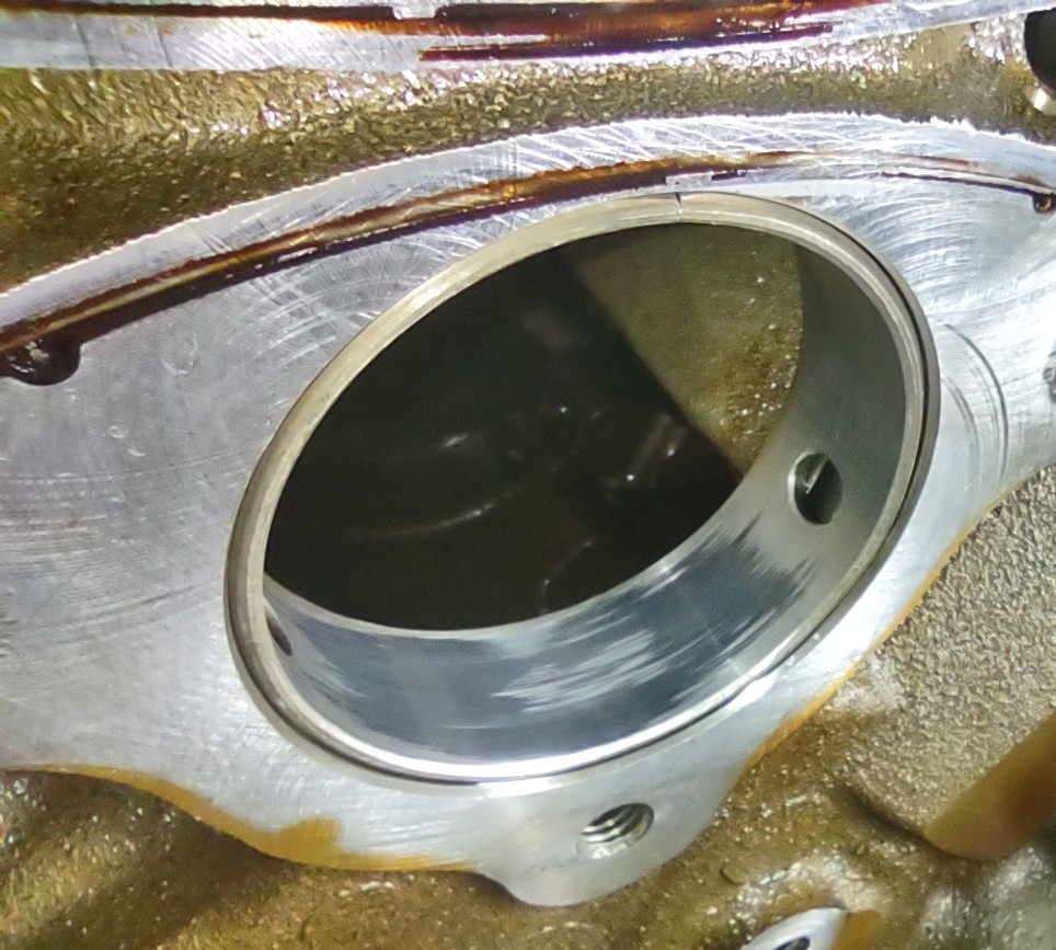

However. Where did the metal chunks go from the failed roller?

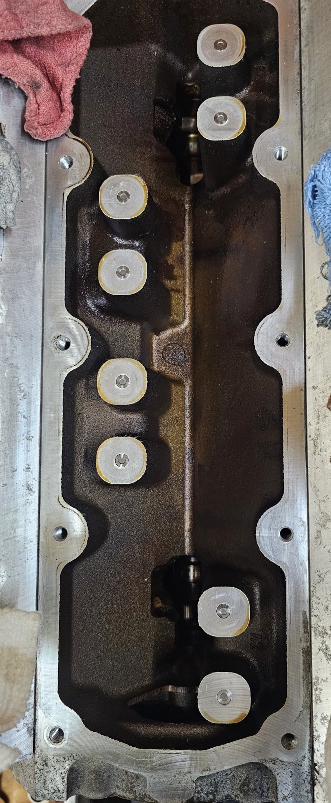

As well, during disassembly, I saw two things that concerned me:
1) there were chunks of crud on some of the rocker arm trunions. I don’t like this.
Chunk of crud is bad juju. It does not seem metallic.
2) some of the upper row head bolts under the valve covers had a film of gray ‘antiseize’ on them after removing them. I broke the head bolts loose with a breaker bar, then ran them out with my battery impact. This may just be the oil on the bolt heads being agitated by the sockets.
I cannot find any similar gray film on any surfaces of the heads under the valve covers.
Two head bolts at left and middle have gray film on the heads. Bolt at right has had its head cleaned.
Gray film doesn’t show up well on camera, sorry.
Inside surface of passenger’s side cylinder head. Looks clean enough, no gray film. I am paranoid, though.
My point is that I now have a burning desire to get a look at one rod bearing and one main bearing. It is nagging in my head that the gray film is bearing material.
I watch ‘I Do Cars’ on youtube too much…:Big Laugh:

This is what you want to see when you pull the camshaft. This is an L94 getting an AFM delete at about 175,000 miles. It had regular oil changes, never more than 5,000 miles. If you see this, the bottom end is good to go.
gwoods71
Sep 23, 2025
22
19
What is the exact characteristics that we are looking for? Just the usual clean wear w/out gouging on the cam bearings?
