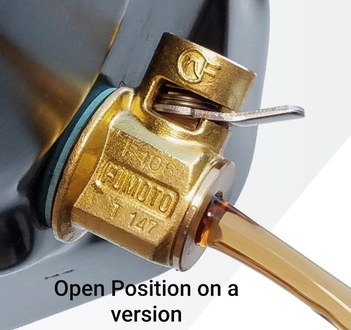

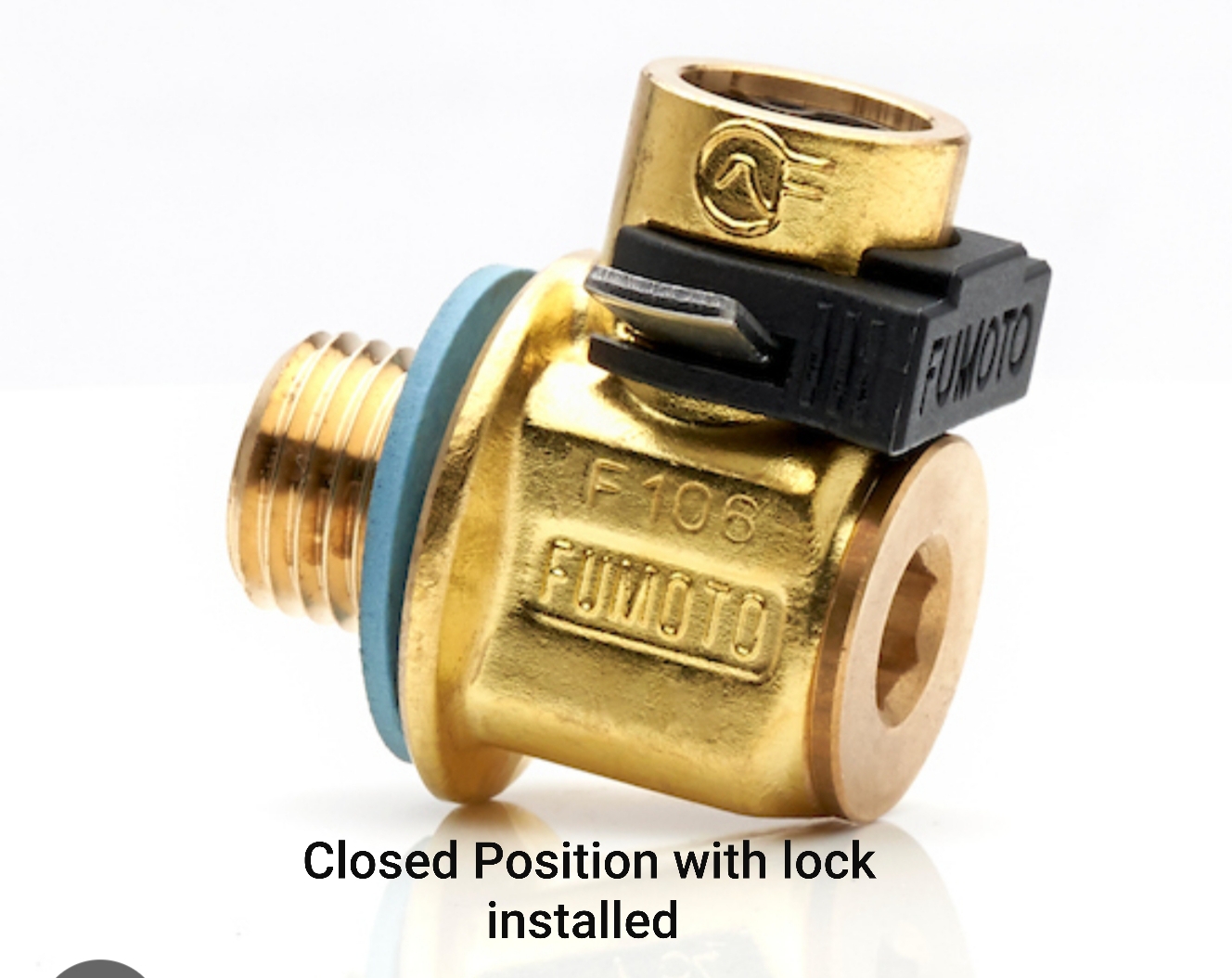

Big fan of Fumoto Valves. Never been easier and cleaner draining oil. I had to replace the little plastic lock on one because it broke when I removed once but it wasn't costly and easy to get. What can be easier than flipping a little lever?
Could that plastic lock have caused a leak?
No it's just a secondary almost redundant "safety". Since the lever is spring loaded and catches in a groove, it takes a good amount of pressure to push it out so it can be rotated into the open position. The little plastic lock just makes it impossible to push the lever out to rotate it.
