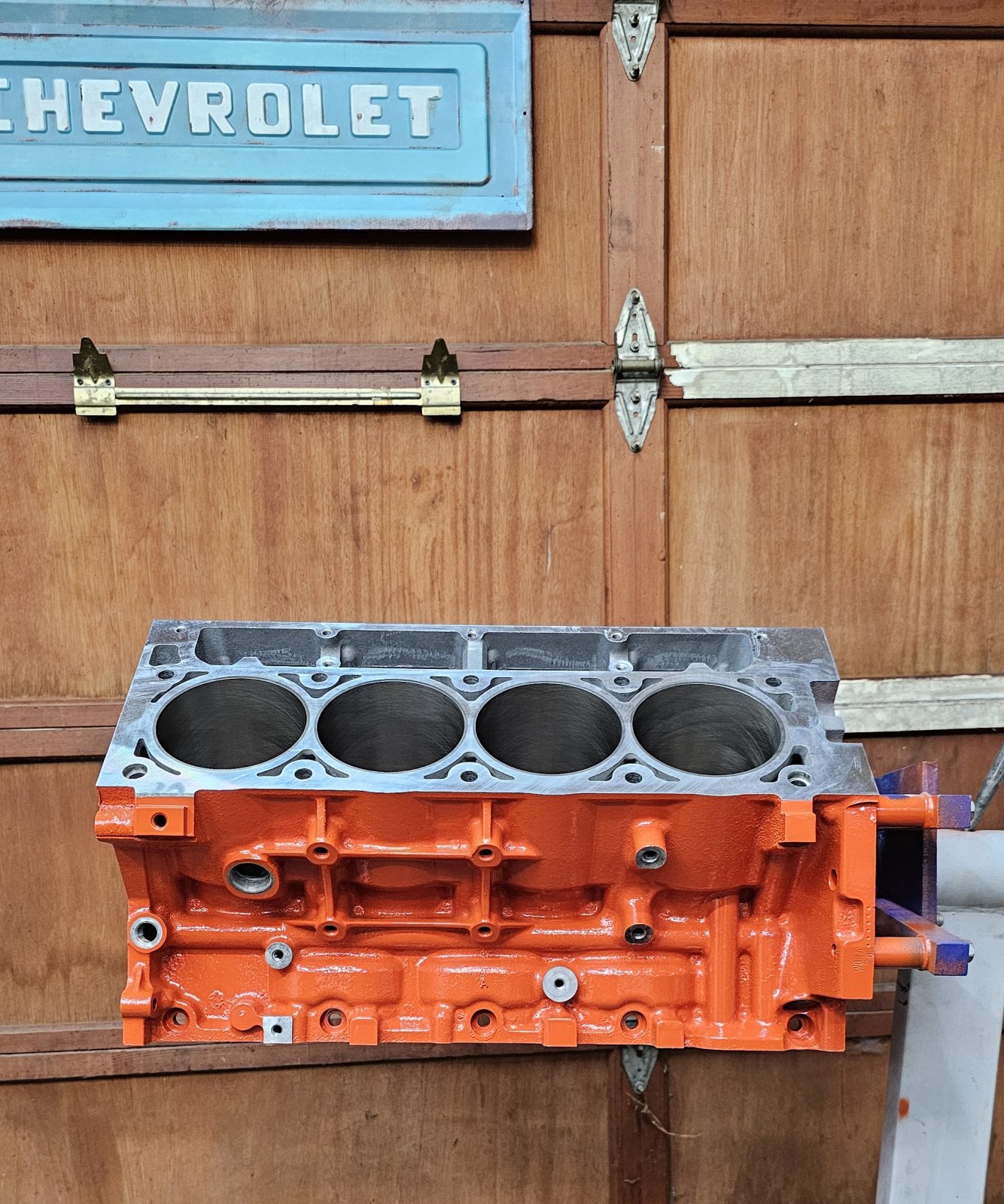

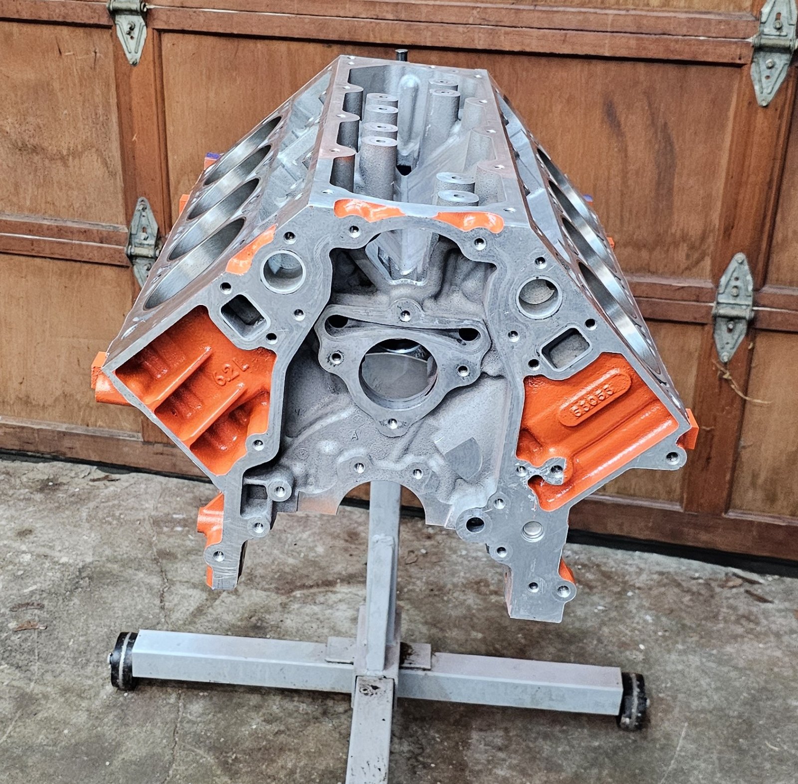

Could not help myself and wanted it painted.

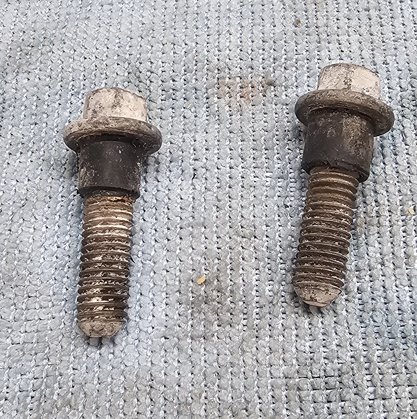

Anyone know where these two bolts go?
I can not recall where they would go.
j91z28d1
Feb 28, 2022
4,655
5,900
look like exhaust bolts to me with that shoulder? but I can't say forsure, haven't taken one if these that far down yet.
SpareParts
SpareParts
Sep 17, 2023
2,113
4,805
North Idaho
Not exhaust bolts. The black part covering the threads is like plastic.
mikez71
Mar 9, 2023
3,340
4,146
The plastic sleeve on the bolts doesn't look completely squared off.
Did they break off of a plastic part as they were removed? (if they're stuck on the bolts good)
That said I still have no idea where...
You sure they belong to this truck?
SpareParts
SpareParts
Sep 17, 2023
2,113
4,805
North Idaho
That's the way they came off of whatever.
I'm pretty sure they came off this engine and i have tried to keep all the bolts/nuts that came off this engine together in one spot but then again i do have parts for 3 ls engines in the garage.
I'm pretty sure i did not put any bolts in the bin that did not belong to this engine.
PatDTN
Jul 5, 2016
632
465
If they looked like they were coated in oil I'd think windage tray.
Instead they look dry and chalky. They look like they're subjected to dry heat. Is there any chance those spacers are not plastic and could be exhaust manifold?
