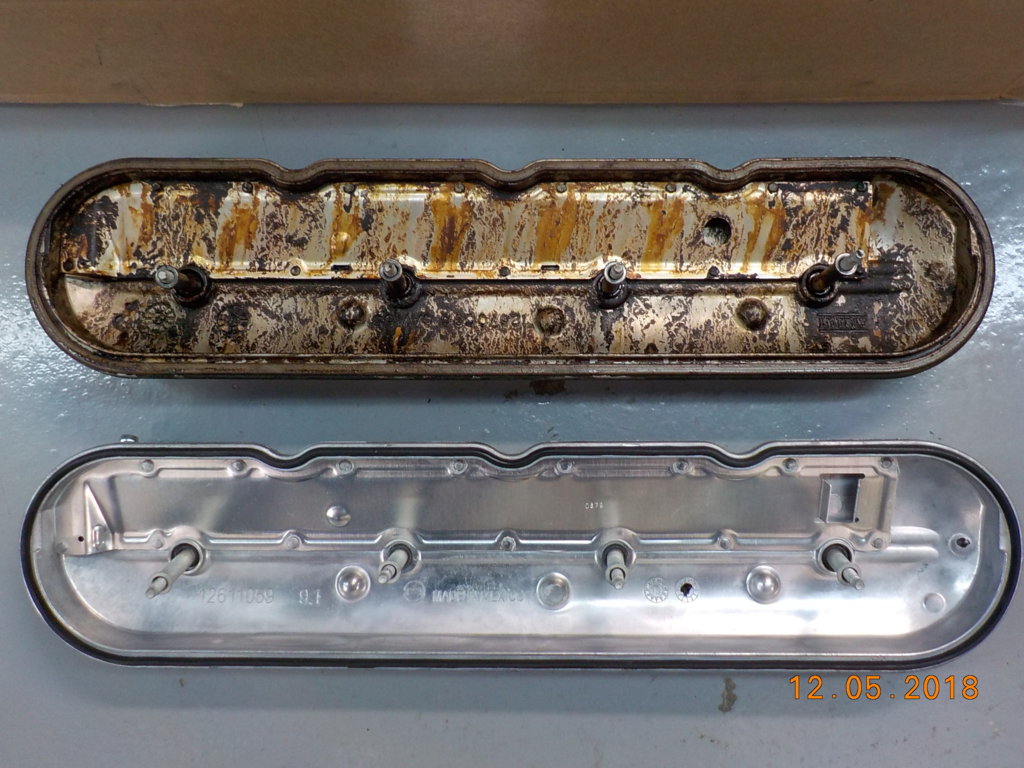

To eliminate the oil in the intake problem the new improved driverside valve cover is a must: https://static.nhtsa.gov/odi/tsbs/2014/MC-10114272-9999.pdf
Here's my ole ds vc and the new improved:

I mentioned the oil in the intake as a reference to blow-by but some is normal with high miles and the old style valve cover.
Installing the "improved" valve cover is critical for reducing oil consumption.

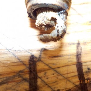

Bought our 07 Denali w/L92 in 2013 w/130k miles it was burning at least 1 qt of oil per 100 miles (see spark plug pics). I completed the TSB TSB 10-06-01-008M and all these yrs and 71k more miles later it never needs oil any makeup oil.

The plugs are pretty bad for sure.
