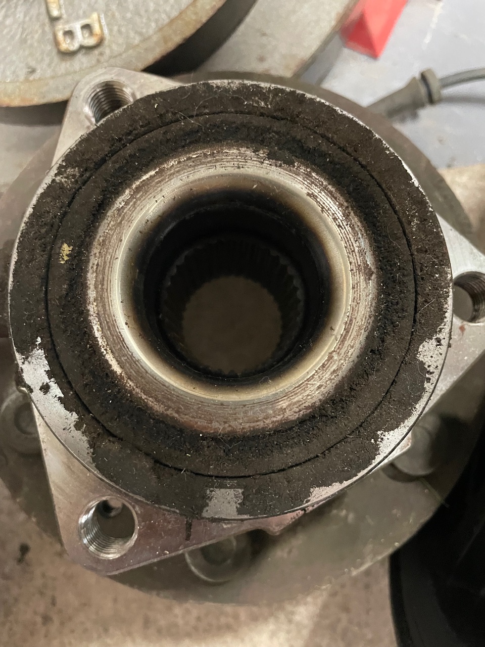

...These were an improved design with protection for the back of the hub.
Neat, I remember thinking the back of my 15k mile front wheel bearings was pretty filthy dirty already..
And wondered if the dirt contributes to earlier bearing failure..
Don't pressure wash back of hub/axle interface. Scared to drive through puddles now..

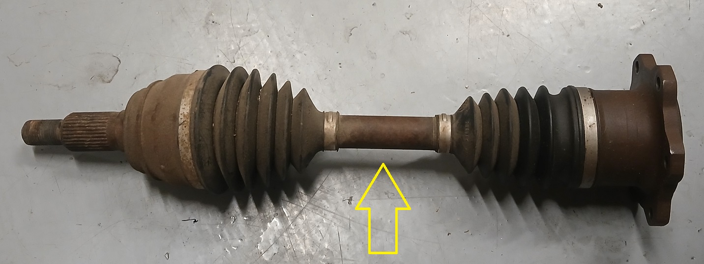

The diff side looks weaker. On another note the diff side moves more freely.. the wheel side offers up considerably more resistance.
I assume these break at the knuckles for the diff side?
The axles themselves are rough machined on the neck where it tapers down to the splines (darker gray). They effectively created stress risers in the machining process. If a person wanted they could strengthen these by cleaning up that rough machine work.
My guess is the shafts don't break though?

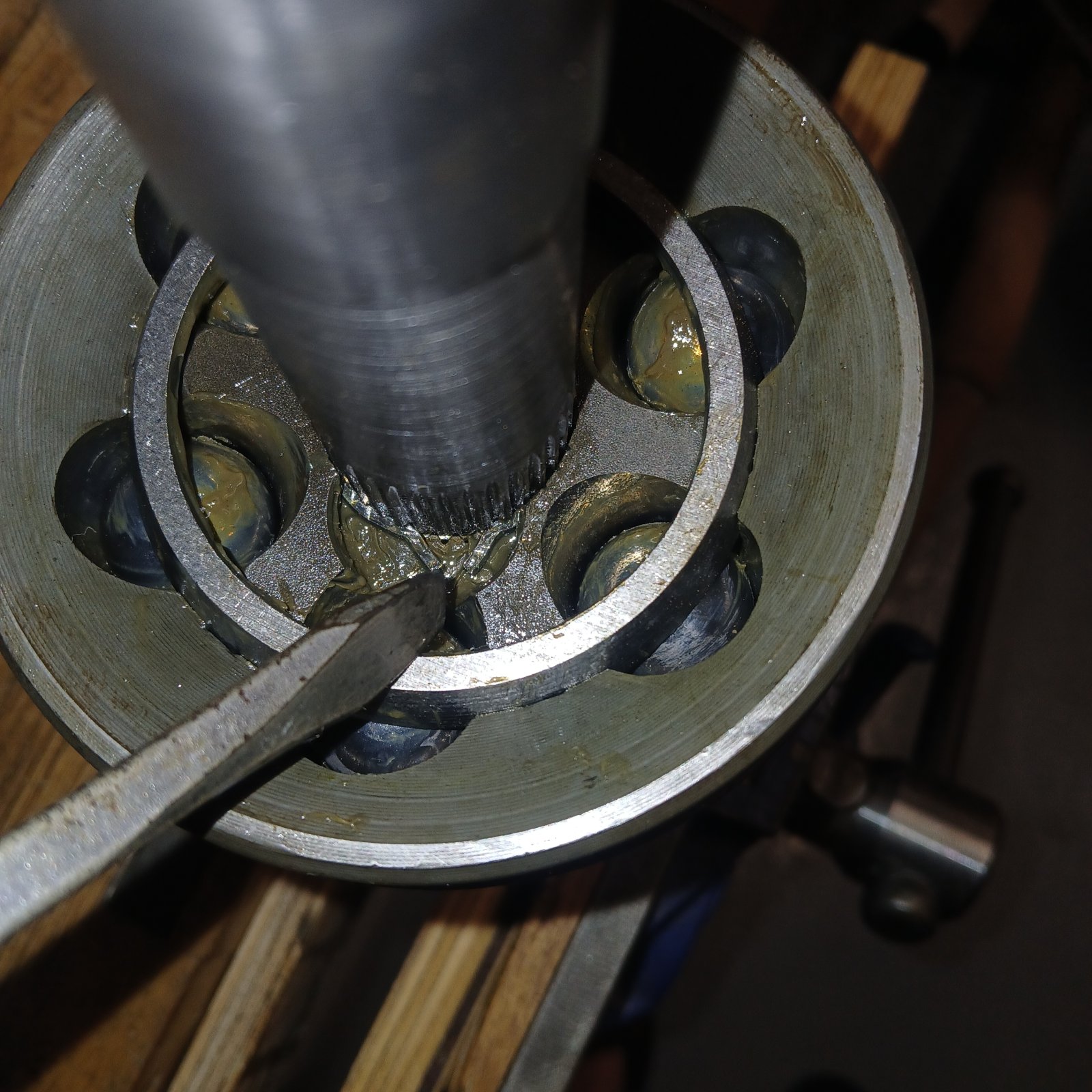

Cleaning grease out: darn! this is the most sticky grease ever. It wasn't too dirty but I cannot seem to get the CVs perfectly clean. I tried acetone but the grease wouldn't dissolve what the heck can get this stuff off?
You can see in next picture, with MUCH effort; lots of shop towels & shop air I was able to get it mostly clean.

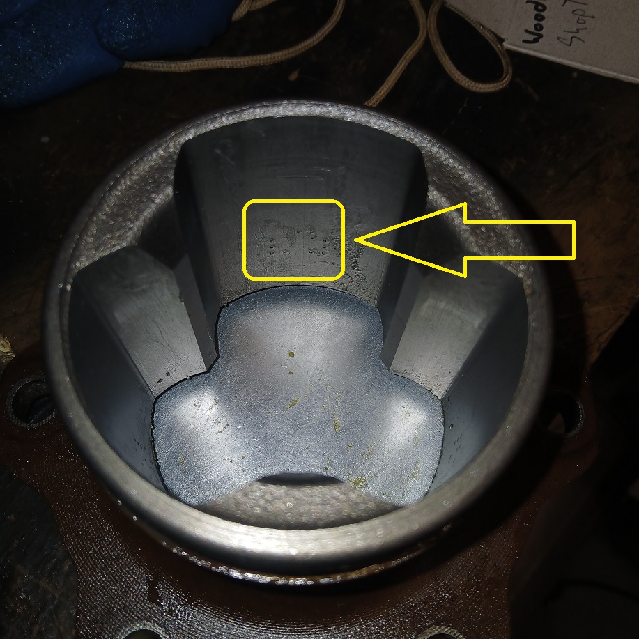

What are these markings on inside of joint: I never made note of orientation between this part and the bearing assembly. Not sure if it matters, however, I saw these markings and wondered if they had something to do with that?
Sounds like you got it clean.. Lacquer thinner is what I usually use for stick/dirty/greasy stuff...
My impression of dot type marks is hardness testing. But I have no idea...
Are they on the other two sections as well? I see something in the picture that looks like it could be on all 3 thin sections..
Also see what looks like a horizontal line, maybe jaw marks, above the dots?
Perfect I have a bunch of that too!
The other three sections have similar dot marks. One of the three pockets has a scribe mark higher up towards open end. Perhaps the jaw mark?
