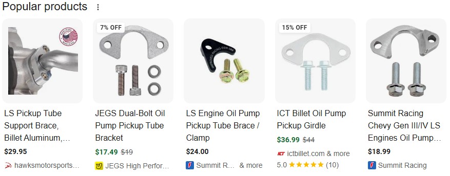

I would definitely get one, as 1 bolt holding a pickup tube and collection head, bouncing around inside the vibrating motor, has to have a life-shortening impact on the O-ring, IMO. I installed one on mine when I replaced the O-ring and deleted to oil pressure relief valve located in the oil pan. There are a couple of different designs, but they all accomplish the same result.
I purchased the two-bolt version from Summit Racing, but there are multiple suppliers.
