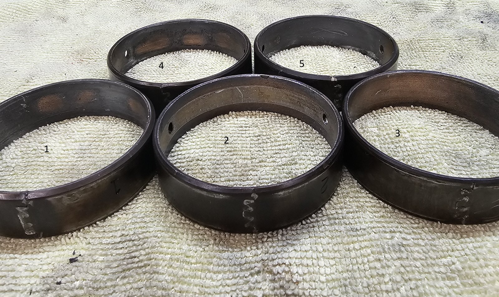

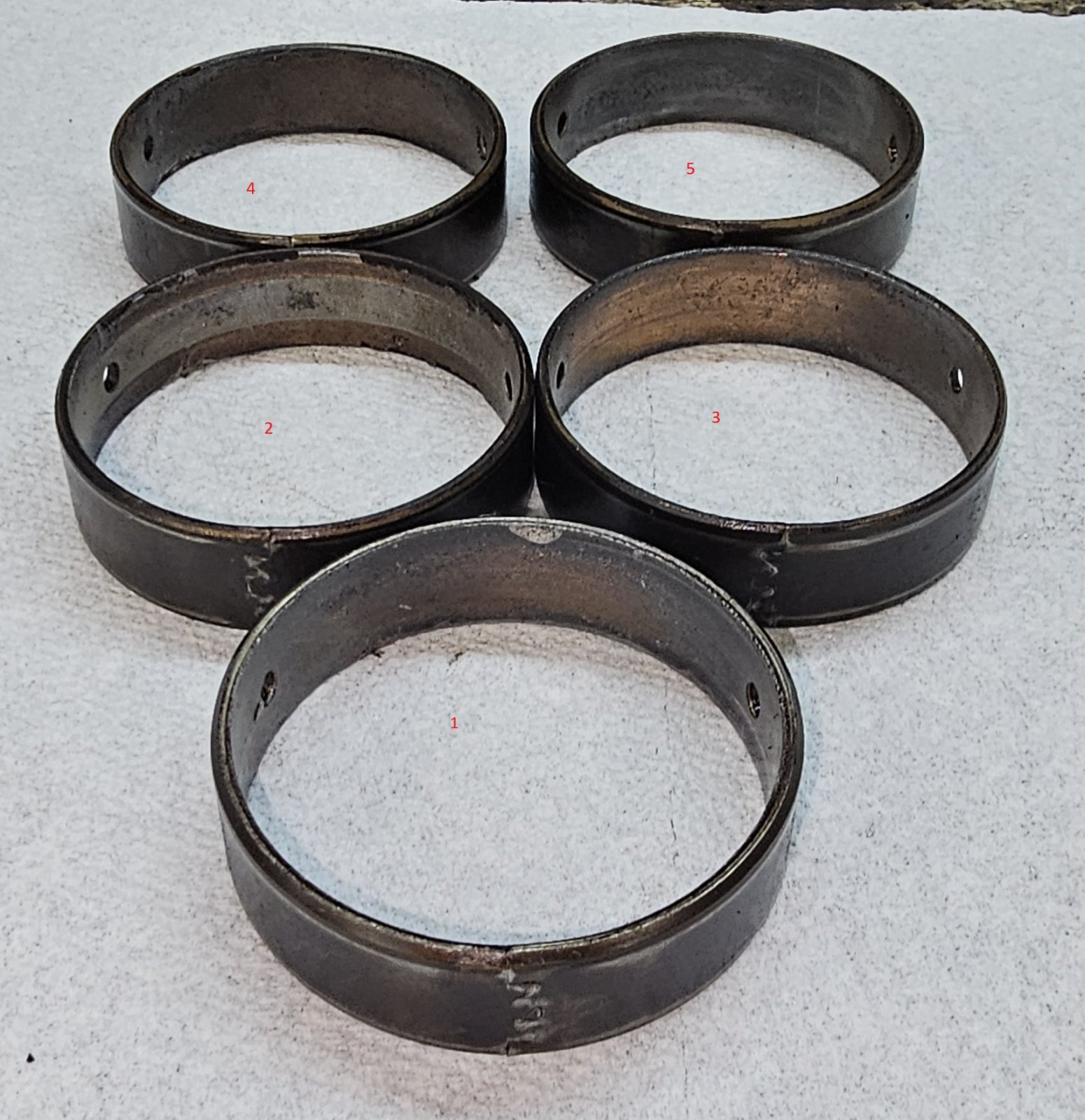

So this engine I'm doing a refresh because of piston slap, worn pistons, high miles, trashed cam bearings and band-aid fixes. The first oil change i did on it had lots of glitter and bearing chunks in it. Every oil change i did had glitter and a small amount of chunks. Would it go another year or two? Maybe but who knows.
Right now it is not so worn i can't get away with a garage refresh, so why not?
Turns out the engine i replaced it with had many of the same problems. Some glitter but no chunks though. I did however replace the cam bearings that were severely worn. I cut open the oil filter and found the media was collapsed and hard as a rock. The filter was obviously filtering nothing and been that way for a long time.

Replacement engine: I can not swear to it but it was green and white and i think Quaker State. Can't remember for sure.
Old engine: Had to all come from cam bearings. Rods and mains look good.
#1 was flaking off around the edges.
#2 the top layer was coming off and chunks were coming off from around the edge.
#3 had a little flaking off around the edge.
#4,5 worn out but solid.

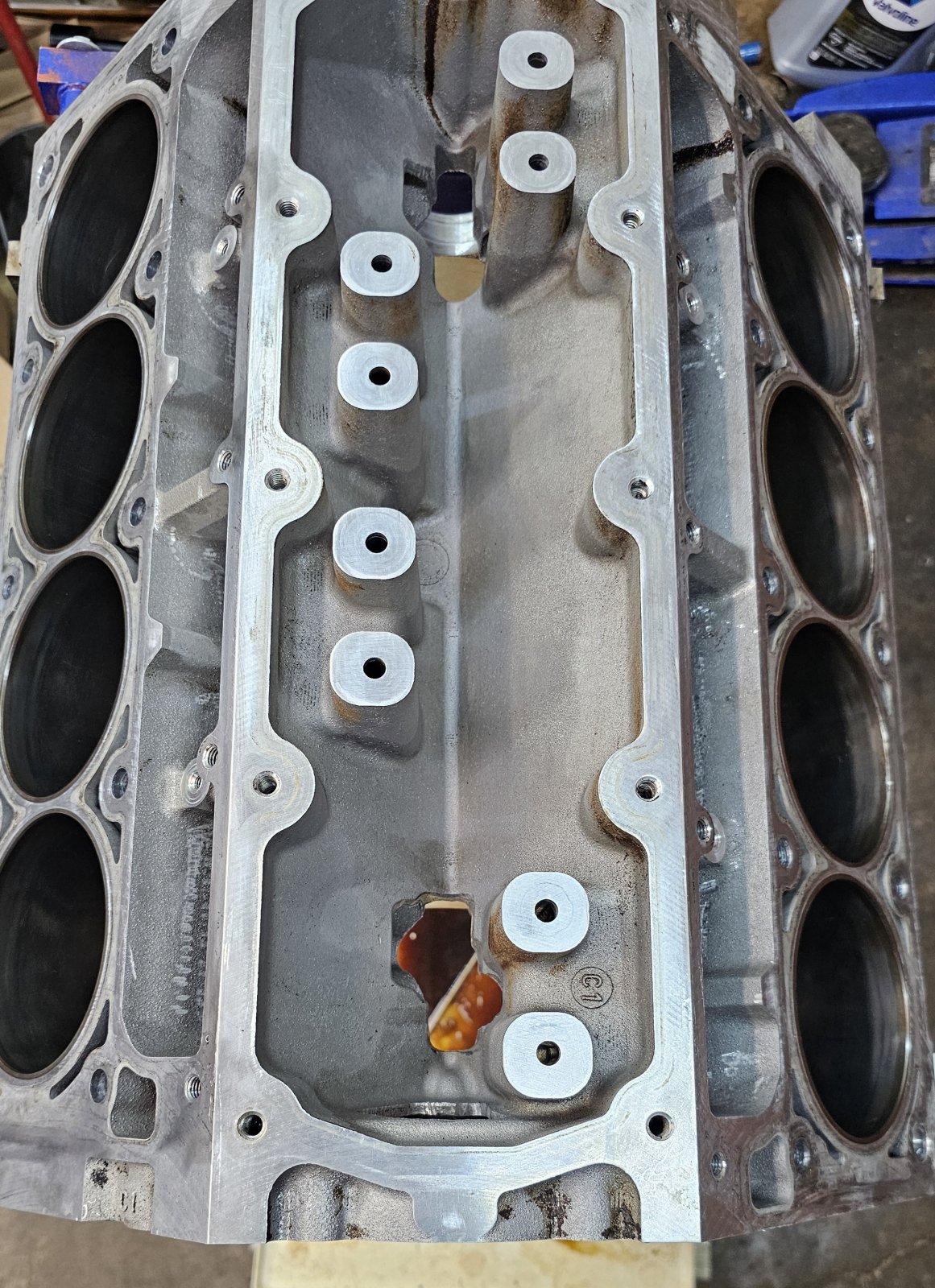

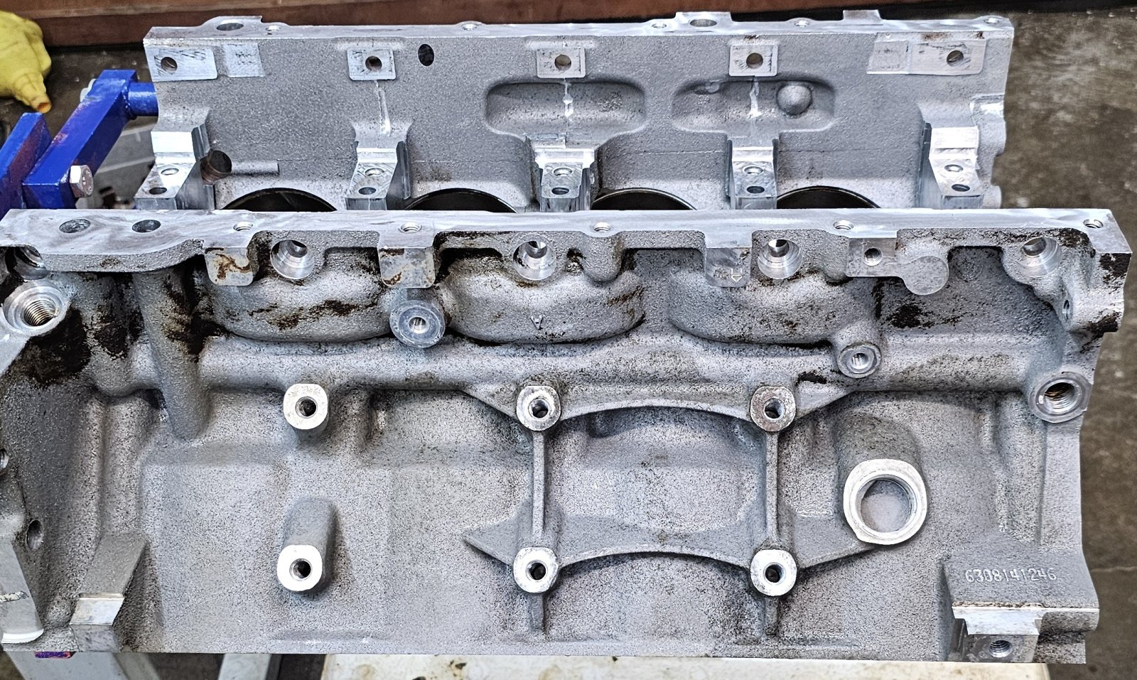

Got the block cleaned up enough to work on it now.
Now need to take out that front oil galley plug, hone it, then clean it again so i can make sure it is as spotless as i can get it.
Think im going to get the short block done first. Next month or two ill get the head work done. Split the cost over a couple month's.
Nothing special, just a few random pics.

Do you have plans to plug the AFM towers? I just used the hammer-in plugs, and skipped over the more expensive versions that threaded in.

Talked to 3 machine shops and the cheapest i can get it bored 0.010 over and honed is $900 bucks and i supply the pistons.
They all will clean the block, deck it then torque plate hone it or they will not touch it.
So tempting to just say fk it and just pretend i don't see the scratches. There are 2 scratches i can catch with my finger nail the rest i can barely feel.
