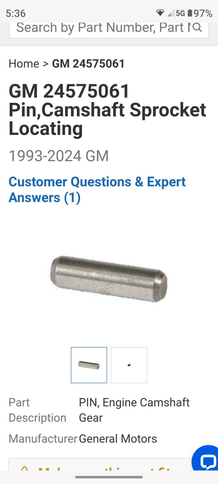

The dowel pin in the end of the camshaft is replaceable.
Genuine GM part number 24575061 should be the correct fit for it. Before you pull the camshaft and run it down to a machine shop, grab the pin with a set of vice grips as tight as you can with the vice grip handle upwards. Lightly tapping the back side of the handle should extract the pin. It might help to heat it up a little bit with a small pencil torch.

Ended up ordering a new phaser the other day.
Actually was able to buy a new cam pin from the GM dealership here. Thought there is no way they are going to have it but sure enough. $8.99.
Got the pin installed without a problem.
The hole for the pin is about .150 deeper then the pin is long. I do not like that so i cut the smooth end if a drill bit off and used it as a spacer so the pin can not go all the way into the hole again.
