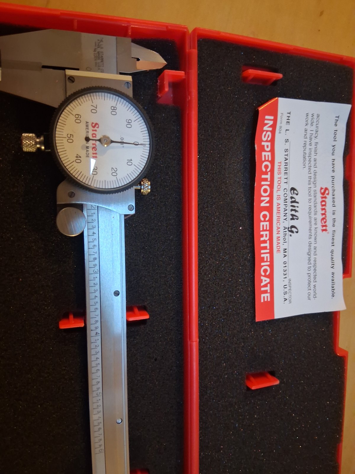

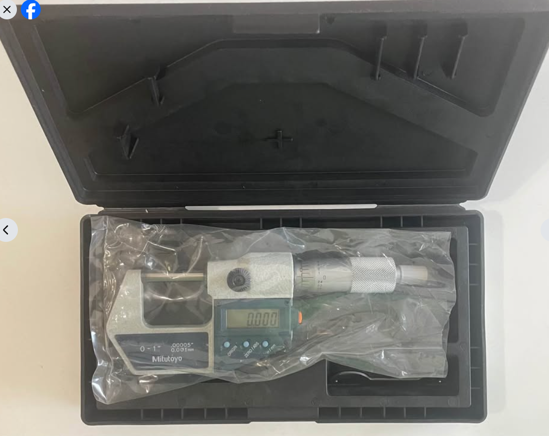

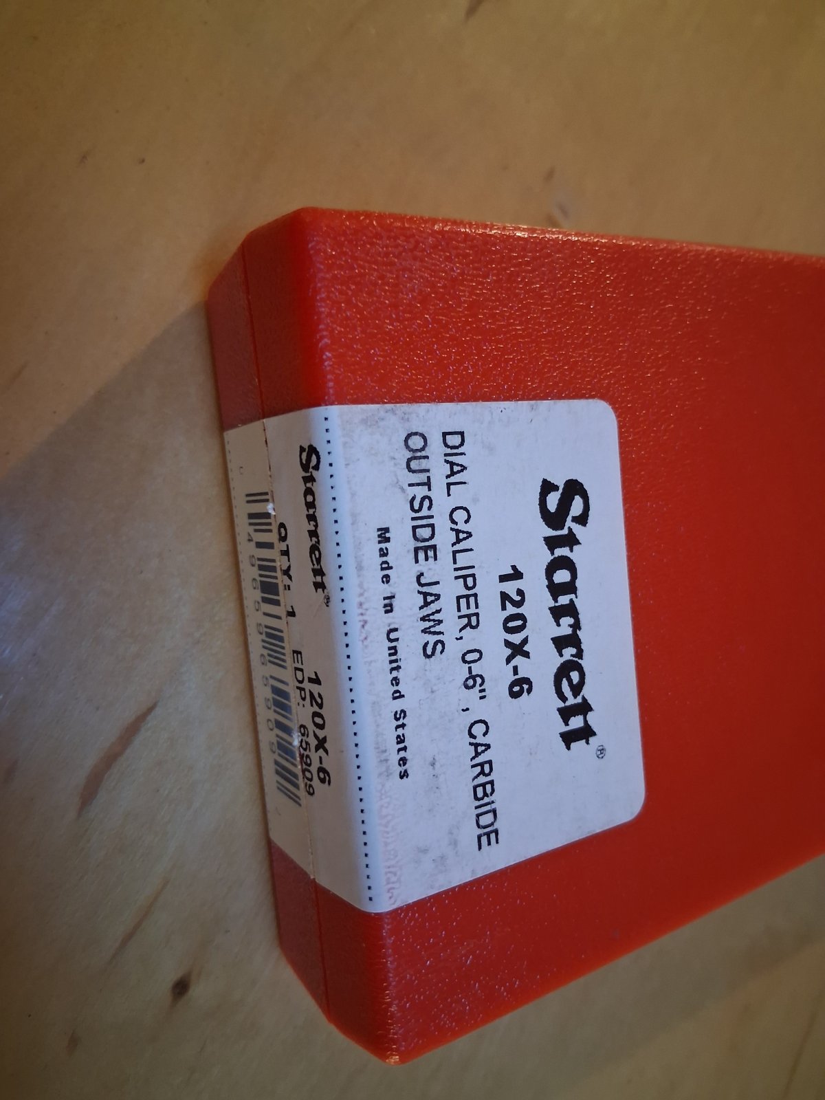

I bought a 0-1" Mitutoyo digital micrometer ($130) and a Starrett 6" dial calipers ($150) from FBMP. The Starrett were still sealed in their box and the Mitutoyo practically brand new:
Not too shabby...

Wow, nice tools! Great investment.
Thanks! Yeah, I'd never handled a nice set of dial indicators in my life until now. The fit and finish eeks quality.
