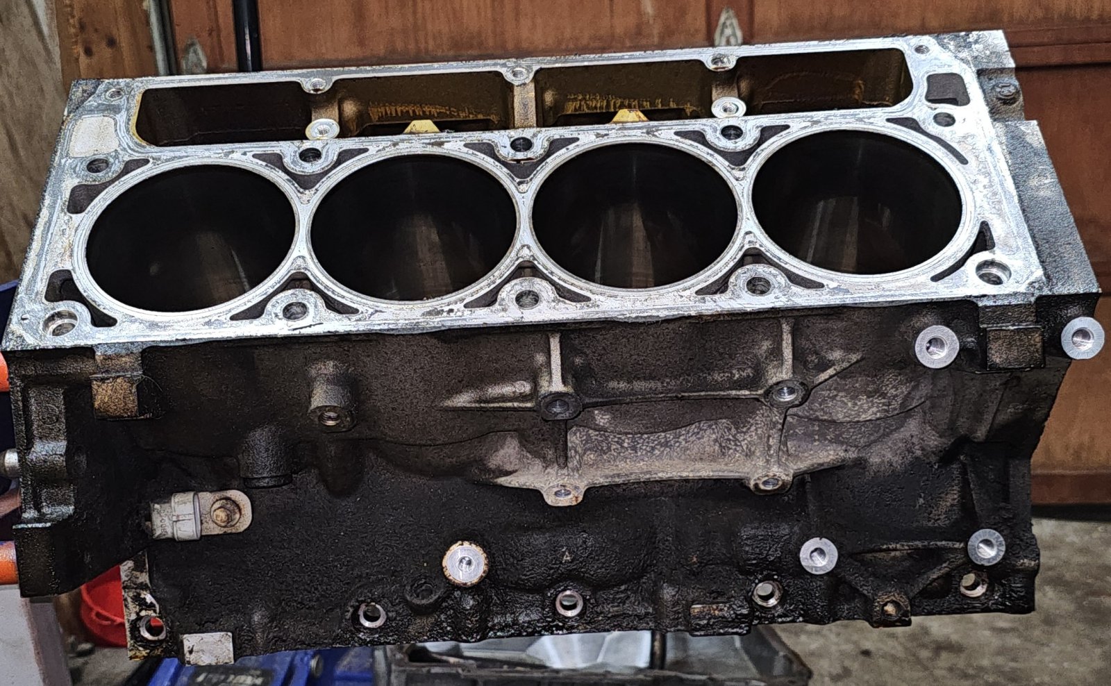

So im going to refresh this 6.2 and it all starts with collecting parts to do a garage refresh.
Keeping a cheap ish budget in mind, using name brand parts with no machine work and keeping everything std size.
This weekend i need to figure out how to get this dirty block clean enough to even mess with.

Find a machine shop that has a hot-wash machine to clean your parts (block, crank, heads, oil pan, pickup tube, valve covers, etc...)
They can also measure you main and con-rod bearings to see if you even need to replace them.... might not even be out of spec... no need to spend money just to spend money.
They'll slam in your new cam bearings while the block is there, and do the cylinder head service to freshen those up too.

Forgot to mention, it's also time to paint the block. My block was iron, so I used a torch to heat up the entire surface several times to force the water out. (Not sure if Al is as porous as Fe) Then I went over the whole thing with acetone and clean rags. Repeated the torch over the block to force out any trapped water.
Then another round of cleaning with acetone and clean rags.
I primed the block with Rustoleum and a paint-brush, and let it dry for a few days. Then applied the top coat of blue. It's held up muuuuuch better than prepping with brake-cleaner, and spray-bombing.

I do have a pressure washer. I have not found anything that cuts the baked on years of accumulated grease very well. Any suggestions?
I have the summit LS cam bearing tool. It does work very well!
New TTY head bolts are only $60 so that's no big deal. I already have all the torque specs for new TTY bolts or reusing the old bolts
I have reused crank pulley bolts a few times. No problems at all.
What i can not find a clear answer on is the main cap bolts. Some say ok to reuse, others say replace.
Honing/Deglazing. I 100% agree, a quality machine shop can do a better job then a person ever could, but im pretty sure i can do it "good enough" I have read a few articles and all say about the same thing. For the average home builder a proper deglaze with a ball hone is good enough.
A machine shop that would clean the block, install cam bearings and hone would be the best option. That ain't happening. I'm not driving 2 hours 1 way to wait 2 months and pay $500. My sweat equity and plastigauge will suffice.
The thing that really tic's me off is the price of gaskets. $400 ish for all the gaskets is insane from what i can find on summit.
I'm painting the block & valley cover Chevy orange before assembly. Pan, heads and front cover will be Aluminum. Current plan.

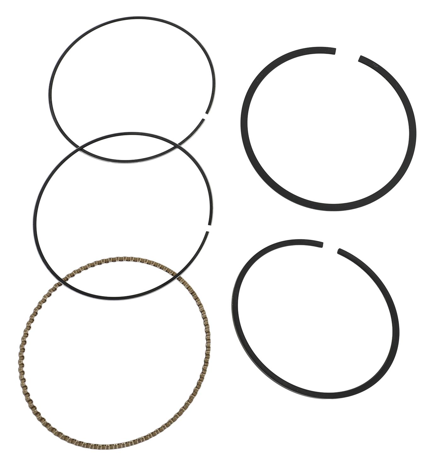

May switch to these rings though. Not because of cost but because i have used a ton of them in the past and never a problem.
