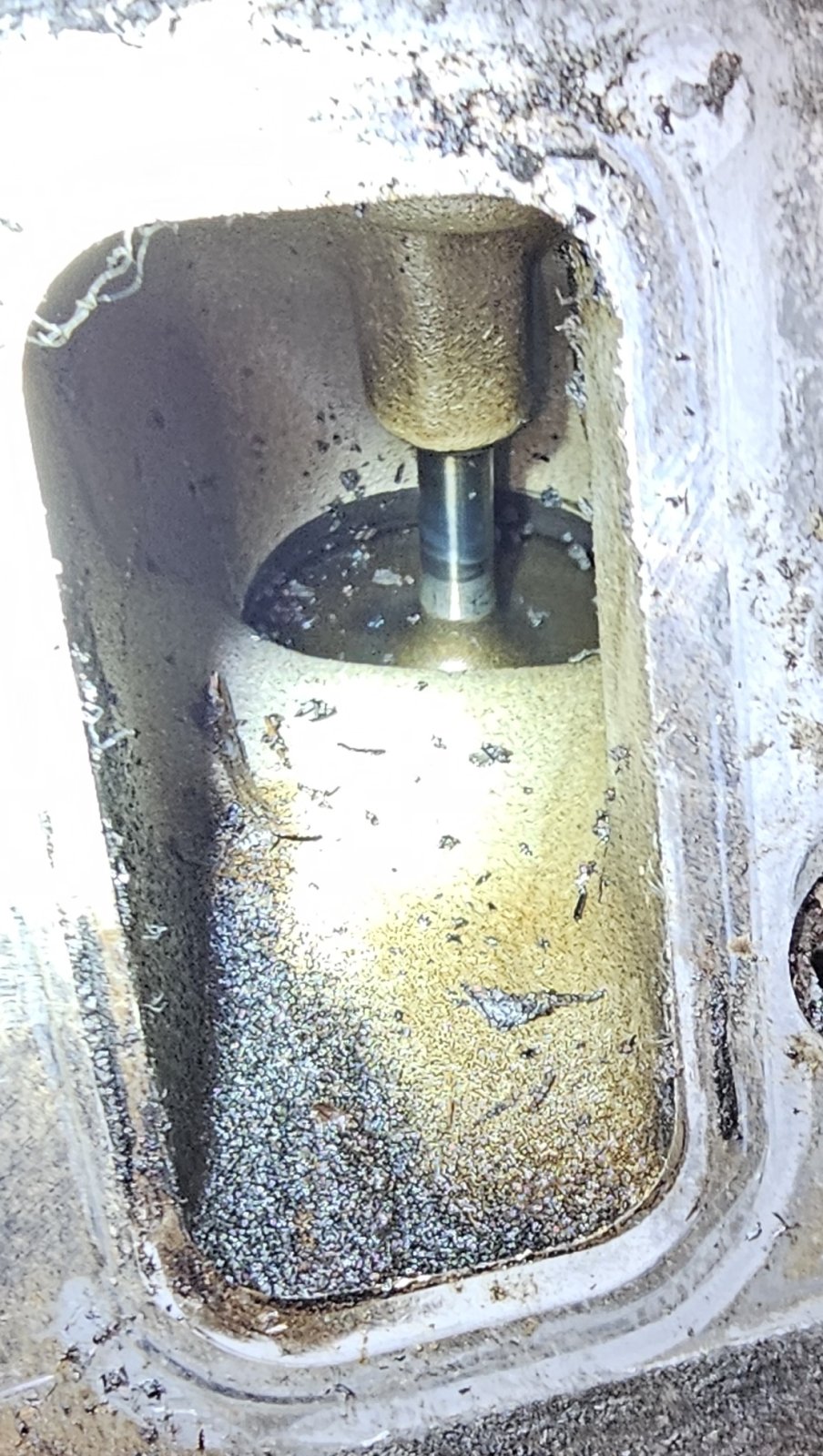

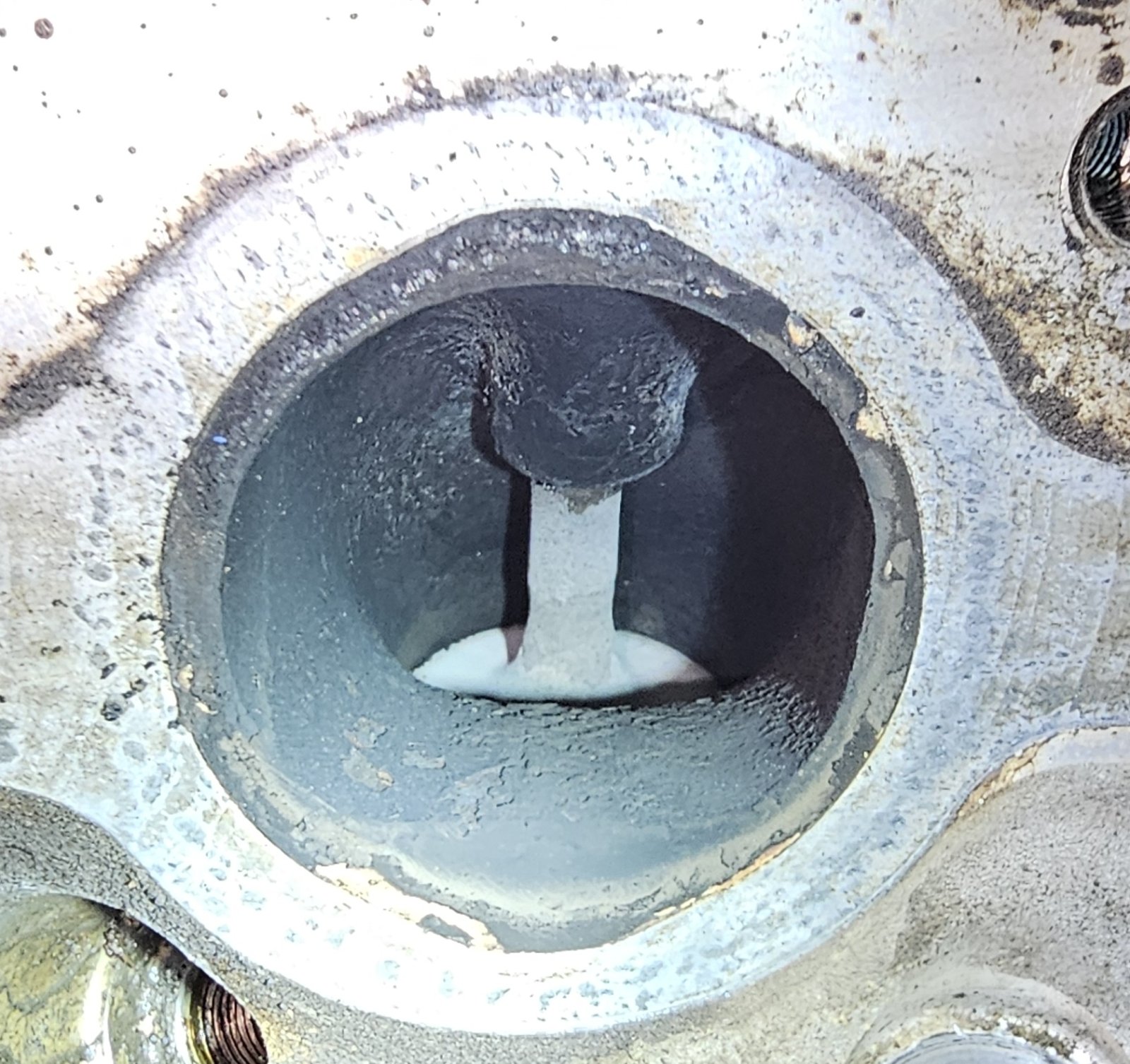

I had some piston slap on start up but went away pretty fast, but 1 was slapping even hot very slightly.
Here are some valve pics. All valves look like the pics

I can only guess the exhaust valves look that way from burning oil thru the pvc?
I'm pretty much convinced that dexso oil is such a hard spec to hit, because it's gotta be oil that can be burned by the qt thru the intake and not foul out the cats for atleast 100k miles like old school oil would if it burned as much thru the old school pvc valves. seems once the oems when to this full bore pvc setups everything eats oil stock. the di engines are nightmares because of it on the intake valves.

I could be wrong, but to me the valves indicate a healthy running cylinder. Maybe slightly lean though.

I was thinking it looked like the white fluffy build up on spark plugs when they burn oil. maybe not thou.

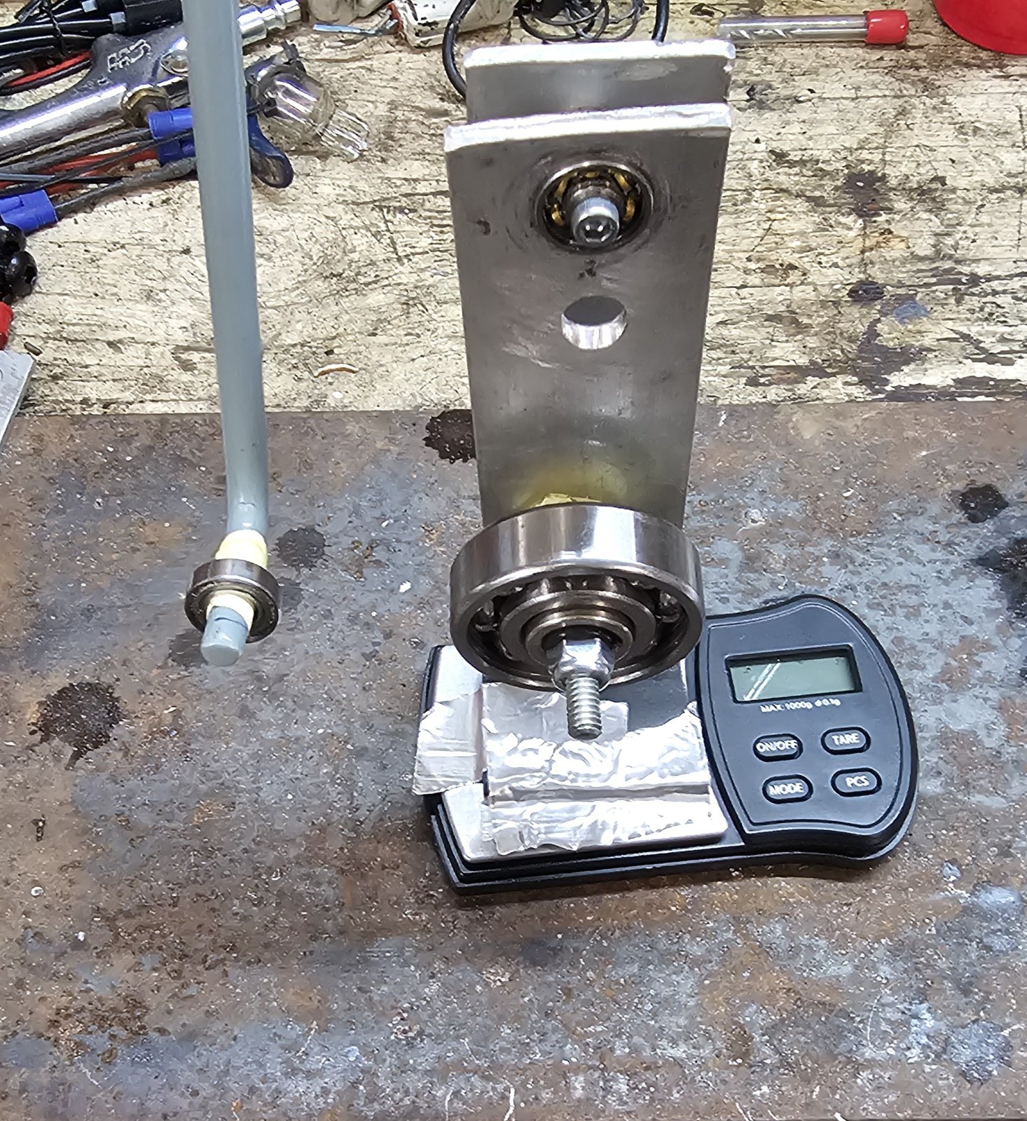

Trying to keep as budget as possible, i wanted to weigh the rods.
After a day and a half of watching videos and trying to build something that would give me repeatable results i could trust with stuff i already had in the garage i got it done:gr_grin:
Used a piece of aluminum strap, angle iron, a quad transmission bearing and an OS 1.20 engine bearing. The part hanging from the ceiling is a hanger and another OS engine bearing.
Seems to work pretty good after i got it figured out and now i have the information i needed.
Now i know that between all the rods there is a 2 gram difference between the heaviest and lightest.
There is a 1.9 gram difference on the big end
And 1 gram difference on the little end.
I'm pretty sure i can get the total reciprocating weight the same.
The rotational weight im not sure if i want to mess with that.
With there being 1.9gram difference on the number 1 rod journal i just don't know if it's worth the effort on a stock engine that will never see over 5.5K rpm?
