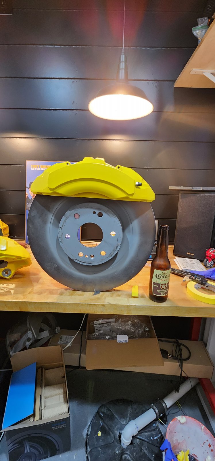

2021 Tahoe PPV massive oem brakes, 16"

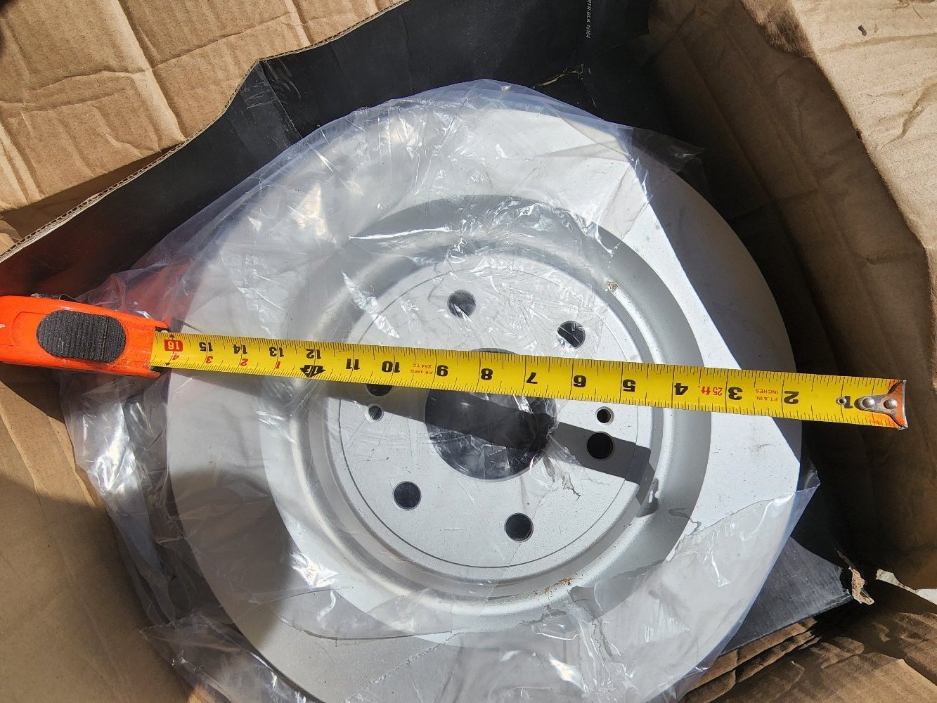

Thanks so got a question you might have mentioned it already what rotors did you go with and if you could give a part number . I'm in the process of doing this setup on a 11 escalade and the only thing I'm missing is 1 rotor I had ordered the acdelco #84865905 rotors but one of them was on back order and now are discounted so I'm stuck with one rotor.
DYNAMIC FRICTION​
60447086 (604-47086)

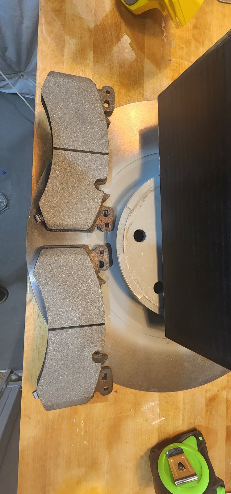

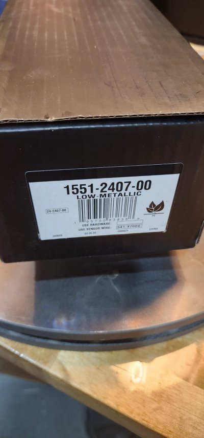

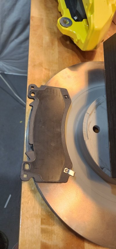

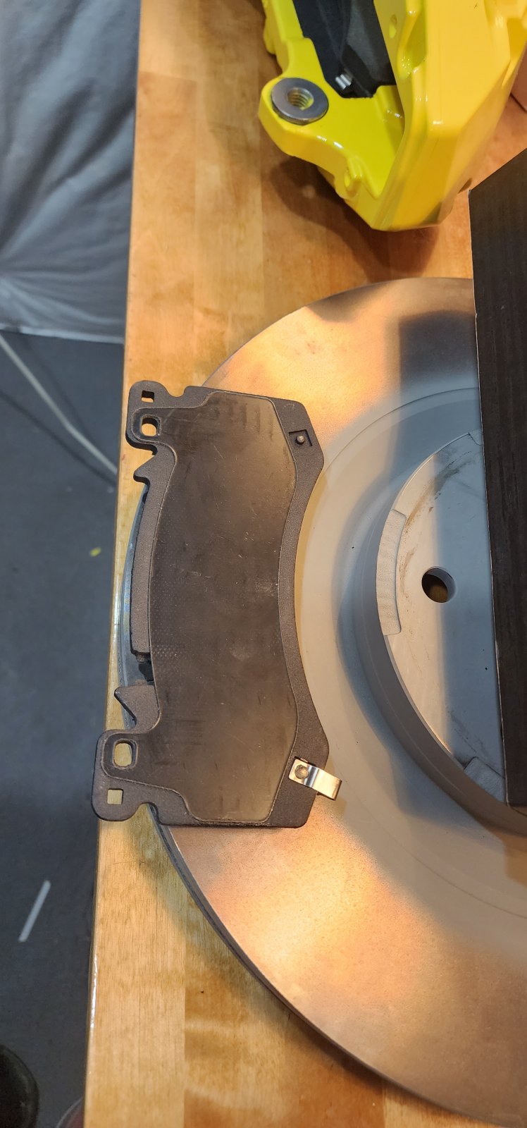

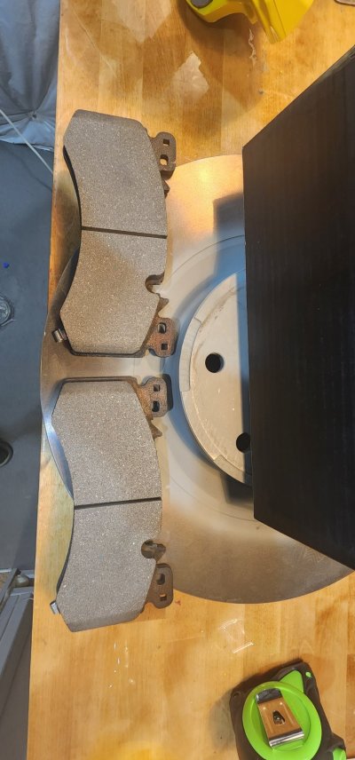

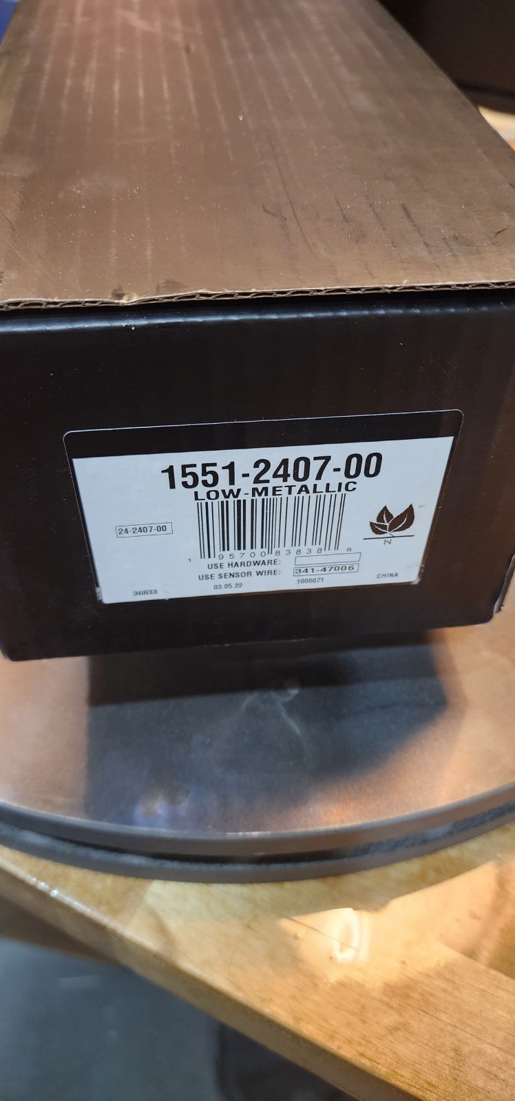

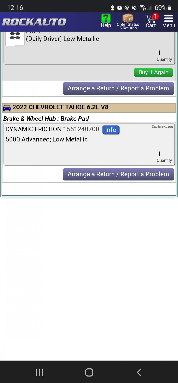

Thanks by the way I did come across some dynamic friction pads that fit these calipers less then 60$ semi metallic. I'll post some pictures when I get home.
cadieext11
Sep 20, 2022
15
Here's the pad info and in the calipers got them off rockauto.

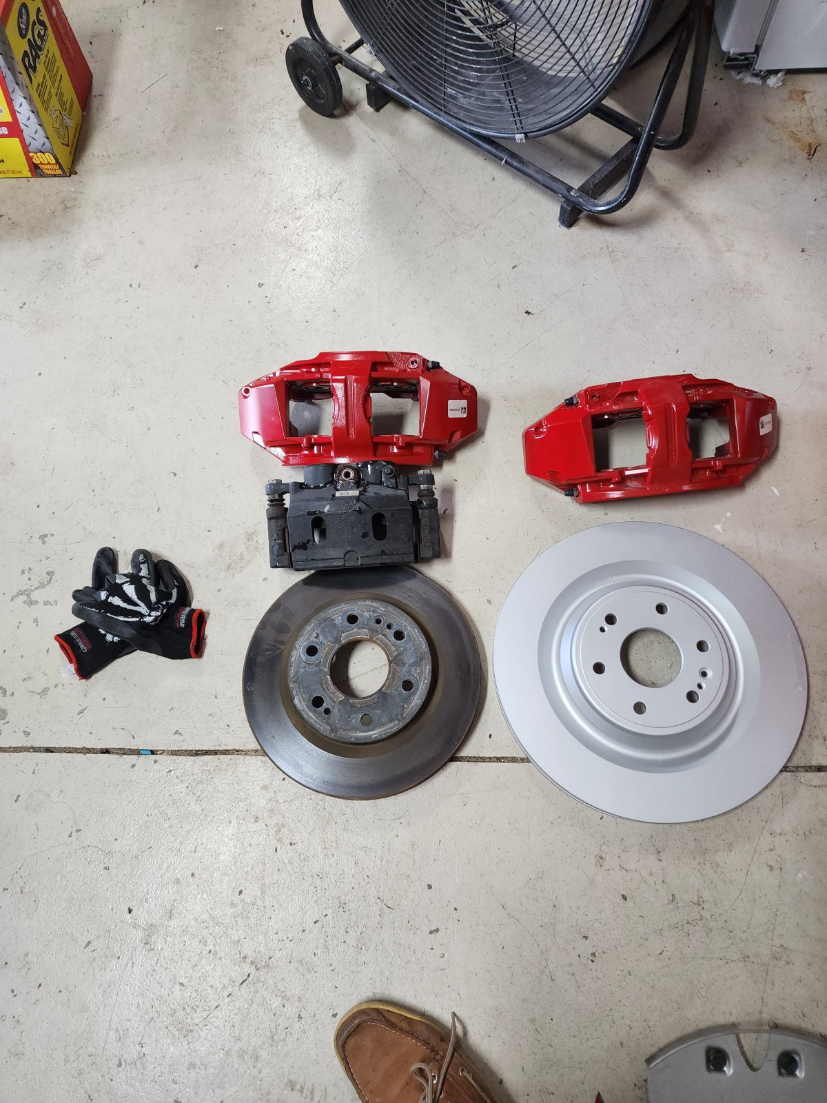

That's good info but I already paid for the AC Delco ones, wish I would have kept looking for the cheaper pads. I think I paid about $350 for my pads. I hope to install all of this today.

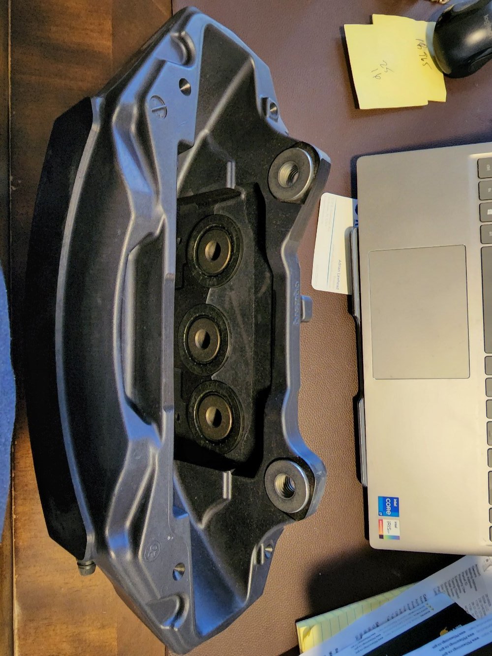

cadieext11
Sep 20, 2022
15

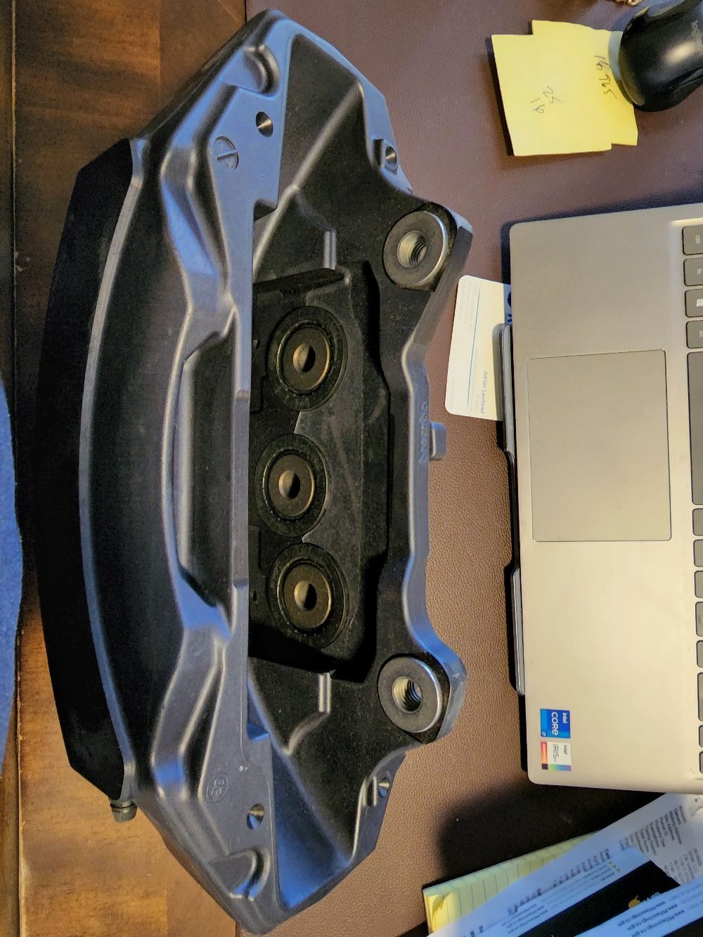

Let me know how it goes I test fitted the calipers and rotor and I'll have to use a washer to center the caliper another member on a group is doing the same setup on a escalade but he has the belltech drop spindles and it's a perfect fit for him

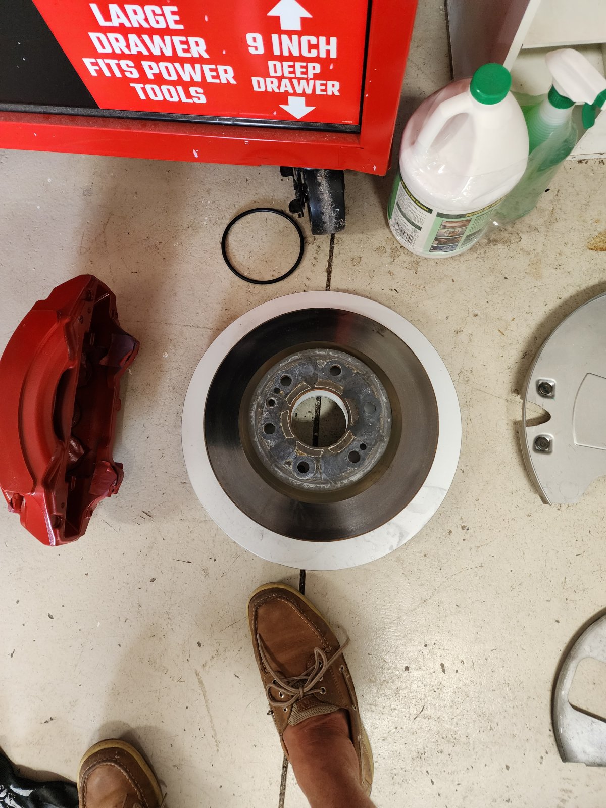

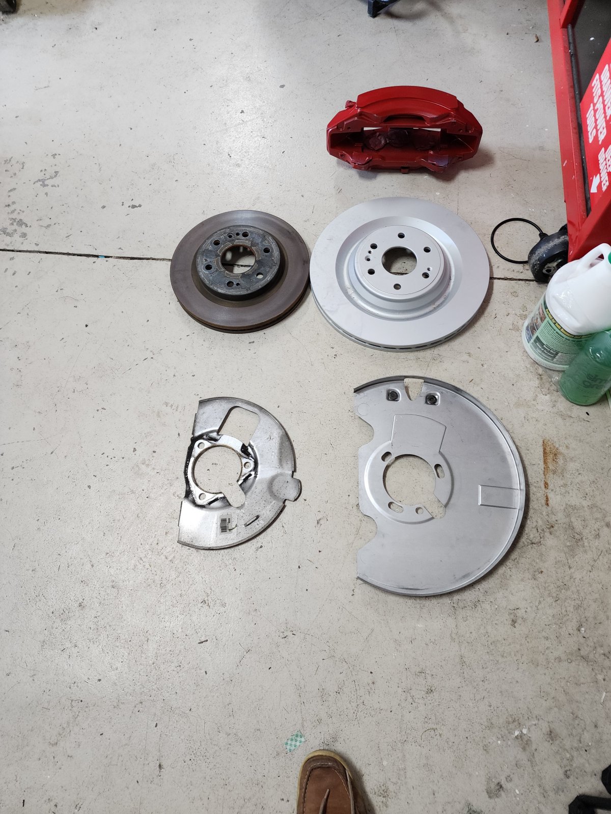

THarber
Jun 4, 2021
307
284
I'm in the middle of it and yes it will need a washer. I have to get cleaned up and off the the parts store.
cadieext11
Sep 20, 2022
15

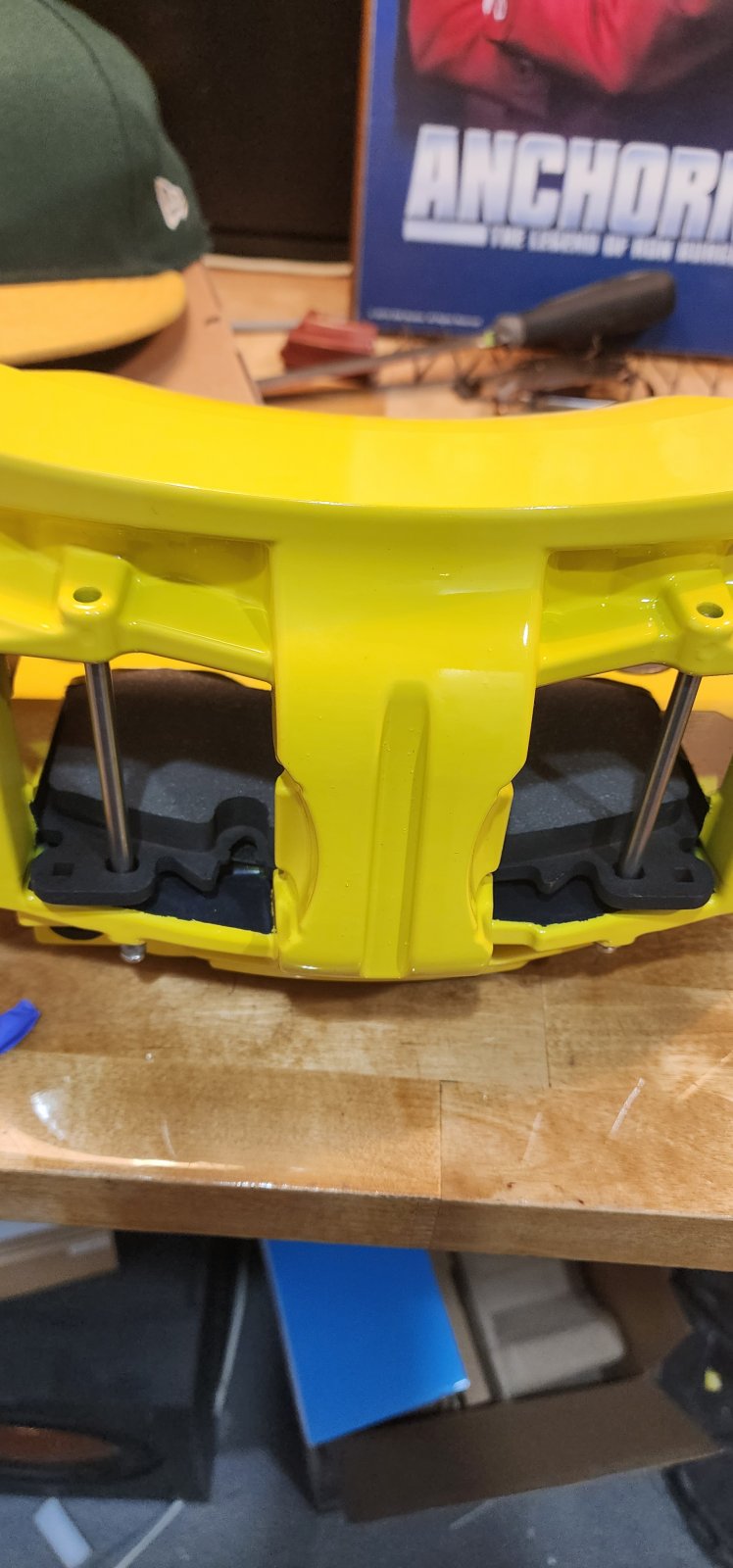

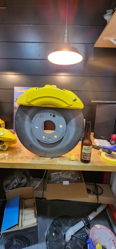

Hell yeah I was thinking of getting the backing plate too but I wasn't sure if it would have to modify it to fit.
Did you paint or powder coat the cailpers?
