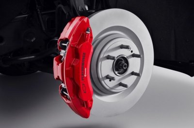

I think even the regular trucks have much bigger brakes as well. There’s a thread talking about wheel comparability or older wheels on the new gen trucks. And they’re saying the wheels are barely clearing the brakes. It’s likely they need spacers to fit older wheels over the brakes. Impressive!

The PPV RPO J55 brakes are the same as these: P/N 84766666
Only without the fancy paint and branding.
The Chevrolet Performance Front Brake System features Brembo 6-piston, fixed aluminum calipers and larger-than-stock Duralife™ rotors for an 84% increase in brake pad area and a 42% increase in rotor area to increase thermal capacity. The Duralife™ hardened rotor surface helps reduce corrosion and provides quieter braking with less vibration. During testing, the Performance Brake Package provided 31% reduction in pedal force at max deceleration, and 12% reduction in pedal travel, providing improved pedal feel. Brakes are compatible with 20-inch to 22-inch original equipment or Chevrolet Accessory Wheels

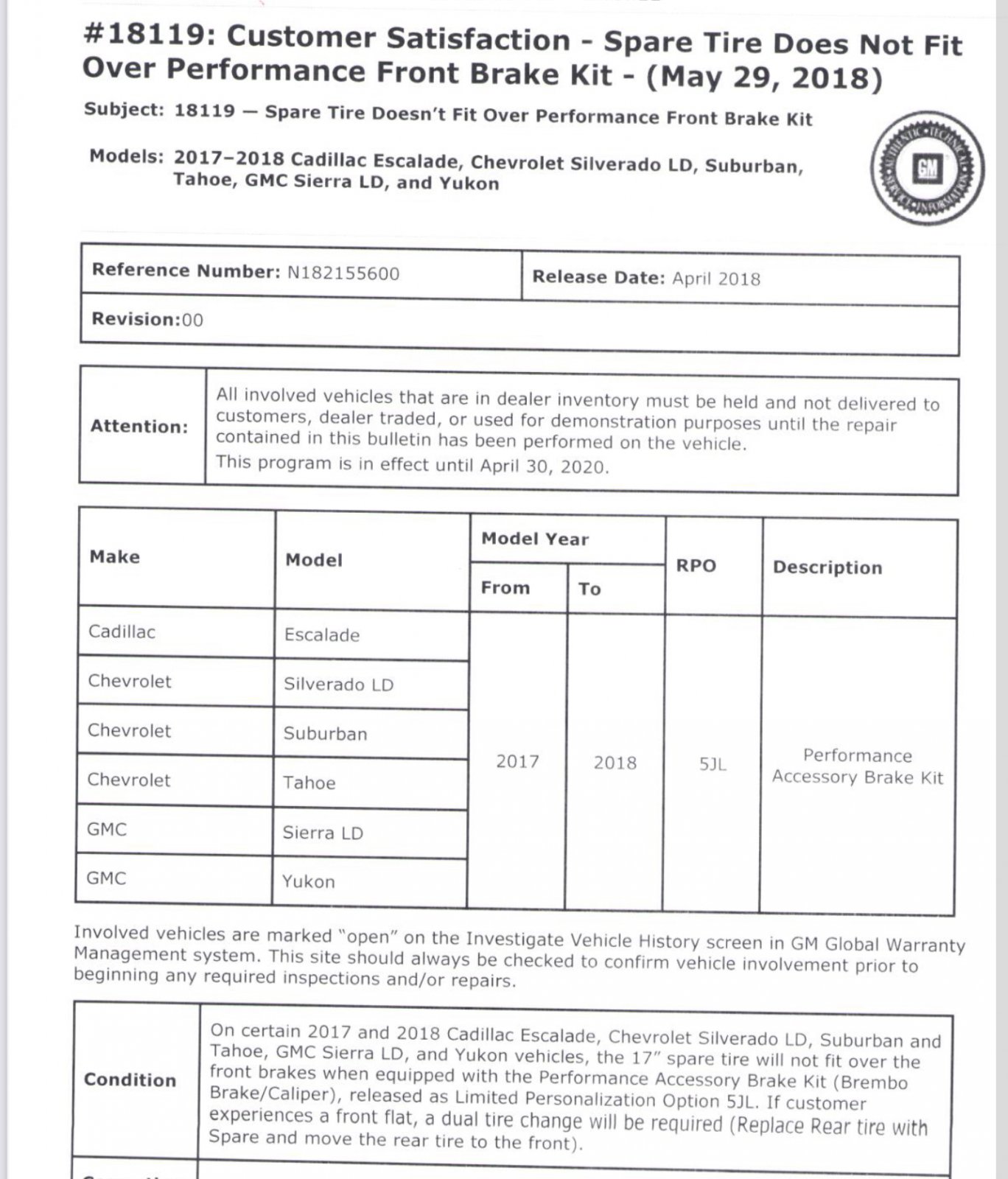

Please be aware that I purchased the Brembo Big brake package for my 2015 Yukon Denali , only to find out after that your spare tire Will Not fit over the new break package. Gm's responce when I asked about this( was never informed at time of purchase) To Take the spare tire replace the rear wheel with it and use the rear wheel to replace the front flat tire. In essence a 2 wheel tire change for 1 front flat!
Or you could get a bigger wheel as a spare.

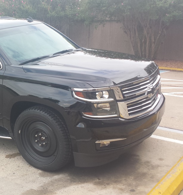

i went w/ transit rim for my '15 w/ BBK

this is on my '15, & just fits in spare location.... so no idea what the spare space is like on the '21+
transits can be hard to come by, but they look good @ 22 inch ;)
I like it, I have the Beltech drop spindles and if I get a front flat I have to do a 2 tire change out using the 17" spare. What size tire is on that 22"? I'm buying me one of those. Thanks for the pic
