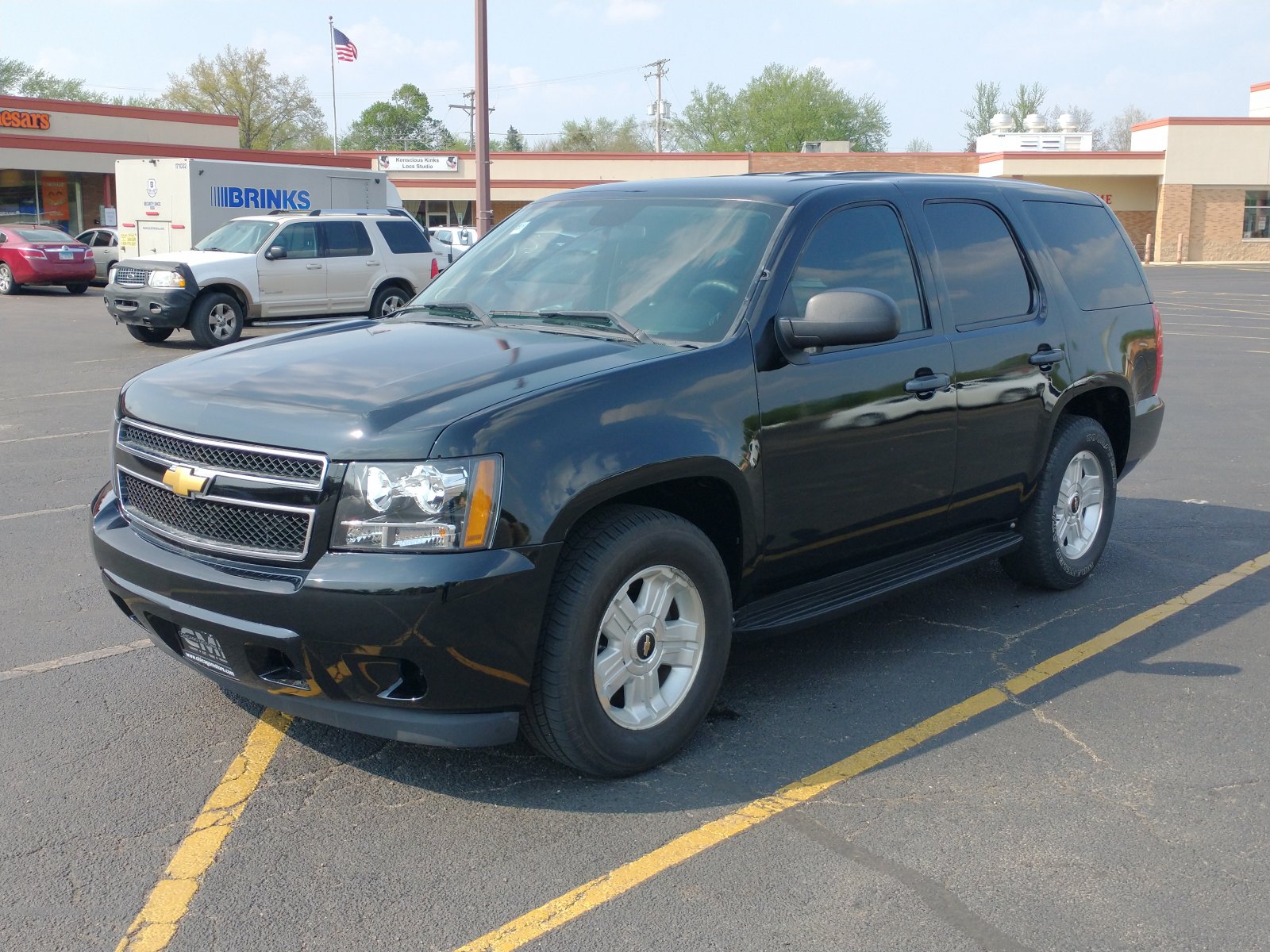

Hey folks!
I am new to Tahoes, but not new to GM or to forums. I use the same name on the Impala SS forum. I've had 7 B/D-bodies, and a 5.3 Trailblazer.
I have been in need of hauling capacity for some time now, and it might as well be an LS-powered SUV. When I came across this Tahoe, I knew it was the one. It just felt right.
It's a 2013 PPV, black exterior, fully caged rear (highway patrol K9?), 108k miles on the odometer. RWD and 6L80E, of course. It was owned by one department in Arizona until retirement at the end of 2021. I live in northern Illinois, and am now the second registered owner.
Cosmetically, there are plenty of issues like you would expect from a police car. There are a few dings in the body, a few holes in the interior, and it smells funny. It has been freshly repainted, and we know how government paint jobs go (pretty much yes/no, pass/fail).
Sacrificing on those things got me a few things that I consider more important. For one, there is ZERO rust on this thing. It's mechanically solid, and I think I got a good deal on it. Obviously the RWD makes it less desirable to some buyers in this area, and the caged rear makes it less desirable to anyone looking to haul kids, etc. I paid $13,250 before tax, title, and plates.
The first orders of business were removing the spotlight and replacing the wheels. It's not that I mind them myself, it's just that I can't stand the constant attention.
I really like the police seats, console, and rubber floors, so those will stay. The rear portion of the vehicle will stay mostly the same, although I am already eyeballing the molded plastic second row for some sort of audio adventure. It looks like a sub box, or at least something to mount speakers in.

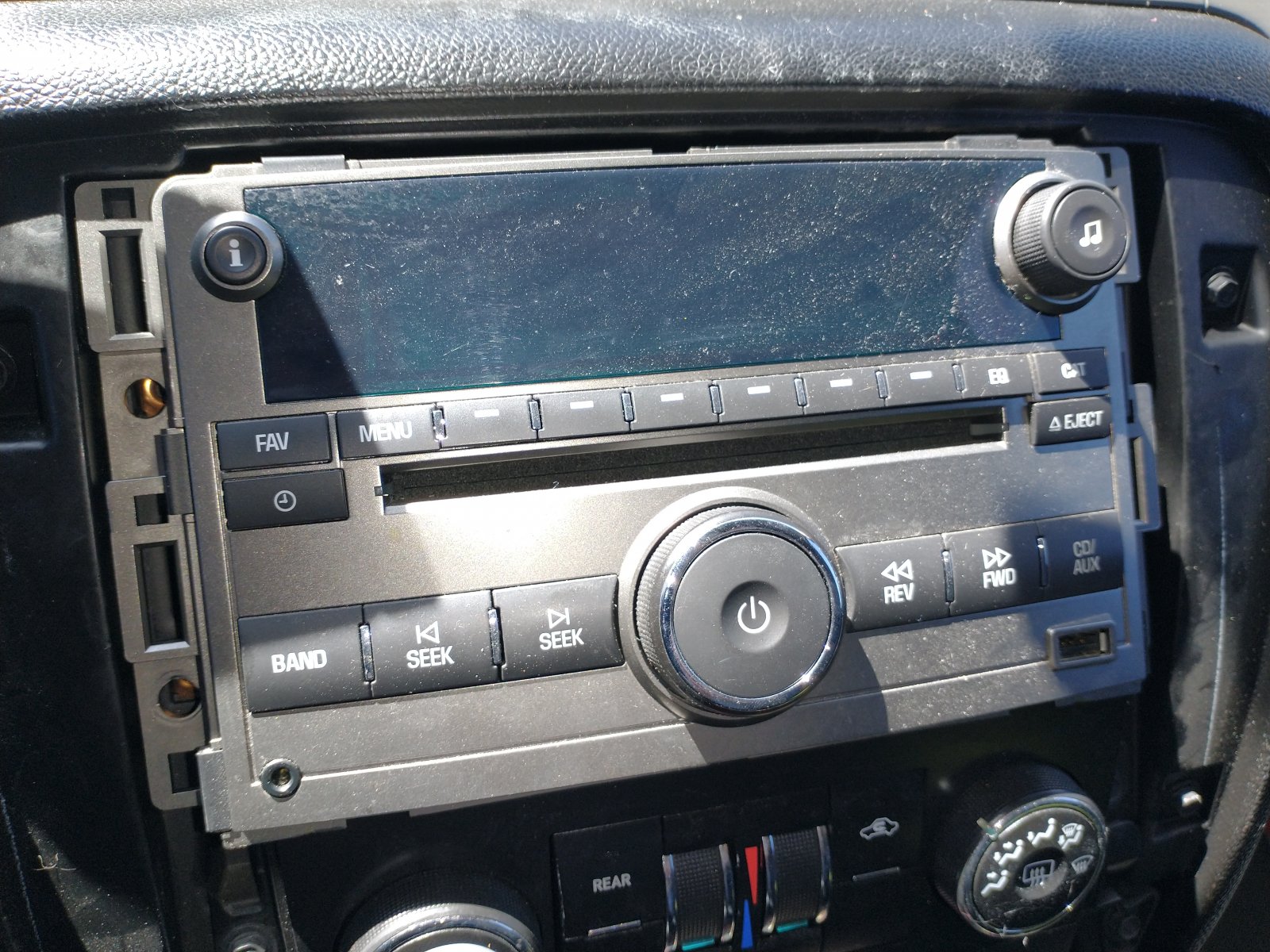

Speaking of audio, I am currently wasting a bunch of time fiddling with lousy OEM equipment. I pulled a "premium" radio from a 2012 Malibu LTZ, which looks basically the same as the radio in the Tahoe, except with a USB port in addition to the aux port. It also has bluetooth, and it's silver in color, which matches the PPV interior trim. The harness connectors are the same, but I figured out pretty quickly that they are pinned very differently. I'm re-pinning my OEM harness so it connects properly to the Malibu head unit, and I've got three wires left in the Tahoe OEM stereo harness that I haven't identified. I think at least one or two of them have to be for the chime stuff, but I have no idea which is which. I'm left with a dark green wire, a yellow wire, and a white wire. The Malibu has two dark green wires for GMLAN, and that's pretty much where I'm at now.
I've got a bunch of speakers and subs to use up, and I grabbed a couple of OEM amps from the junkyard. I'm just patching together a cheap system. BTW, if anyone happens to be knowledgeable on the various OEM Pioneer subs that were offered in late-model GM vehicles, I would appreciate some guidance. Over a period of months, in three separate incidents, I have pulled two subs and an OEM enclosure from different vehicles that I mistakenly thought were all "the same".
Additionally, independent of the Malibu stuff, I've also been doing some ghetto experimentation with the chime setup in our cars. It seems to me that you can actually leave the case from your factory radio in the dash, with the "board" still intact. With no face plate or disc drive, there is plenty of space to mount an aftermarket head unit directly inside the factory radio case with a standard mounting kit. And, if I'm being honest, I don't see how it's any more ghetto than the goofy chime retention module that seems to be the only alternative. Why not just skip it? If I run into any kind of roadblock with running the chime through the Malibu head unit, I will probably just remove the board from the factory case and mount it remotely inside the dash or console and then forget about it.

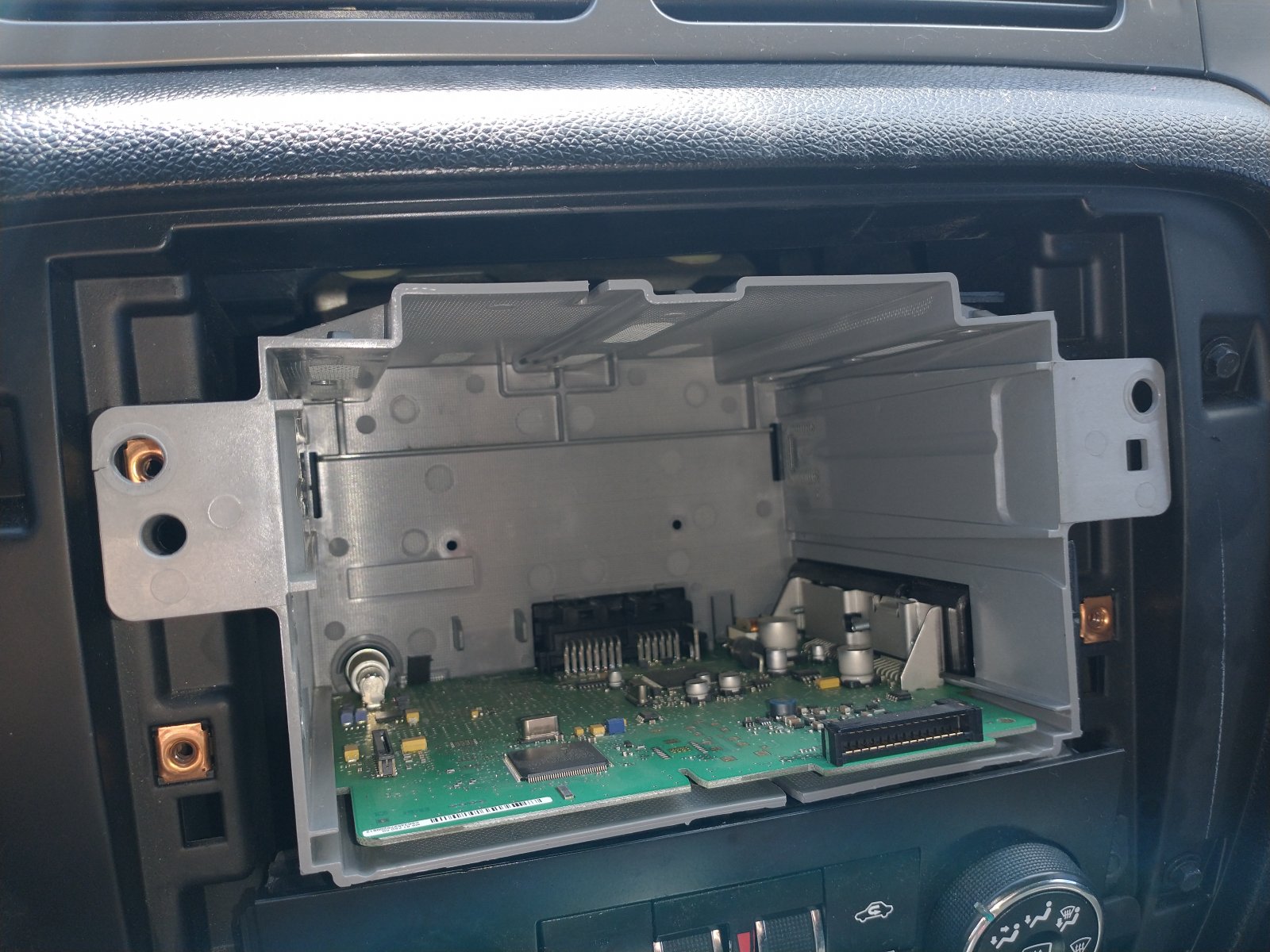

I think I figured out the last 3 wires, finally. I found the GM guide for the Tahoe PPV electrical system, and it's mind-blowing. I had no idea that this giant bundle of coiled wires sitting on the floor is 100% factory. There are a bunch of random wires for random things just ready to go. Yellow is hot in acc, run, and RAP. Yellow/black is hot in run with vehicle in park, etc.
Here's something kinda weird... I have been reading that the 07-13 trucks don't have a switched 12v wire for the stereo, and people go to all these lengths to run a wire to the engine bay and stuff. Well, I'm pretty sure the #6 white wire in the 14-pin connector is "entertainment remote turn on signal". We will find out, as I figure I am going to connect that to the slot for switched 12v on the Malibu radio.
Yellow is the dimmer wire, which I suppose the Malibu does not use.
Green is for GMLAN, and I am relieved to find that it apparently doesn't matter that the Tahoe has 1 wire and the Malibu has 2, as the system works fine as long as all the green GMLAN wires are connected together.
Off I go.
45,013
Being a PPV and not having a lot of the common options, they probably just use the normal/commonly-optioned harness and leave the wires unterminated for upfitter use.
What 14-pin connector? Yes, the radio is turned on by a data signal that commands it to turn on and draw power from the constant 12V source. As you mentioned in a previous post, there are RAP, switched, constant and ground taps in that box above the brake pedal. I'm too old and fat to dig in there, so I tapped a switched 12V in the panel on the righthand side of the dash for my radar detector.
I will bet against you on that. Have you seen the electrical system on the PPV? I'm pretty sure I have the regular upfitter box in addition to this giant coil of wires. There are 8 gauge power and ground leads throughout the entire vehicle, and there is a power distribution block under the hood that looks like something from a crazy audio system.
The GM radios of this era use two connectors, one with 14 pins and one with 16 pins. You might think of the 14-pin connector as being 12-pin if you don't count the power and ground, but the pins are numbered 1-14.
45,013
All I've ever seen of the PPV electrical system is the rat's nest from all the aftermarket add-ons being ripped out. I had to go back and re-read your description. I clearly misunderstood. So, GM provides all these extra circuits from the factory to support the accessories. I always thought those were aftermarket. Pretty damned cool and convenient!
Oh- at the radio itself. It'd be a bit of a breakthrough to find if that white wire is a viable switched 12V source.

I found a post the other day on some forum where a guy claimed to have found a switched 12v wire in the radio harness. Although, I am wondering if it's just a switched 12v output for the other electronics in the car, rather than an input to the radio itself. Meaning, theoretically you would still need to connect switched 12v power to this wire for it to function.
I've hit my first real roadblock, and I'm going to bed stumped tonight...
I was not able to get any power from the supposed factory 12v switched lead. I'm now paranoid that some or all of this harness has been cut somewhere, but I can't trace it very far.
Next, I tried to connect the Malibu switched and constant wires together just to test the head unit, and it made no difference. I still can't get it to actually turn on; it's acting like it would if the car were off with no key in the ignition. Then I grabbed one of my cheap but brand new head units and tried to connect it the same way... It literally blew up immediately in my hands and started smoking. That might just be a coincidence, since it was cheap.
I just looked at the supposed upfitter panel that was referenced in another thread, and mine doesn't look anything like the pics I've seen. I'm suddenly back to the timeless question, "where the hell do I get switched 12v power from?"
At this point I might just put the Malibu radio back on the shelf and proceed with just wiring up an aftermarket unit. I need to be done with this, because I've spent too much time on virtually nothing.
Most of the extra wiring harness was intact in theothertwin when I got it. I did some recreating in thecopcar. It was only after I got the second twin that I realized how much thecopear was savaged during decommissioning.
the big 125 amp power feed into the cabin was a fantastic find I knew nothing about when I bought the first one.
45,013
Did the Malibu have a factory amp or do the models that have an amp have that same HU? Could that be a switched from the HU to turn on an amp?
Could this be the Theft Lock? I don't know what these specific units do if there's a VIN mismatch. The ones with the touchscreen display show a blue screen and a "THEFT LOCK" message.
I believe this head unit was only available with the Bose system.
Yes, I believe the white wire in the Tahoe harness and the pink wire in the Malibu harness are both "output" turn-ons. In the Malibu it goes directly to the Bose amp, and I would guess on the civilian Tahoe it would be for rear entertainment stuff. On the PPV, I don't have a guess.
Every piece of documentation I've come across has clearly said there is no accessory/switched 12v input to the factory Tahoe radio.
Wait a second... I've been short on sleep for the past couple of nights and now I feel like there is something wrong with my logic here. Why was I even trying to connect power to those wires? I will look at the diagrams again as soon as I wake up. I bet I forgot a pin in the harness or something.
Theft lock was my first thought, but everything I've read says that it would give me some sort of message on the screen. The head unit is acting like it has power but doesn't have an "on" button, basically. I yanked the little chip out of the motherboard and it changed nothing.
The other thing I considered is this...
The base factory radio in our trucks has no switched 12v input, and it can also match VINs with the vehicle. This tells me that there must be some communication between the radio and the computer system, maybe through the GMLAN. Could this be just as simple as the Tahoe not recognizing the Malibu head unit on a computer level? I don't think this radio was ever offered in a truck. Damn these newer cars.
Yes, all OEM HUs are VIN-locked. Pending verification of your wiring, it's looking like the radio doesn't understand the "turn on" command from the Tahoe.:(

Okay, after a few sips of coffee I see what I did.
Everything was fine until I identified that white wire in the Tahoe harness yesterday, and that's where the sleep deprivation logic took over. I started thinking that this white wire may have been a turn-on wire FOR the radio, when in reality, it seems to be a turn-on lead FROM the radio to other devices. Somehow, I managed to get the pink wire from the Malibu mixed up in all of this, even though I have known for several days that the pink wire is an output to the Bose amp.
I'm all ready to put in an aftermarket head unit right now, but I realized there may be a snag with my ghetto chime retention setup...
Ultimately, the chime sound still outputs through the regular speaker wires on the factory radio, yes? In that case, I'm suddenly not sure how I would be able to get the chime sound to play over speakers that are wired to an aftermarket head unit.
I feel like the chime alerts may be more important on a PPV, since all of the "idiot-proofing" is deleted by the factory. There are no automatic headlights, and there's nothing stopping you from locking your keys in the car with the engine running.
