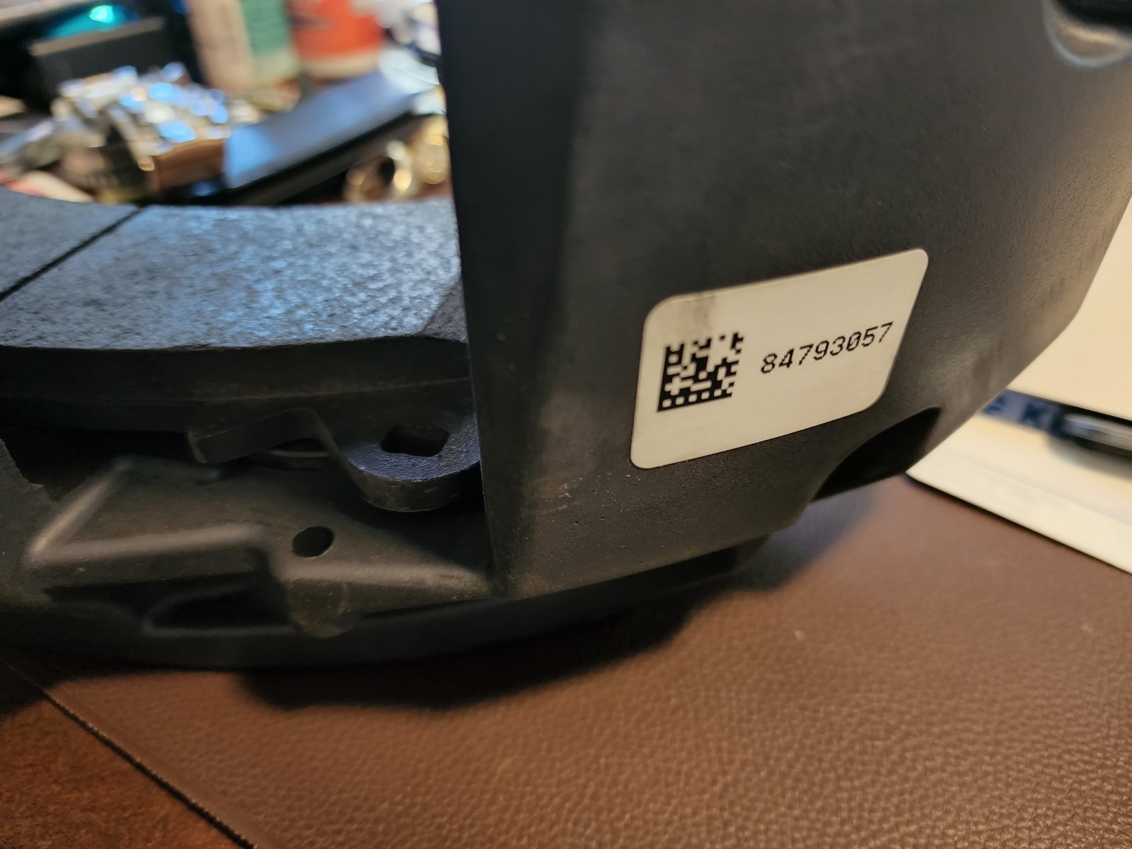

So here are the calipers
. They are huge!
THarber
Jun 4, 2021
307
284
Also I can confirm as previously posted, aftermarket pads will not fit. As you can see, the holes for the slide pins do not align. I have GM pads on order.
