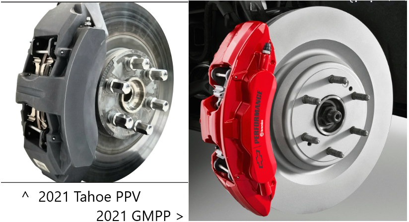

These are the largest brakes available using OEM parts. The rotors come in at 410mm. This setup is basically the same as the GM Performance Brakes upgrade via PN 85138043, except the calipers aren't painted red, and the design of the caliper is slightly different. It's also 50% of the cost coming in at under $1200.
This setup was used primarily on the 2021 Tahoe PPV, but it appears to be some kind of option on 2021 Escalade 3.0 Diesels based on part fitment data. Differing from the GM Performance setup, these calipers have a larger cross brace on the top

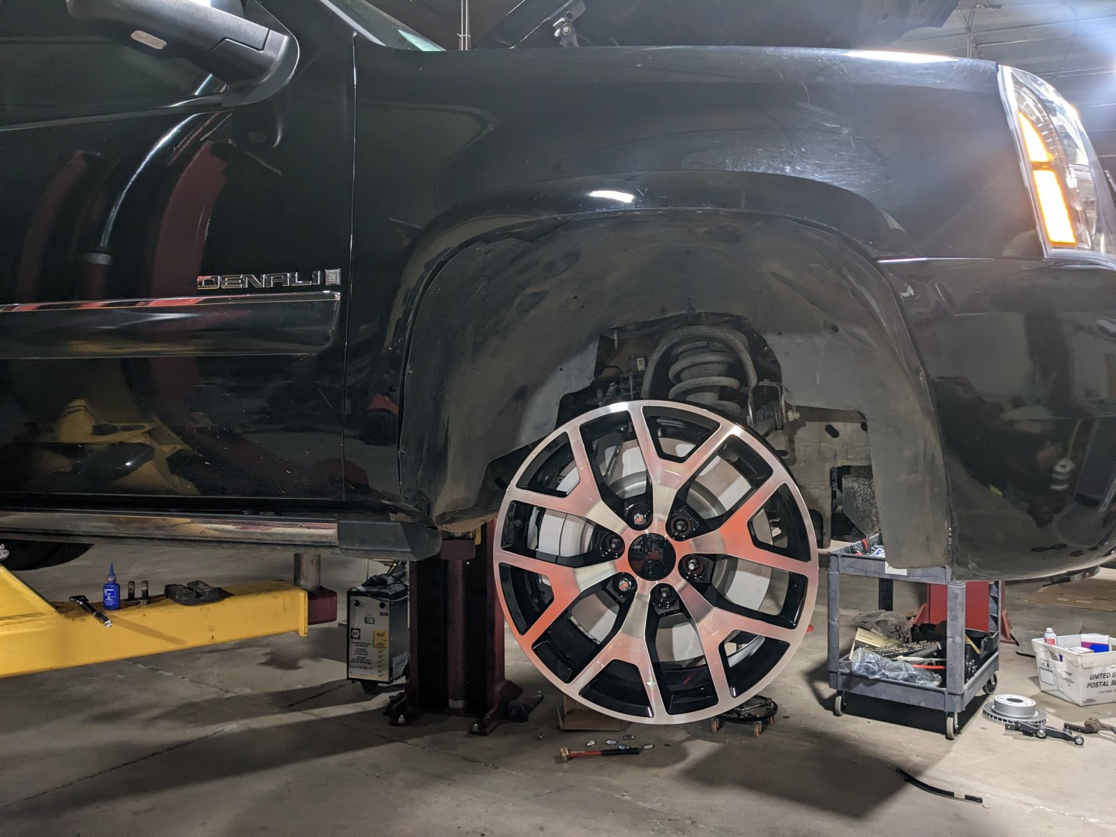

Wheel choice is going to be a big variable. GM says 20 and 22 OE wheels will fit the brakes, from a diameter perspective. It's going to be in the offset and the design of the spokes that things can cause problems. Here they are fitted to a set of '12-14 Escalade 22" wheels which have 31mm offset and they clear with ease. I'll have another test coming with 27mm offset 20" honeycomb wheels.

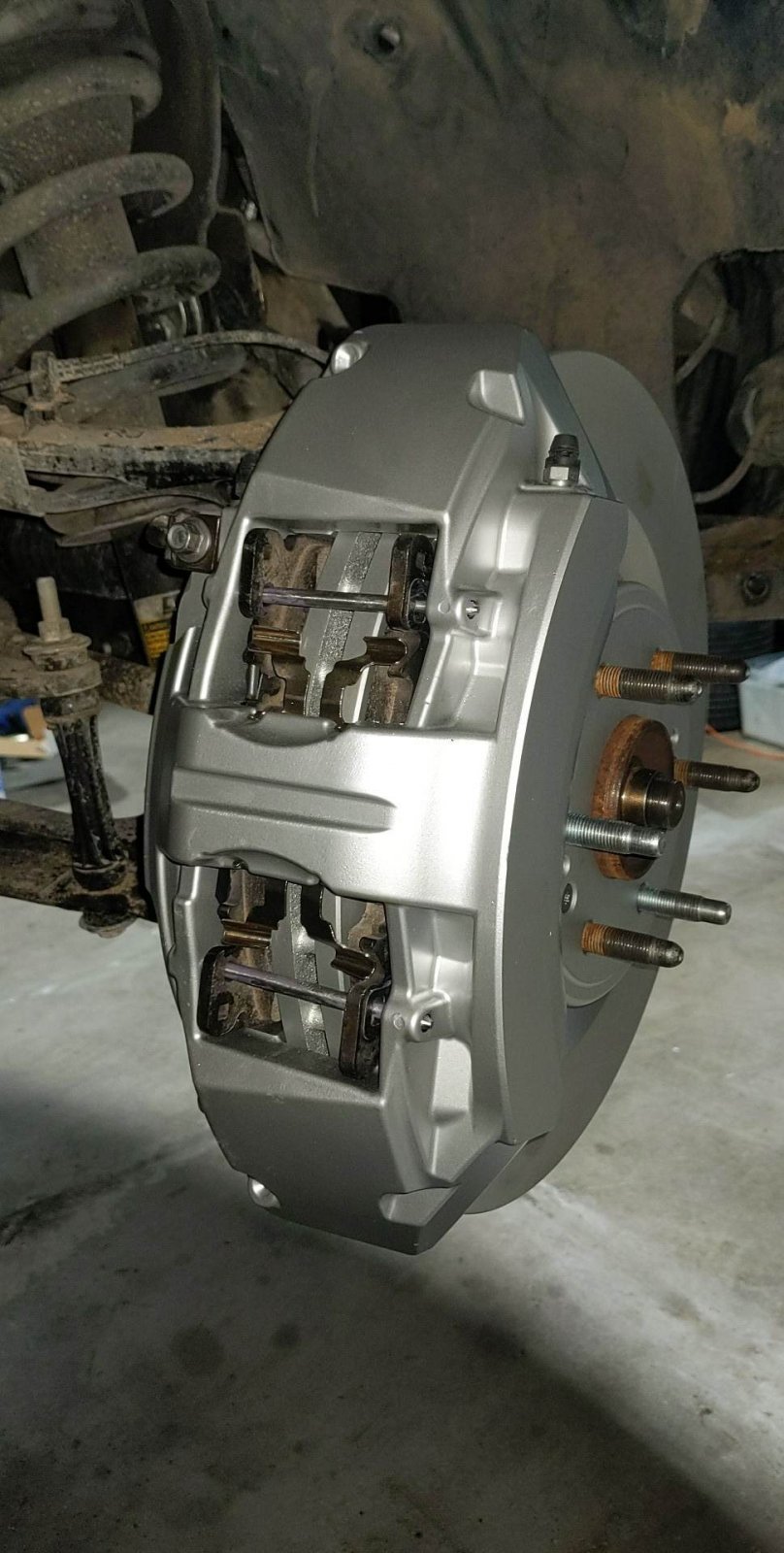

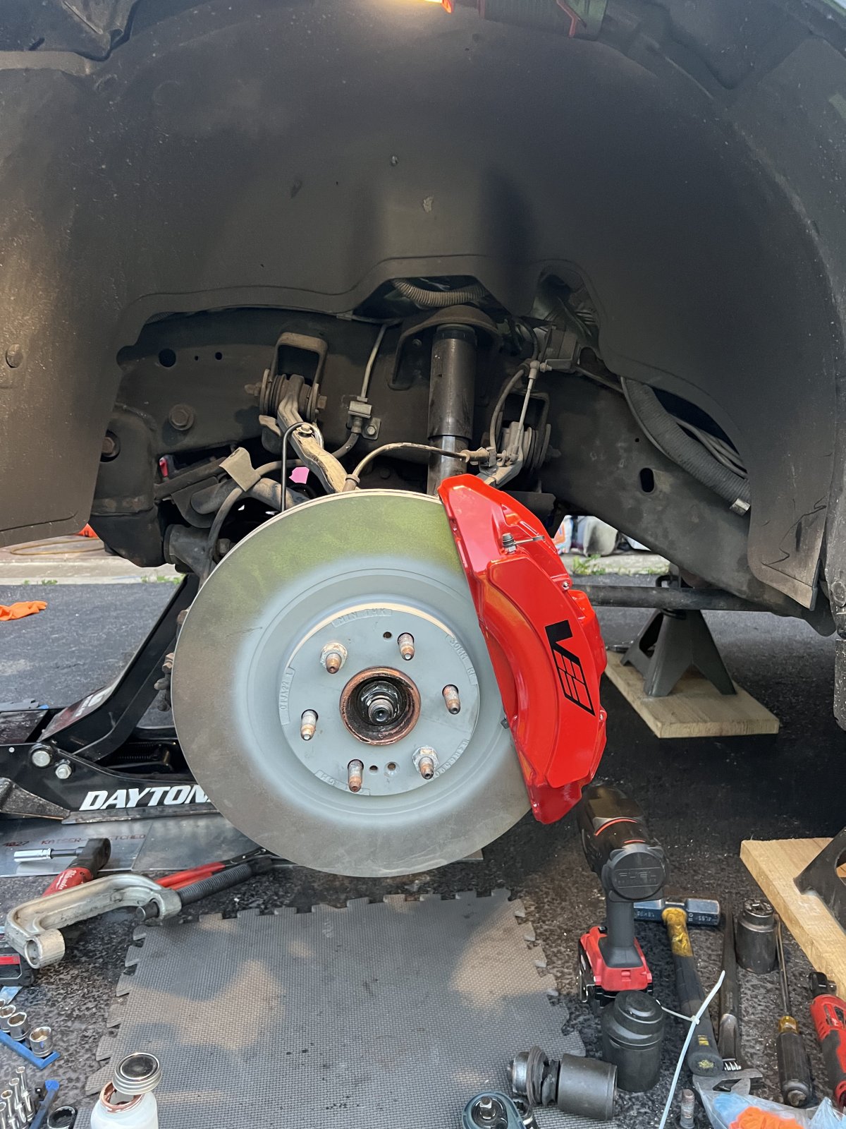

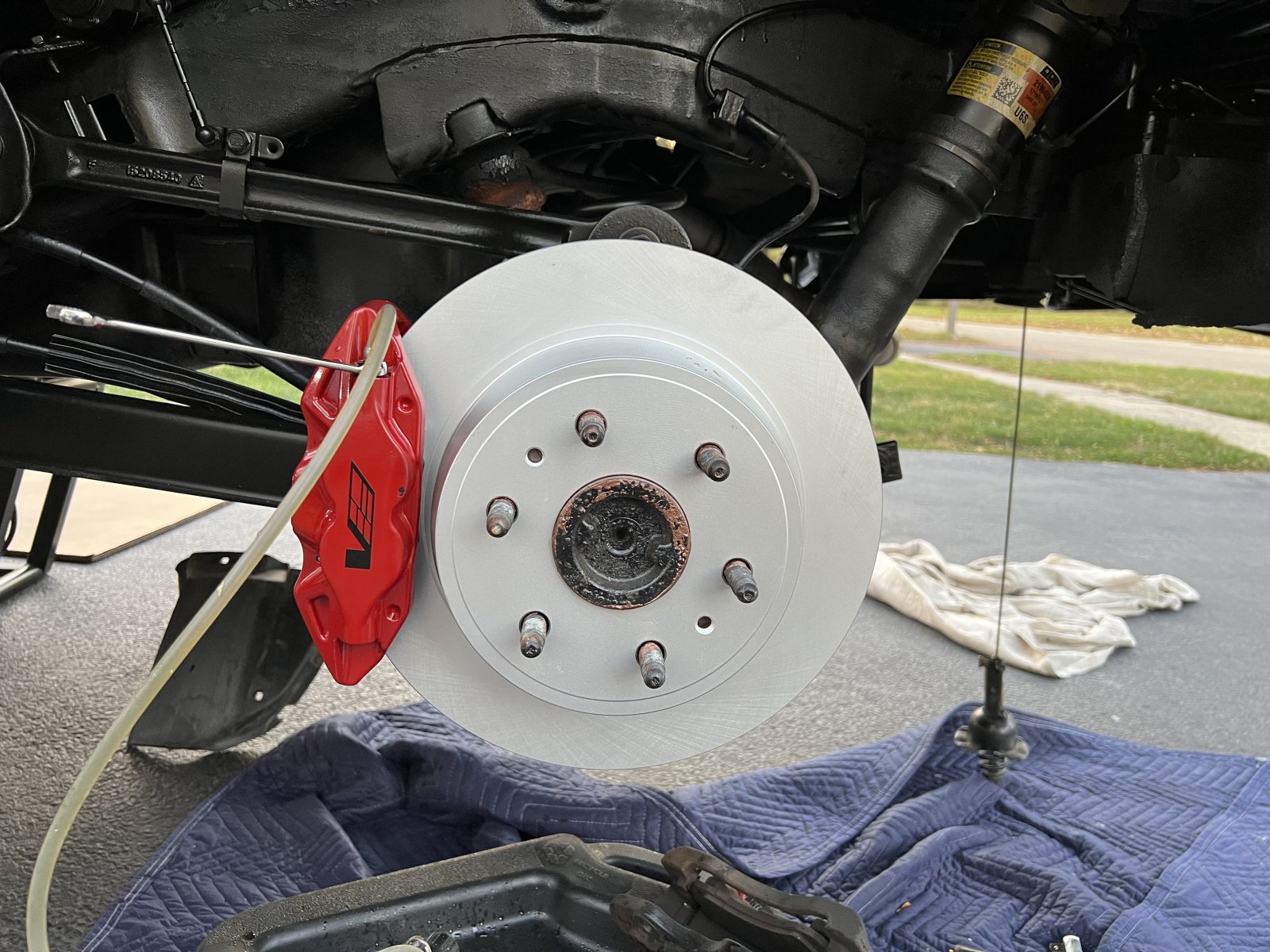

In the middle of the install of the 2021 Tahoe PPV 6 piston Brembo front brakes on my 2007 Yukon Denali XL. So far everything is fitting perfect. Just have them bolted up for a test fit and they clear my Escalade 22s with ease (offset is 31mm). I have a set of 20" Sierra Honeycomb wheels arriving tomorrow so I'll follow up with the fitment on those (offset 27mm). Hopefully will have time tonight to finish the install and bleed the brakes.
Here are some pictures so far. I did paint the calipers silver instead of the black they came in. Pads are still on the FedEx truck so no pads in there yet. Might have to install a shim to center the caliper, unknown until I get the pads in there.

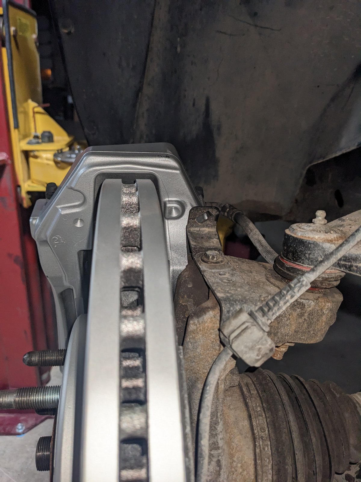

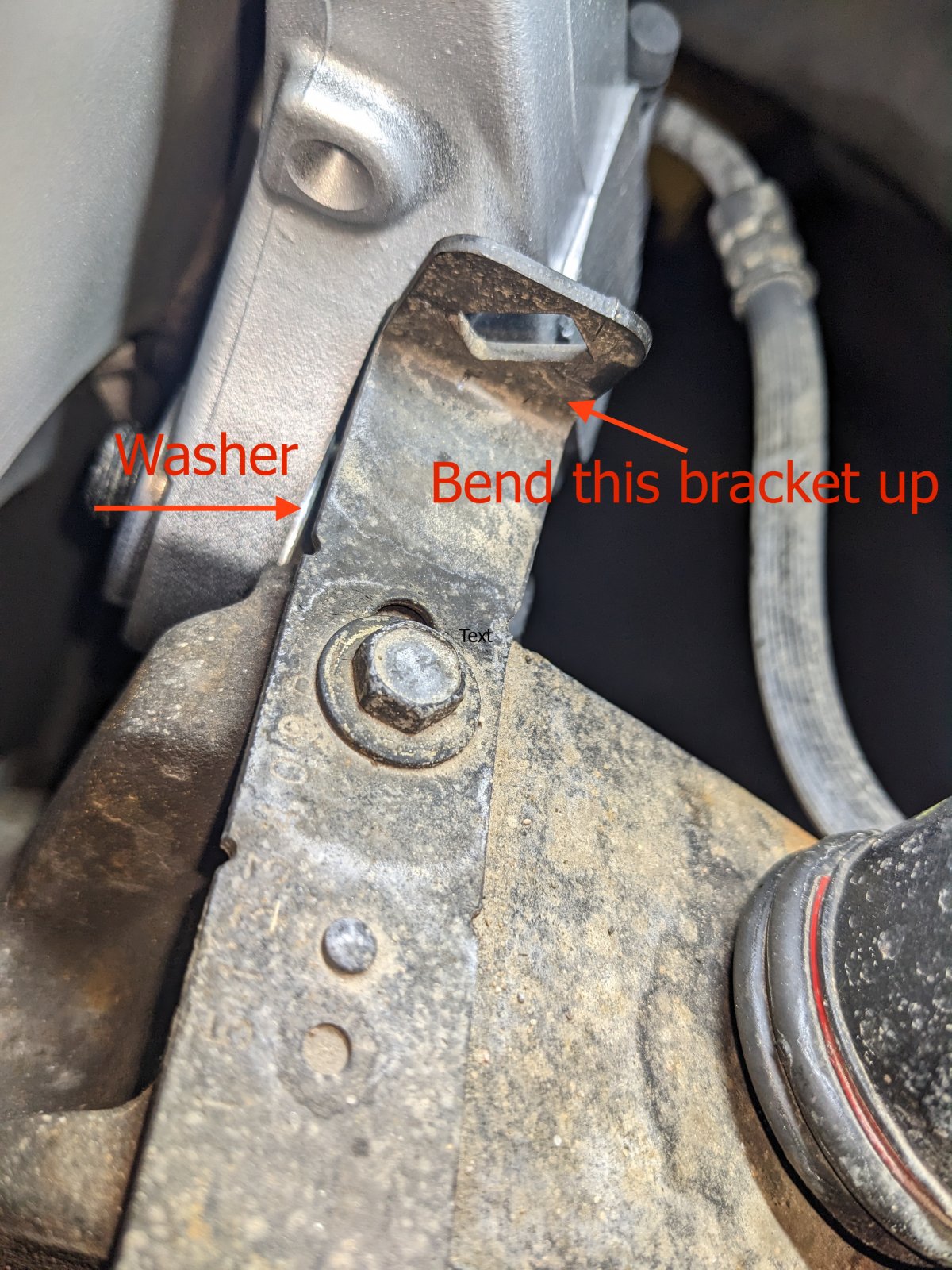

On my 2007 a thin fender washer was needed to center the caliper on the rotor. The washer is about the thickness of a dime with a 9/16" center hole. My hardware store didn't have the right size in the thickness (thinness) that was needed so I got thin 3/8" center hole washers and drilled the hole out with a 9/16" bit. Worked perfect.
The bracket on top of the knuckle needs to be bent ever so slightly.
The stock brake hoses fit perfectly fine using the banjo bolts and crush washers listed.

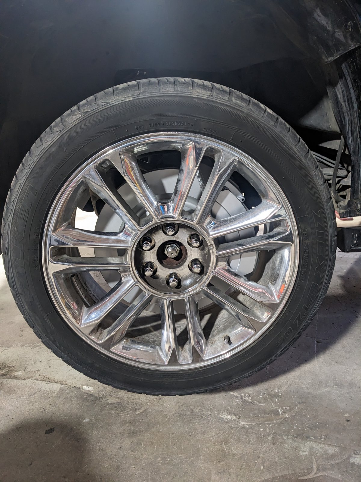

Sweet! What year Escalade 22" rims are those?

2012-2014. GM part number 22755314.
Thank you!
I ask, because other than yours are polished/plated, those are the 22” rims on my 2013 Escalade ESV Premium.

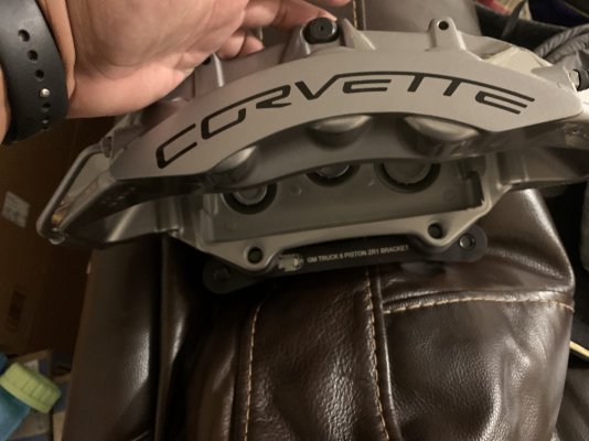

Nicely done and worth of a sticky if I say so myself. Hopefully GM will continue down this road and offer a bolt on kit for the rear brakes.
Until then, there is a kit available to add C7 Vette calipers to the rear using the OEM discs.
Here’s the link from the EXT the kit was put on that’s adding a little hp upgrade.

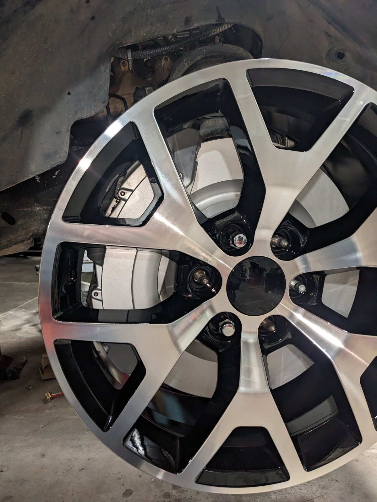

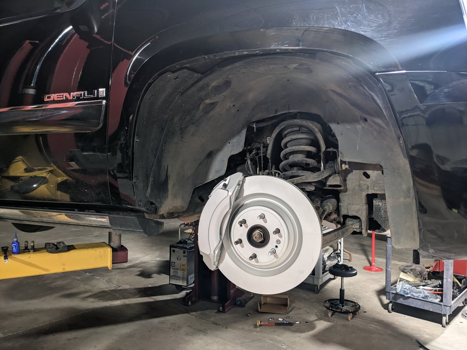

The Sierra Honeycomb 20" wheels clear with ease as well. There is more than a fingers worth of room between the spokes and the caliper.

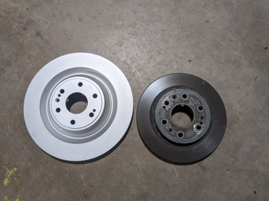

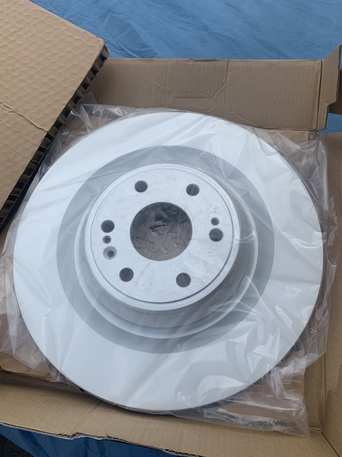

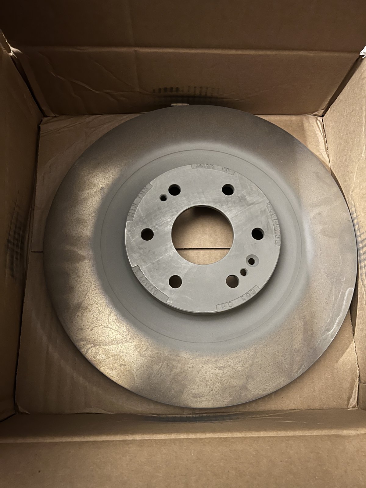

Hi from my knowledge you’re using the 6 piston wrong rotor for that set up. I did the ppv calipers too but I order oem ppv rotors no one made them 1 year go when I did the swap. But now power stop makes them and raybestos and gm discontinued the #84865905. And the rotor you bought are for gm brembo 6 piston upgrade kit that use 16” rotor not the HEAVY DUTY ppv. The braking surface is different from 2.5” to the ppv rotor being 3” and how I know because I bought Dynamic Friction 604-47079 but to do the ctsvbrakeswap.com zr1 brake conversion and I compared both they are very similar. I’m sure you won’t have problem just that your pad probably over hanging and not making 100% contact.

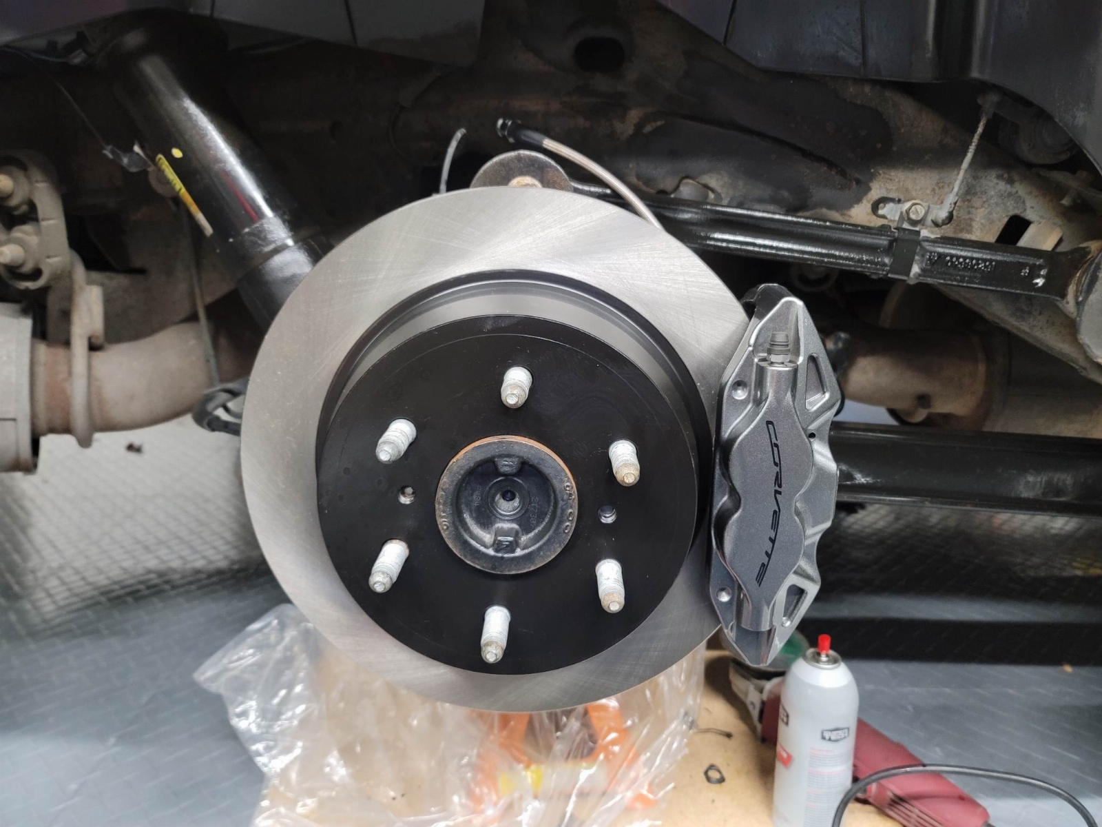

I also did the rear c7 upgrade
Good to know, I will inspect it tomorrow to see if the pad is slightly too large for the rotor. I'll report back.
Done about 300 miles and this setup makes the braking effortless on this truck. Love it.
I don't see the overhang at all. Maybe you used different pads but the pads I used are perfectly flush with the edge of the rotor. They are the right pads for these rotors.

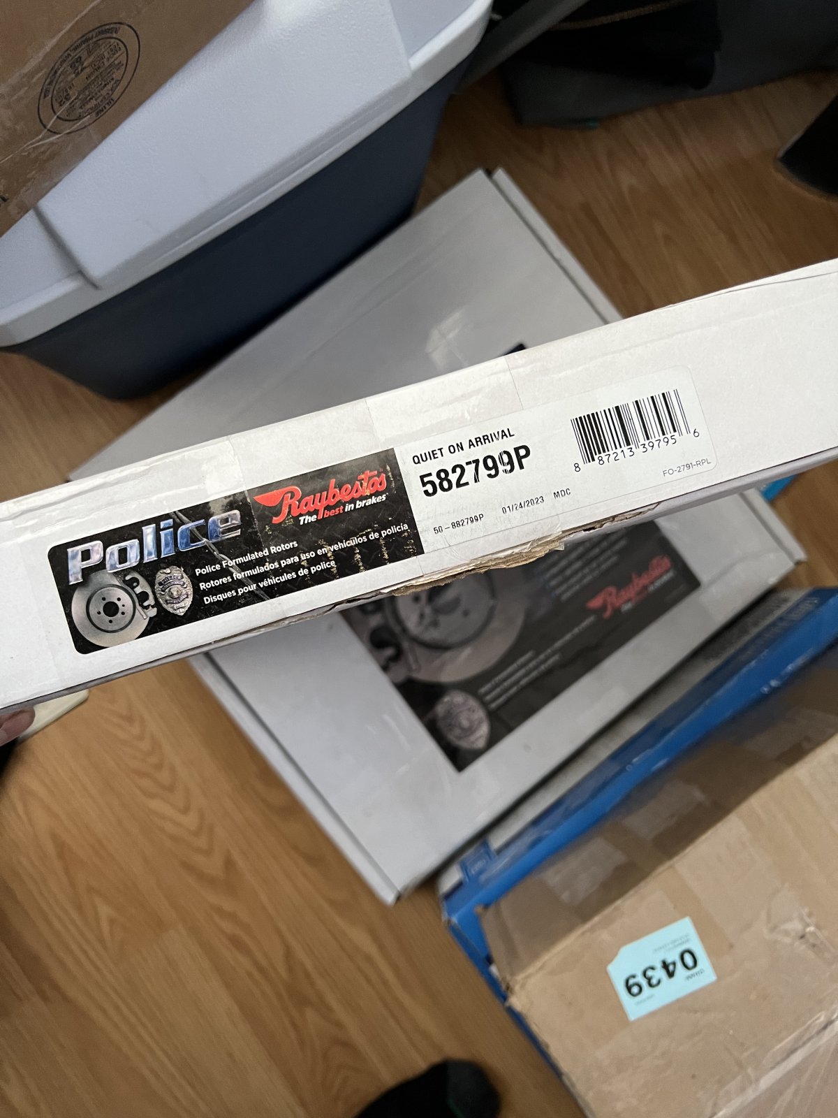

What is the part number of the Power Stop and Raybestos rotors?
Redkeys
Feb 2, 2023
15
RAYBESTOS Part # 582799P
Powerstop Part # AR82209XPR
Auto specialty has them to but I don’t like uncoated rotors I like the coated rotors they last longer with out getting rusted right away
AUTOSPECIALTY AR82209
