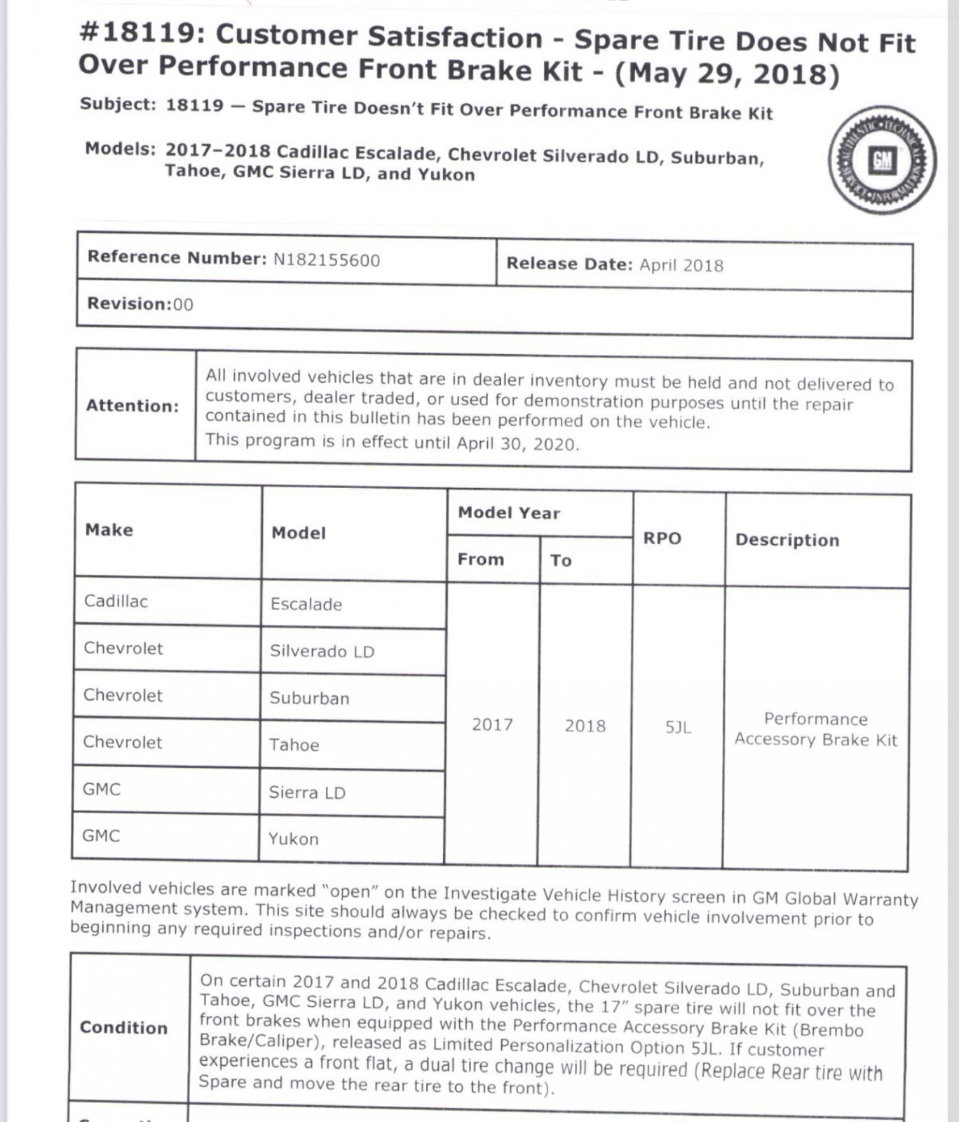

20 inch won't fit in the 18in slot I tried
The overall diameter of the spare wheel and tire should be the same as the rest of your alloy wheels and tire combos. With that I'm confused why a larger wheel will not fit in the spare spot. You have to use a thinner tire with a larger wheel to achieve the same overall diameter.
This is the part that concerns me the most. Does the spare tire area not accommodate a tire/wheel assembly that is wider (regular size tire) than the original spare? I would think the diameter of the spare and regular wheel/tire is the same.
