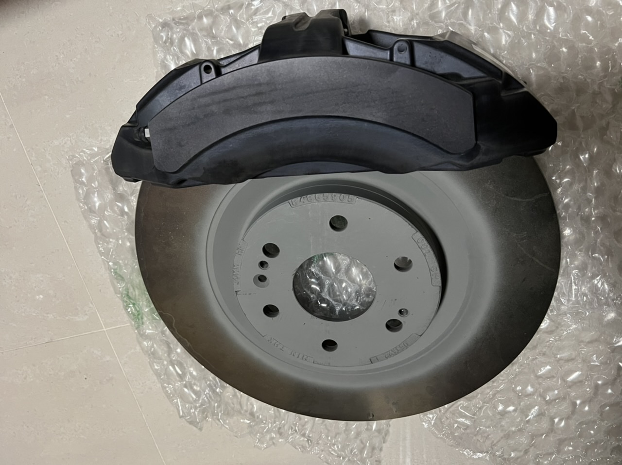

I painted the calipers with VHT caliper paint and clear. I also painted the backing plates black, not pictured but they were not coated so I didn't want them to rust. Backing plates are a bolt on, no modifications at all.

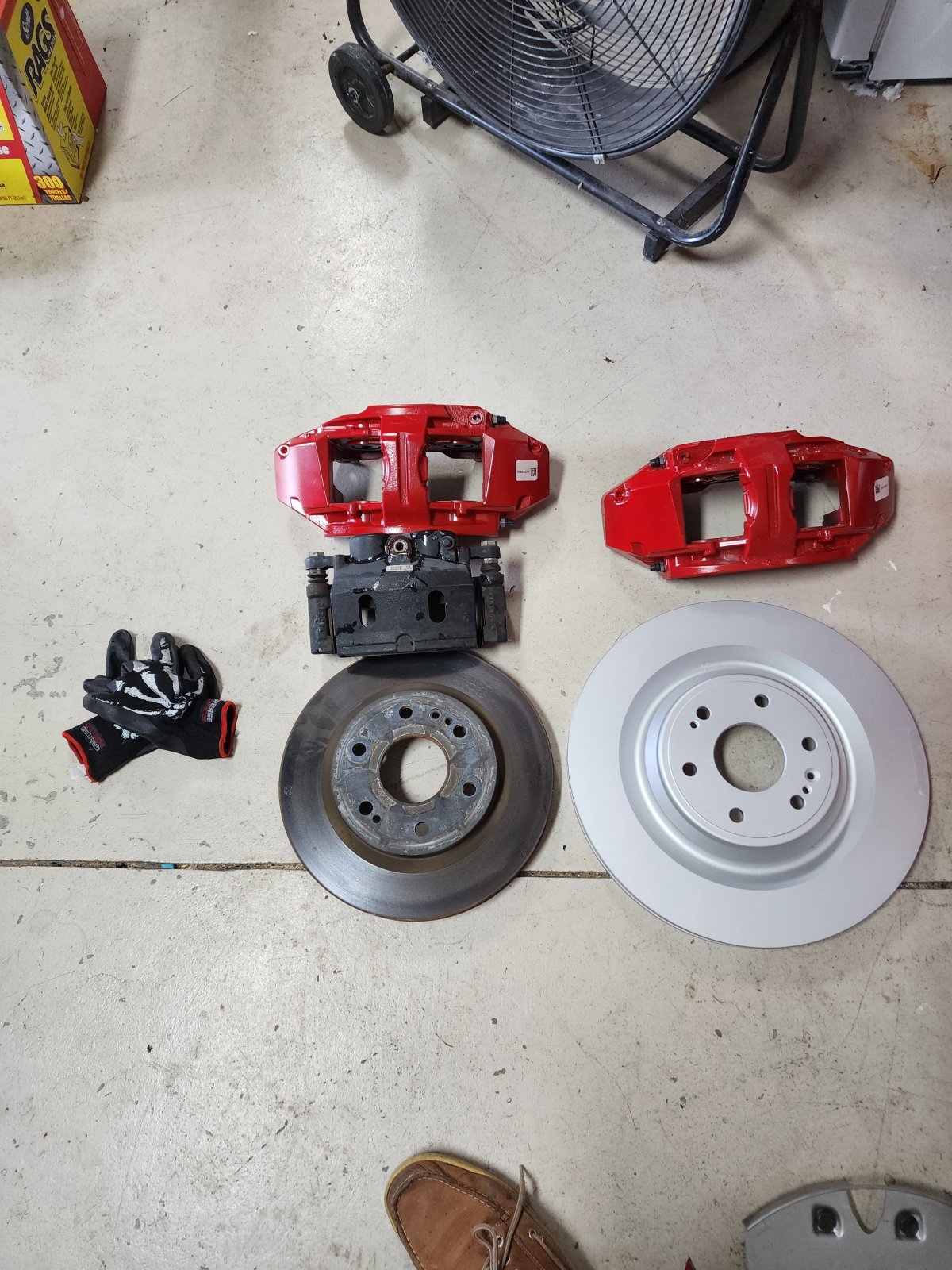

This set up will give you 6 piston Brembo calipers and 16" disk brakes for the front of your truck. This was purchased for my 2019 Yukon but might fit others. They would not clear my wheel so my loss is your gain. To the best of my knowledge you will need a 28mm offset wheel or greater for this to work but that is a guess!
I have approx $1600 into it with shipping and taxes. Prices below are approx. I can send you receipts.
Rotors #604-47086 Dynamic Friction $285
Calipers #84793057 and 58 $830
Pad pins #85153957@2 and Brake Shields #84763236 and 35 $101
AcDelco Pads #84997498 $358
Banjo bolts $10
I'll also throw in Powerstop rear ceramic brake pads.
I painted and cleared calipers, not professional but I used caliper paint as well as the backing plates. I mounted one as test fit, it had fluid in it but never got it close enough to bleed. The other one was not touched. Prefer local pick up in Central FL. $1300 or best offer
