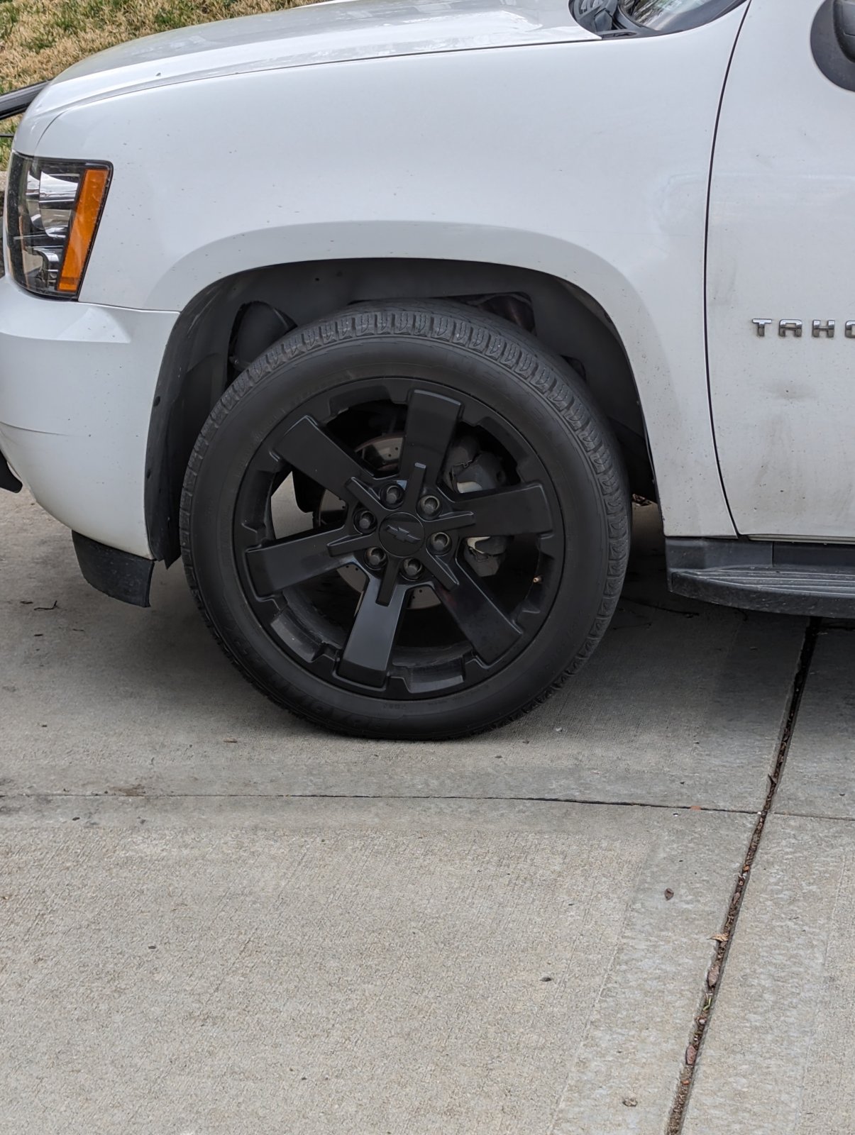

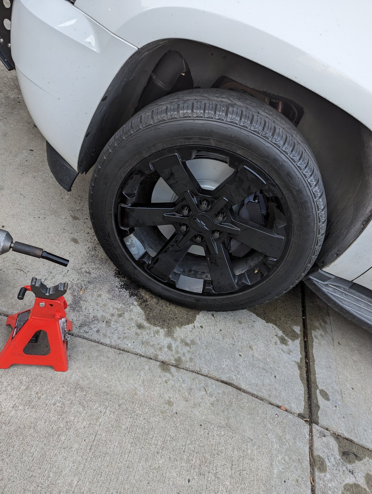

just adding wheels to the list that don't clear. these are 22" x 9" with a 24 offset factory wheels. ended up having to install longer lugs and a 12mm spacer

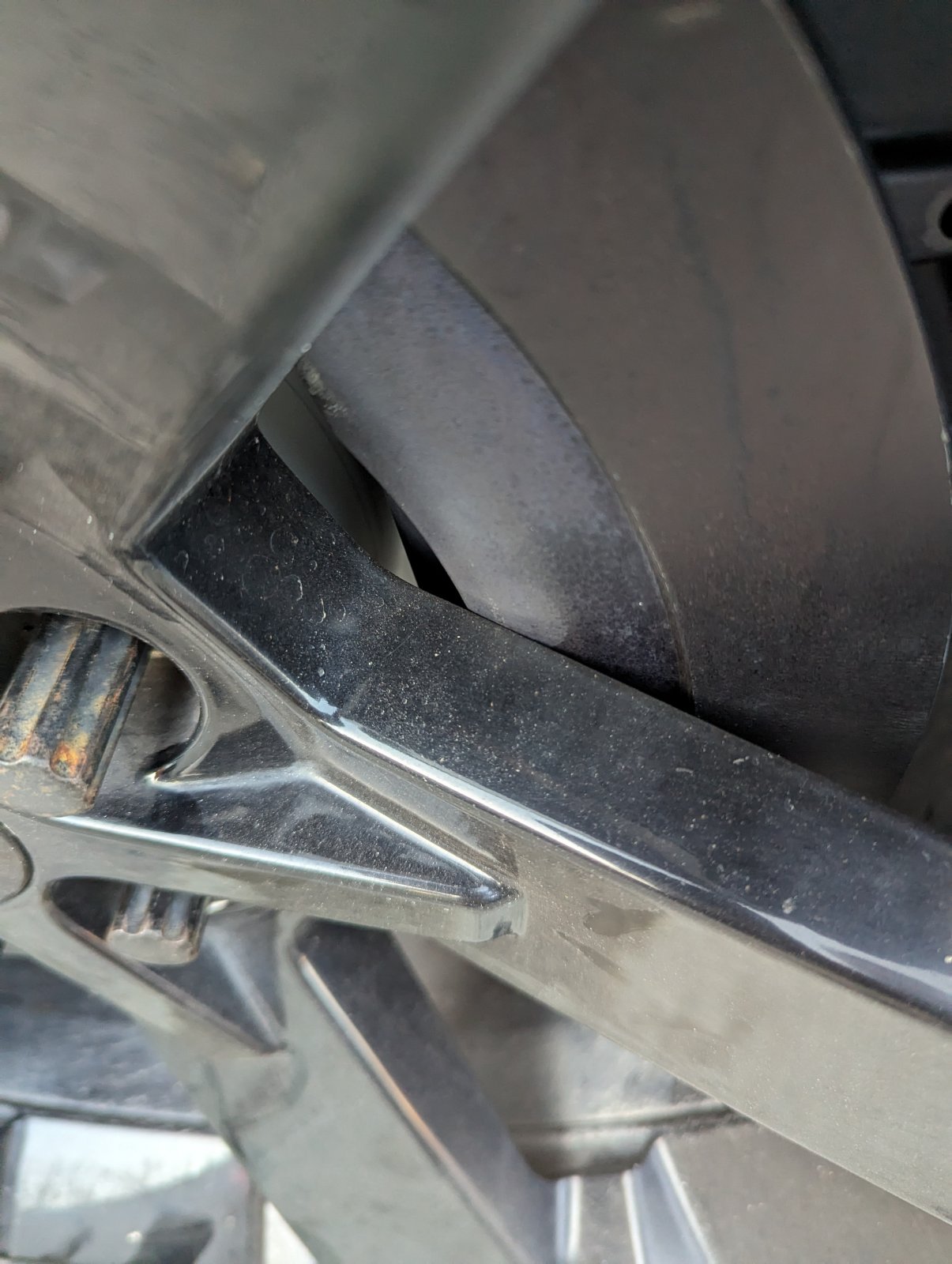

Two questions for the guys who have done it. Have you noticed the brake line extending to almost maximum stretch when you turn the wheel to full lock? Has anyone run the stock 2007 Escalade wheels with these brakes? Looks like it clears by maybe 1/16" of an inch from the spokes.
Thanks guys for this thread
I just scored this brake setup from the junkyard and was searching everywhere to see if they’d clear my stock Escalade wheels. This picture made my day lol
