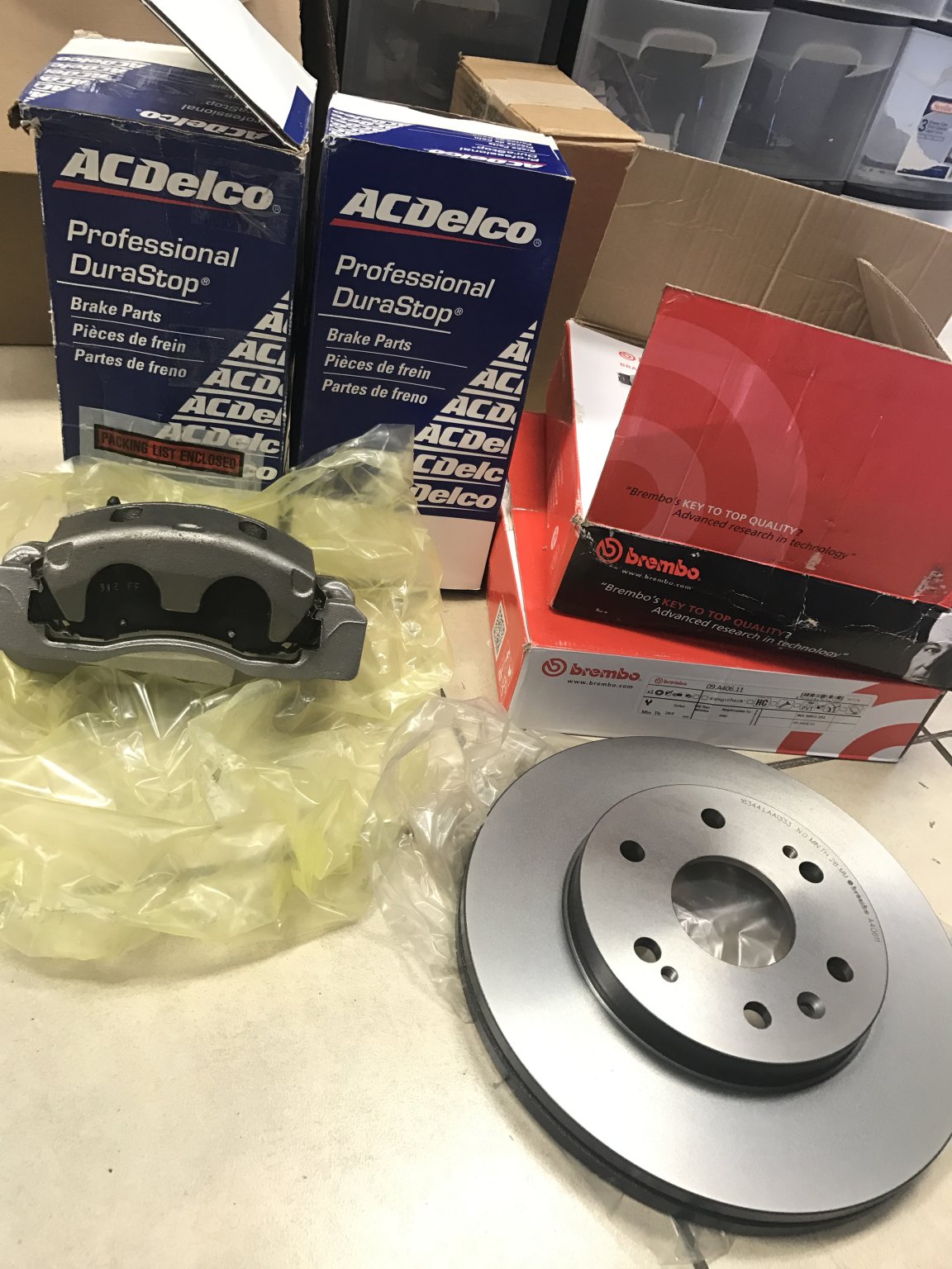

I received my AC Delco / Amazon rebate today for the calipers even though I returned the GMT800's instead of the GMT900's. So either they didn't care or they didn't notice. It did take almost a month.

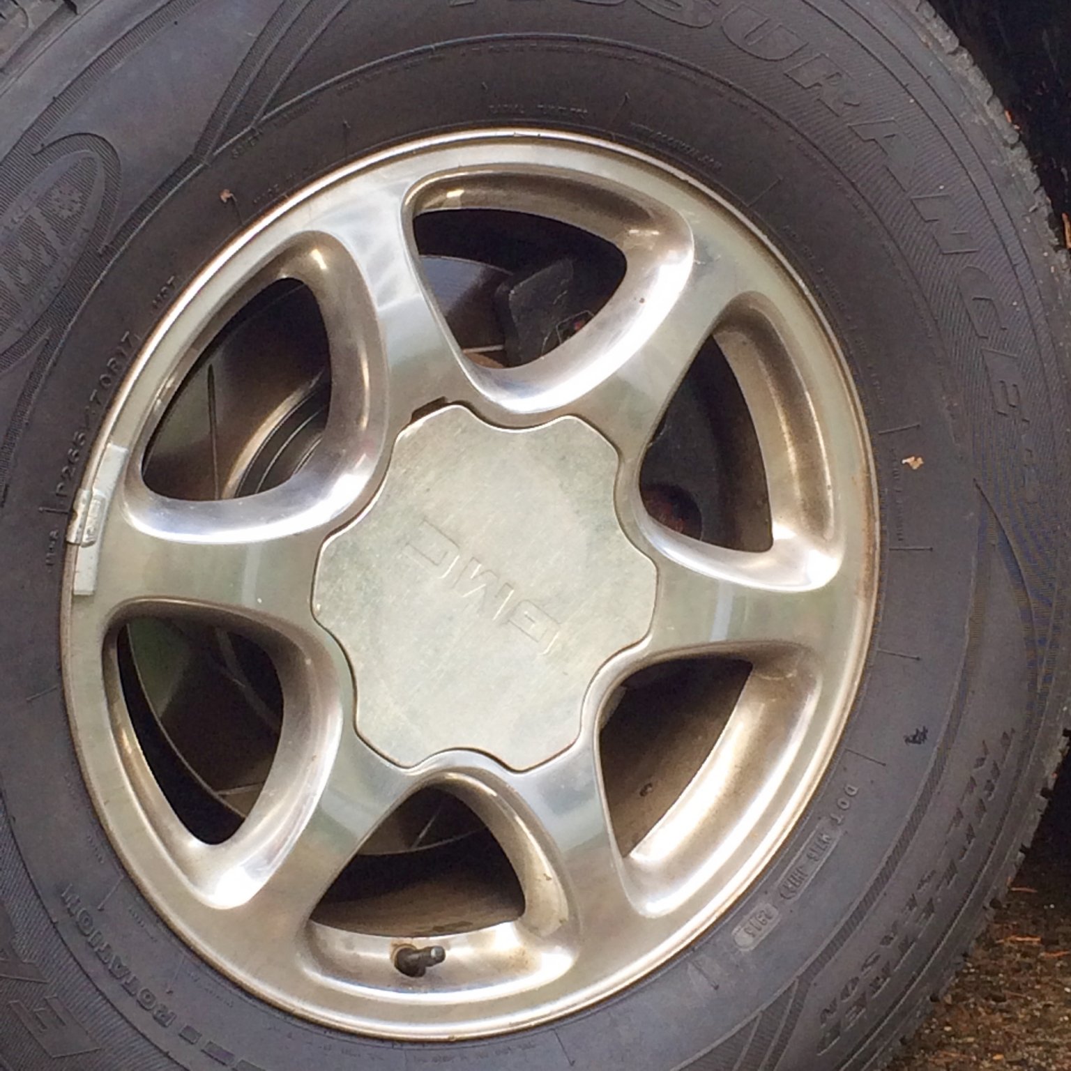

I believe 17's clear but not 16's. Didn't you do the upgrade while you had 17's @1992rs ?
1992rs
May 8, 2015
287
218
OR
@Red Rocket & @TheAutumnWind are correct. I did the GMT-900 (NNBS) upgrade when I was on stock Denali 17's. There's no way you could fit a 14" rotor. I didn't take any measurements but I'm betting there was maybe half an inch of clearance between caliper and wheel. The only thing I miss about the 17's, it looked pretty aggressive.

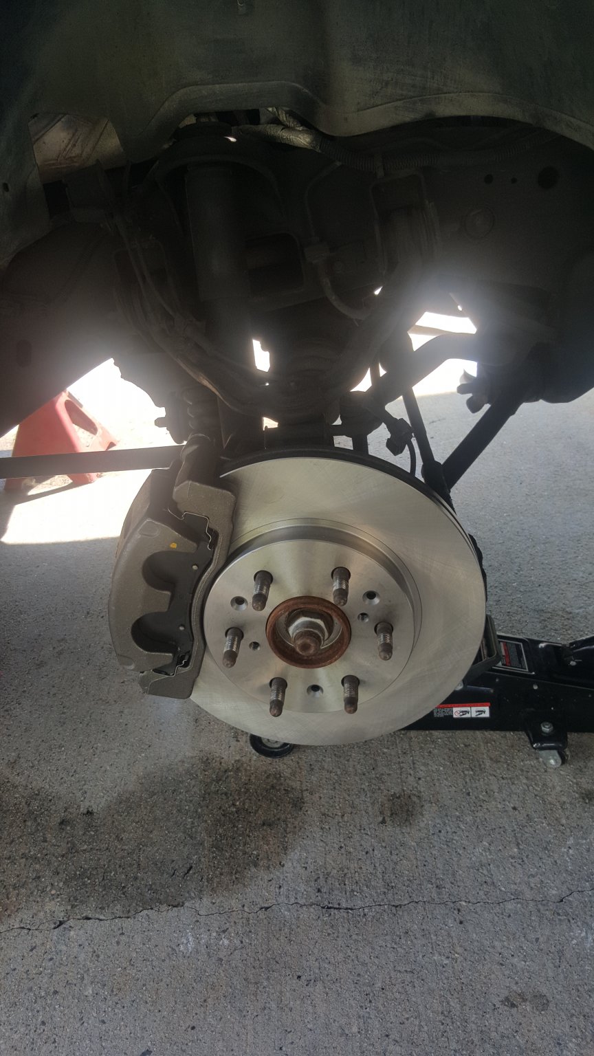

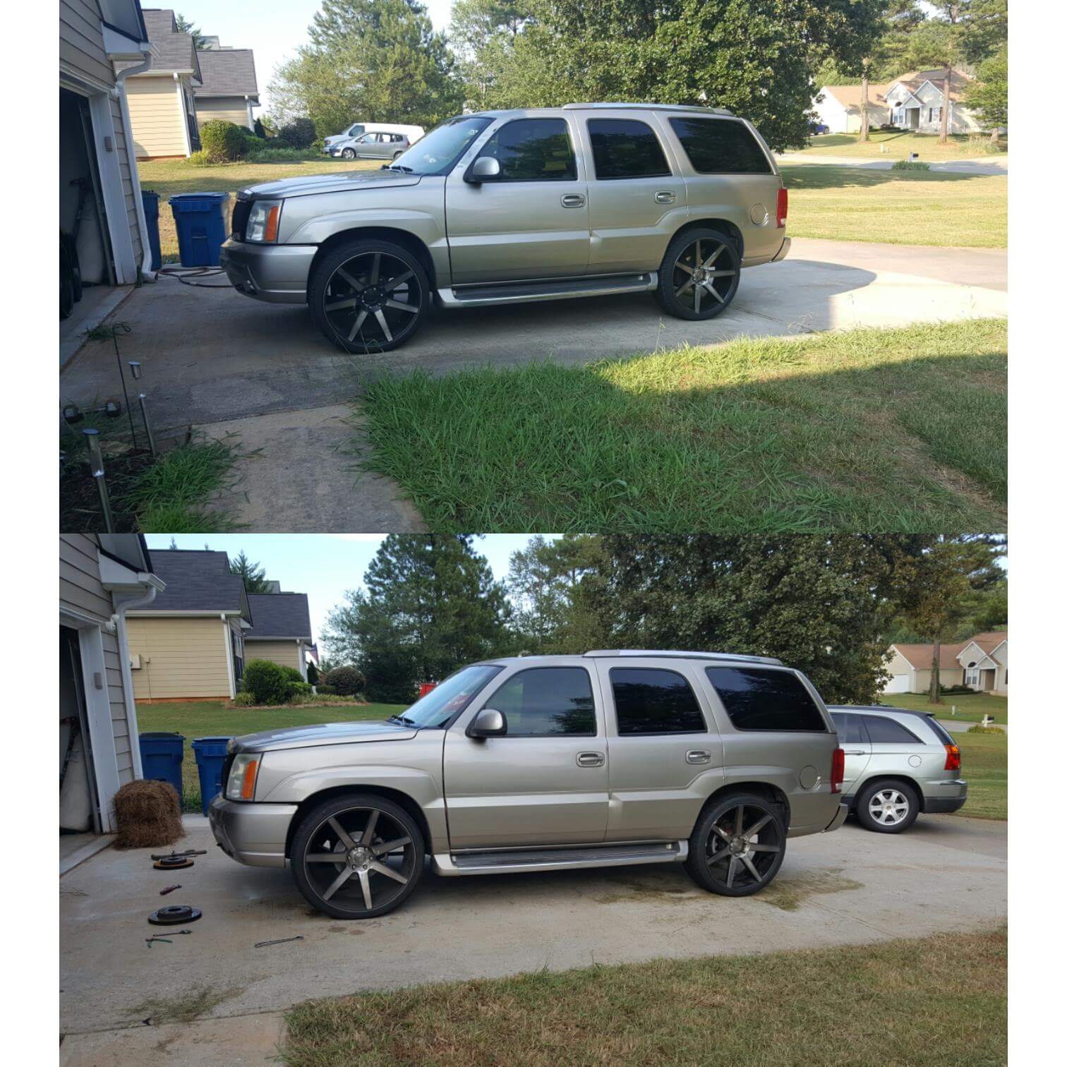

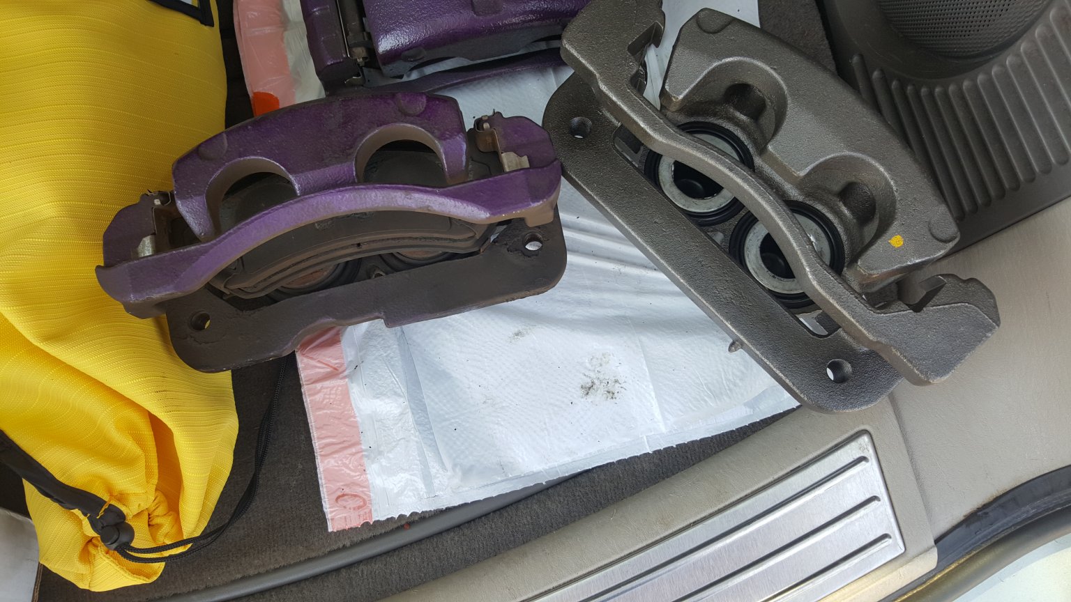

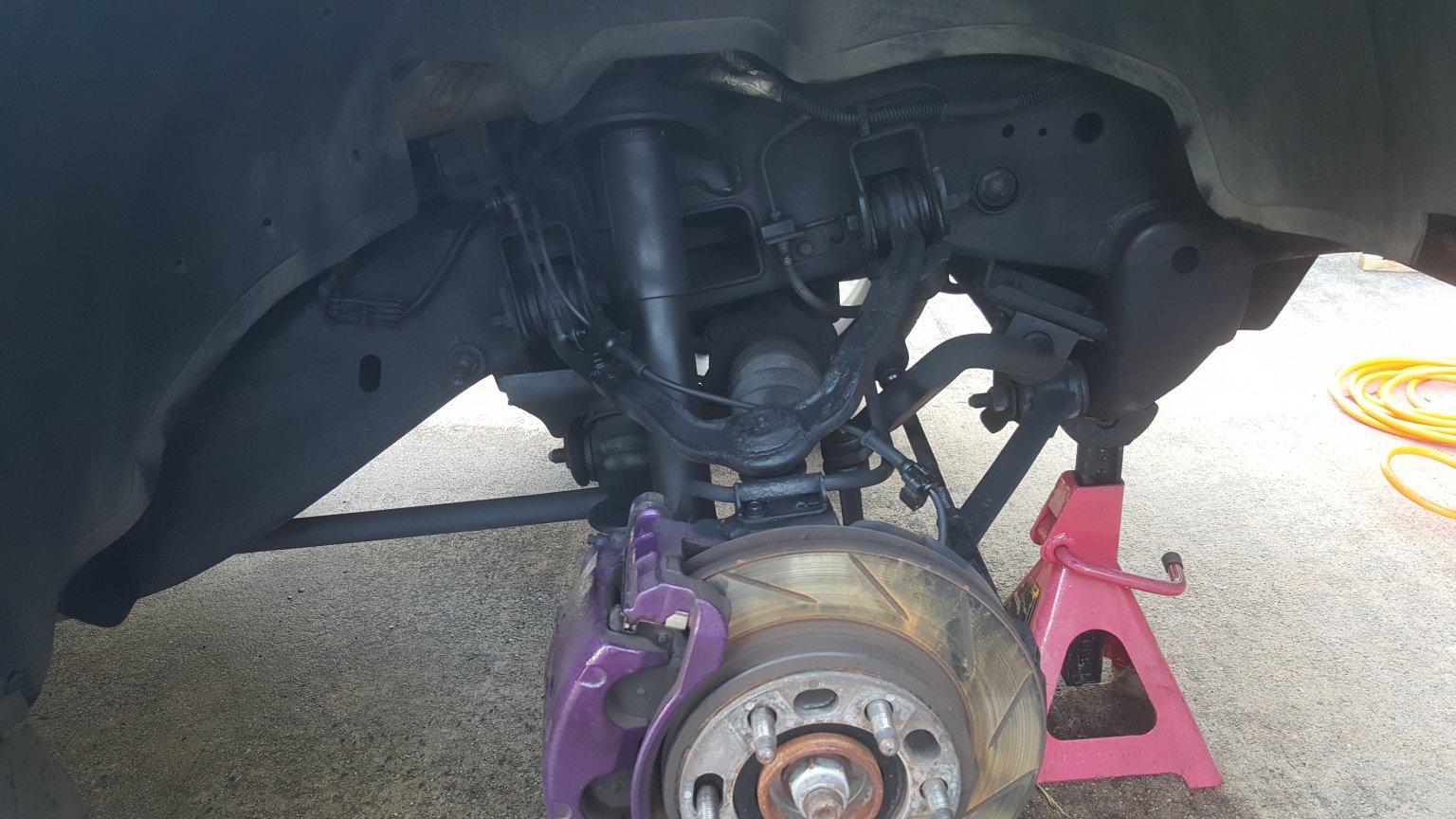

So I did the upgrade. Rotors, pads, calipers and brackets all from a 2007 Tahoe. Everything bolted on as this thread suggests.

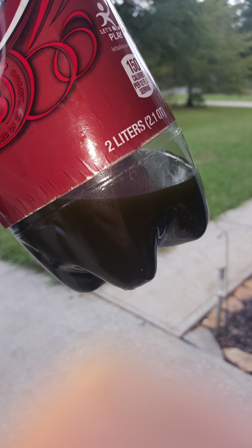

The brakes feel amazing. The truck stops hard and I no longer have a terrible shake in the wheel when I have to get on them hard. I was also fighting a random ABS issue that seems to be fixed now. I attribute that to the disgusting fluid.
In the photos below, the purple calipers are OEM. My reason for replacing was that the bleeders were seized. You can tell by the brake fluid in the Dr. Pepper bottle that it was in desperate need of a flush.
Last photo is a before and after. I had to install new tie rod ends so I took the opportunity to take some load off the torsions and put it back to stock.

The brakes look so much better on the vehicles with big wheels!
What rotors did you go with? I personally am a fan of blanks over slotted/drilled options so I like that you went that route and found it to be an improvement!
I agree. The brakes behind the big wheels look much better.
The rotors and calipers are Brake Best brand from O'Reilly. I have a jobber account with them so the cost was my biggest concern.
