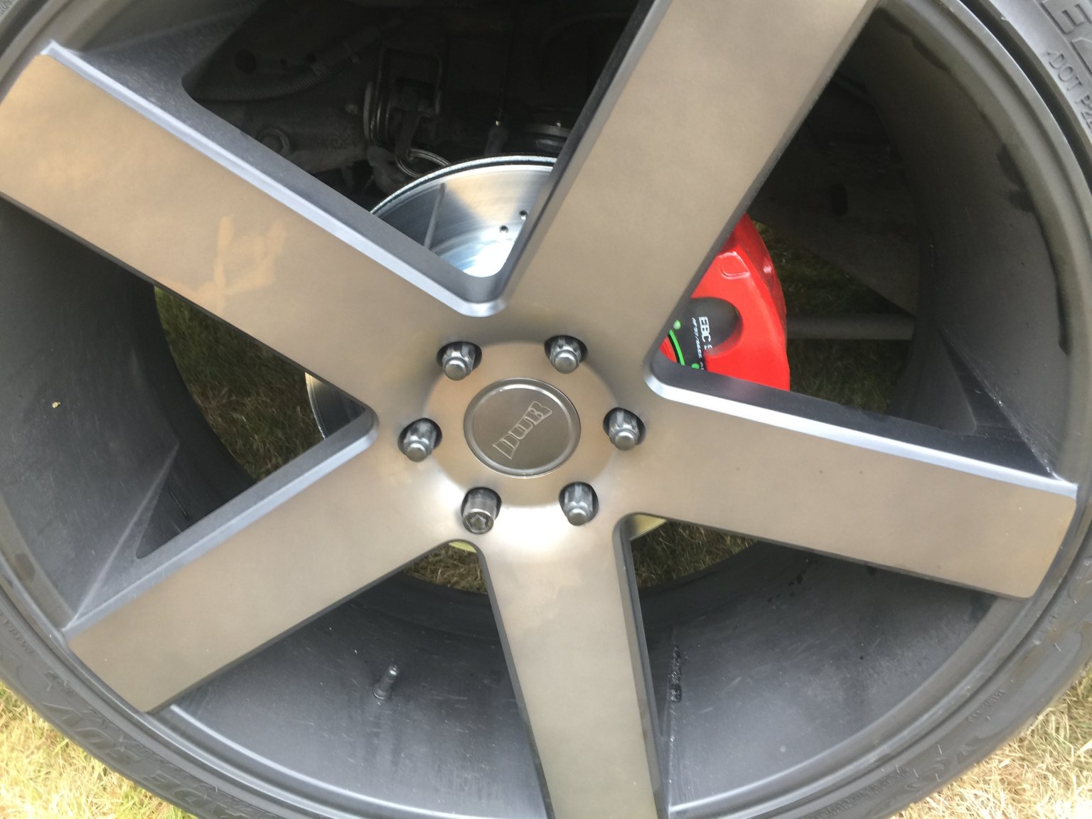

Ok, today I installed everything in the front and was going to wait on the rear lines for another day. I tried bleeding the fronts only and I'm failing. I'm not sure if I need to start at the rear and then do the fronts. I'm using a pneumatic bleeder and it seemed on the right front the bleeder valve was letting the bleeder suck air instead of from the line. It seemed loosely threaded, so I removed it and added pipe tape and reinstalled it. I think I'm getting all fluid now but it's hard to tell, the tube is translucent instead of being a clear tube. Before starting, I sucked the old fluid from the reservoir so I'm hoping I didn't get air in the system. so...any advice would be appreciated. I think I'll call it a day. Hopefully tomorrow I can get this done.
52,954
Tried it some more, replaced the hose with a clear one and started at the right rear, then left rear. Got clear fluid out of both so I'm sure new fluid got to the rear. No air bubbles and I pulled about 3/4 of a quart through there. Then I went to the right front and now I can see I'm getting mostly air. Same with left front, so I'm not sure if it's the bleeder valves leaking so I'm not getting good suction. Sorry to hijack the entire thread but I need help!

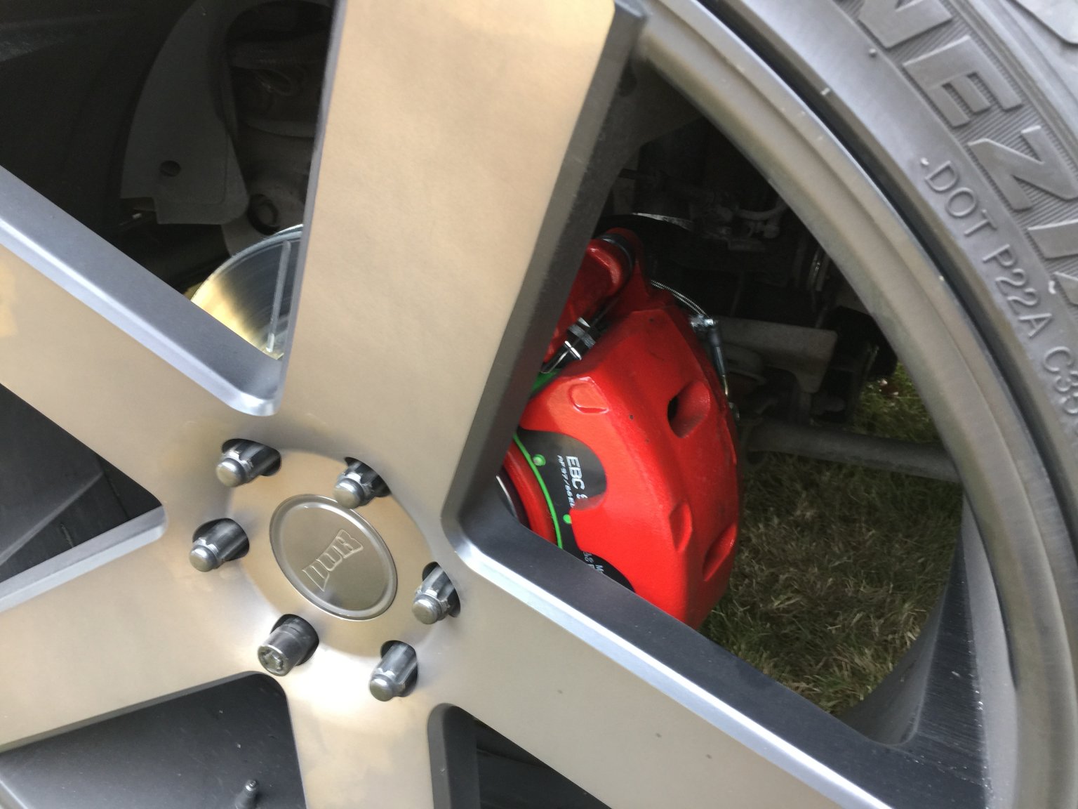

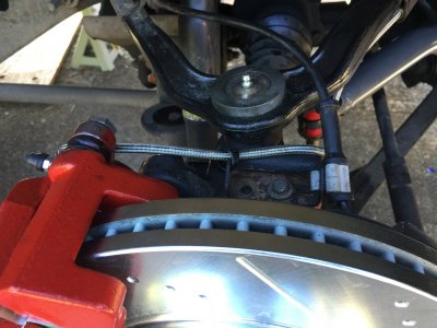

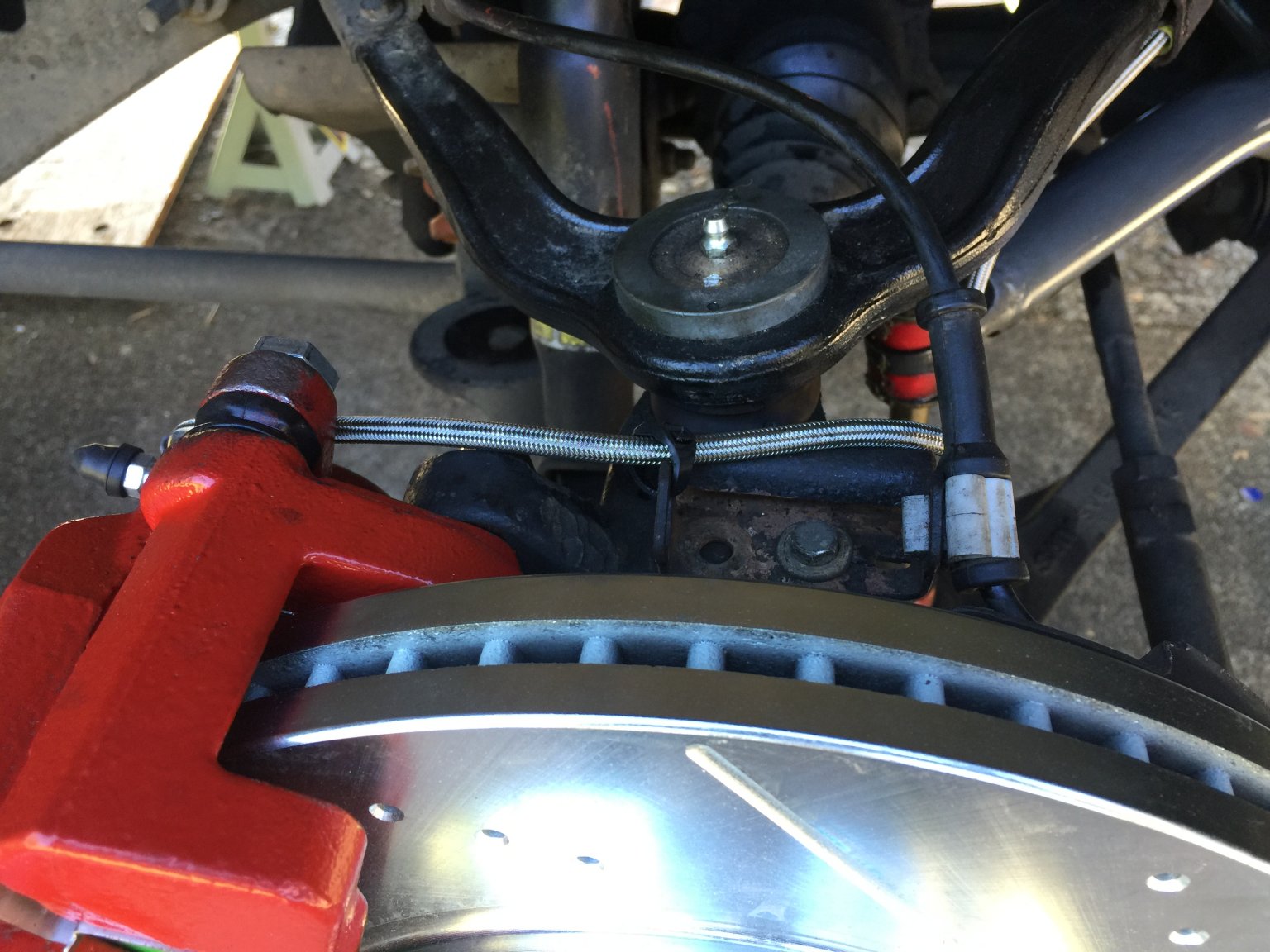

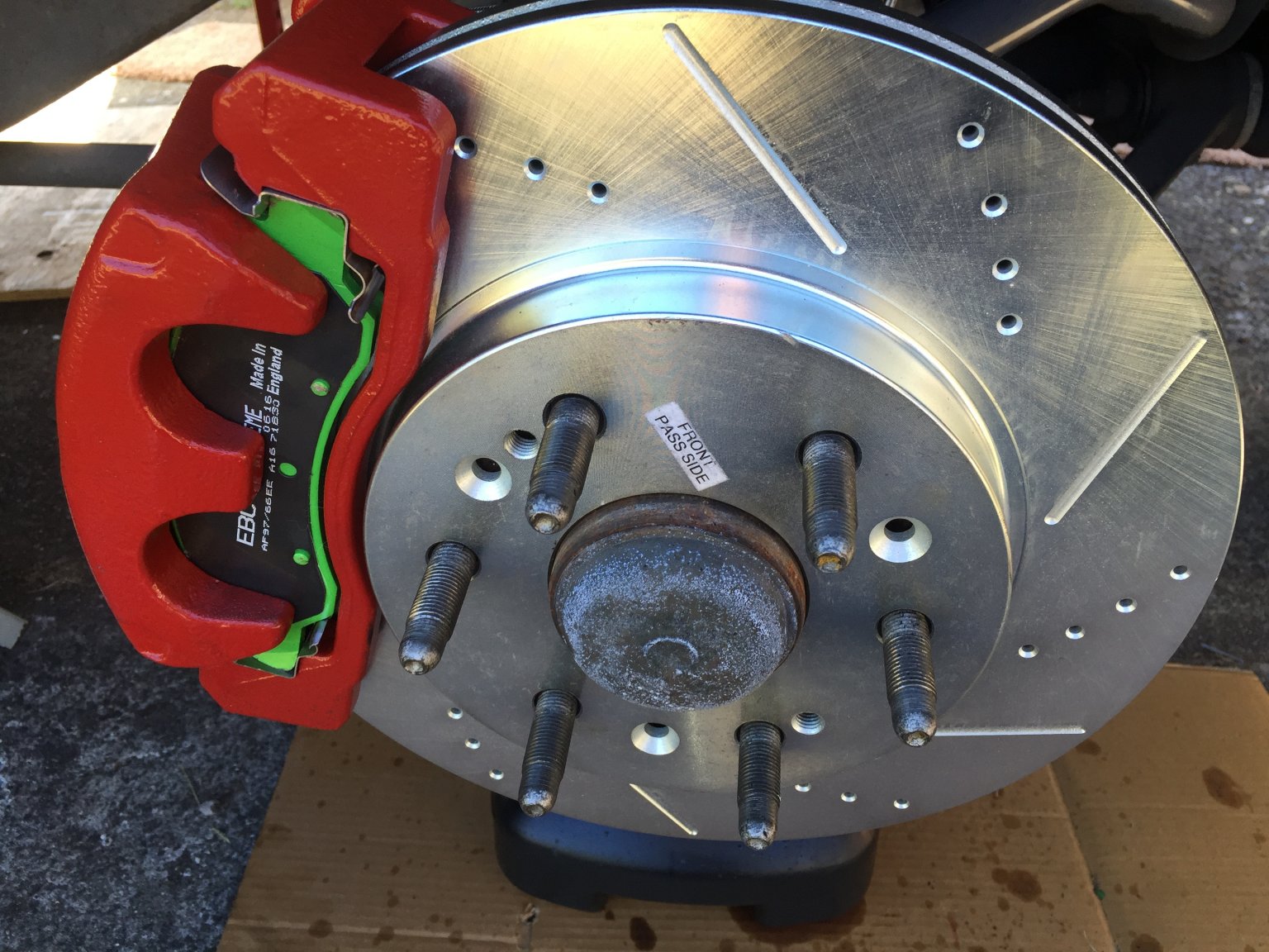

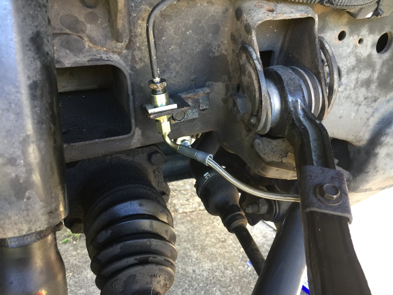

OK I finally got everything bled. I did the fronts the old-fashioned way: a hose stuck in a bottle of fluid, loosen the bleeder and pump the pedal until there's no more air. I could watch the driver side and for the passenger side, I just pumped about 1/2 quart through. Took it for a drive and so far so good but I can't do a hard stop until the pads are broken in. I'll keep updates coming. Looks great though! In the 3rd pic you can see I was able to reuse the factory clamp for the line by bending it open and then reclamping it on the protective Goodridge sleeve. IMG_5301.JPG IMG_5304.JPG IMG_5306.JPG IMG_5307.JPG IMG_5305.JPG

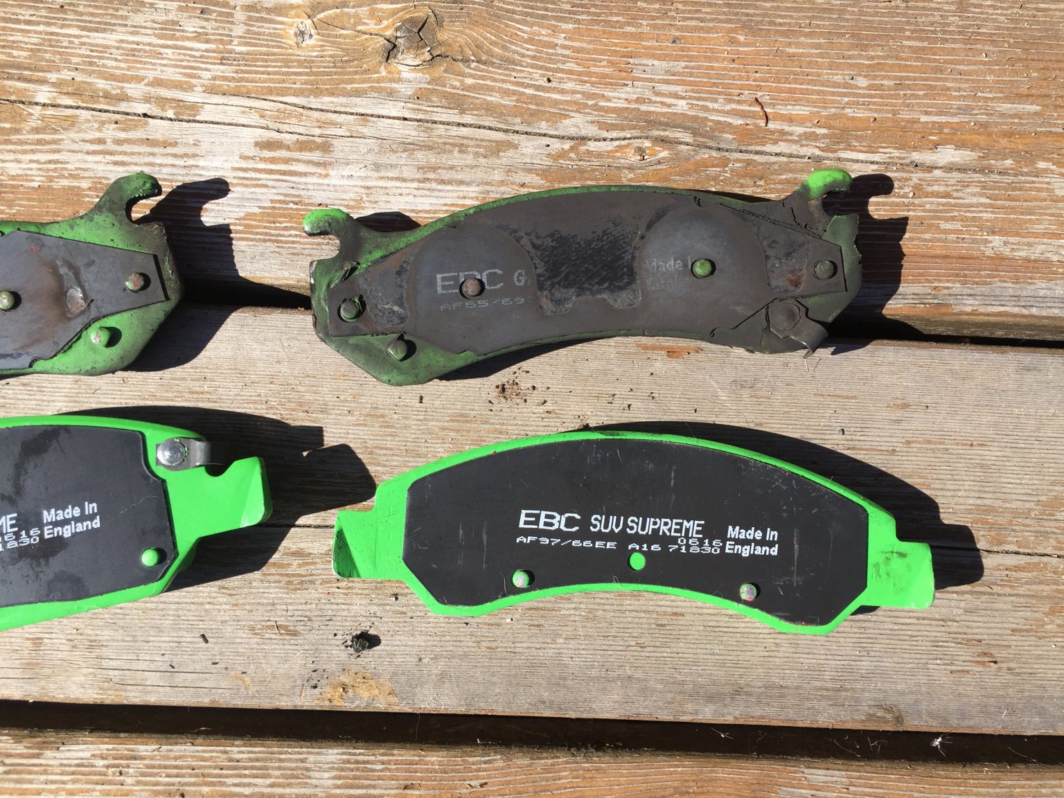

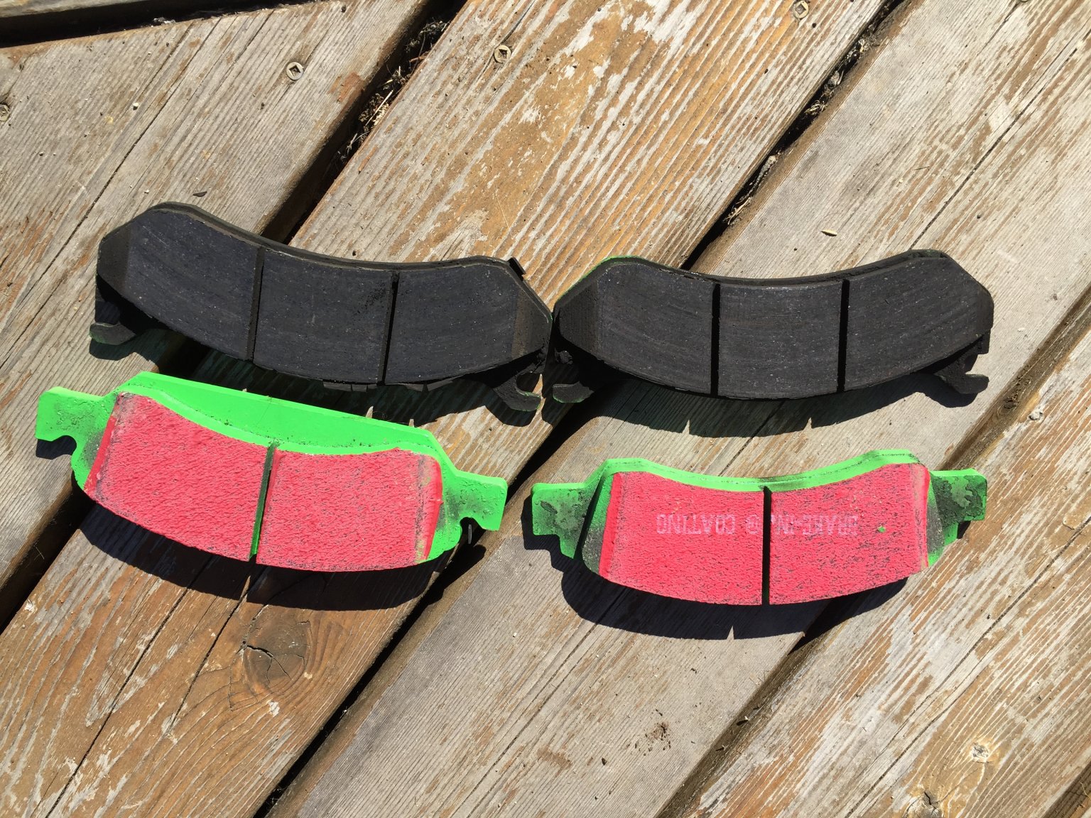

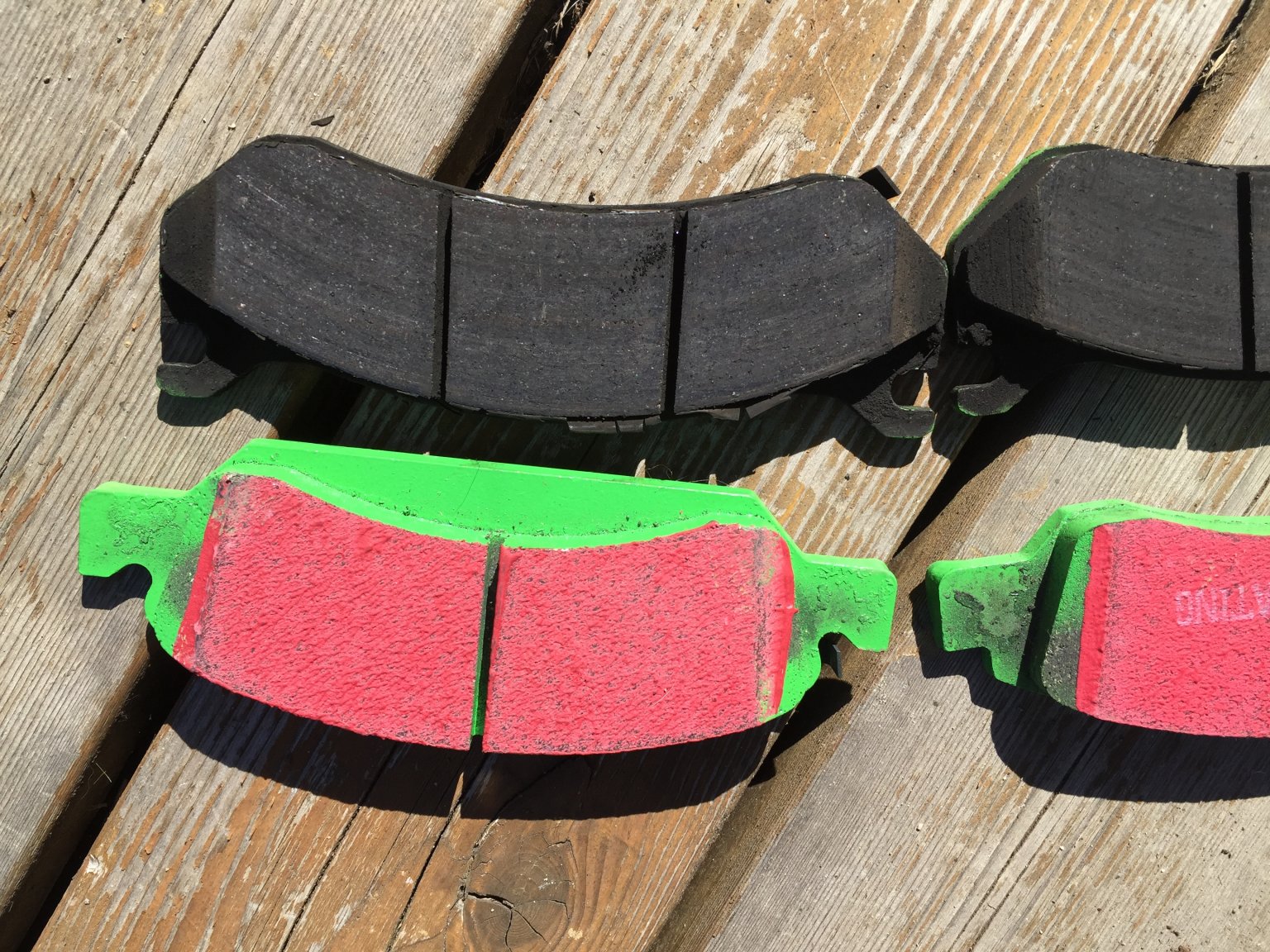

IMG_5308.JPG IMG_5309.JPG IMG_5311.JPG IMG_5312.JPG IMG_5313.JPG A few more pics. I was surprised that the pads weren't much bigger. In fact they look shorter but fatter, so maybe they're about the same surface area. And now I need to wash my truck, especially the wheels.

I actually got around to finally installing the '07 brake setup I've been kicking around in my garage for about a year now just today and I'd say it was a worthy upgrade. Not night and day, not sure if that is because I went with a completely stock setup of rotors, calipers, and pads but is really an improvement overall! Nothing at all nice as Red Rocket ended up with but then again mine isn't anything to look at so no need to start now! lol
Gonna give it a few days of driving it around to get a full feel of it all but at least my front brakes actually feel like they are doing something unlike before so that is a good thing! Going to start collecting parts to perform the Hydroboost swap as I think once I get the squishiness out of the brake pedal it will be a way better experience using the brakes on this tank!
So far so good fellas, and the best part is it is all completely 100% bolt up with no modifications needed to install it all!

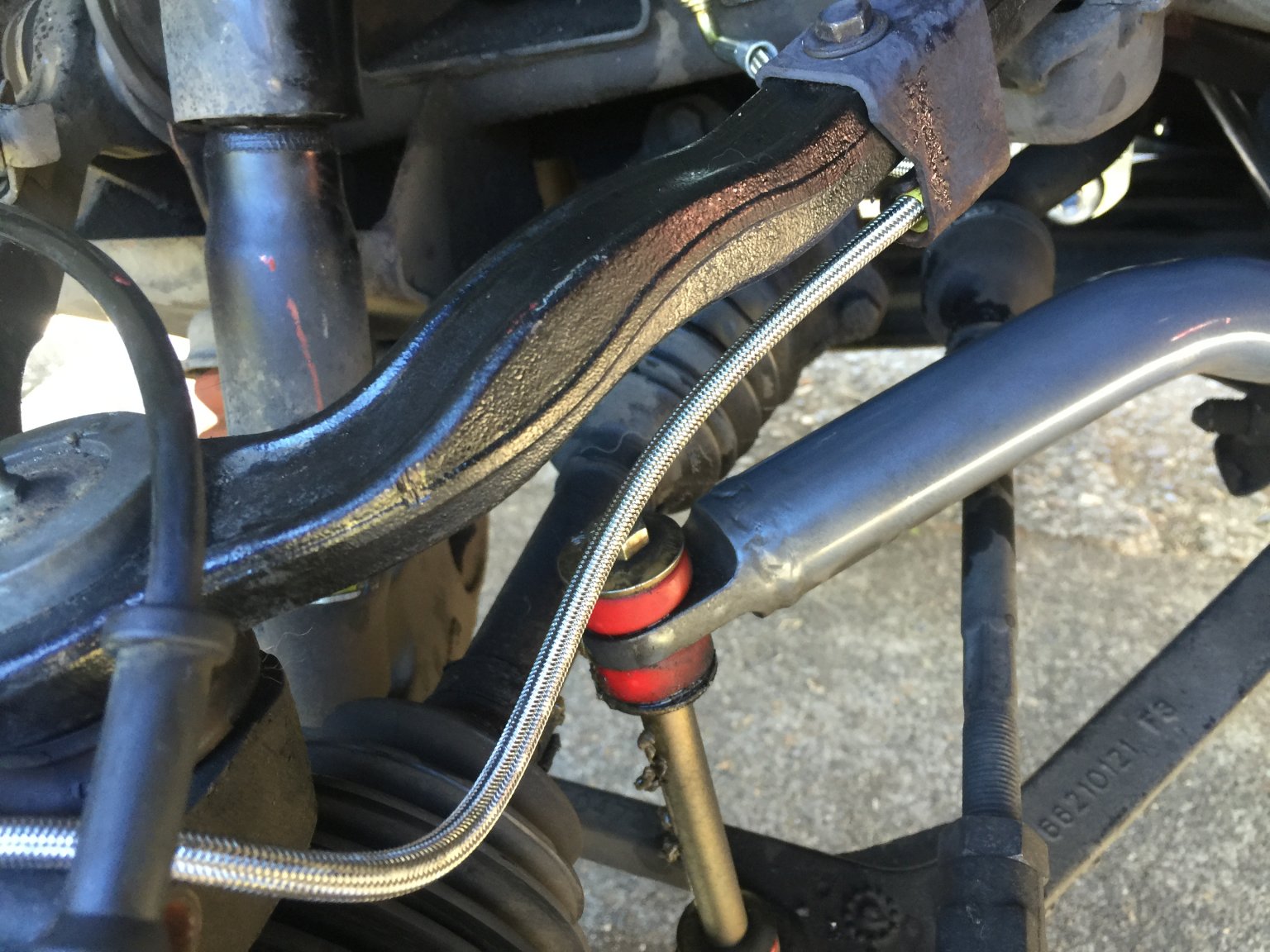

I'm not going to be able to say whether or not the upgrade by itself is night and day but what I did to mine seems that way. I don't know if it was because I installed the stainless steel hoses or the fact that my brake fluid was really old , but my brakes are waaaay better now. Stops much faster it seems, and the feel at the pedal is so much more solid.

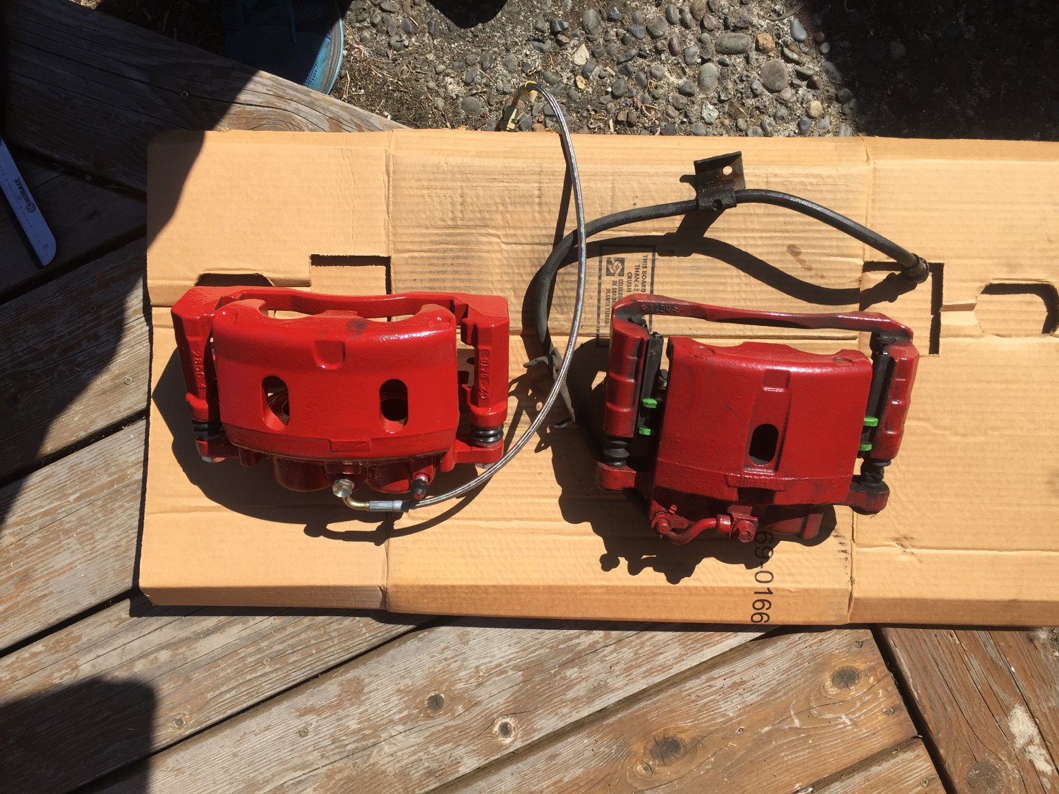

Well @TheAutumnWind I didn't get away quite that cheap but it wasn't too bad considering what you end up with. I shopped around and Amazon had the best prices shipped on everything except the EBC pads.The rebuilt OEM calipers were 238.63 shipped after core return, the powerstop drilled/slotted rotors were 141.17 shipped, the Goodridge stainless lines were 130 shipped, and the EBC 7000 series pads were 73.41 shipped from EBay which turned out to be from Auto Anything. I use EBC pads in all my vehicles after finding out about them from the motorcycle forums I'm on. Best pads I've ever used. Anyway after adding it all up....583.21. Plus another $20 or so for caliper paint and brake fluid. So...call it $600. I'm sure you could buy some cheaper parts, you don't HAVE to replace the brake lines, but I figure if I'm doing this I'm doing it right.
My numbers were my best guess for about as cheap as possible. Obviously you stepped it up a bit. I'd really like to run EBC pads, the biggest thing for my wife is she HAS to have pads that don't squeak. Performance pads I have installed years ago would squeak and weren't great unless they were hot. I'd be interested in checking out the EBCs if that isn't an issue with them. I wonder why those 7000 series pads are small? I read that in another review of them. I'll have to compare and contrast the 6000vs7000

Oh, and @TheAutumnWind the EBC 7000 series pads are the same size as anybody else's pads or the 6000 series , the pictures just show that the GMT900 pads have a different footprint than the GMT800. And dont buy the 6000 series EBC pads unless you don't mind brake dust, according to the reviews. The 7000 series have zero dust. Oh, and they don't squeak.
