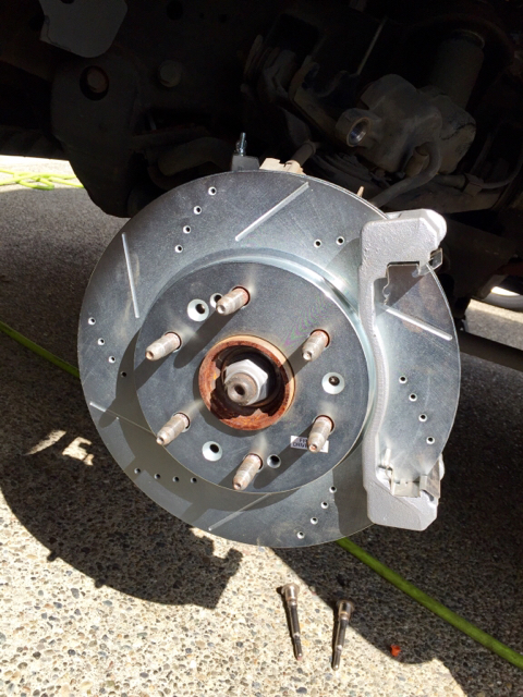

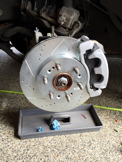

Well I got all the parts to start this project tomorrow - pads, rotors and calipers. Got the slotted/drilled and ceramic pads (only wanted slotted) but I got a good deal off Amazon for $164 and ended up paying $100 for both calipers from Advanced Auto. Hopefully it all goes smooth and my wife will be safely stopping once again!

Did the gmt900 conversion over the wknd to my wife's 05 and it turned out awesome! Bled the brakes with a motive power bleeder and all set. She had 83k on brakes and now the rears next. Staying with 05 setup since they are better than the 07+
