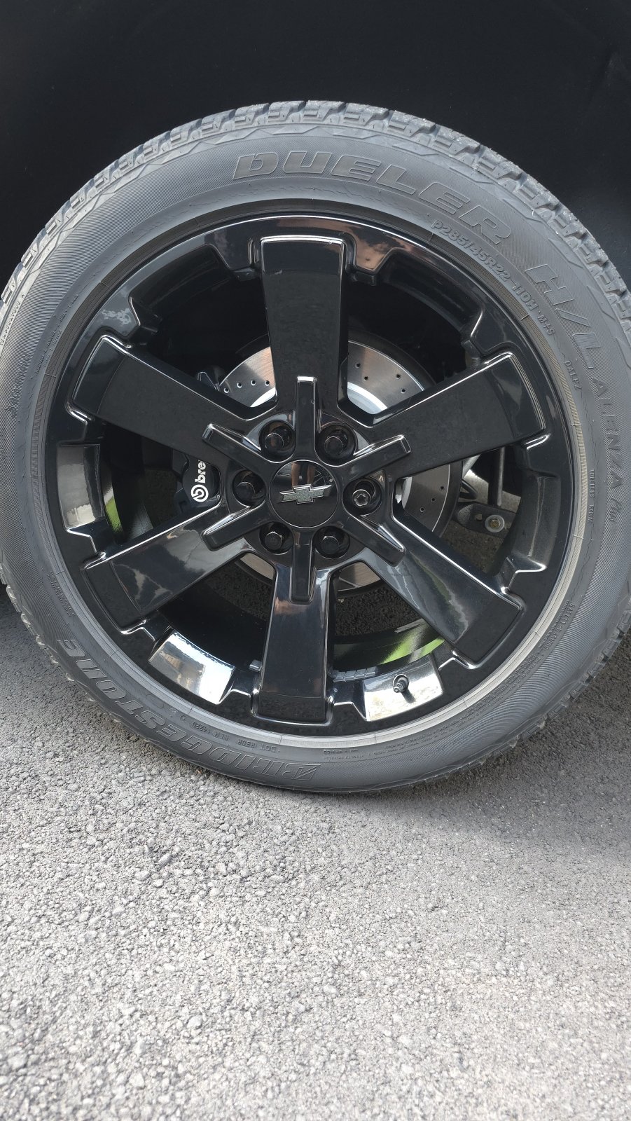

22x9 24offset , fronts did not clear the 6piston brembo FML , need atleast .75 inch spacer and extended wheel studs now F..M..L lol had to put my original caliper back on

They are oem. Really a bummer now I have to find the correct extended wheel studs,remove the wheel hubs , find a custom.75 hubcentric spacer . Pain in my @$$ lol and then hope I have the right measurements that my oem lug nuts will fit just right

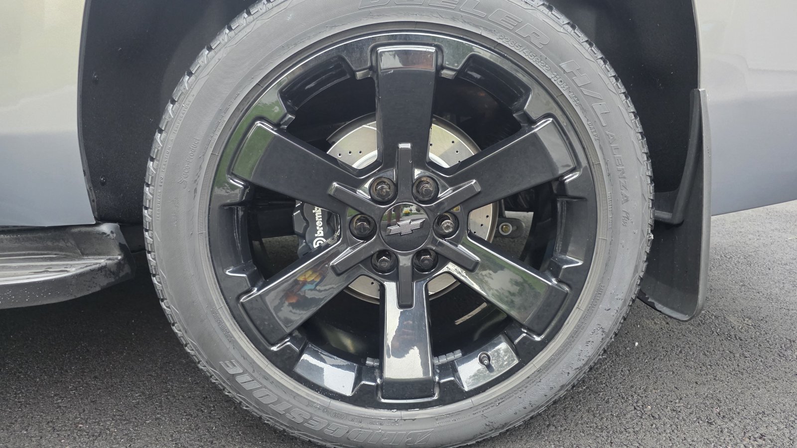

Rear was very simple install with those wheels. The fronts on the other hand with a .75 spacer should have the tire flush with fender il find out as soon as I have them on il report back. I have seen these oem wheels sold as replicas for a pretty good price brand new. Could always do replicas if its easier on the pockets.

Ended up not needing the extended wheel studs, the ET extra threaded lug nuts were more then enough
NYBRD
Jul 29, 2024
202
303
Forgot to mention I ended up going with 15mm hubcentric spacer which I think is .59 of an inch which was enough to clear the caliper
6x139.7 or 6x5 same thing
78.1 hub measurement
15mm thick.
& ET extra threaded lug nuts
Hope that helps anyone if they need it just in case
