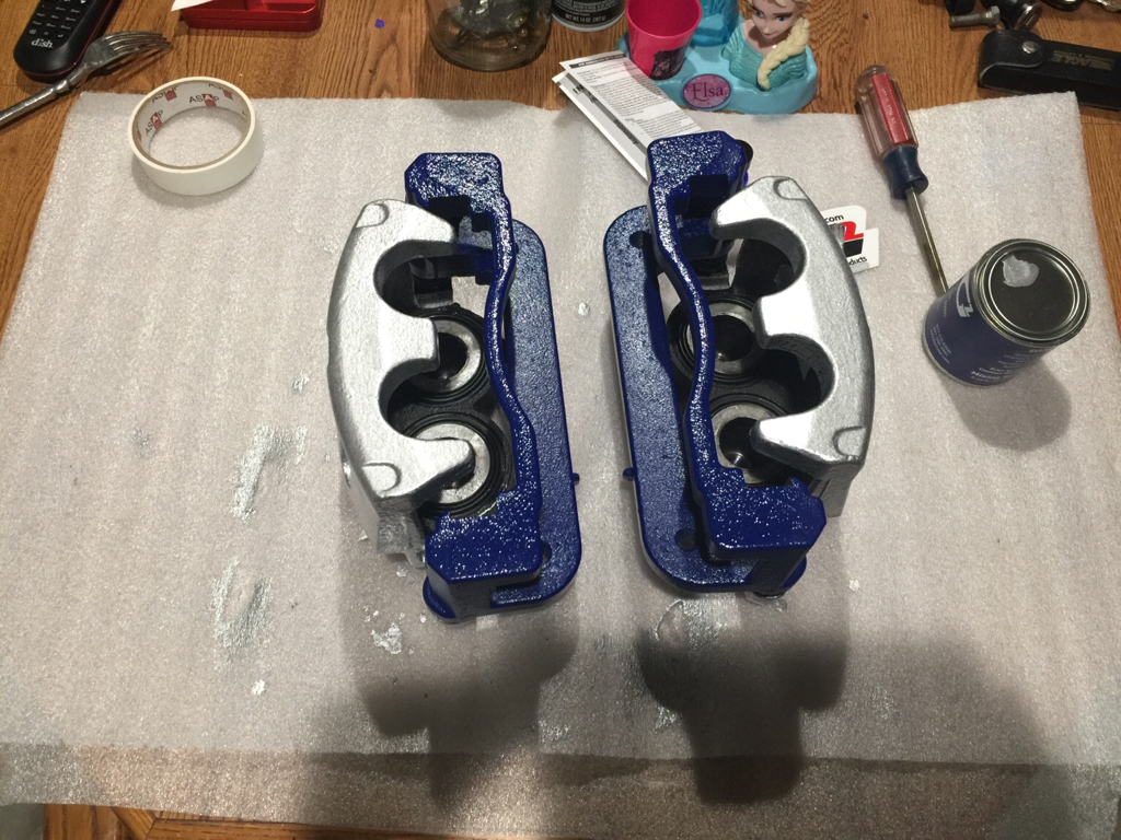

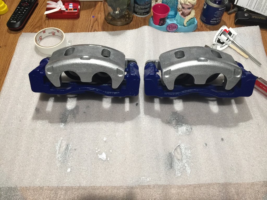

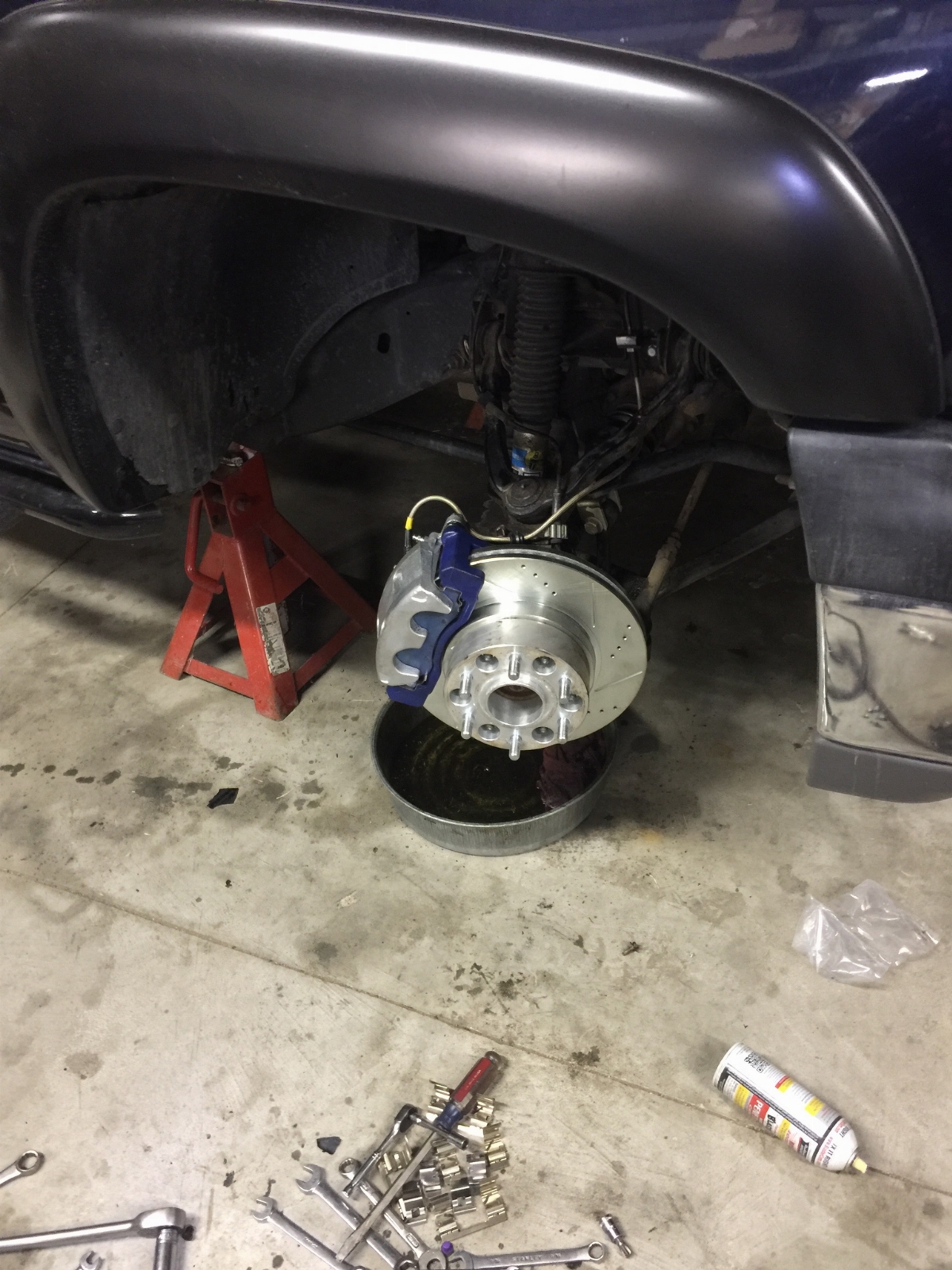

So here's my calipers painted up. Got a question tho before I start this swap tomorrow.
Am I ok to use DOT 3 brake fluid? The Wally has a gallon of DOT 3 for $16.00, & the DOT 3/4 shit is $15.00 a quart. So I got the gallon.

Damn those came out good
Can't wait to see them installed.

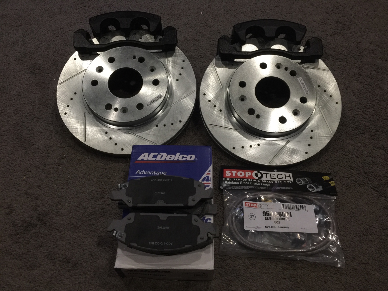

These are the parts I used in my upgrade and I couldn't be happier with the performance and lack of noise. I know there are more aggressive pads/rotors but this works for me:
Calipers:
Drivers side: ACDelco 18FR2247
Passenger side: ACDelco 18FR2246
Pads: ACDelco 17D1363CH
Rotors: ACDelco Specialty Performance 18A1705SD

I would get high quality Dot 4... Get synthetic Dot 4 that has the highest boiling point... Price is not too relevant. I would not cheap out on brakes. :D

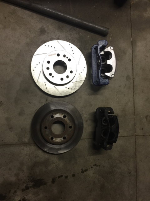

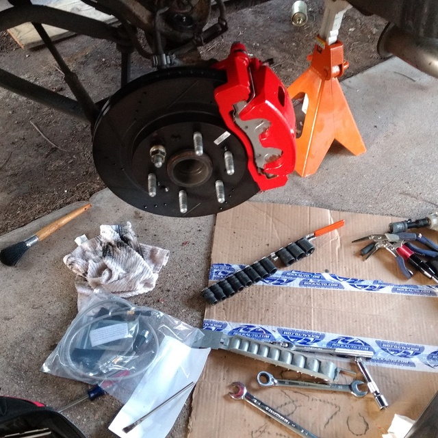

I guess I should update this thread. I did do this upgrade a bit over a month ago. Is it worth it? I would have to say yes, especially if you need to replace your brakes anyways. I'm not sure I would want to incur the cost of the new calipers and brackets, pads, and rotors if what is on my truck is fairly new and working just fine. But since it was about time for new pads and rotors anyways, I went ahead and pulled the trigger on the upgrade. I went with the Powerstop red powder coated calipers from Rockauto, Wagner Thermoquiet Ceramic pads, and Black Zinc plated Powerstop rotors.
Yes, it does stop better and faster than the original sized brakes. Is it a night and day difference? Not really, but it IS a pretty noticable improvement in stopping this big ass SUV. So I would say it's worth it if you need to replace your brakes anyways.

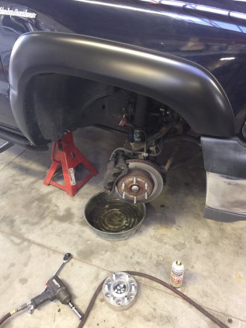

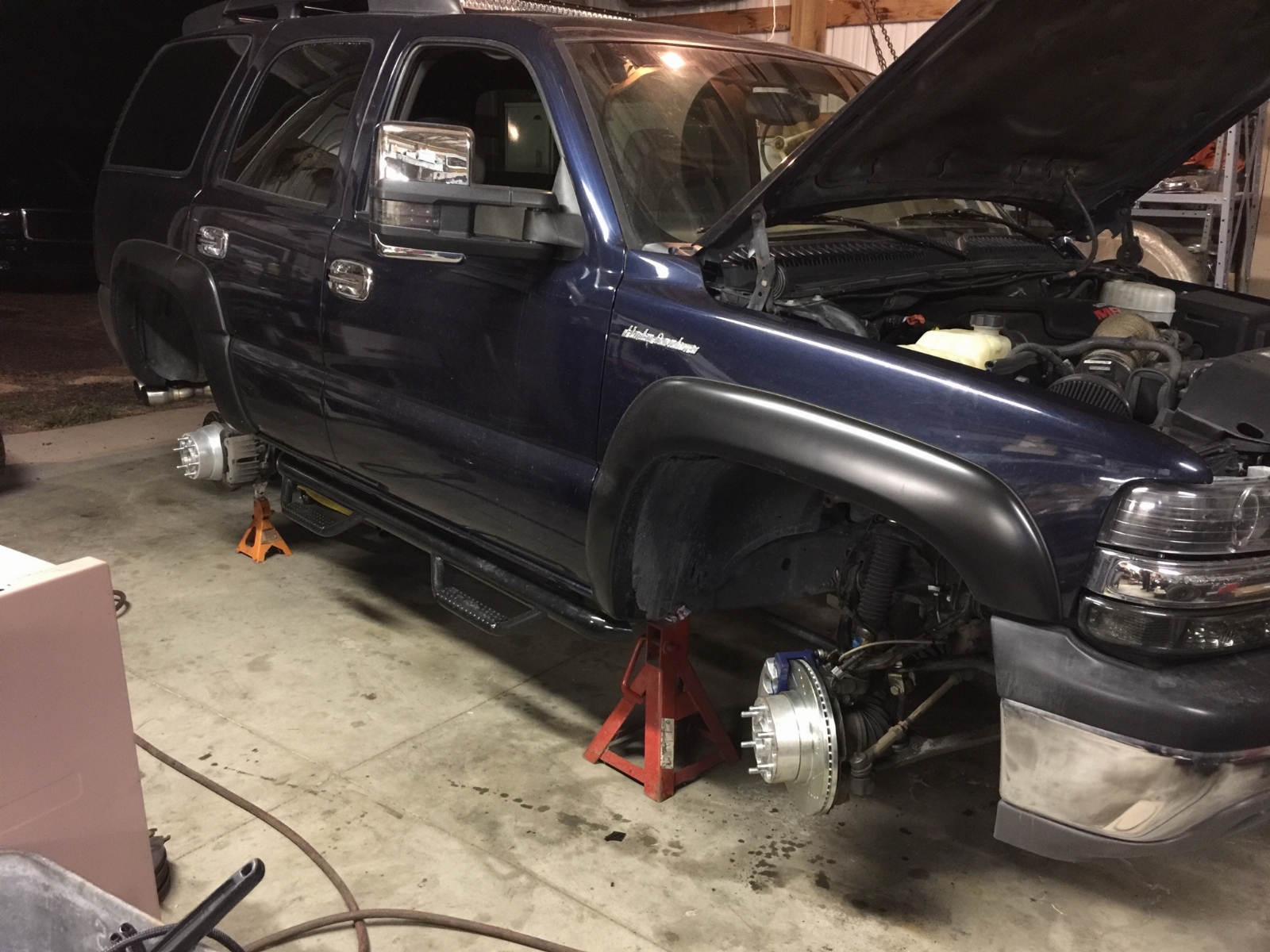

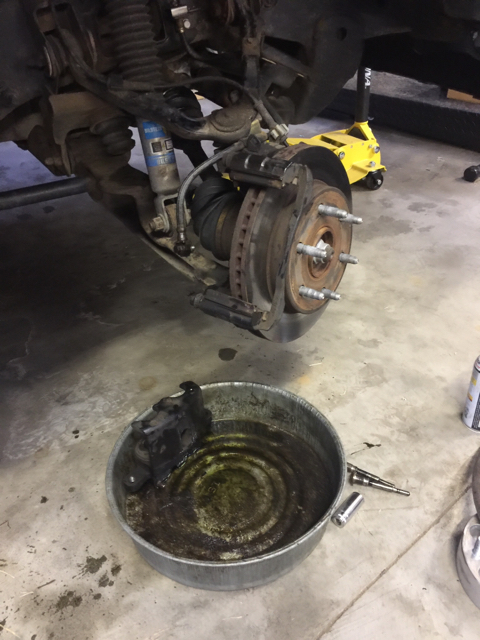

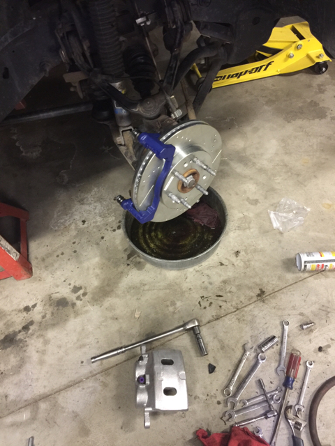

Update here as well:
So I got mine all done. Everything went on very easy, other than trying to use a garden sprayer to bleed the brakes. Ended up with brake fluid all over the floor, because it all just seeped through the master cylinder cap under pressure.
The upgrade is a night and day difference for me. I'm running 285/70/17's with 2" spacers and that combination made me have a horrible shimmy/wobble when slowing down for turns and stops. Now it stops smooth and quickly. Bled them the ol' fashioned way (2 person) and they are great. I really recommend this upgrade if you are running bigger tires or rims.
