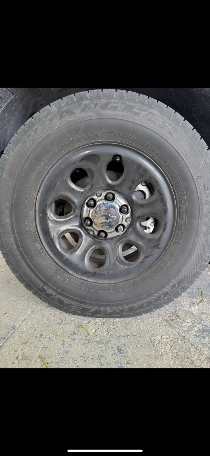

These are my wheels. I don’t know if they affect the cooling as well since they don’t seem to have a lot of open space. I don’t know much about wheels so

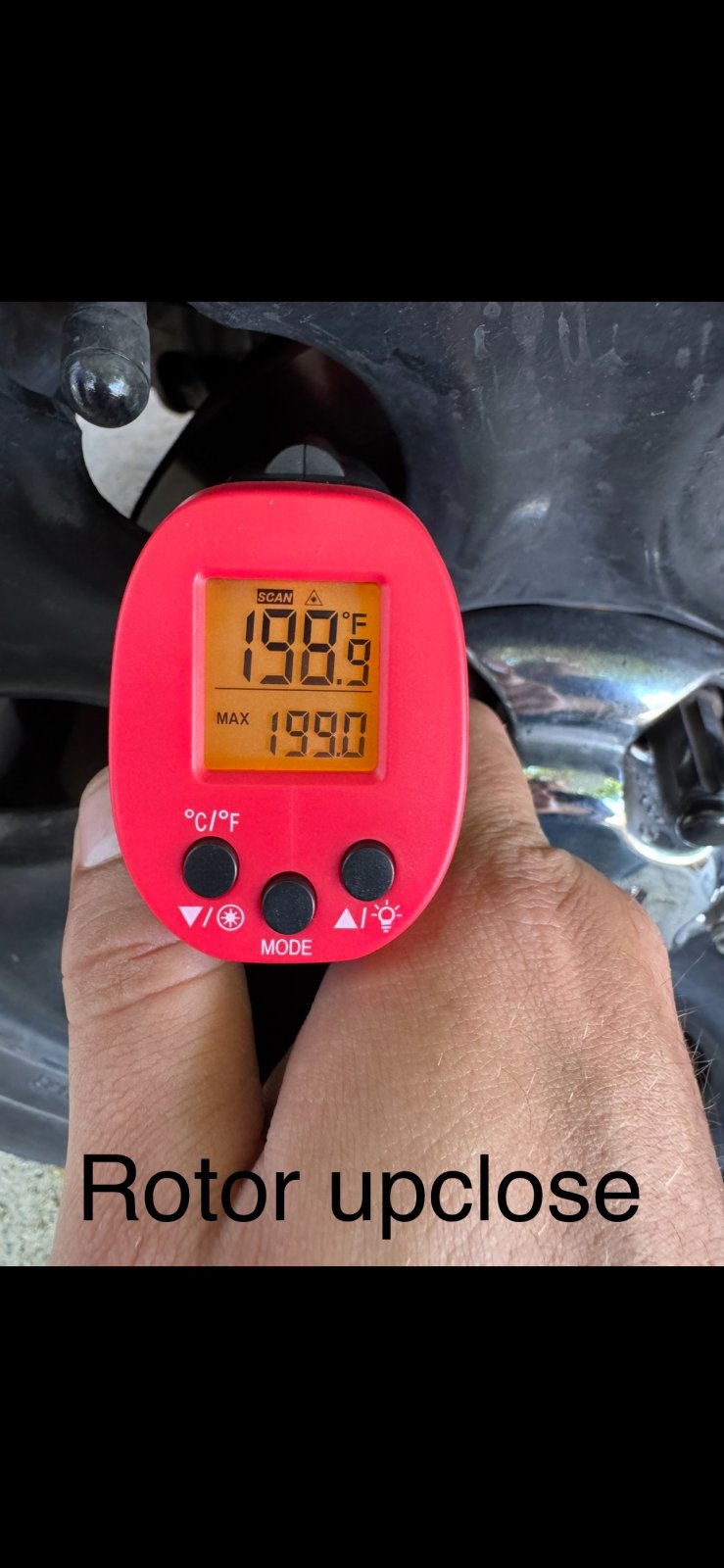

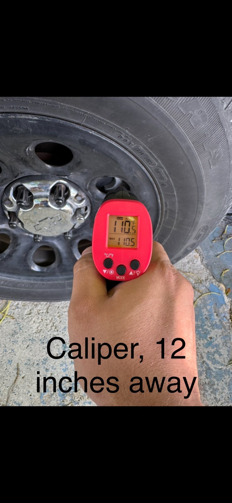

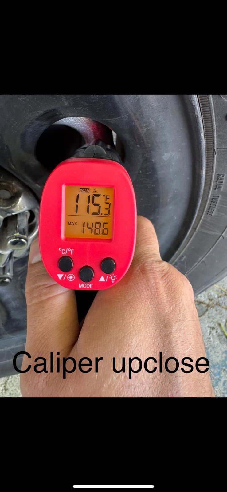

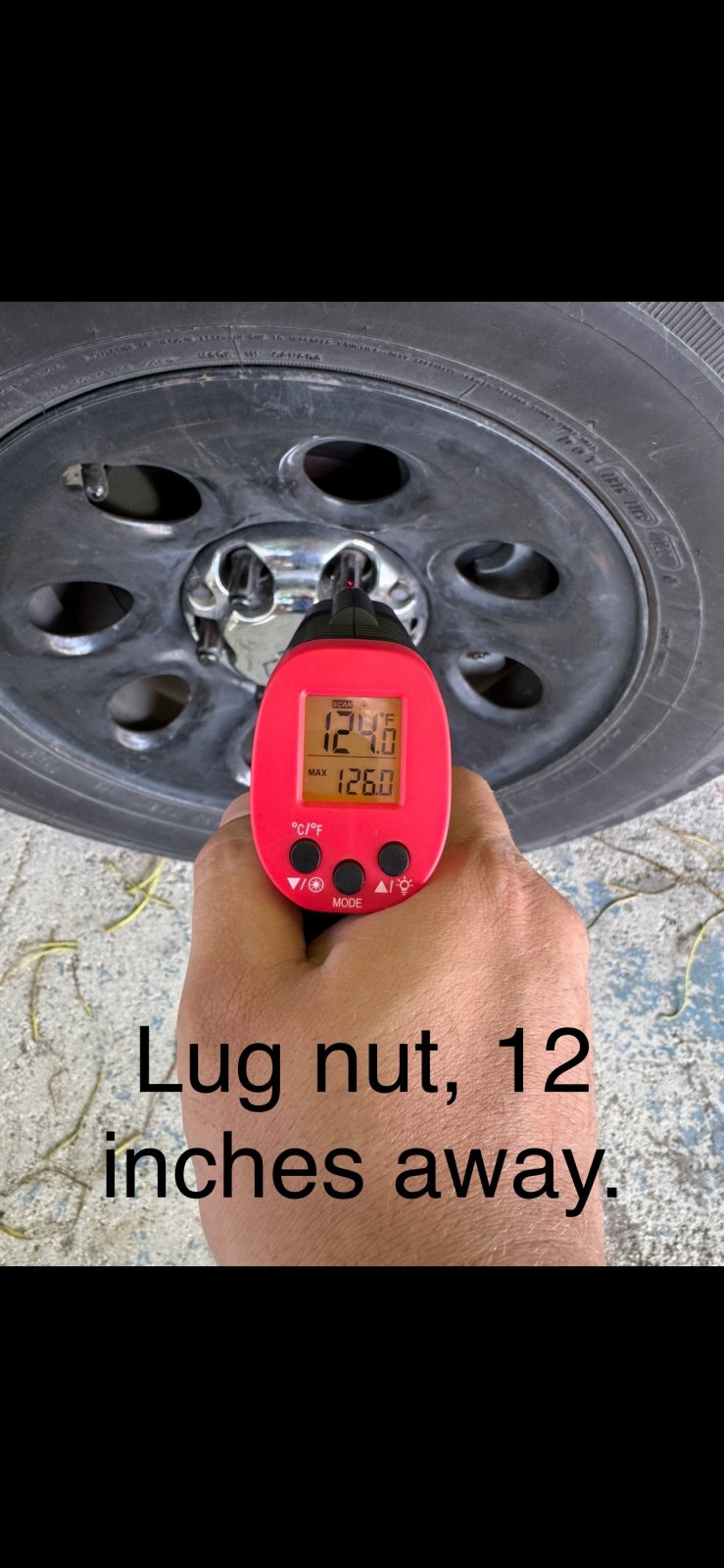

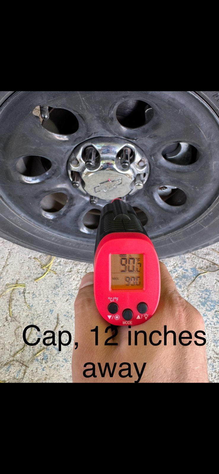

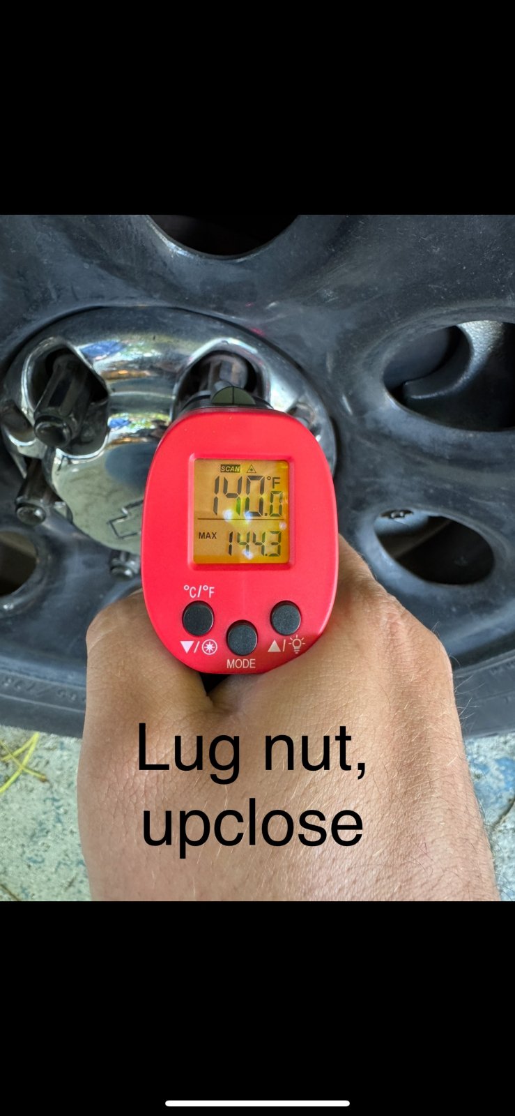

Ok so i did get me a infrared tempt gun, first time using one of these so please go easy on me! At first i measured upclose but then saw that it says to get a more accurate reading, to take tempt 12 inches away. Hope this helps. This is from a 75 miles roundtrip i made today going fishing. Outside temperature was 82-83 here.

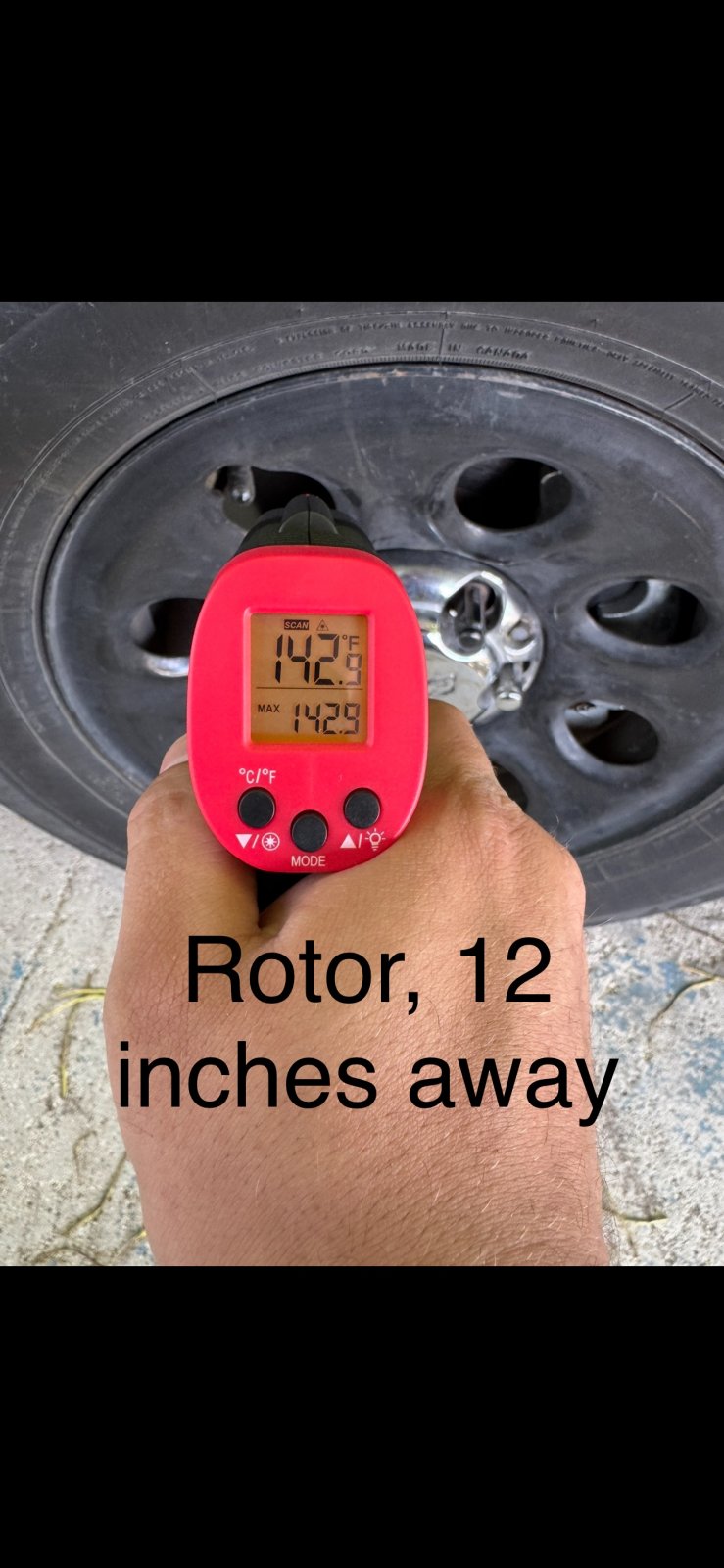

By the way, this is the driver side only, the passenger side is always similar to the driver but when i parked i noticed the passenger side was being hit by the sun so taking a reading would not be accurate. The temperatures started to come down after 10mins or so little by little.
Please be aware that the IR heat "gun" reads infrared radiation from the surface you are measuring. The IR energy given off is greatly affected by the surface, a flat black surface will read much more accurately than a shiny chrome surface. If you want to measure with best accuracy, put a piece of black electrical tape where you intend to measure.
Also the "gun" averages the temperature of the spot it is measuring. The spot size it "sees" is determined by its S ratio, an example of an S ratio (Usually printed on the side) of 6 means that it sees a spot 1" in diameter, if the measurement is made 6" away. Better optics in the "gun" could give a better S ratio, such as 12.
If there is a laser built in, it is for aiming only, whether you turn it on or off makes no difference in the measurement, unless the battery is low. If you get a different measurement with the laser on or off, change the battery.
Lastly, you must hold the trigger on long enough for it to declare "Hold" on the gun, and it may take a few seconds. Some guns may indicate this differently, YMMV.
Are you a two foot driver? If so you must hold your left foot above the brake pedal, not touching it.
One more thing, the IR gun will not read through a glass window, it will indicate the temp of the glass surface on your side.
