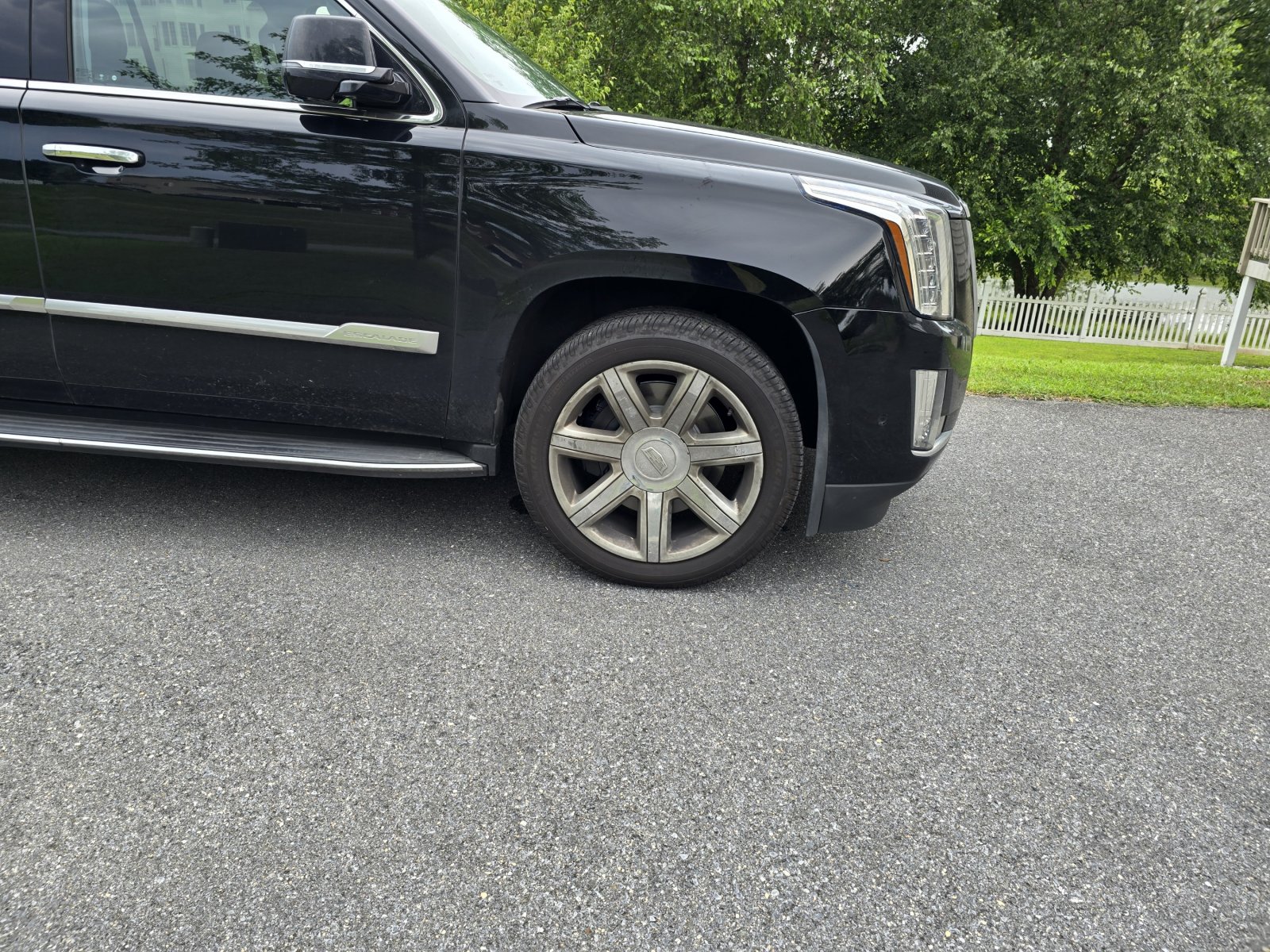

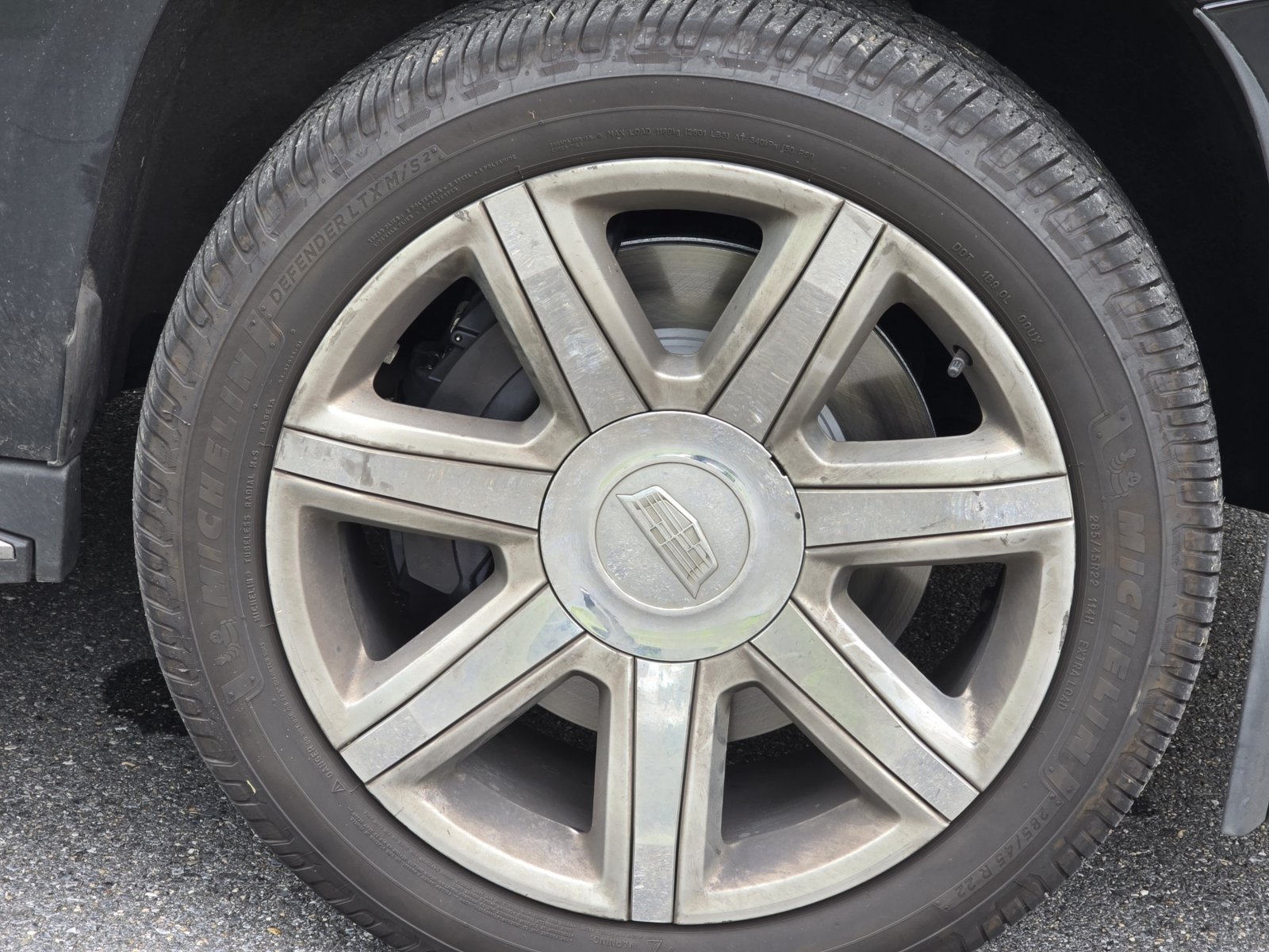

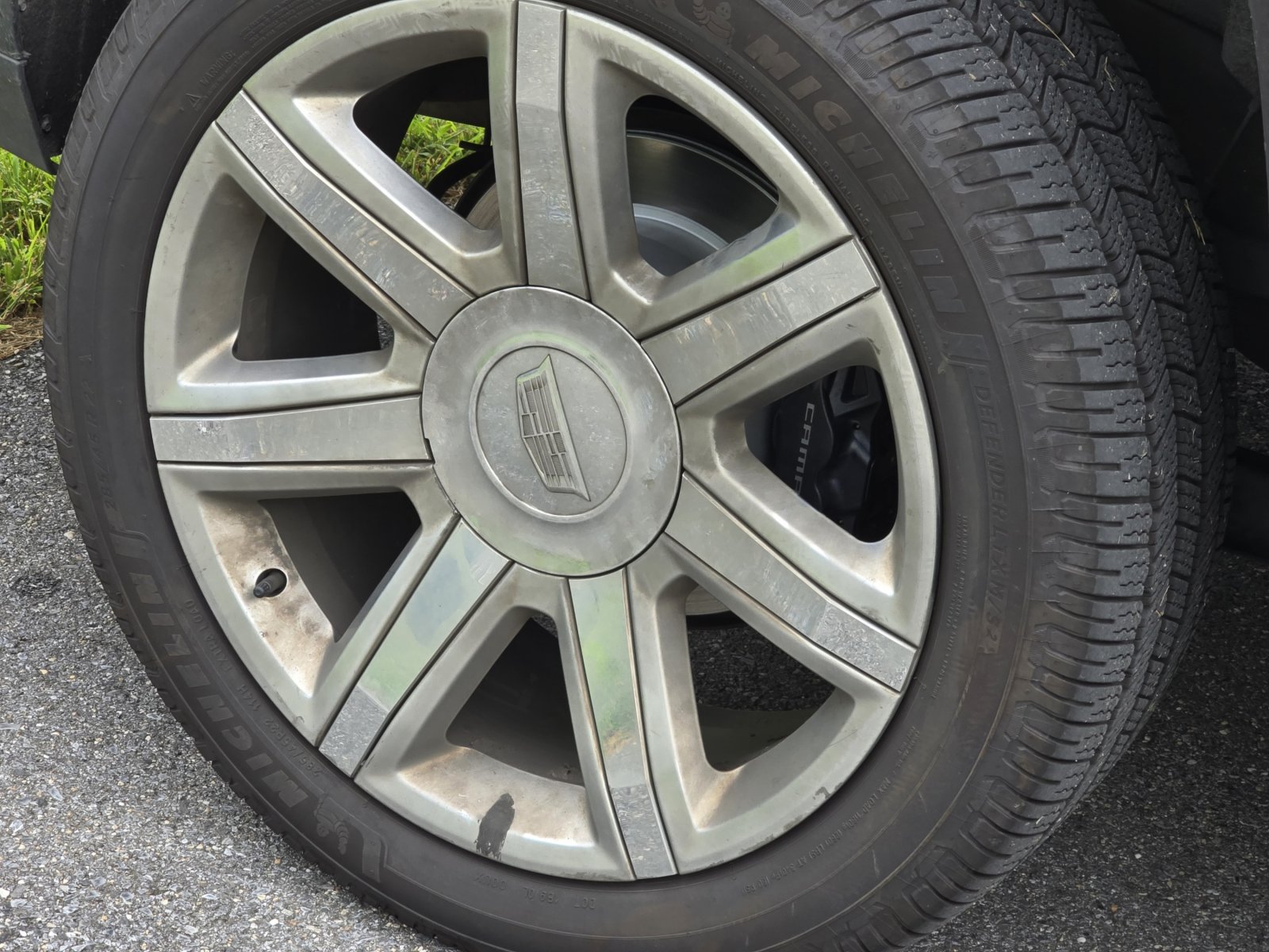

Here are some of the after pics. Excuse the really, crazy dirty wheels, a full wash is coming very soon!
The last one in the series is obviously the rear. Camaro brakes. :p

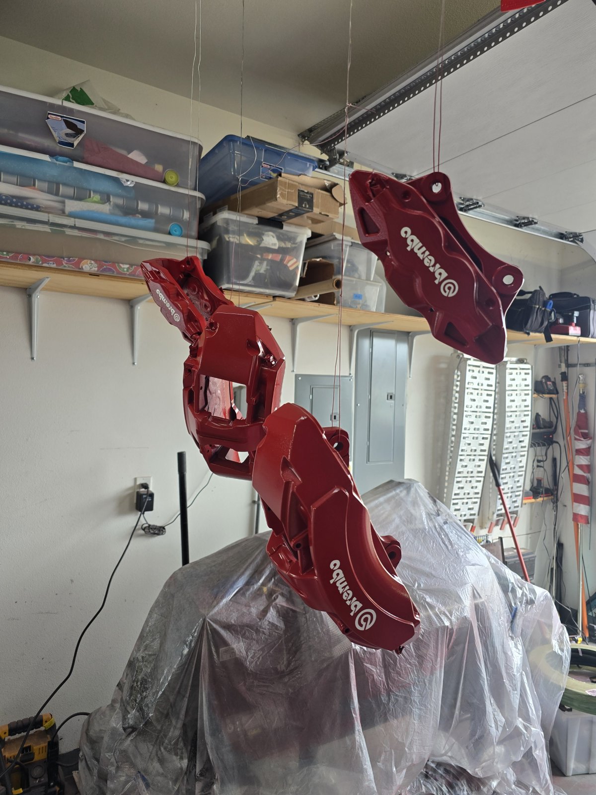

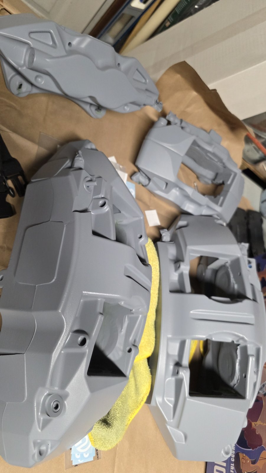

Have them primered up , almost there hopefully I get em on soon!

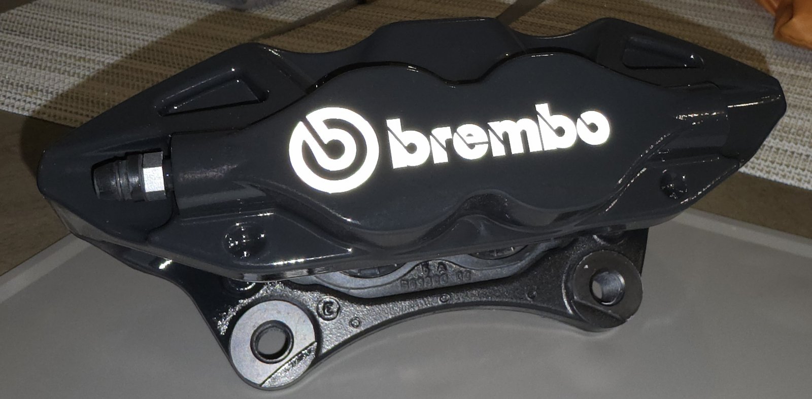

Haven't had the time to install but looking forward to it , cleard the decals into the paint and they are reflective thought that might look kinda neat who knows lol

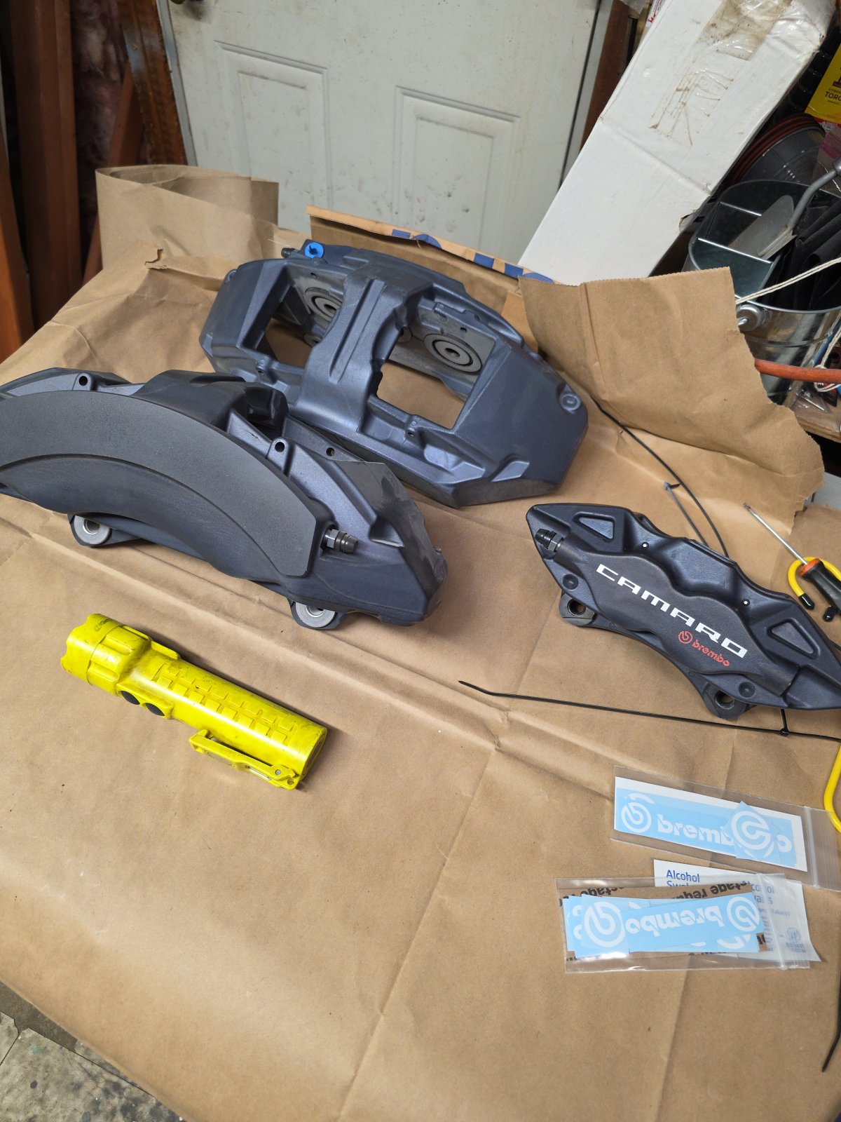

Looking good. Today while loading the brake pads I realized I don't have brake pad pins for the front calipers . I also painted the ZL1 calipers going on my wife's 2023 Camaro 2SS convertible and those pins fit the Yukon calipers. Hopefully have the right pins arriving Tuesday.
All calipers are loaded except Yukon fronts.
