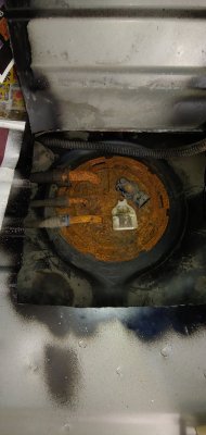

Cut an access panel for a fuel pump on 2007 Yukon. The location was not correct. Can anyone help with the correct location for the access panel?

Is your yukon the xl? You were supposed to cut towards the front seat. Cut about 8 inches toward the front and lift the orner and look under the sheet metal. if the 8inches is enough change the cut direction towards the passenger rear door.
After you change the pump have a muffler shop weld the cut that was in the wrong dirrection.

His is an XL... you can see that his rear door jamb is straight in one part of his video.

Yes its an XL. Yes you are right that the panel needs to be where you showed it. I cut it in the same place in the 2007 as others have done in the earlier models and it worked. Thanks!

Here are photos showing the location of a DIY access hatch for 2007 Yukon XL fuel pump. Its basically the same location as in the pre-2007 generation. Used a Dremel with a metal cutting wheel. Was super easy. Yes it created sparks, but there was zero issue with the sparks igniting gasoline. This was MUCH easier and faster than dropping the fuel tank and having Access Door Location 1.jpg to disconnect all of the hoses and vent lines. Access Door Location 2.jpg Rusty Pump 11-2019.jpg
