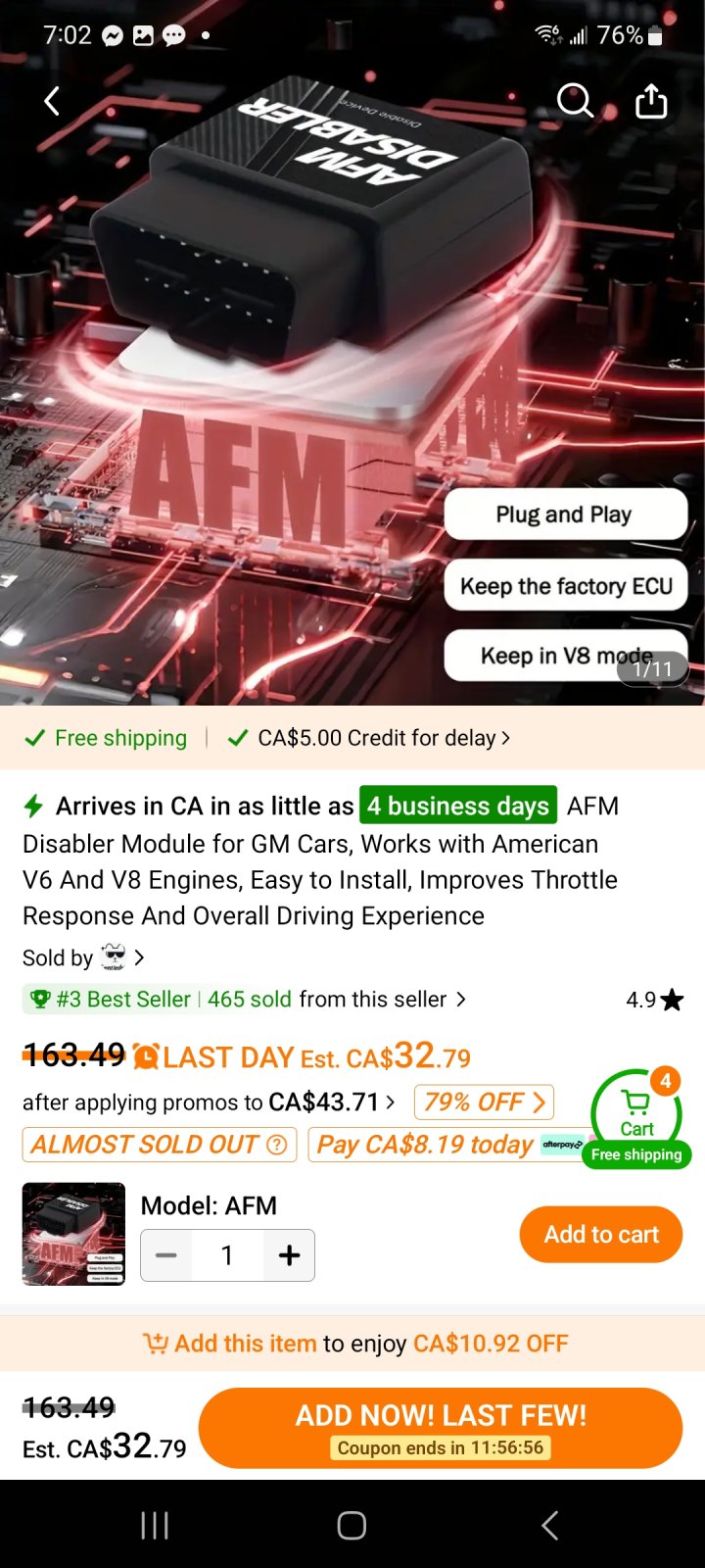

I was also looking at an AFM deactivator module that plugs into the obd socket. It is also supposed to regulate the fuel injection patterns for increased fuel economy.
So far as most of us know, all they do is prevent the ecm from using less than 8 cylinders; they are not known for altering fuel injections patterns.
If this is not the case, please show info to that effect.

Thx for that piece of inte Mike, in my ruminations, failure of the ecm to deactivate the injectors of the 1,4,6 &7 cylinders could be the cause of my gas-in-the-oil tragedy. By the way, I measured the resistance across the pins on each of the injectors. I got 3.5 to 4.5 ohms across the team of injectors. In another wavelenght, I ordered one DOD deactivator from Temu and the listing description stated that fuel patterns are optimized. I may have swallowed bait, hook, line and sinker huh? Ill take a screen shot for you guys and eventually will be able to report the results.
