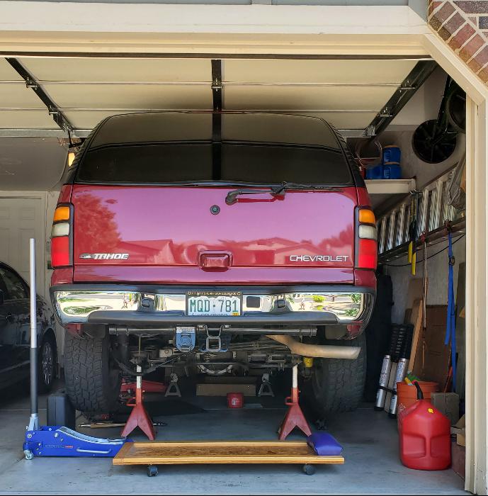

Long cranks could be a leaking purge valve or injector, or it may need a crankshaft position correlation relearn. I'd do more diagnostics before condemning the fuel pump.
Having said that, the tank can be removed in the driveway. I used 6-ton jackstands for my GMT800:

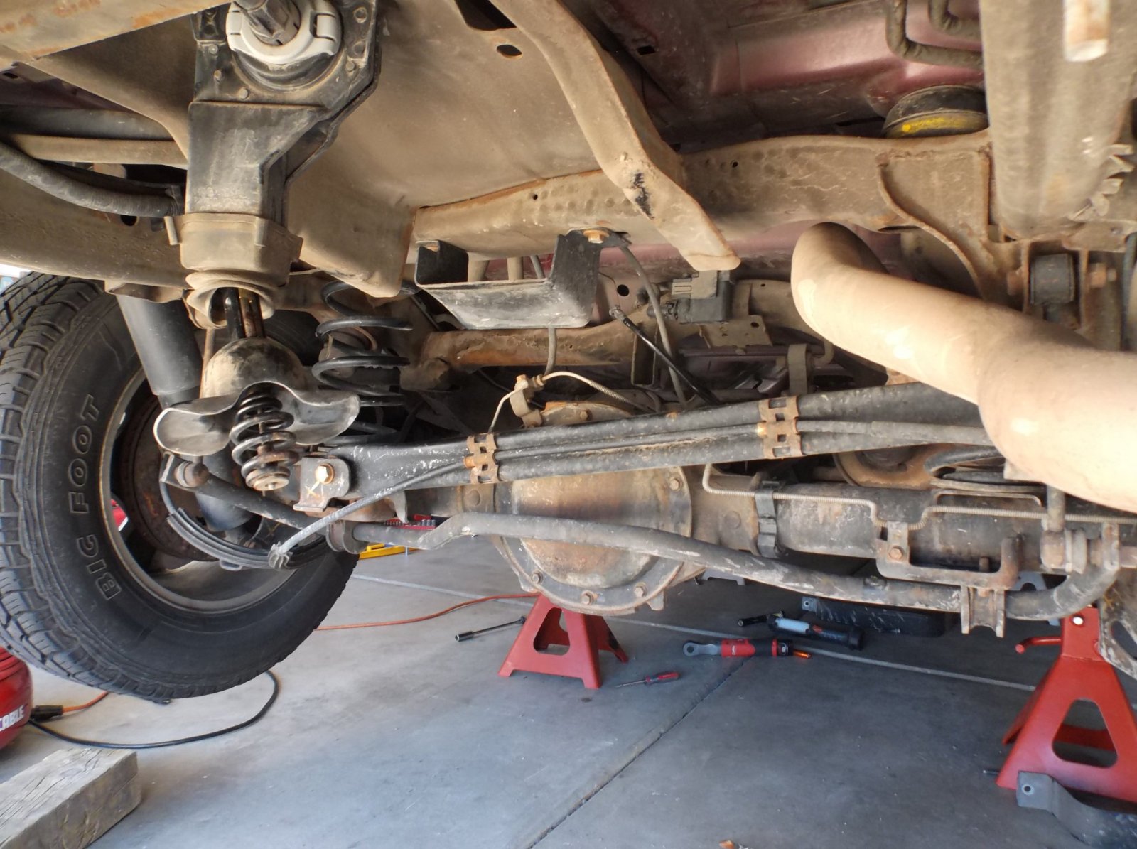

Excuse my ignorance, but is the tank in the back on your truck? It's on the driver's side on mine.
Yes, in that pic the tank is still installed. Here's a pic after we pulled it out:
Yours won't be exactly the same, since you're in a GMT900, but it will be similar.
