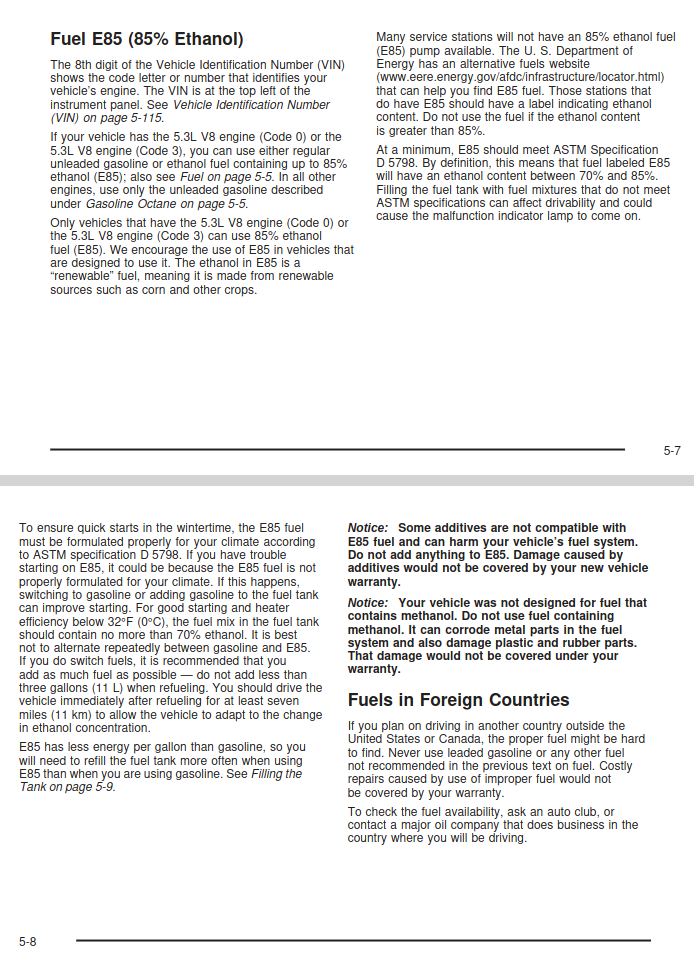

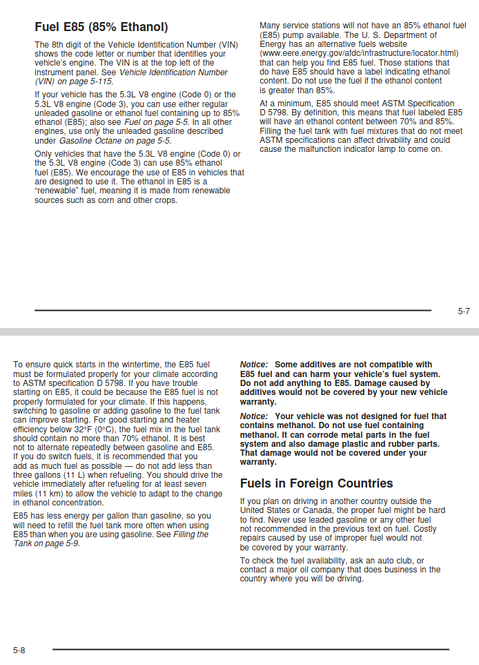

I feel like a broken record. 3 gallons. Excerpt from the 2008 Owner's Manual:
