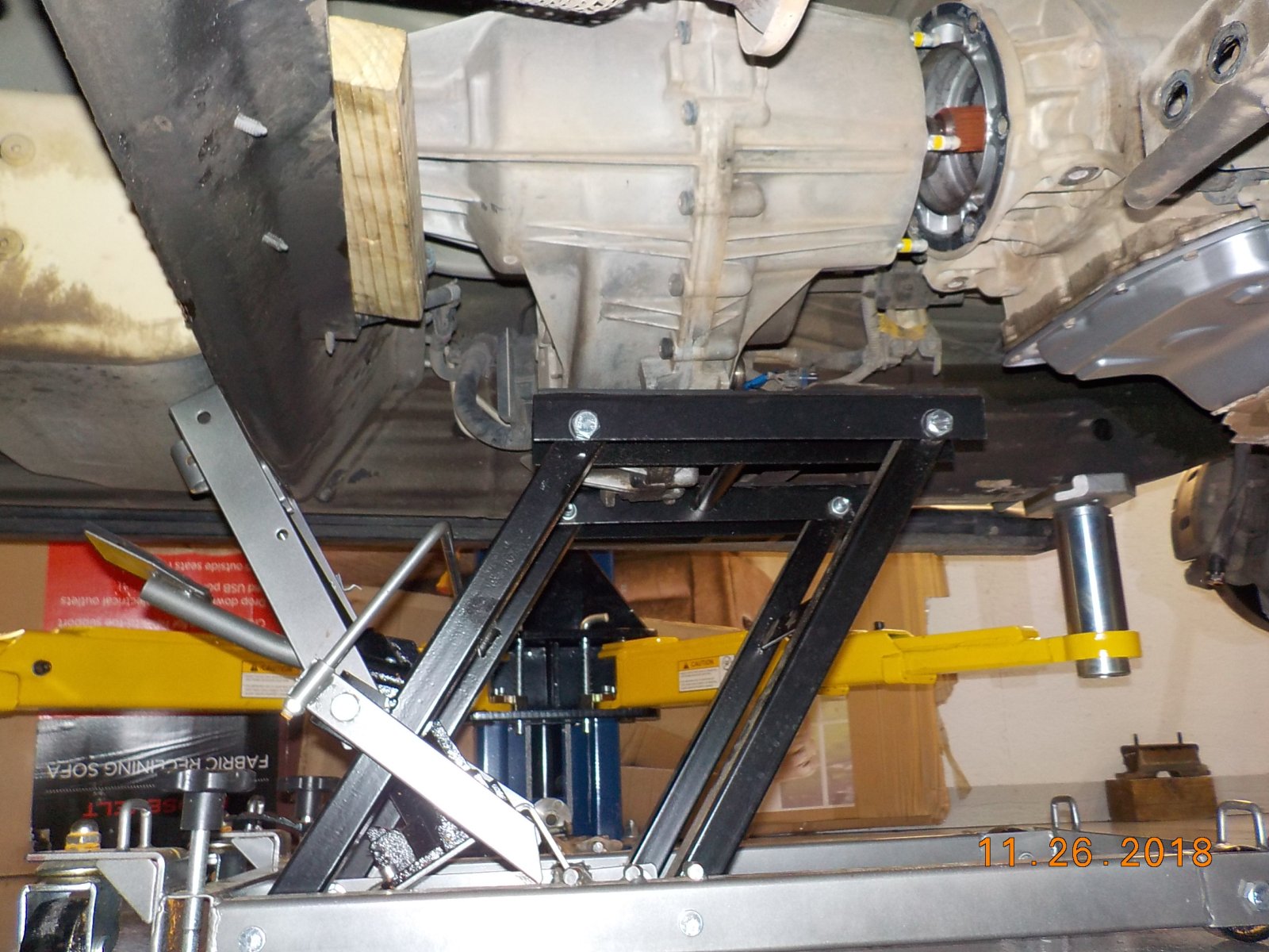

I have just completed a similar job to this. Please start at post #27 in my thread here:
Will do, thanks.

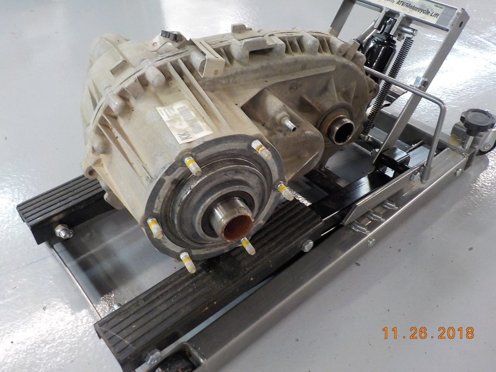

The transfer case is actually not that heavy. I can put it in myself bench press style and if i can do it anyone can do it.
Yeah, the transfer case looks to be a snap...but the trans laying on the ground looks to be a pita.

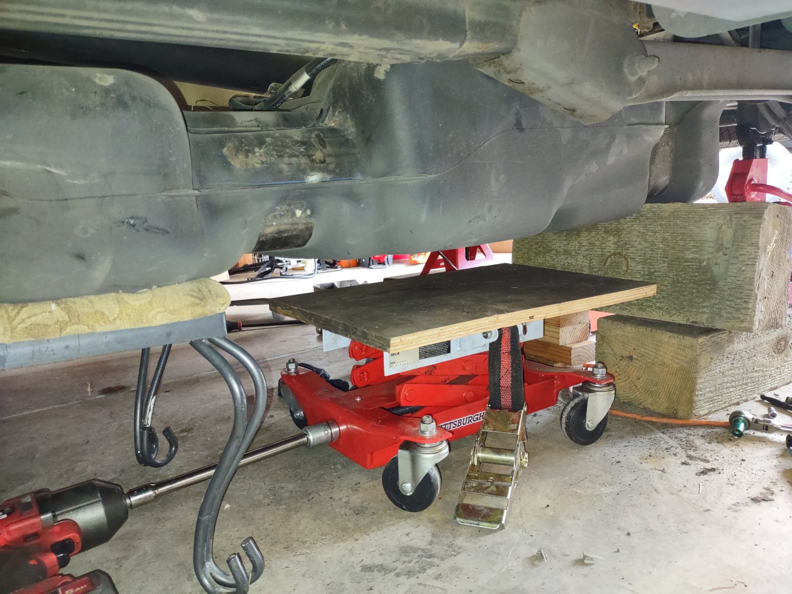

I just did mine a couple months back, I did replace the RMS, the plate gasket and the Barbell. I used a new OEM GM barbell since the original went 150,000 without failure I was not afraid of the oem part.
I have a Harbor freight tranny jack, I bolted a 5/8" x 14 x 20" piece of plywood to the top of the tranny jack. This allowed me to better hold the tranny in place at the correct angle to slip it back in when it was time for install.
Drain the tranny first before you remove it. Saves a lot of mess later. Removing the intake manifold for upper bolt access is a great idea. I did those bolts with a 3' extension and I bet it took 2 hours for the top two bolts alone.
The thick plywood is a good idea, thanks. Was that the scissor jack or the 800# model?

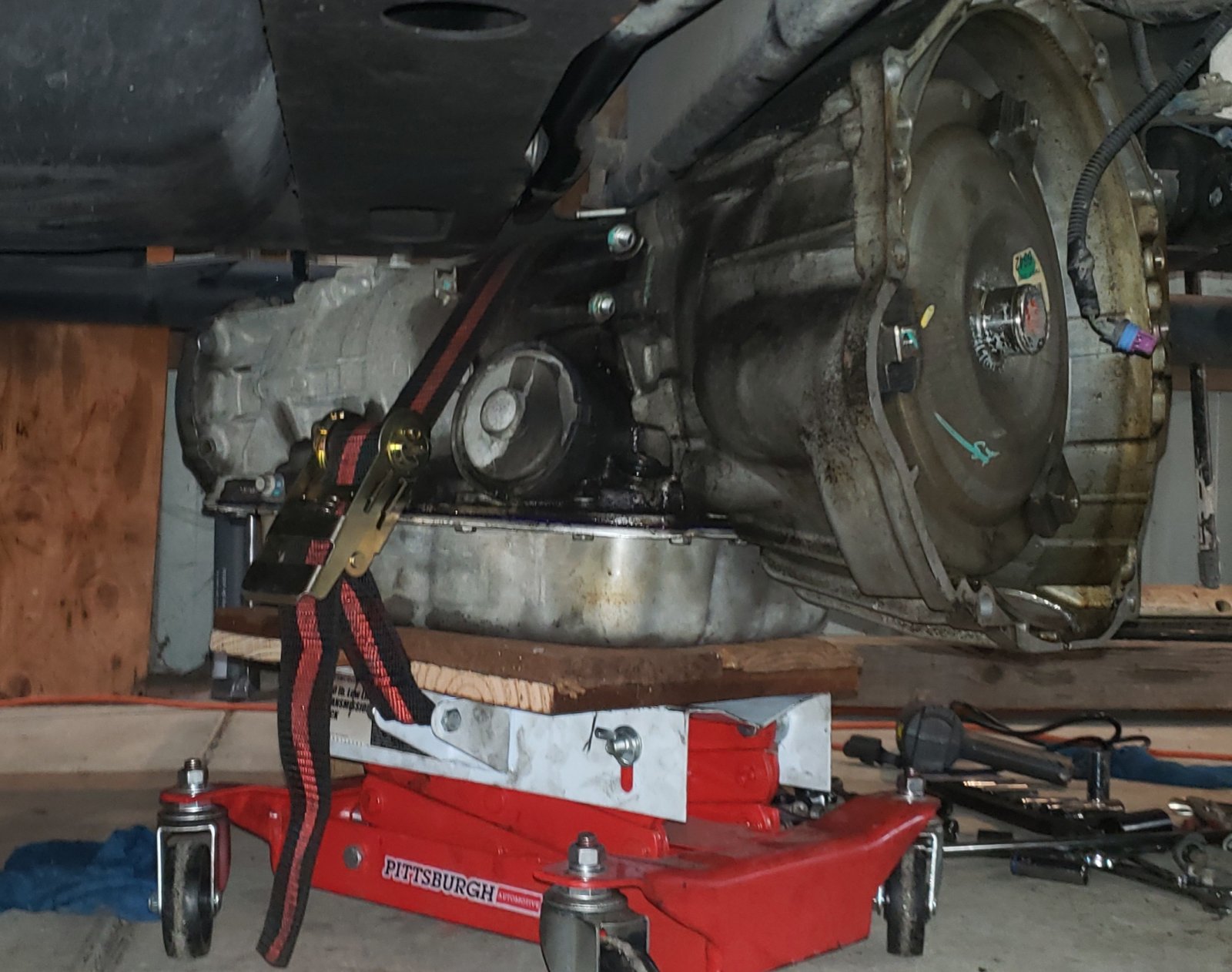

I used the small sizzor type Harbor freight jack, with the tranny properly balanced on the stand it worked fine. I think I used a small piece of 2x4 maybe 10" long under the front of the tranny to get my angle correct for install. It was strapped down tight to the tranny jack.

I can tell you that the balance point with the transfer case attached is just in front of the cross member. A floor jack, a short 2×4 on top of the jack, and two ratchet straps hooked frame rail to frame rail just to catch it if something goes wrong will get it out and back in. I left the cross member attached to the tranny during the process, it makes a convenient handle to steady things.

I can also confirm that inexpensive harbor freight transmission jack, with a piece of plywood works really well. Used it on an Escalade and a Hummer H2 to simply roll the transmission back, to do the rear main, cover and barbell. I've also used it to assist on front differentials, particularly on the H2 which weighs a lot more than the Escalade. Most recent use was lowering the Escalade fuel tank to do the fuel pump, with about three quarters of tank of fuel. Not a problem.

The piece of plywood makes the tranny jack much more functional. I have done a few front diffs with it along with 3 transmission jobs now. So far the jack has worked and kept the load stable.
