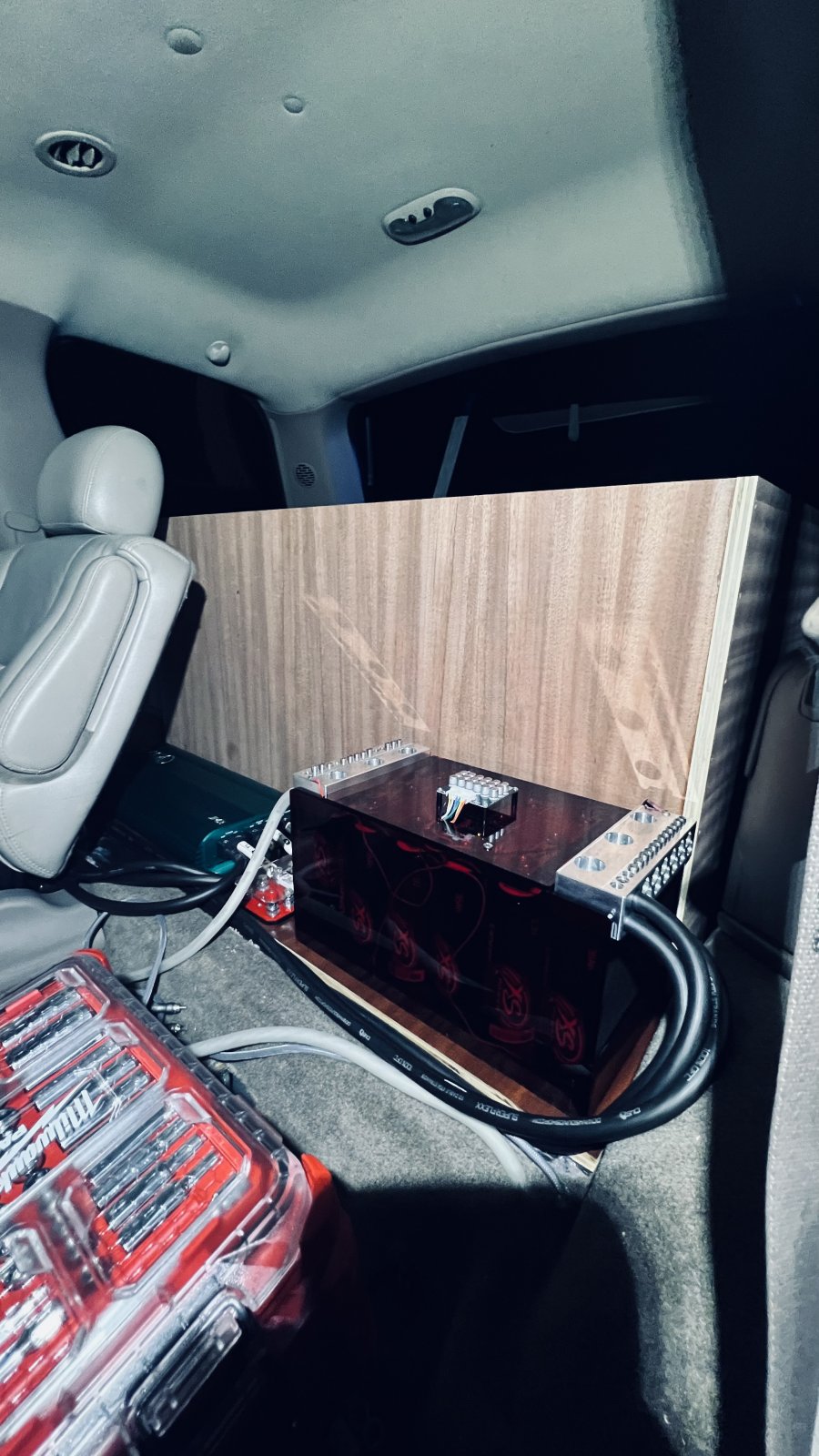

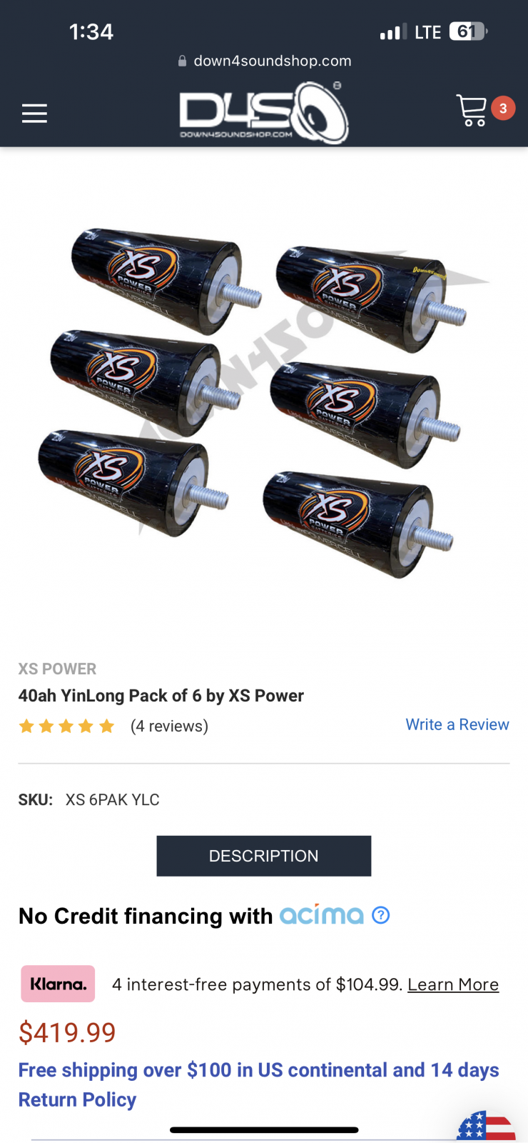

I’ve had similar luck seems like if they last 3 years it’s a miracle.
When mine finally gives out I’ll be swapping over to lithium to try out its around 450-500$ but has better constant voltage quick charge and lasts 10 years supposedly
420$ but by the time you get the box and mounting hardware your over 500$
I quit using interstate batteries
I’ve had good luck with my diehard so far
View attachment 421529View attachment 421530
My My we are so close. I think you need to add the Flux-Capacitor, available on ebay.
