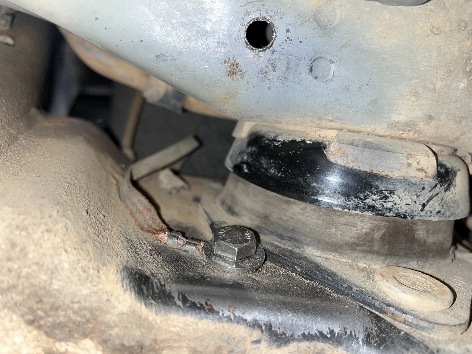

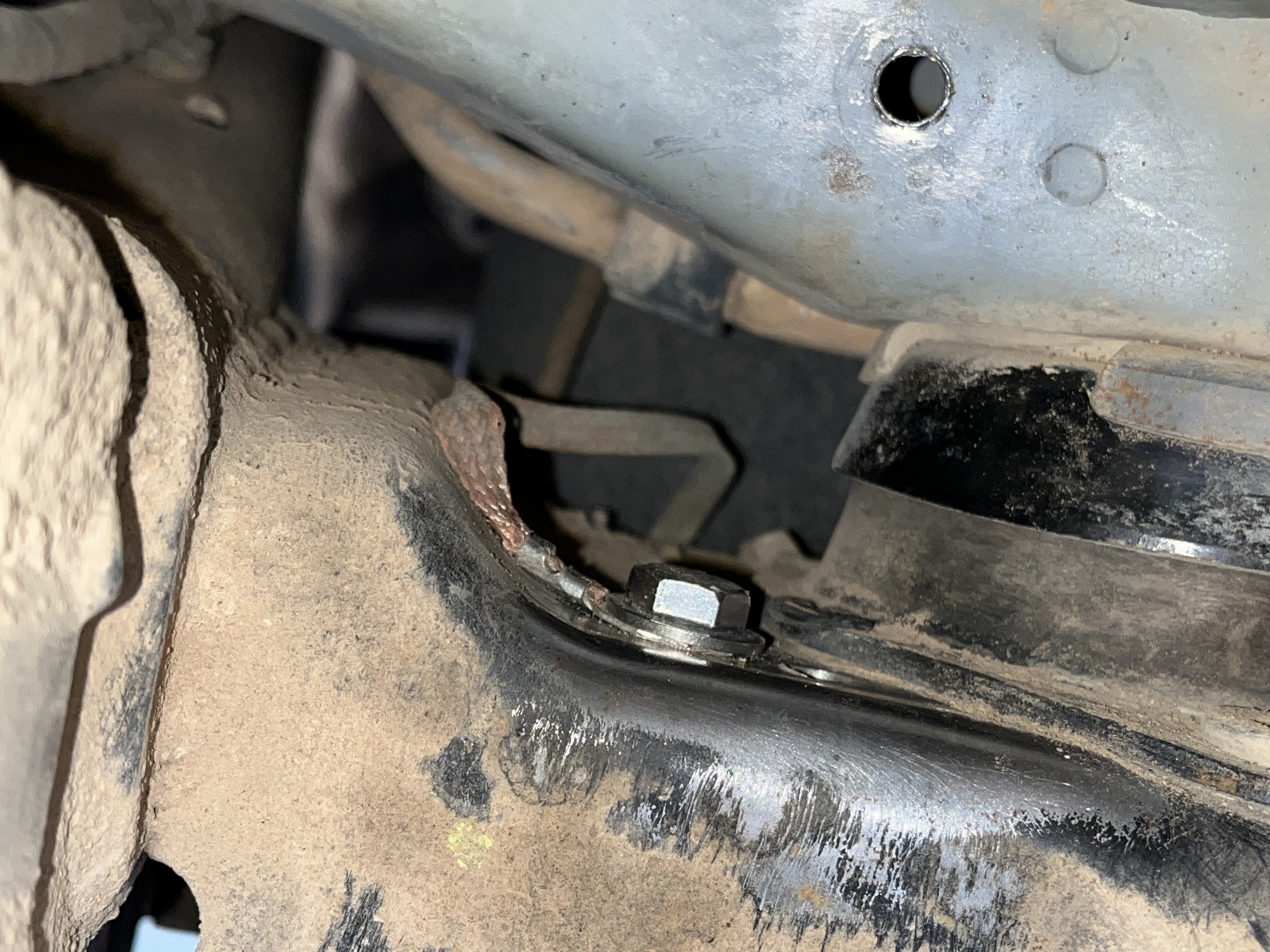

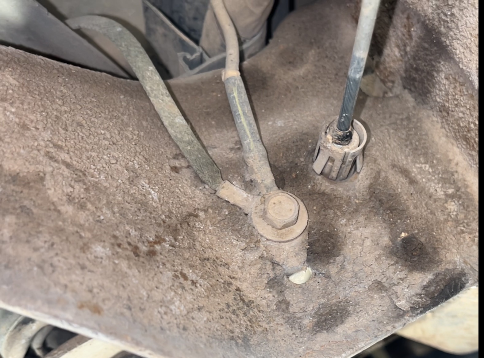

Pics of GROUNDS:
Before
After
Before
After
And a little more info on those grounds… The chassis ground on the passenger side frame rail was actually somewhat loose when I took it off !!! Not super loose but it was NOT tight as it should have been. When I went to reinstall the bolt after cleaning, it just threaded indefinitely but would not tighten. Not even a little. Great. I went into my stash of extra bolts and pulled out one that was similar. It did tighten but not as much as I wanted, it too, just spins freely. I got it basically to stay at “hand tight”.. being where our roads might as well be gravel highways I’m definitely worried about it coming aloose. How big of an issue is this ?

Actually sounds like your loose-ish ground is the problem and make sure your door switches are working, as in the latch on the door that go to the b and c pillars…

As stated above, you need to make that ground connection tight. Many unusual things happen with these trucks when the grounds are not clean and tight. Also, when batteries or battery cables (typically rot from the inside out) are not in good shape, unusual things happen as well.
