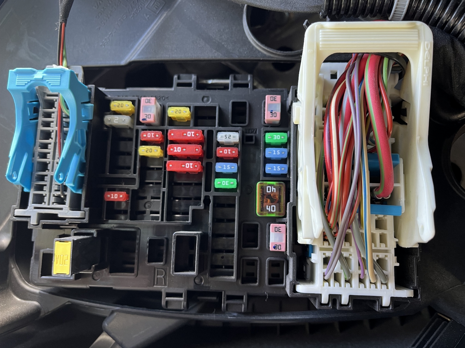

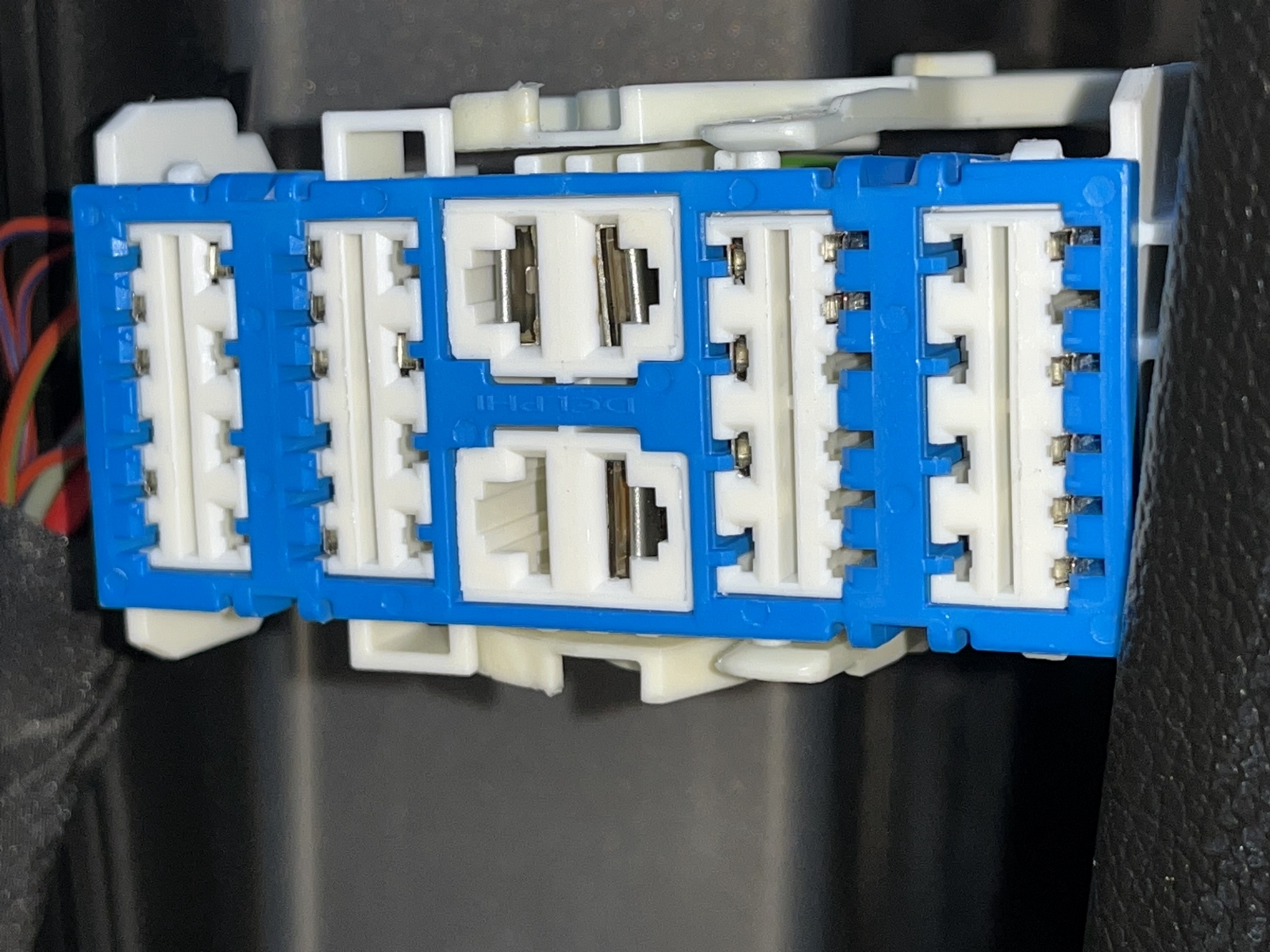

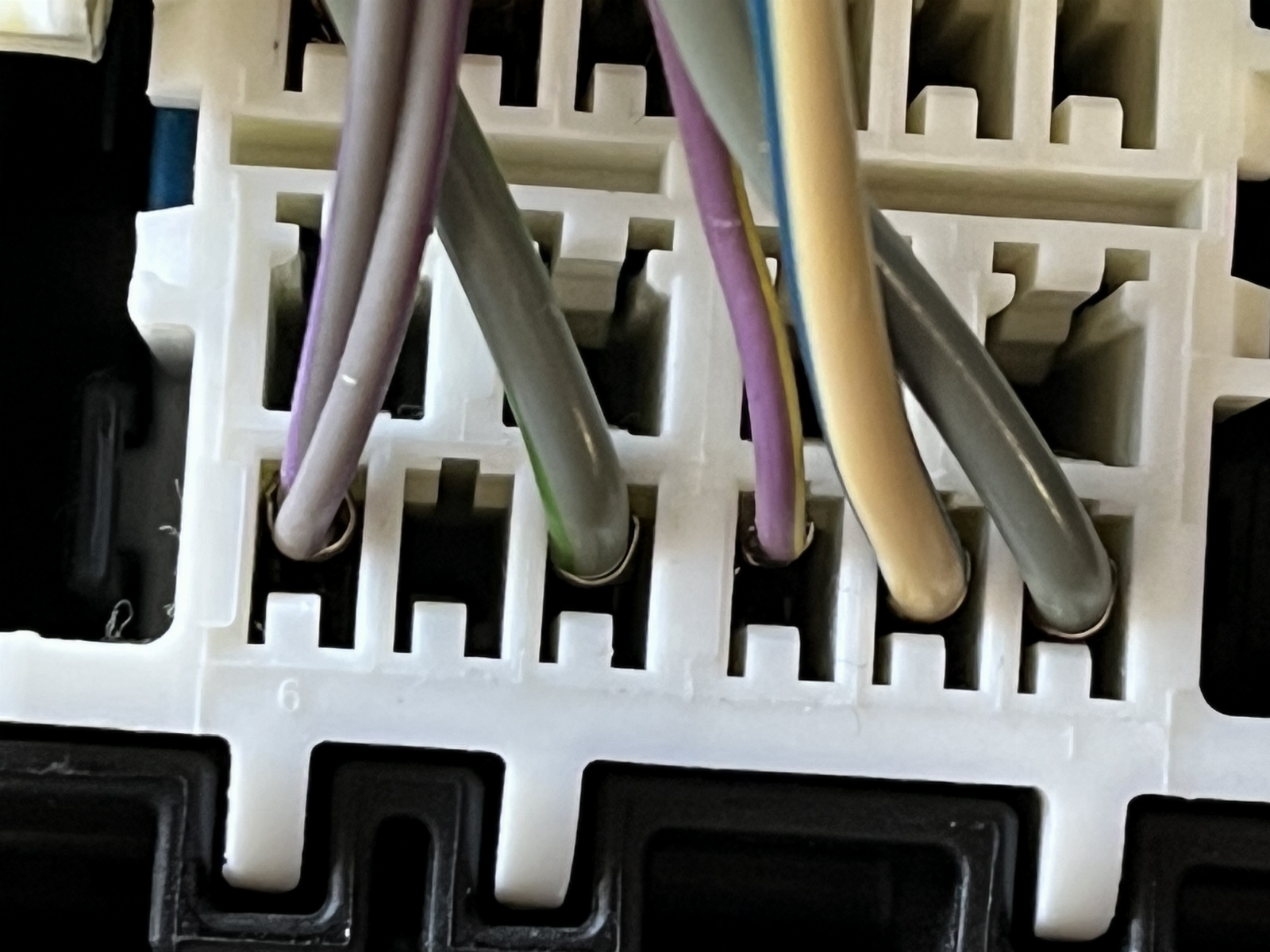

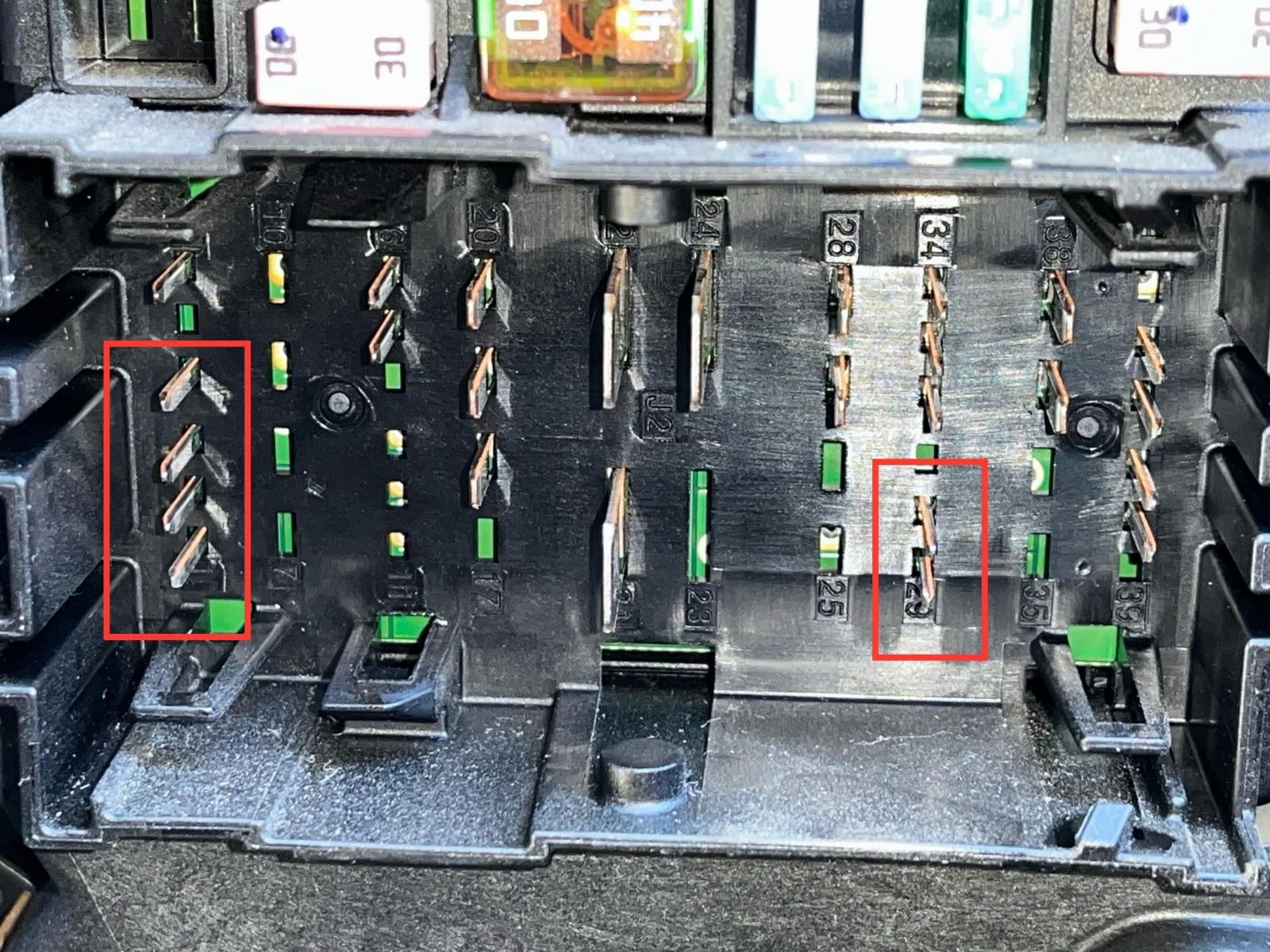

So i checked that harness and it’s impeccable. I wanted to test each relevant pin with the multimeter but apparently i don’t have a setting low enough to get a proper measurement, or i just don’t know wtf I’m doing (or both) electronics is not my strong point
But to the feel test the pins are secure and tight and so clean looks like it just rolled off the assembly line.. wouldn’t you all agree ??
I also looked at fuse#43 on the driver’s side.. looked OK to me
I am starting to think BCM, or pinched wire somewhere in any of the harnesses..
Orrrr…. What? Other than the current possibilities of:
-Pinched/corroded wire hidden somewhere either in wiring harnesses or battery cables
-BCM issue
What else could it be?

Ya, looks clean, figured it might be worth a shot to take a look at anyway.
it looks like its going to take a deeper look, maybe you can take a meter and probe those pins/wires and see if one is guilty
I have no idea what they should ohm out at, maybe @mikez71 has that data or @swathdiver
I would suspect one of them is possibly the cause or will lead you to the cause.

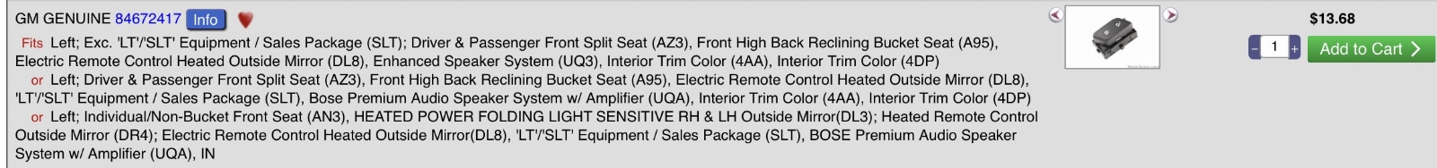

Bad driver door module? (switches)
more specifically driver door module meaning the door lock actuator or the actual switch you press to lock & unlock?
When i think about it, if the switch on the side of the door is faulty it could definitely explain all of this foolishness.

ya easy enough to swap out the switch with a used one, I bought one for the wife's suburban it wasn't that much maybe $35-40 off of ebay
But it’s $14 on rockauto for GM genuine ???? Or is this the wrong part?

if that's all you want to replace or try, I bought the whole switch on ebay complete
do you have a pic? there’s no other listing on rockauto and i’m not seeing anything that looks like a complete assembly on eBay
Nice that you have a separate switch. Integrated on the 07-14's.
You could always remove yours first to test.
If it looks right, and it's listed for your vehicle, it does look like a simple (cheap) part.

Frick it, i just ordered one. For basically $20 why not, we’re still on the cheap end of the parts cannon. When it comes in I will replace with the new one, see what happens . . .
