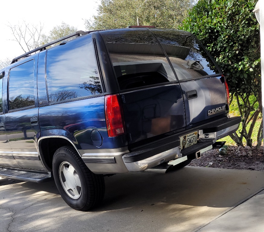

Put new tail lights in today. What an upgrade as far as looks go. Now I need to decide if I want to do the third brake light. Up next will be the new multiswitch. I have a mobile mechanic coming on Wednesday to do that for me. Will cost me about $125 but it's worth it.

Nice work!
Shes starting to look real tidy!
Really quite like the barn door style!

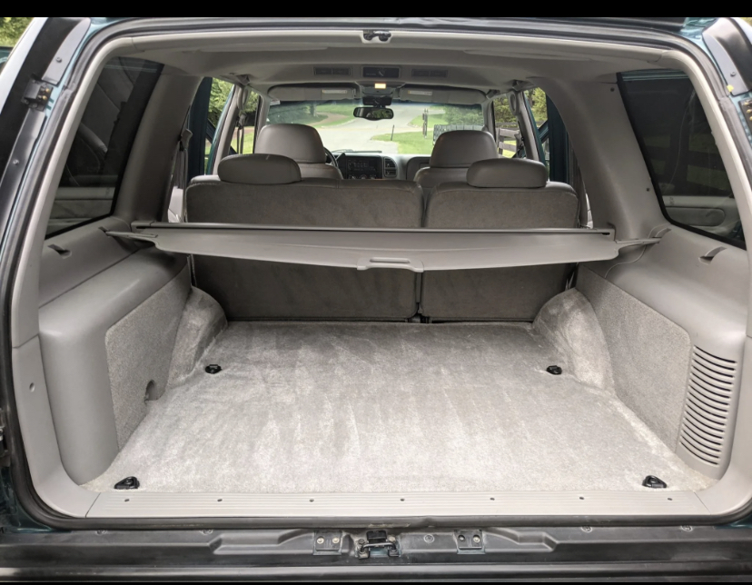

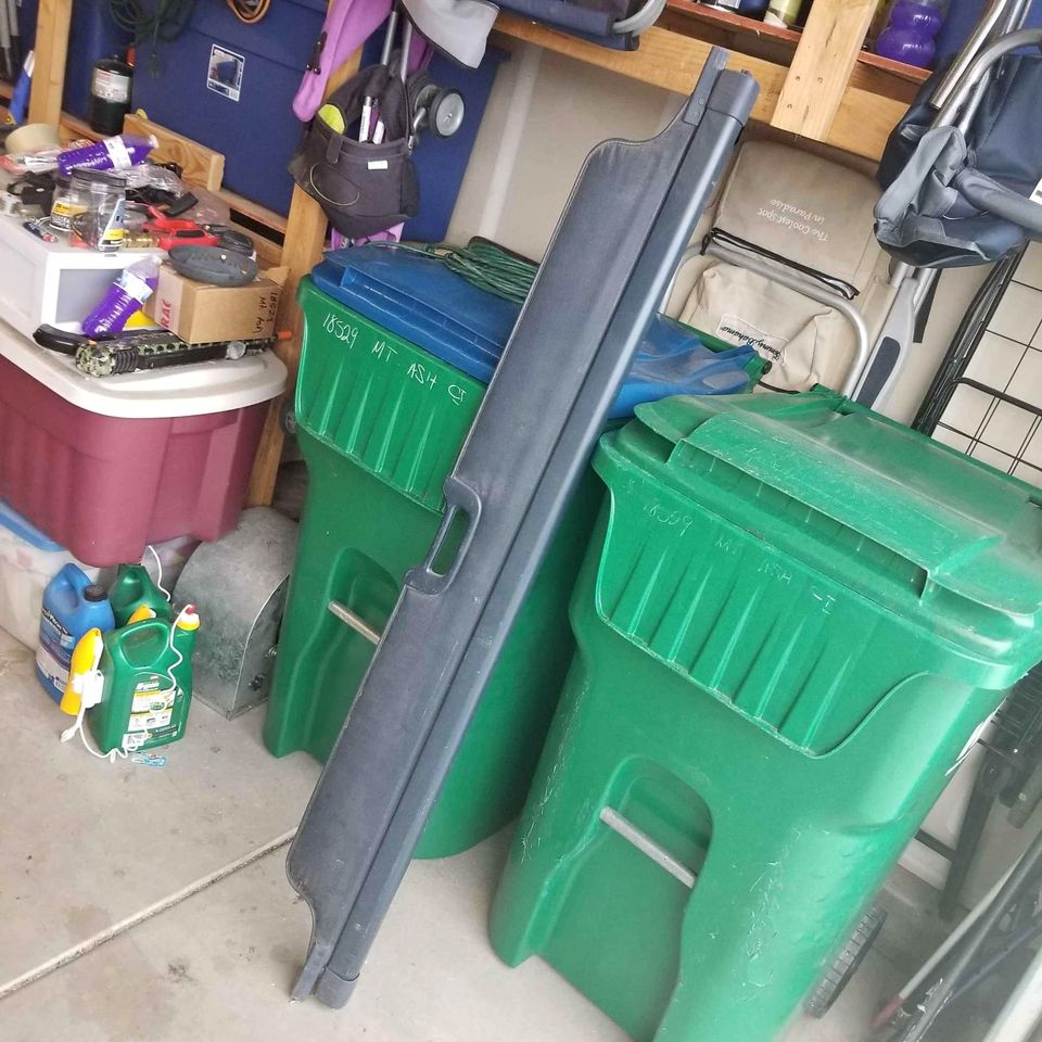

So I thought I would share. Not done yet. Waiting to receive it, but I scored a blue cargo shade for my 99. You can't imagine how hard it was to find. Countless hours searching Craigslist, Facebook and anywhere else I thought I could find one. I finally found one in Nevada. Shipping it wasn't cheap but I really wanted a blue one to match. Living in Florida, you would think I would find one closer. Getting this made my day.

OK, The search for a blue one continues. Got this today and it is too wide. I think it's from a 96. I honestly thought it would be no problem for a 99. Lesson learned. Disappointed though.

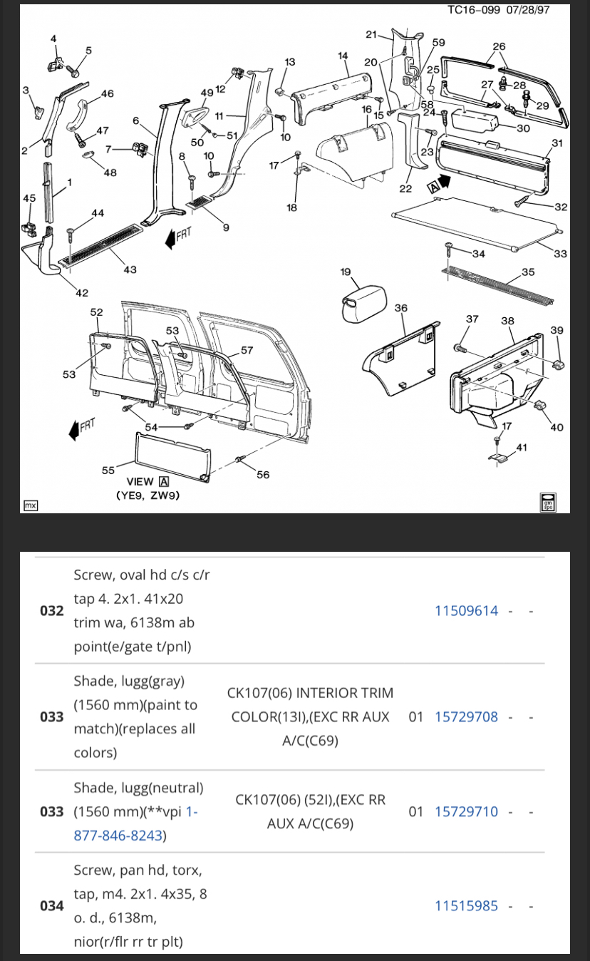

If it helps, this looks to show the two dimensions used (1498mm vs 1560mm). According to the part description, the longer ones were used in the earlier years without rear a/c. The side panels were different.
GM tended to use sequential part numbers for different colors of the same part, so blue’s part number was probably close to one of these. Maybe you can turn up some old dealer stock that way.
It’s marked as specific to Tahoe/Yukon - model code 107(06).

Thanks for the information. Blue as an interior is no joke. I don't have to have it, but thought it would be nice to have. It is hard to find good blue stuff. Most of mine is good luckily. Just recover the drivers seat (and pad), and get the sunvisors recovered and it will look pretty good in there.
