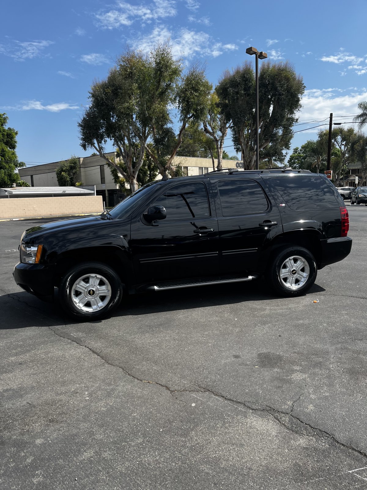

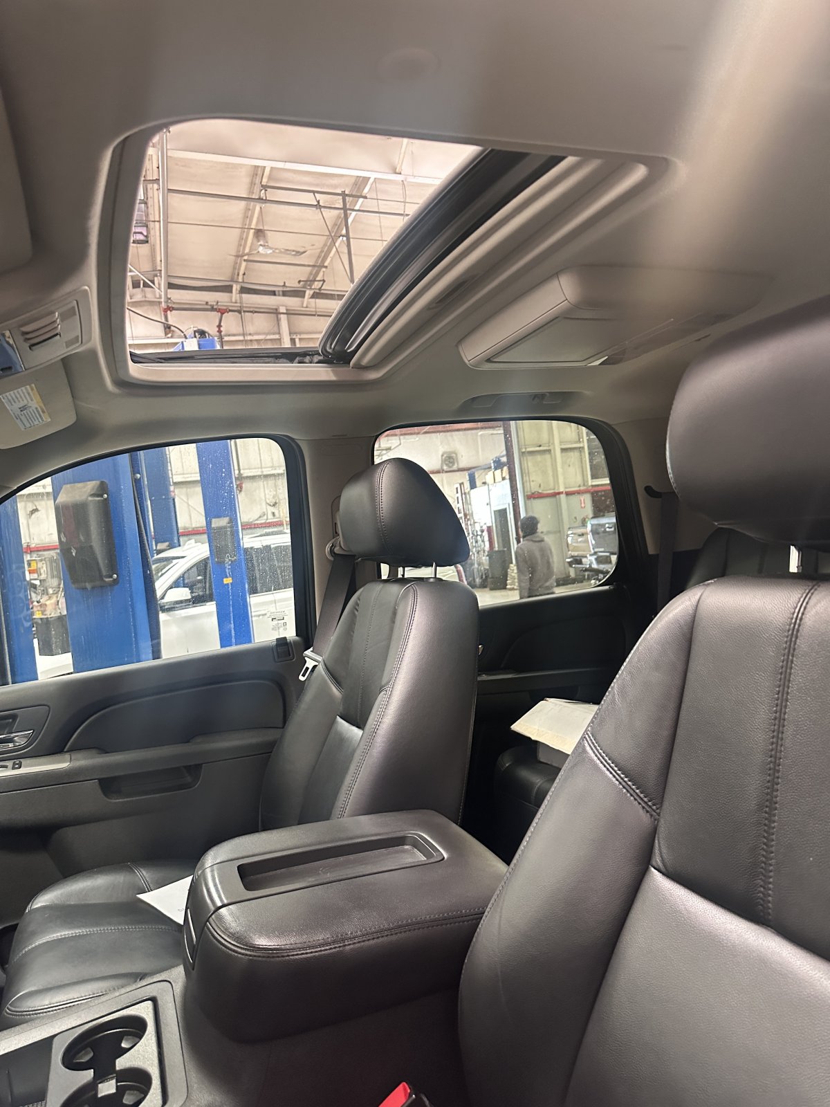

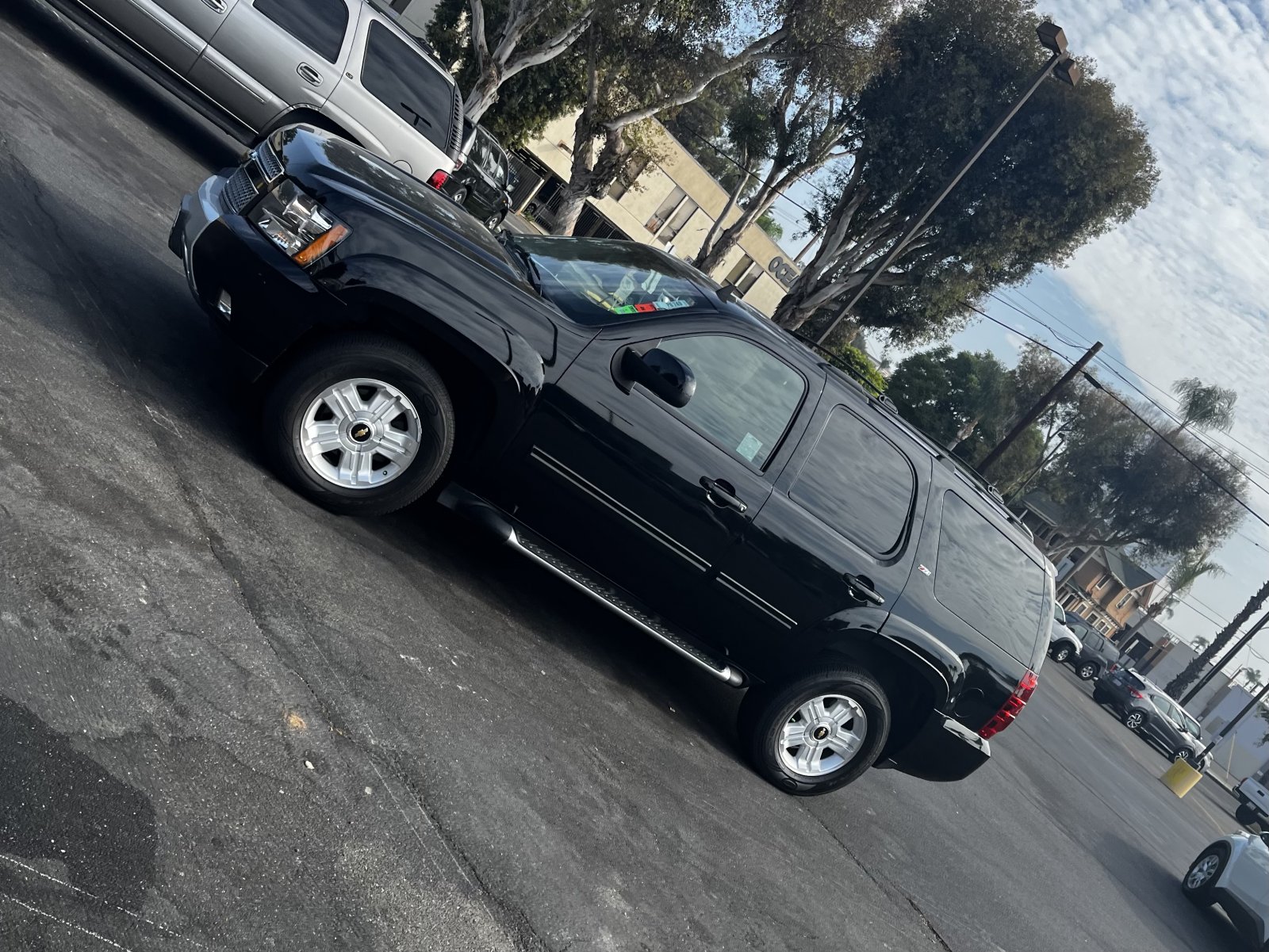

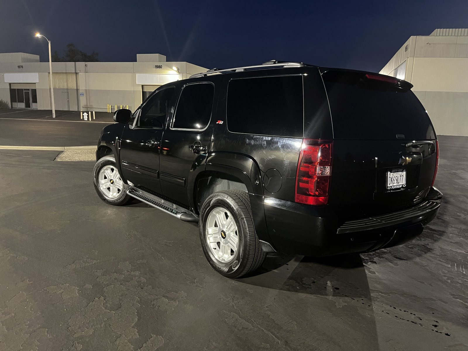

Appreciate all the feedback! It’s a 4wd. I don’t go off-roading much or anything, but wanted the 4wd “just in case”. Currently sitting on stock 18” wheels and tires. Since I purchased off a dealership, they serviced it prior to me purchasing. But in March of this year I did take it to the Chevy dealership for an oil change where my buddy is a mechanic and had him check it out, since I trust him. He said everything was good. But next time I go, I can ask him about the ATF to ensure everything is running smooth.
Someone mentioned the gears. It currently has the 3.42 gears. The original window sticker was still in the vehicle. I am considering a tune, not because it needs anything, but simply because I’ve heard great reviews for BBP and wouldn’t mind a bit more HP. I do have some pictures of it. Some are from the dealership when I first bought it (w/out window tint). The pics with window tint are the most recent ones.

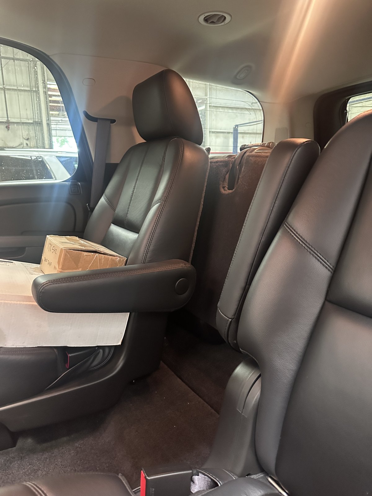

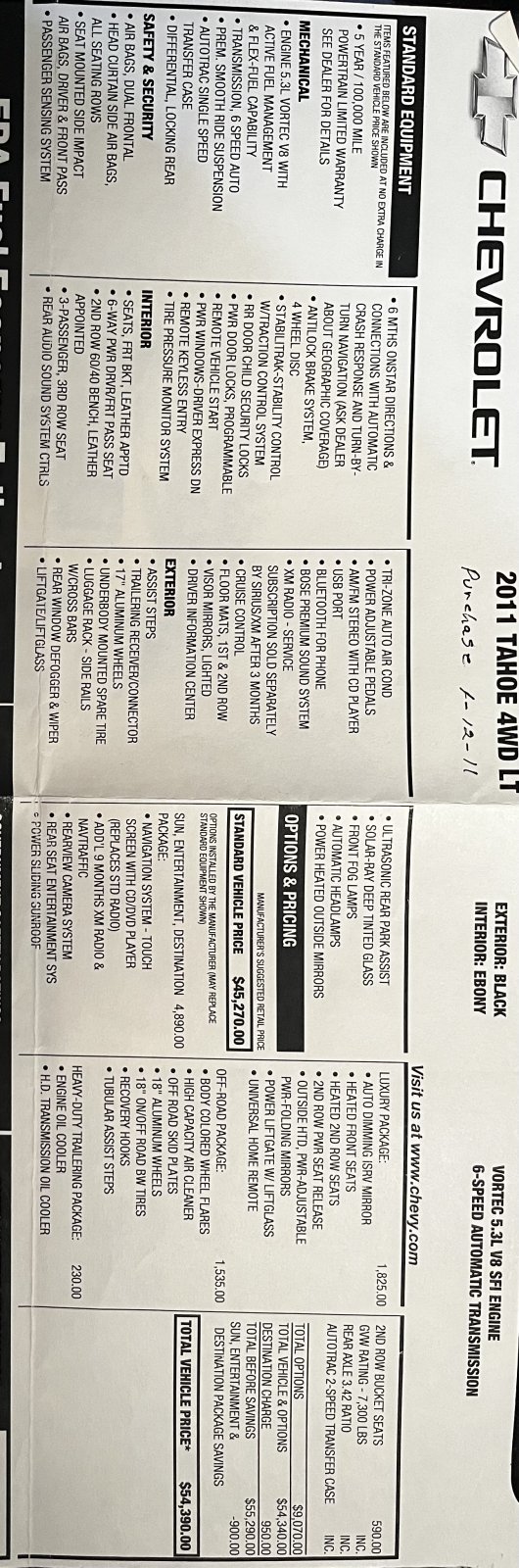

Someone mentioned gears. It currently has 3.42 ...
If it already has 3.42, congrats, that's what GM shoulda put in ALL of the ones with 3.08.
The big deal about the tune is not the extra horsies, it's the improved engine and transmission response,
how much more durable the transmission will be after addressing the TCC lockup behaviors,
and how much the engine will appreciate having Engine Half@$$ disabled in the long run.
You'll be next in a long line of people who got tuned and wonder why other people don't.

Always loved the look of the GMT900 Z71s with the fender flares and front bumper. Nice truck!
Just remember that even though she's low mileage, some things will age out due to time. Just keep looking her over from time to time. I bought a Sierra with low mileage like yours and found this to be the case.
The front axle and 2-speed transfer case is nice to have, remember to exercise it once a month or so, so it will be ready for that day when you really need it.
