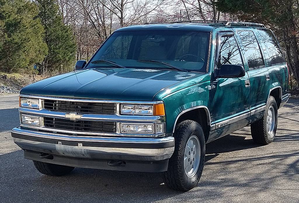

Picked up a '98 Tahoe for what I consider cheap. Was hunting for something with barn doors. Got 193K on the clock, runs and drives smooth, couple of very minor door dings and a few spots on the interior, but over all, extremely clean. No rust that I can find.
But since I've never had a vehicle like this, I'll be bugging y'all to death with questions.

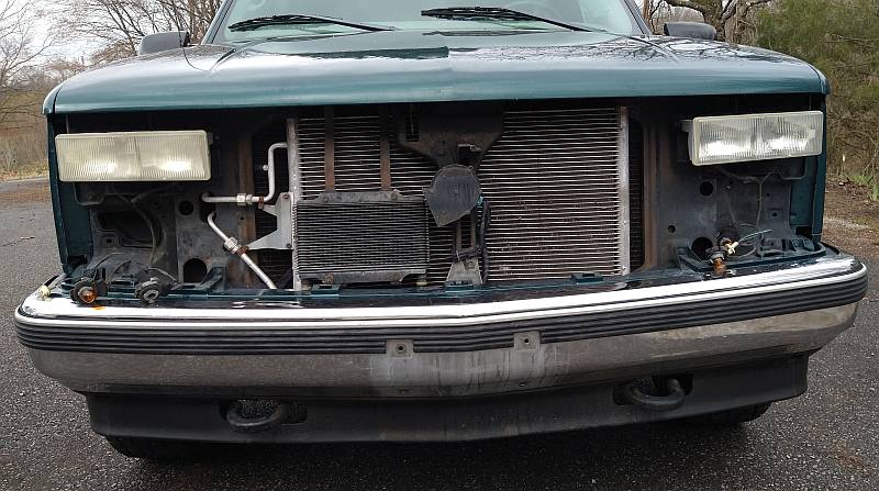

Quick one for now off the driveway camera. Front end is kind of taken apart while I deal with the grille issue.

Welcome to the Forum from NH.
Pics of the truck, please.

As for the grill, I wouldn't bother trying to JB weld it especially if you already have a replacement available for only 50 bucks. The JB weld will work temporarily, but the grill will eventually crack again, as the crack will usually end up spreading beyond the repaired area. I honestly would just spend the 50 bucks and be done with it, as long as the replacement grill is in GOOD condition.
