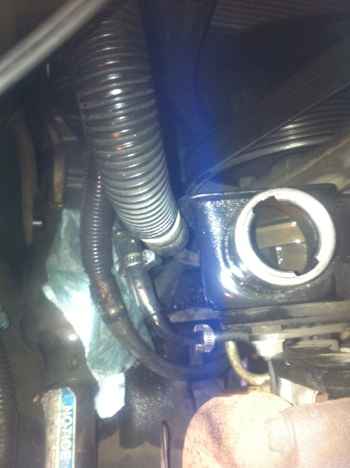

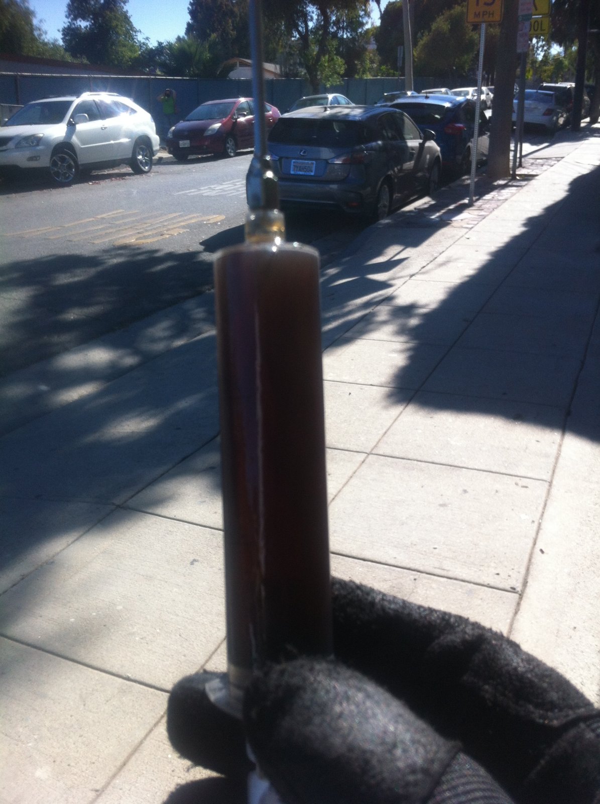

Flushed the power steering. Thought I'd try that before I change the pump. Fluid hasn't been in long but wasn't looking so hot.
I used a short piece/ 6" of 3/8 tubing folded to block the hard line, and 3-4' of 5/8 pushed over the other side to send the fluid to a catch can.
If you don't have a syringe a 'flavor injector' works great for sucking PS and brake fluid out of the reservoirs. I think I bought mine at the grocery store.
