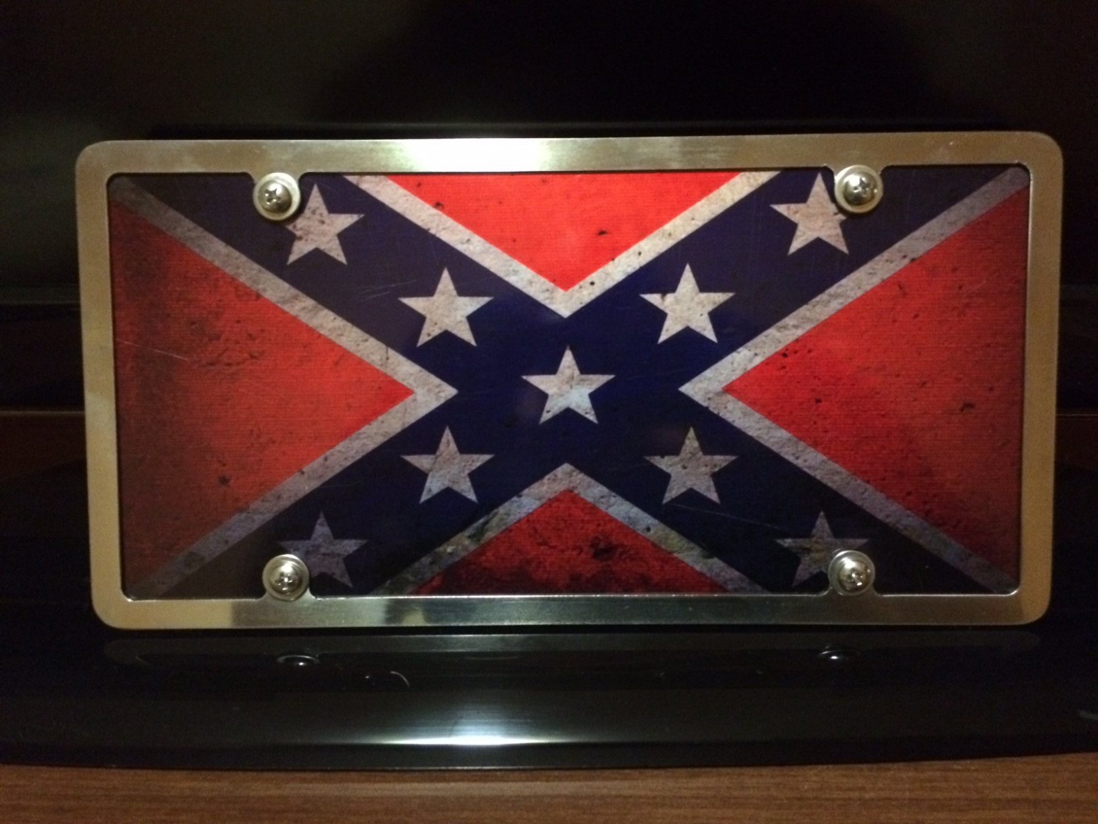

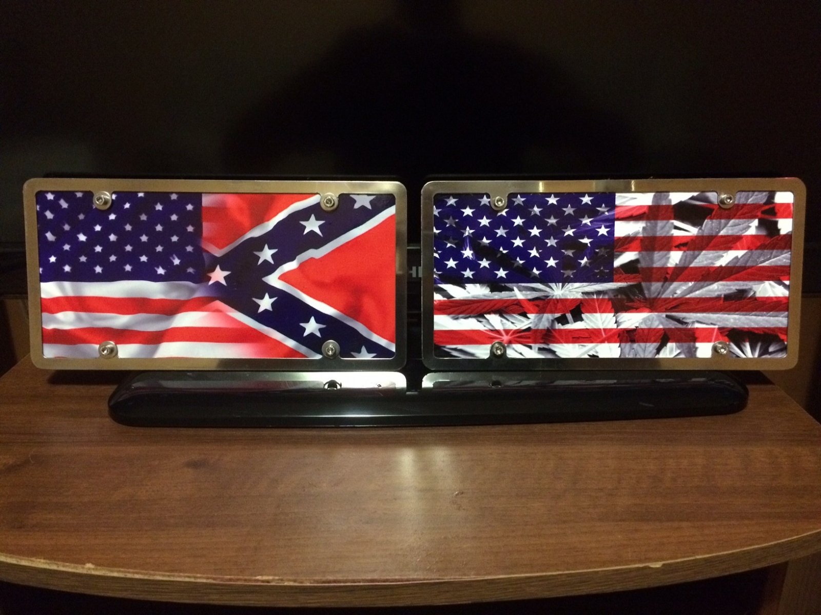

I have no idea what that says, but it's got an American flag so it's awesome! [emoji106][emoji16]

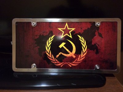

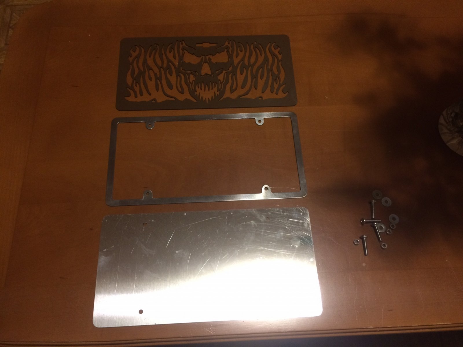

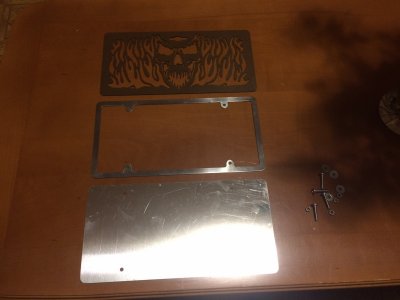

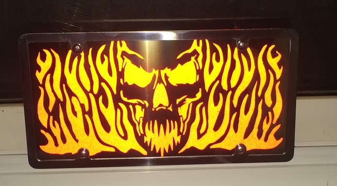

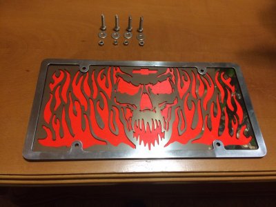

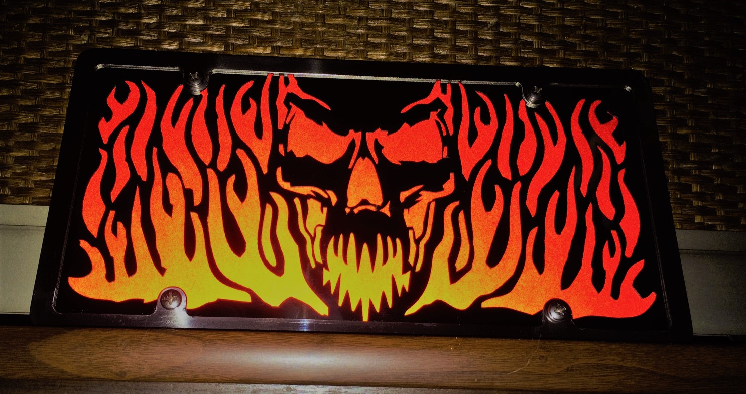

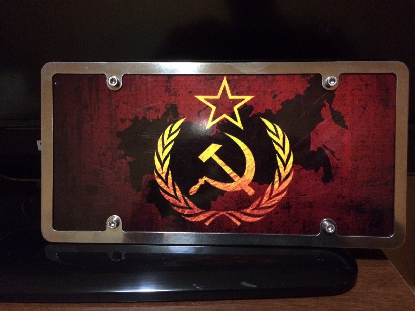

But, on June 12 there was a stylization for an American registration number with a picture of the formidable, but bygone USSR .....
and glowing Skull in the amount of registration numb
