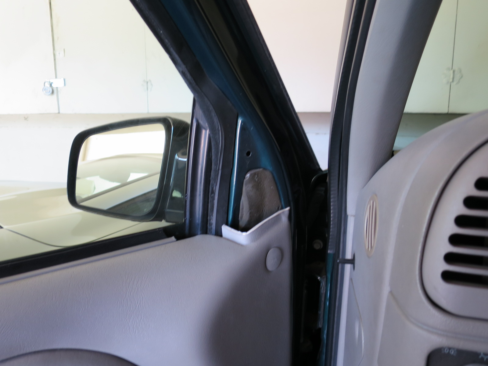

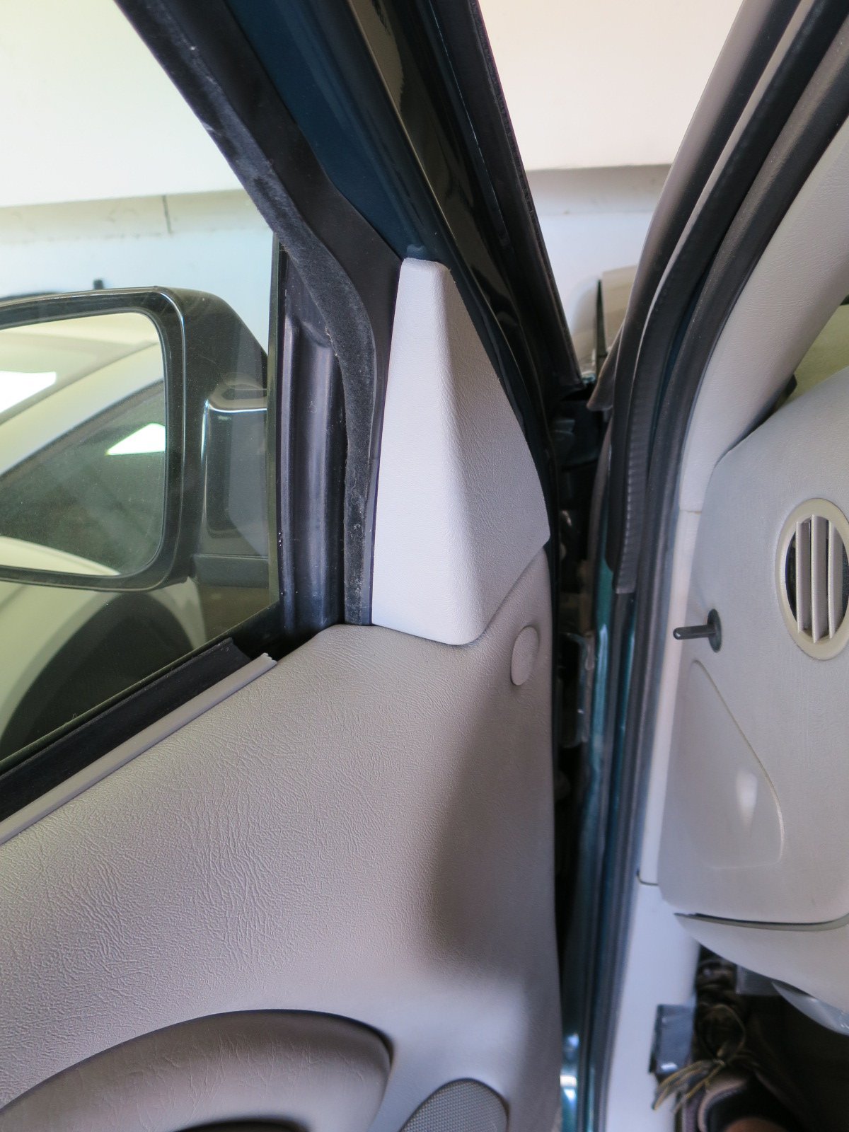

Took me about 10 years to finally look for and find the right clips for my drivers door panel that was literally hanging off at the end. I took this off at least 5 years ago to use the clip for comparison and then lost it somehow. Just got one from fleabay. Color diffference is just the light. Was bugging me for ages and it feels good. Wonder if the old one will turn up now?
Lol, you know it will!

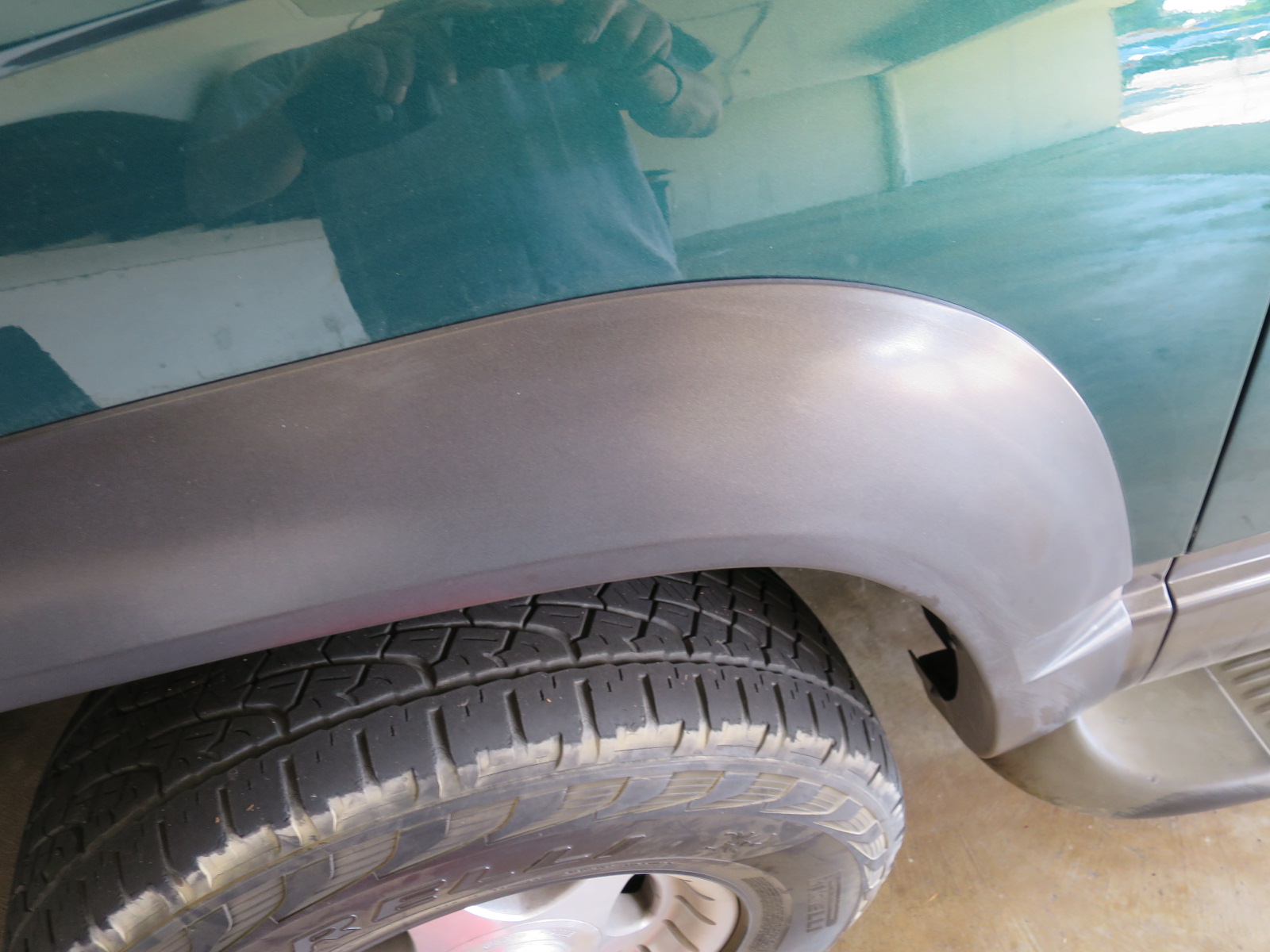

Spent about 1/2 hour on each fender flare washed, polished, stripped, polished, as they were looking very tired and they have been a bit neglected. Looked much worse/dry in the sun and they still don't look much better tbh.
These are also the best two. Other side have some missing paint along the top and one has some damage. Kind of all need painting really but in the meantime.
Should I be treating these as paint or plastic? Seems like bumper gel would make them look better but they seem painted. I've always struggled with these. I kind of prefer them matte but they are starting to look like crap and I wanted to do something. The other side was worse. What do you do with yours?

I primed and repainted mine with this which is the factory color (for 98 Sport at least)
I just masked mine as each flare had a bolt that was just too hard to get to. Results were ok for a rattle can job, about a five footer. The paint alone scratched easily, so I hit it with a few coats of clear but not enough to make it glossy.
The flares will flex, so if I had it to do over I’d look at some anti-flex agent, whatever that is. If you look close, there are tiny hairline spiderweb cracks in the clear.

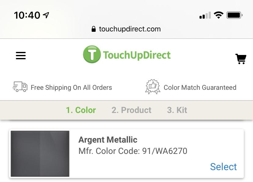

I went to automotivetouchup.com , ordered the same color code as east302 ,WA6270, gloss clear, sandable primer and an adhesion promoter/flex agent for rubber bumper covers etc. I did mine at least 3 years ago and they still look great. I removed the rear flares since I was completely redoing the interior at the time and had everything removed. I did the front flares on the truck.

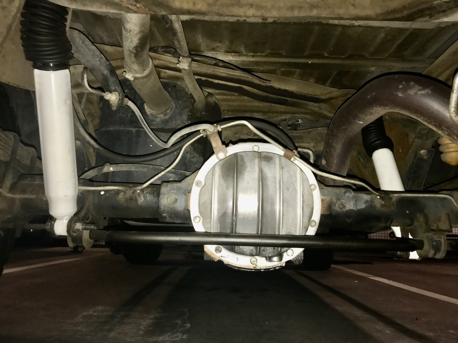

I replaced:
Rear shocks with Explorer Pro Comp ES6000 924509.
Front shocks with Explorer Pro Comp ES6000 918501
Added some Daystar Universal shock boots.
The shocks were due for a swap and these were affordable and gave me some extra length to allow for the slight torsion lift and the extra leaf in the rear.
Replaced front disc brake rotors (AC Delco) and front brake pads (ACDelco 17D369MH Professional Semi-Metallic Front Disc Brake Pad Set)
at the same time I did the shocks.
Rear shocks pics only.
