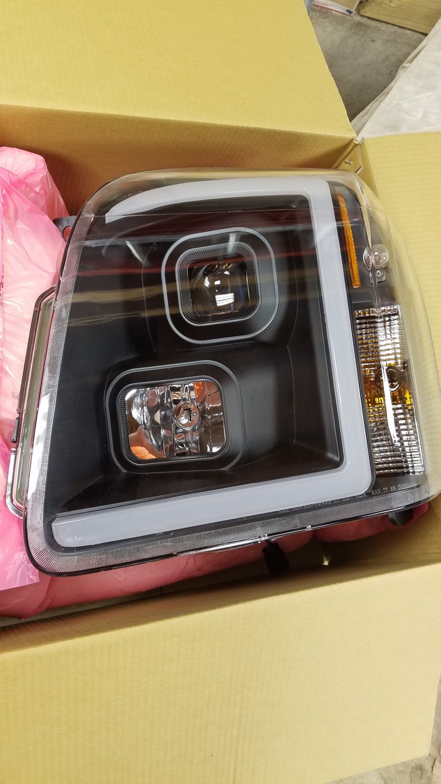

Yeah the high beam is below the low beam projector. The housings take H7 and H11 bulbs for the low and high. They're not great, but better than the OE light output. The led surround comes on with parking/headlights and are not the DRL. They were about $300 when I bought them at the beginning of 2020. Only problem I have with them is the thin outer layer of clear or uv is peeling starting from the top. Could easily be buffed and re-coated probably.

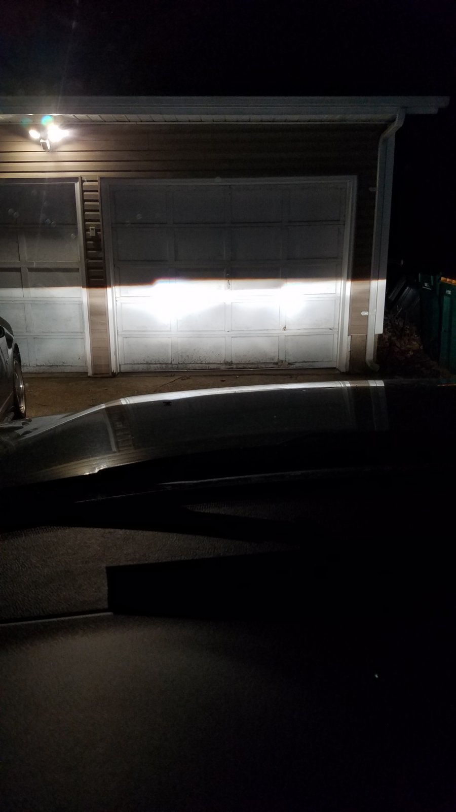

that's a pretty nice cut off for what they are. these morimoto's have the angled step cut off. i don't like as much as the square.
I'm pretty much done with projectors that need bulbs thou, the ones with the chip on board while not replaceable, they are so much brighter and crisper cut off I'm OK with it. if they ever burn out I'll replace the whole thing.
the bi-led I put in my fogs had the angled step cutoff, I took them apart and cut the flapper straight to make them into a proper under the "fog" cut off, but had they been a nice step, I wouldn't have touched them.
for the lenses, the chemical stuff recommended from posts back is some pretty good stuff. I'm sure you could restore it them, put some ppf over it and they look good as new. my morimoto's weren't just hazed on the outside, the plastic it's has that crazing stuff going on. like internal cracks. very disappointing for the price but warranty was painless.

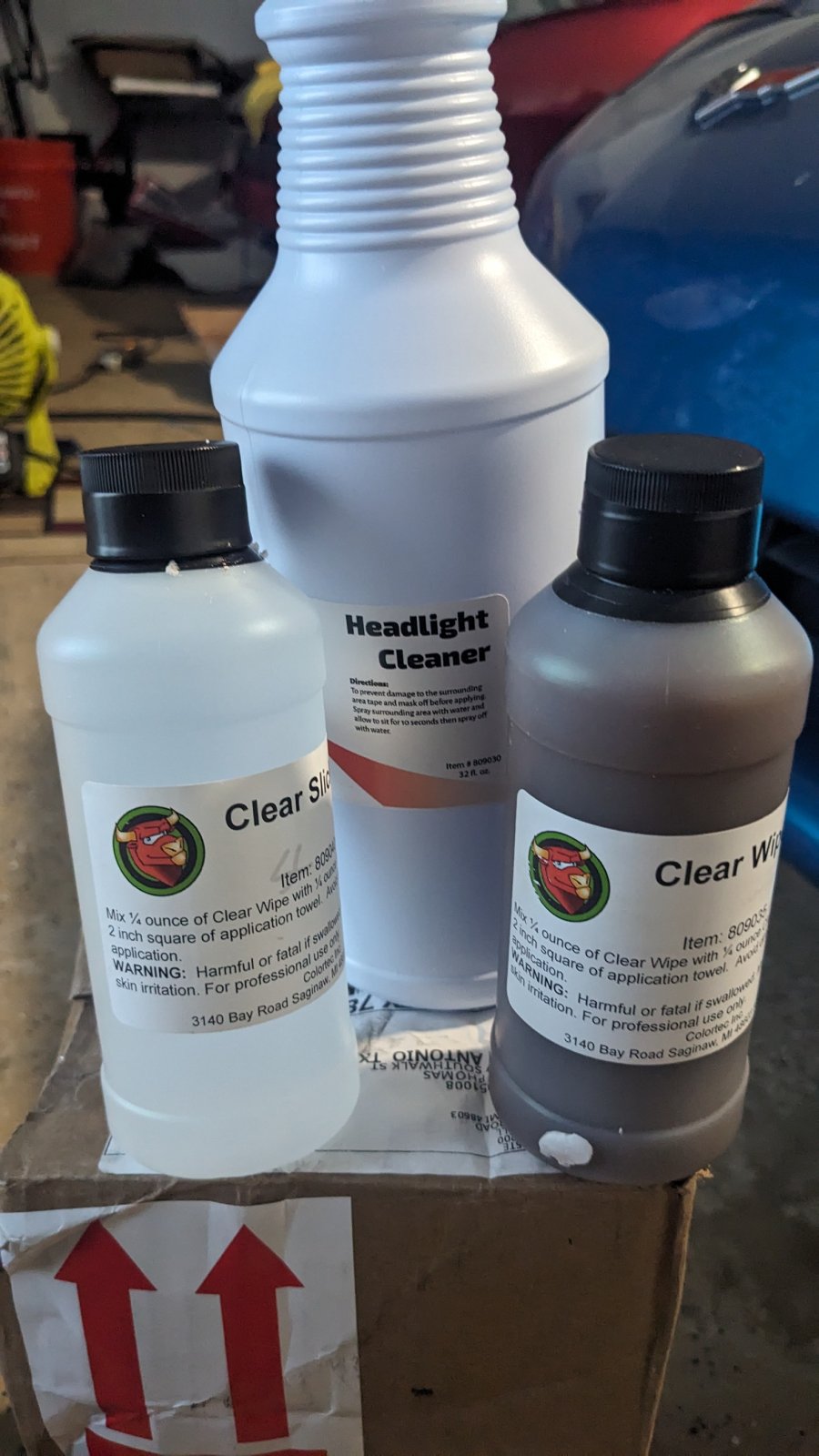

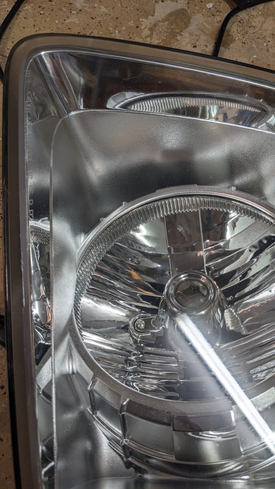

I've tried a few of the restore kits, most help but it ain't like new. from a member here I ordered this stuff. it's pretty crazy. it puts a factory type uv coating on the lights and makes them crystal clear too. I did my new lights before installing them and then put ppf over that. they look perfect right now. it was pre cut ppf for the stock lights and I don't think it fit right. I want to redo that for better coverage but you can't even seen it.
time will tell but I think the other member was right, this stuff might turn out to be really good oem quality.
I practiced on my old stock lights that were really hazed up. Just cleaned up with the spray and then wiped the mix on. it would have been perfect if I did some wet polishing, but I was just testing since I was going to coat the out of the box new ones that didn't need any work.
I don't believe that about to many layers blocking light output, that's just silly. if it's clear it's clear. 6 layers of ppf would block less light than a slightly sun damaged len. anything you can do to prevent that is worth while.

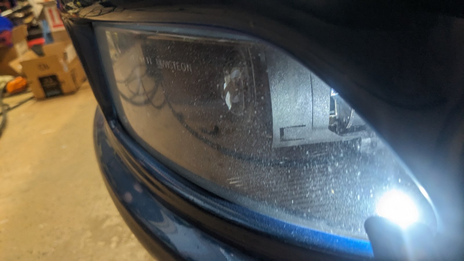

my c6 fog light lenses look horrible, I need to either wet sand, buff and apply this coating badly or just replace them. I removed the lenses and did the retrofit on them because I wasn't worried about damaging them but the light output is great. just since it's a retro fit projector, you gotta remember to flat black the old reflector if you can't remove it, it will glare all over the place if not.

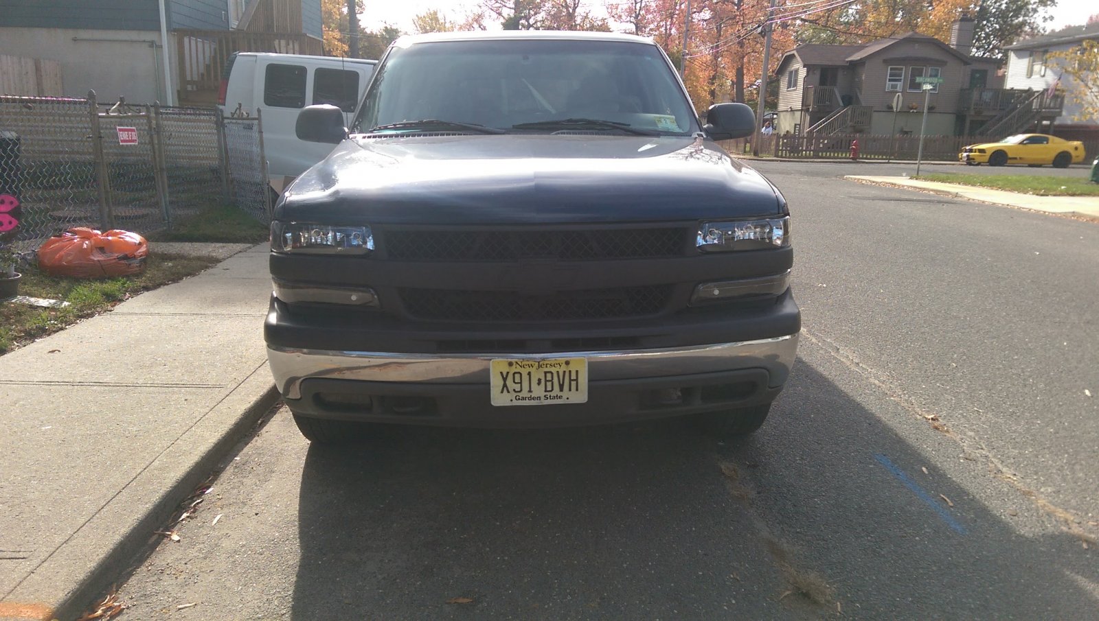

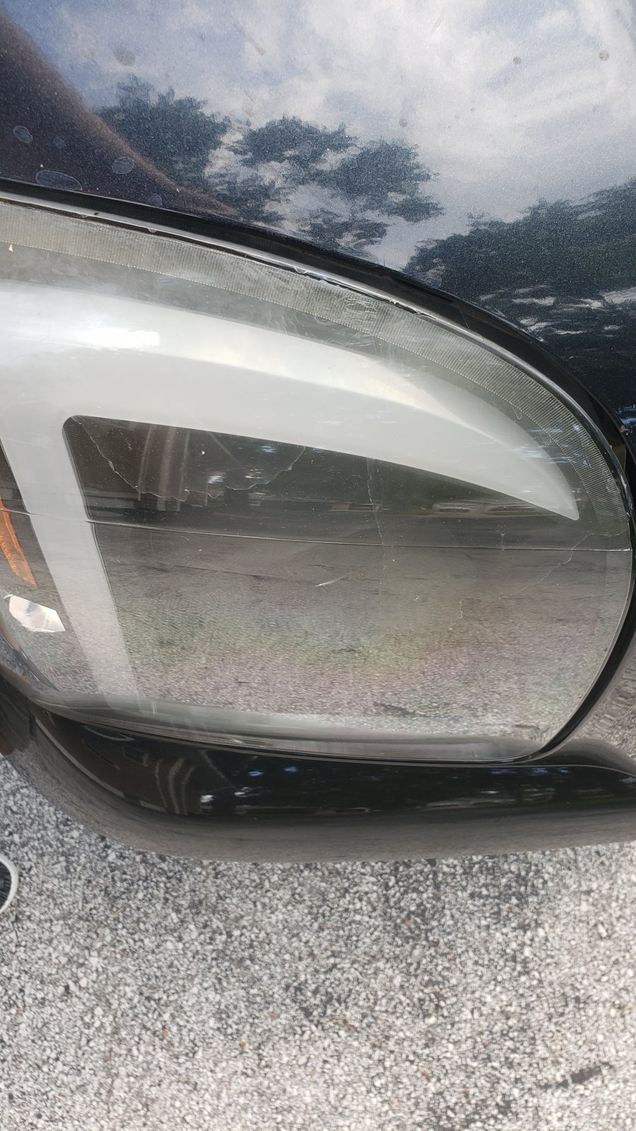

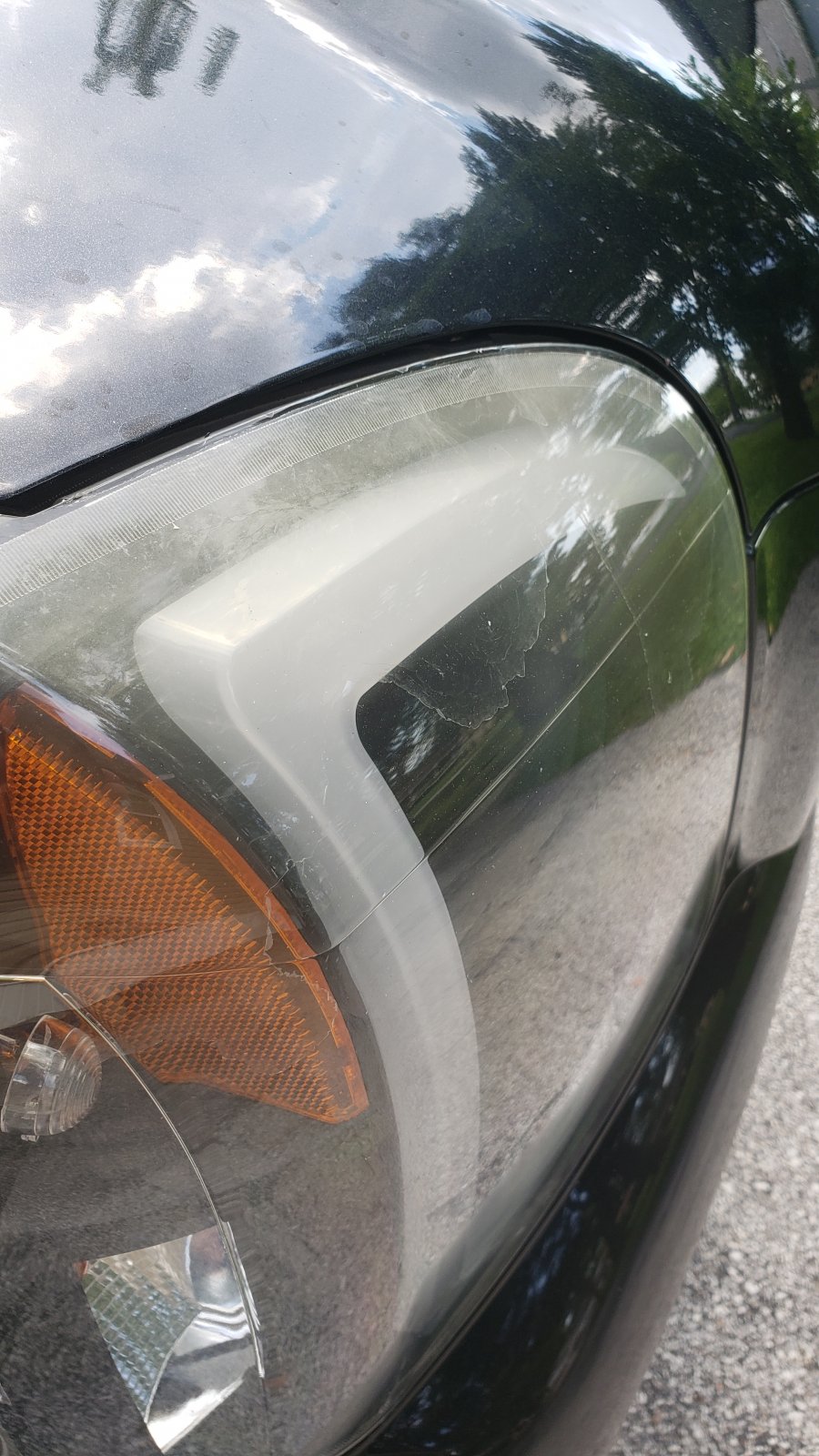

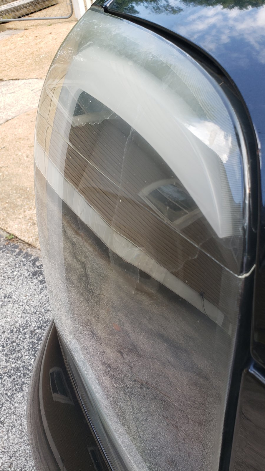

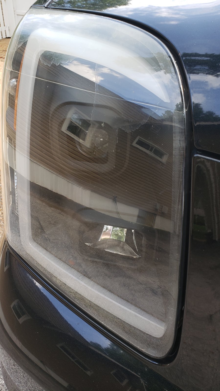

I just took some pics of my current headlight. It's hard to see, looks more like a hard water spot. It's like this on both headlights.
I still have my OE headlights in a box in the attic of my garage. They're in great condition, no haze, no yellow.

yep, that's the uv coat. you'd probably need get thru that with some wet sanding, and then mix and wipe on that 2 part mix. since you're not yellow, the spray wouldn't do much for you.
the spray is wild stuff I messed with it a bit. I feel like I could damage stuff with it haha.

When I've restored completely yellow/hazy headlights I start out by dry sanding with a custom flexible pad that goes on a palm sander. Depending on how bad the headlight is determines the grit of sandpaper I start with. I then go to a finer grit paper until I hit 2000 grit. I then buff with plastic polish, using a buffer with custom 10" wool pad. The final step would be to mix the 2 part uv protector, then applying with a lintless cloth. I applied just the uv protector to my then new headlights. IMAG0755_416582734887229.jpgIMAG0761_416583249964051.jpgIMAG0891_416639122610541.jpg
Ti's was back 5-6 years ago. They're now just starting to get a very little hazy on the tops of the lights.
EDIT--I just checked when I did the lights originally, and it was back in 2016--8 years ago! I'm in NJ, so southern states might not last as long as mine did.
