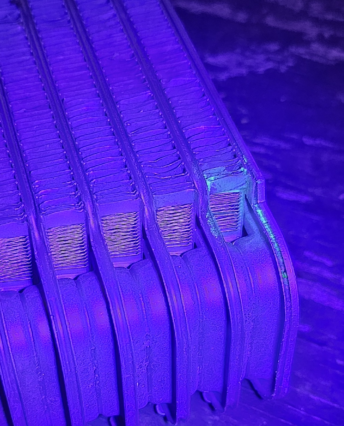

Yesterday i got the rear evaporator changed. Not to bad a job really. You don't need to remove the entire unit
It is in two pieces held together with clips. Underneath there is just 1 stud you need to remove a nut from. Took about two hours start to finish. Added about 1/2oz of PAG oil also.
After vacuum test filled it with the required 48oz of r134A

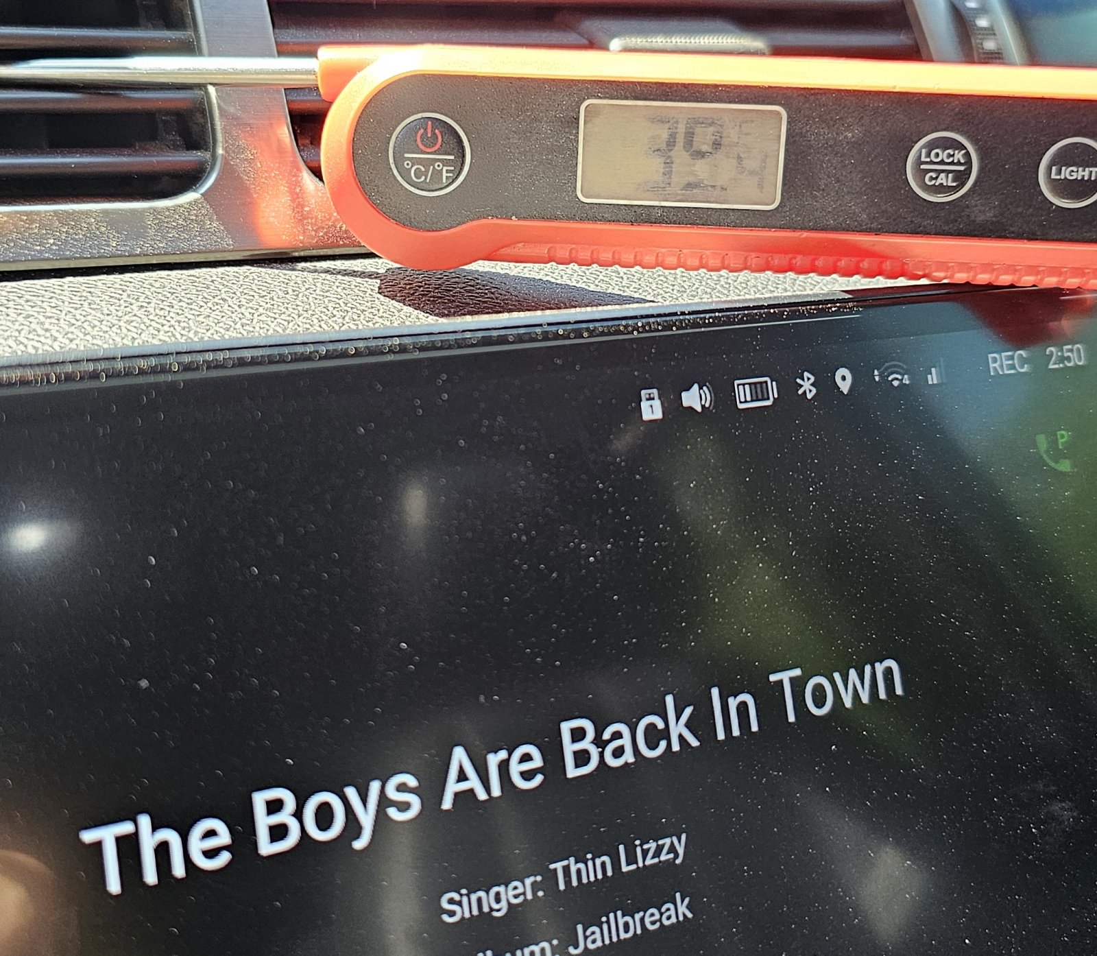

Idling in the driveway, temp was 39.4f with front and rear on high and outside temp was 83F
Hoping i fixed the leak.
